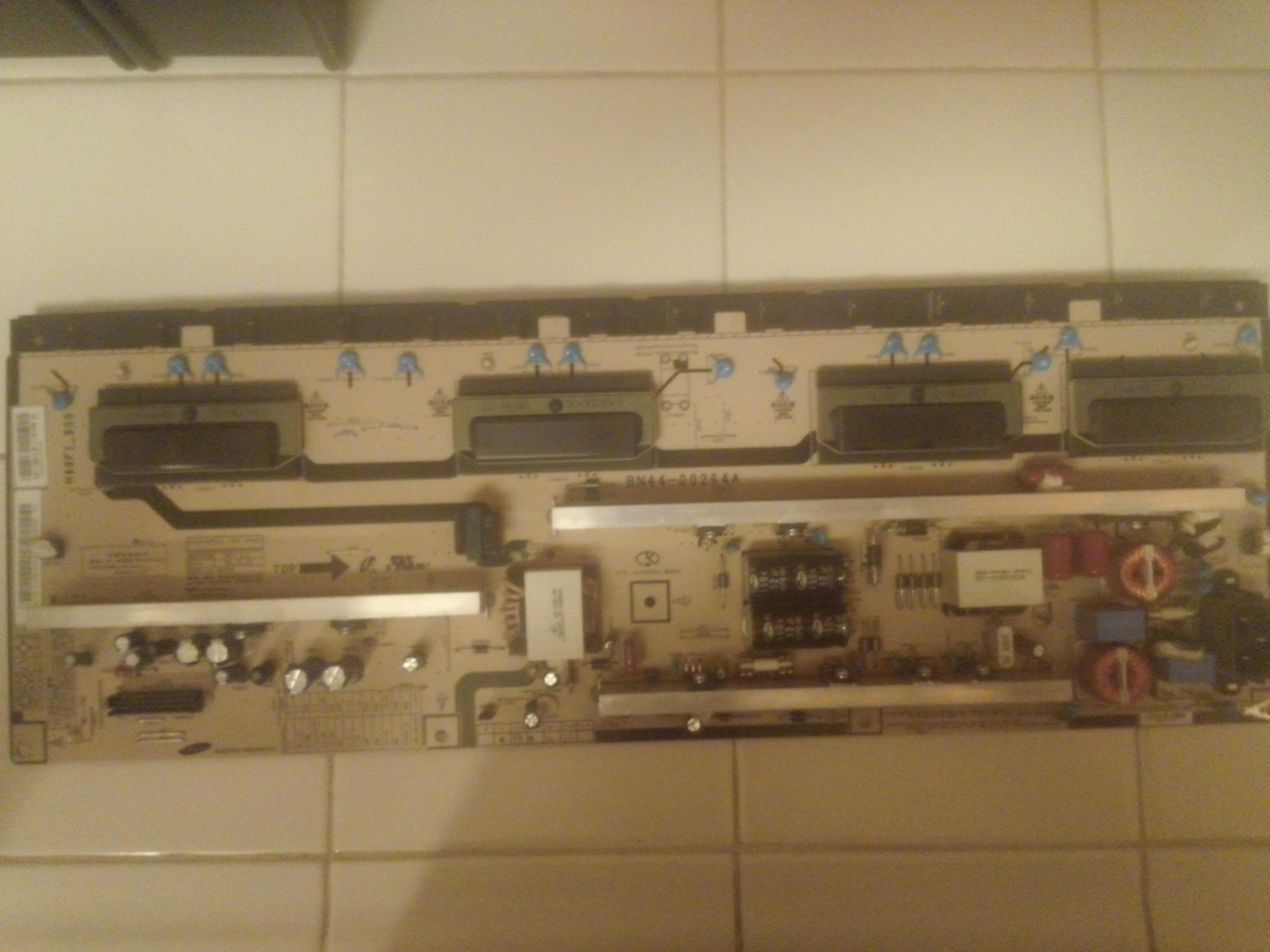

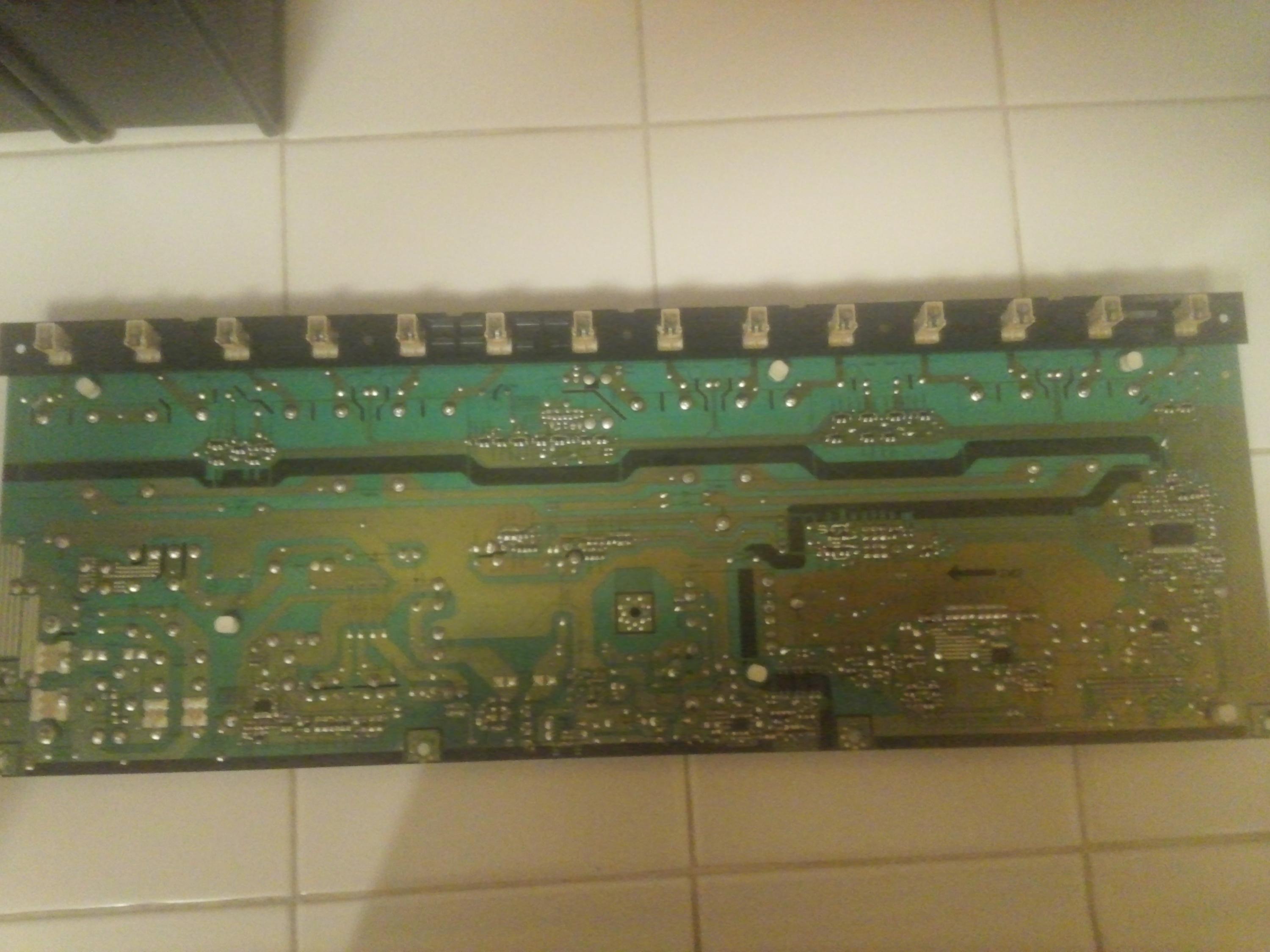

          Re: Old Samsung LCD
          Best pics I could get, if you need better I can get a better camera later and take better ones. It's the same board as the one in the link I posted. You gave the guy in that post a list a points to test on his rectifier, I did the same and got in the 50 range with the 200 setting on everything except point 2 & 3 I got nothing.

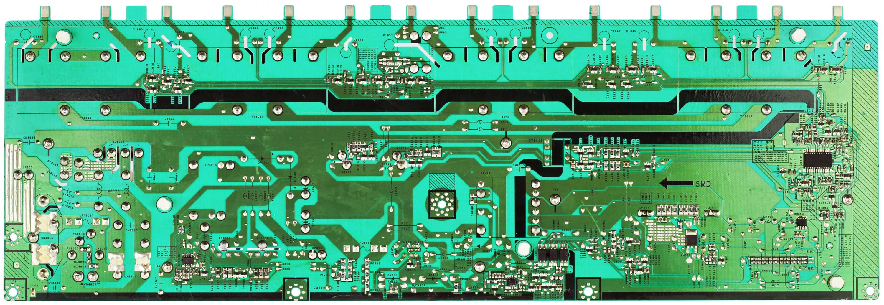

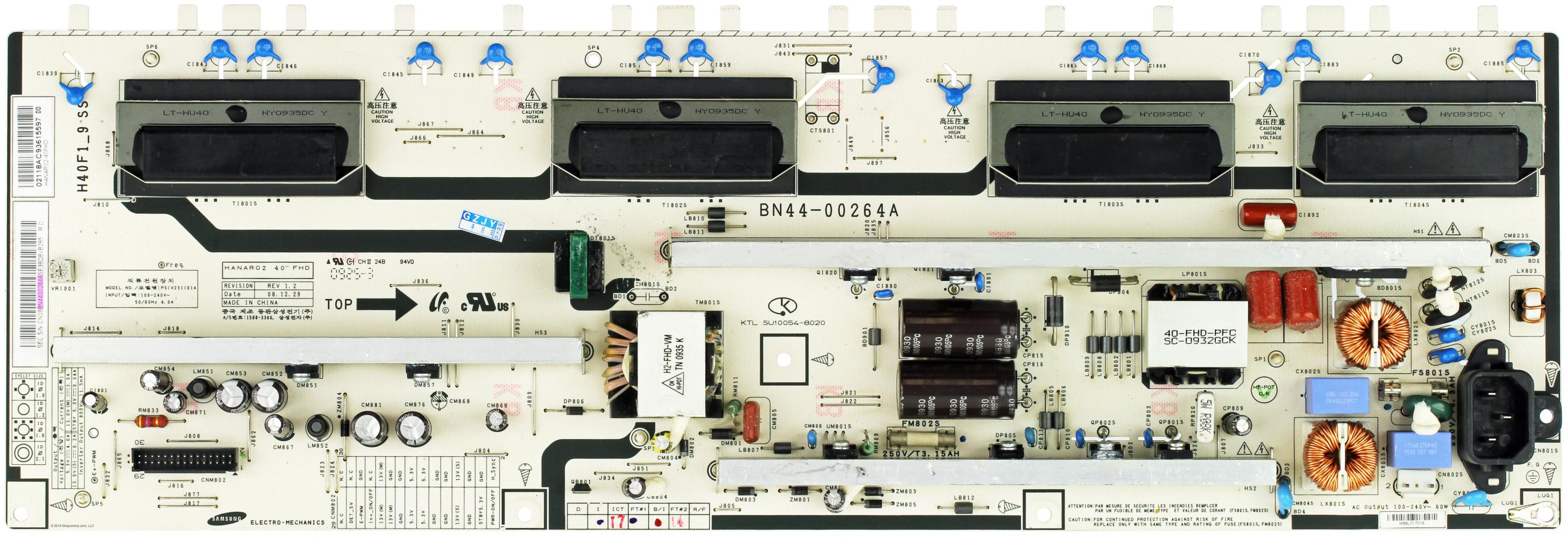

                Re: Old Samsung LCD
                OK, your pictures are too blur to use, so I found good pictures at SJ.
                Since it blows the main AC fuse, so the shorts will be in the load some where so:
                Check the resistance between the two legs of the main filter cap CP815, if it shows <100 Ohms or so, then remove the fuse FM802S to see if the low resistance will go away, if not then you have shorts circuit in the main power supply/ PFC Voltage booster section, if the shorts go away then the shorts are probably in the switching power supply or in the inverter section.

                  Re: Old Samsung LCD
                  You have include pictures of the inverter boards but you say in your first post that the fuse is blowing on the power supply so surely that's the board you should have initially included with nice clear focused photo's of the top and bottom of the circuit board?
