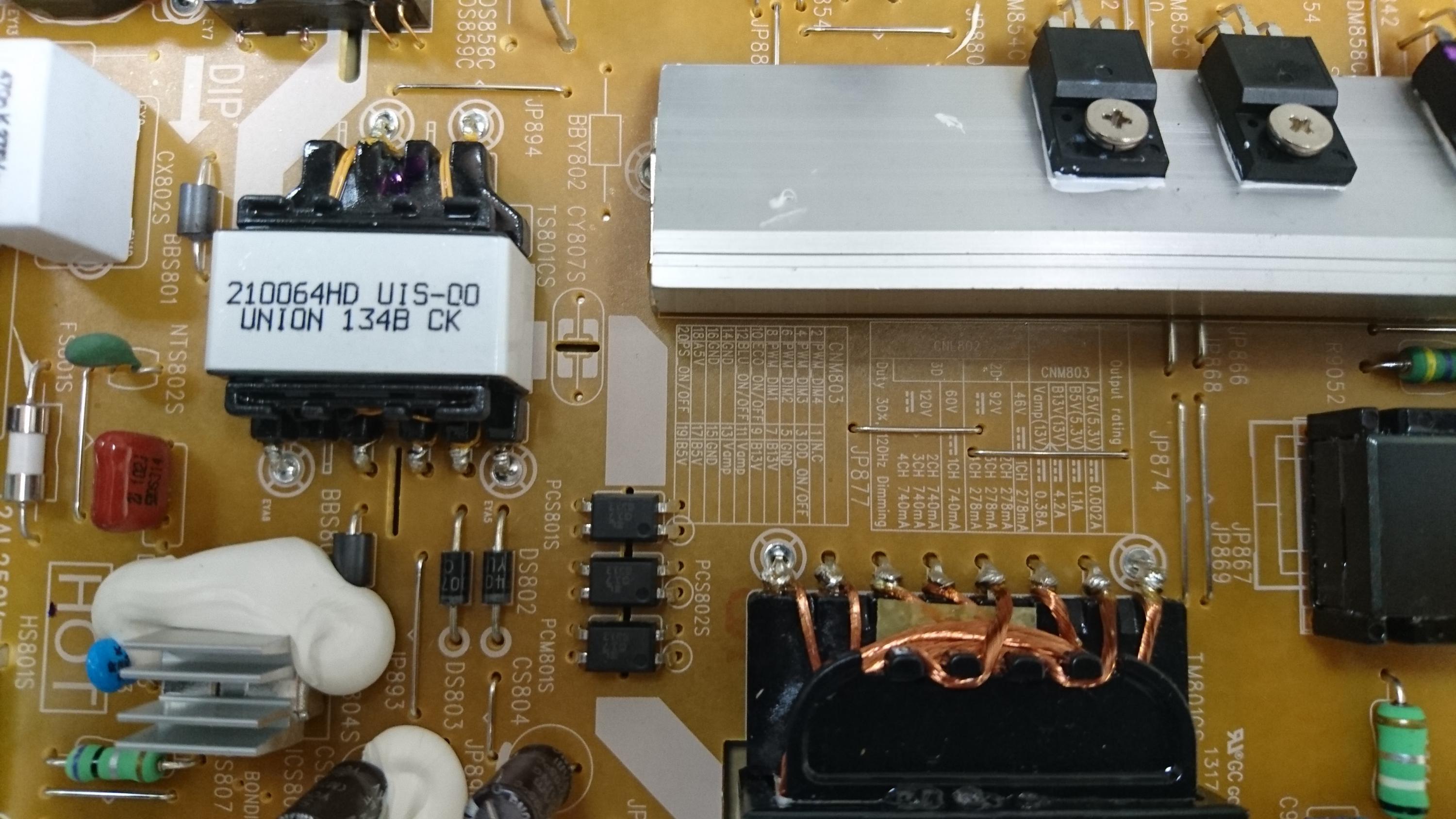

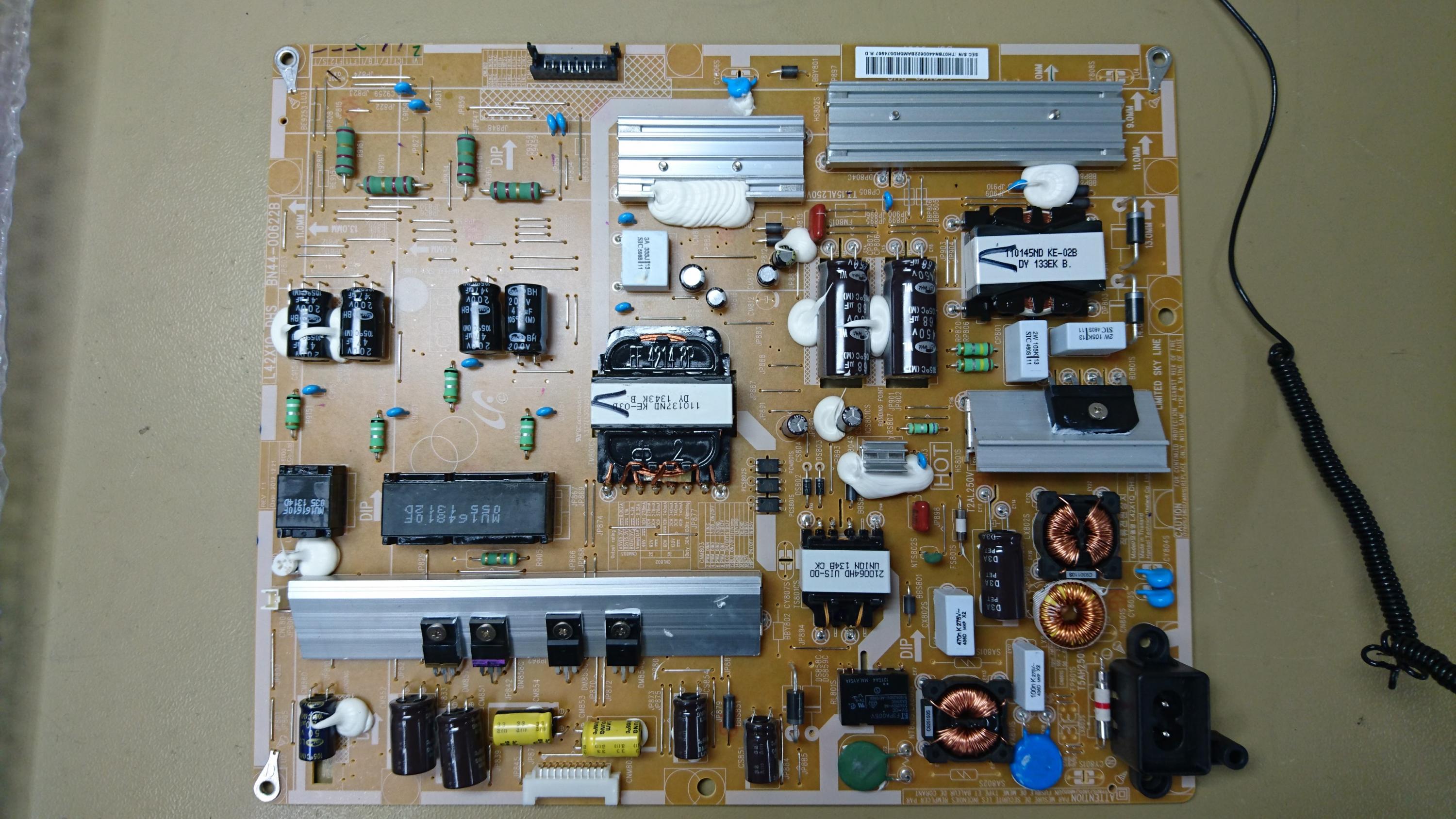

    I´m trying to fix a three year old Samsung LCD for a friend and this one seems a bit tricky for me. When powered on, the set starts up for a second, backlight (LED) lits up, OSD is displayed but just for a second and then turns off again. This repeats every two seconds until I cut the power off from the outlet. It´s the onboard relay of the PSU that "clicks".
    There´s no difference in behaviour if I disconnect the main board and/or the LED backlight, except that the cycle is a bit slower (due to lower PSU load I presume). To me it sounds like an overload protection that takes place and puts it into "hicc up-mode" .
    All the capacitors seem fine visually, however I have the proper equipment to both measure them and replace if considered necessary.
    Any ideas? I´ve made a brief measuerment on diodes and FET´s without any obvious signs of shorting out.
    Please see the attached photos.

        I would resolder all those transformer legs, the legs for the devices mounted on the heatsink. Inspect the connections really really well.

          Re: Samsung UE40F651 just clicks when powered on
          I´ve tested all the caps with a semi-professional Fluke tester with no remarks.
          Also resoldered all the Connections mentioned by you budm, no difference, none looked particulary bad either.
          The short half a second the PSU turns on I can hear a faint whine from somewhere on the PCB, like a high current and then enters a overload condition (??)

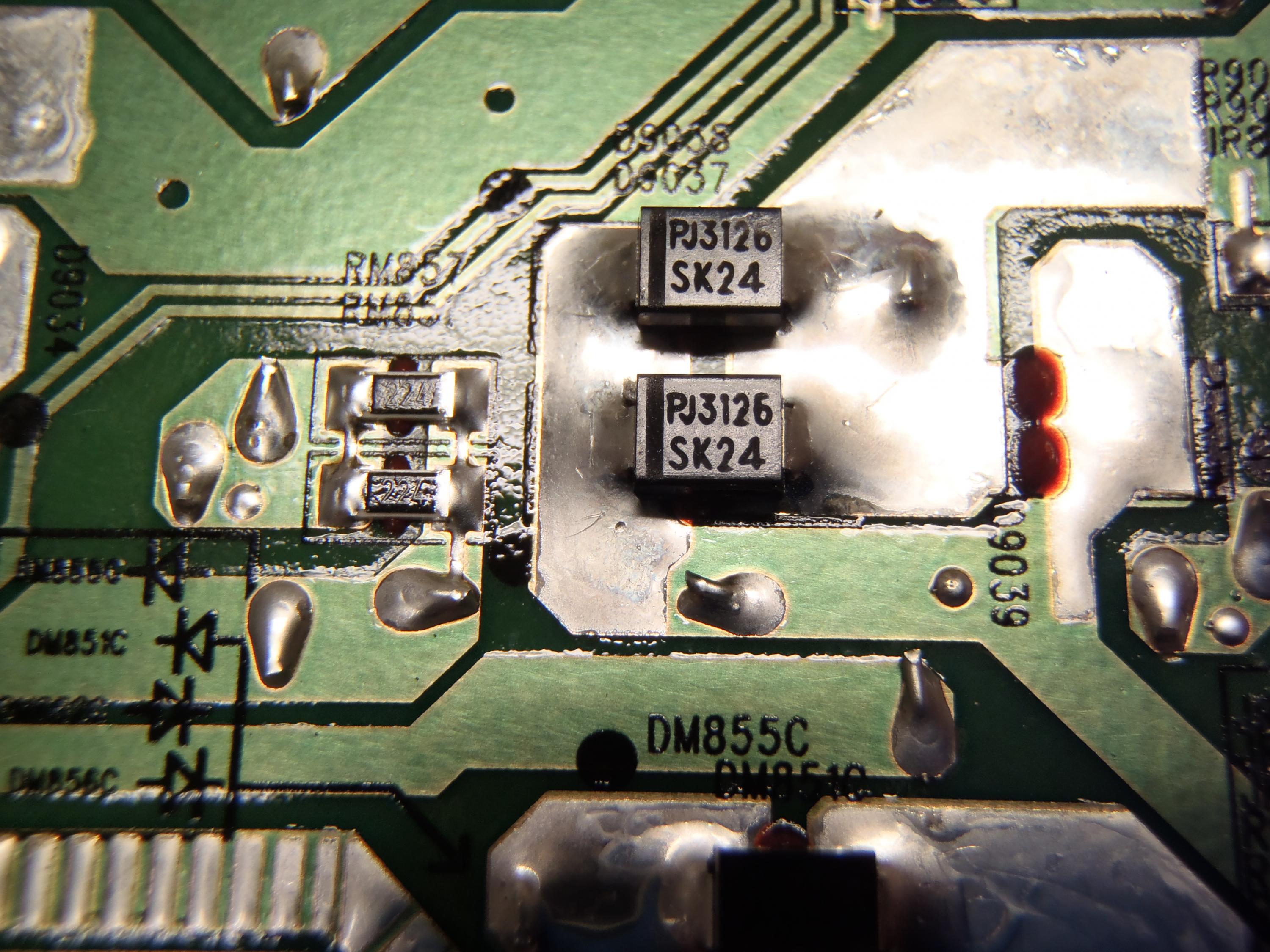

          The diodes in the first attached photo measures full continuity (in circuit, tried to desolder one but changed my mind). This also applies to the second photo.

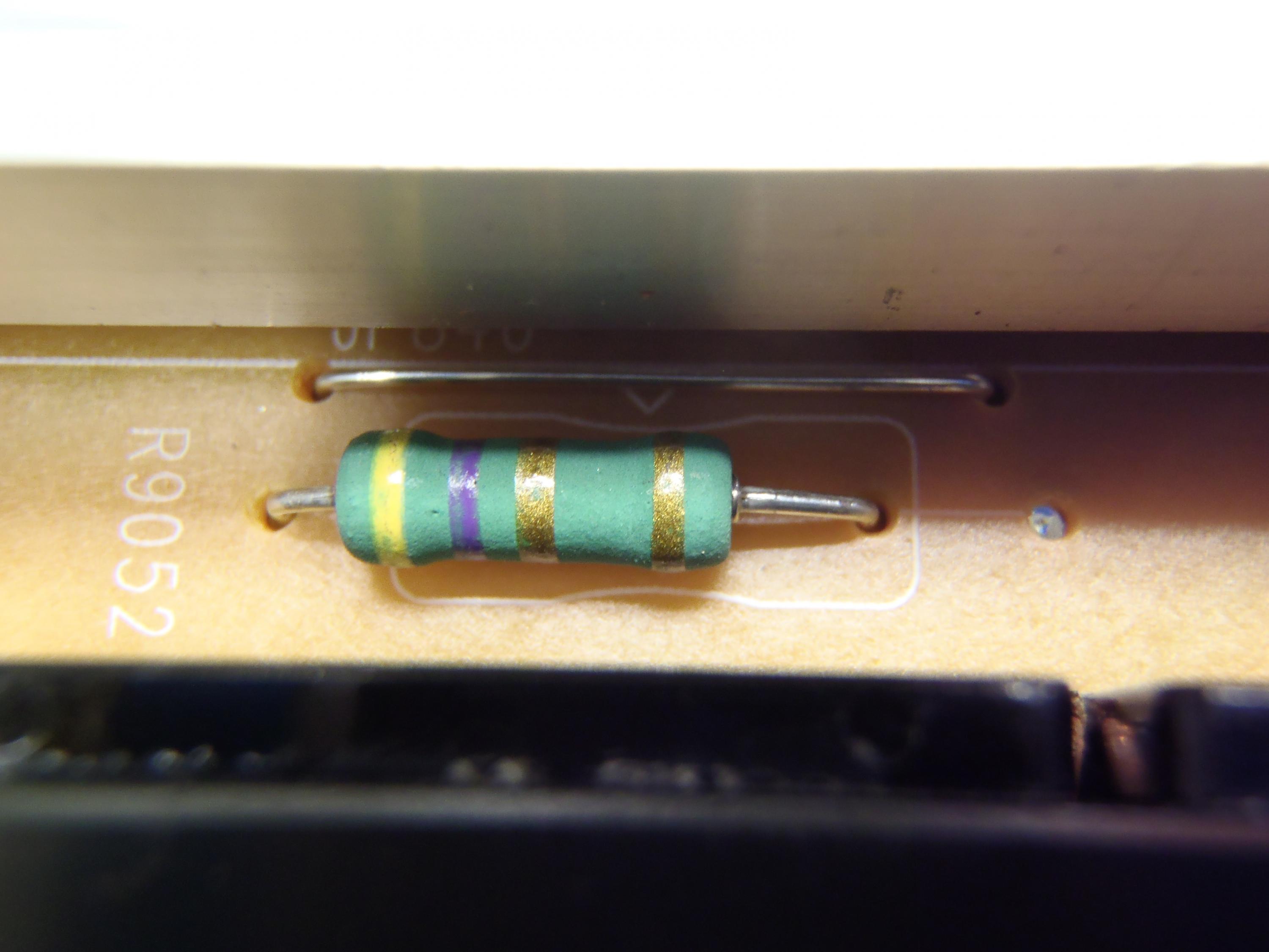

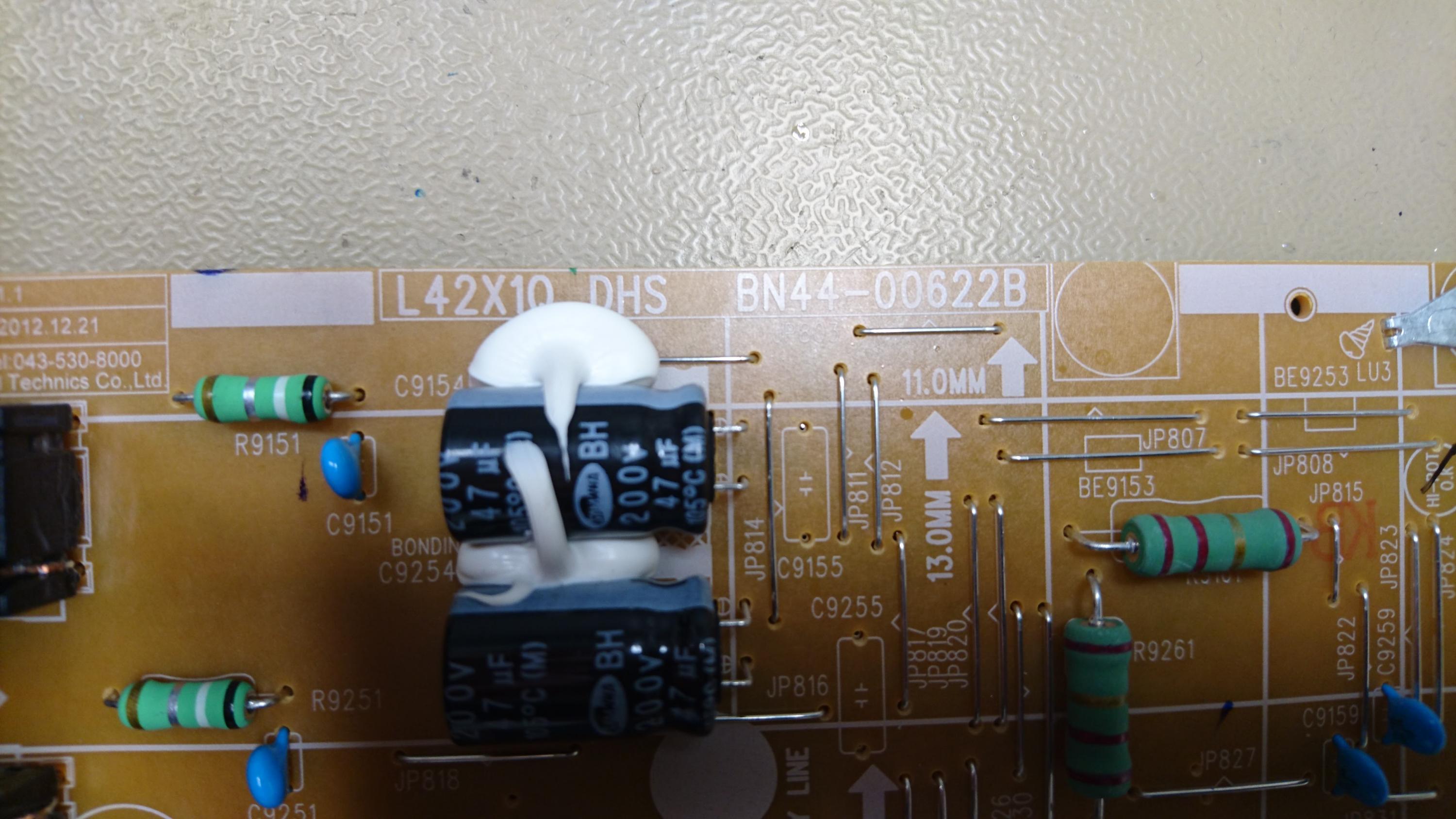

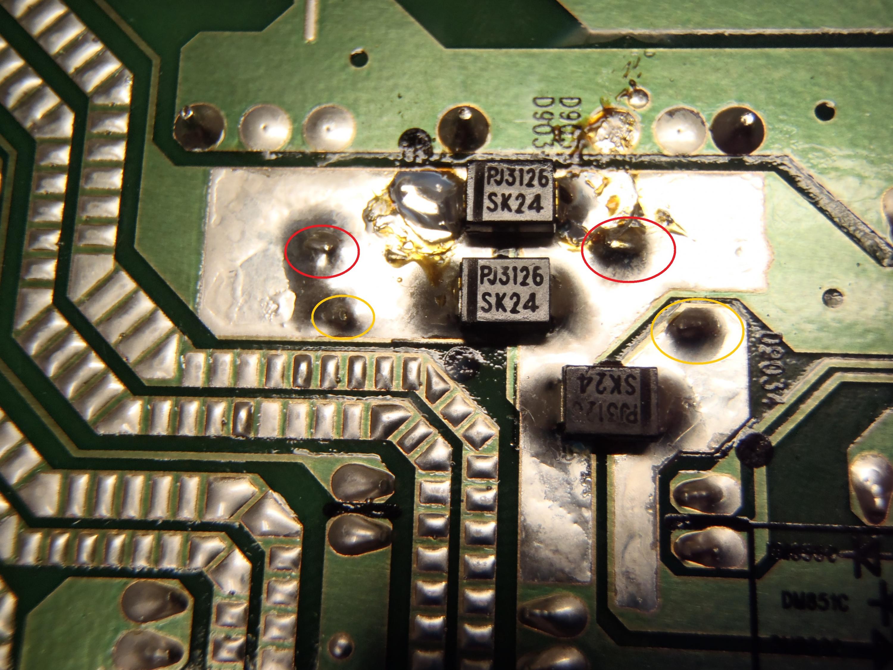

          The red circles indicate a resistor and the yellow ones a jumper/bridge (as seen on the third photo).
          Can shorted diodes be the cause of the problem?
