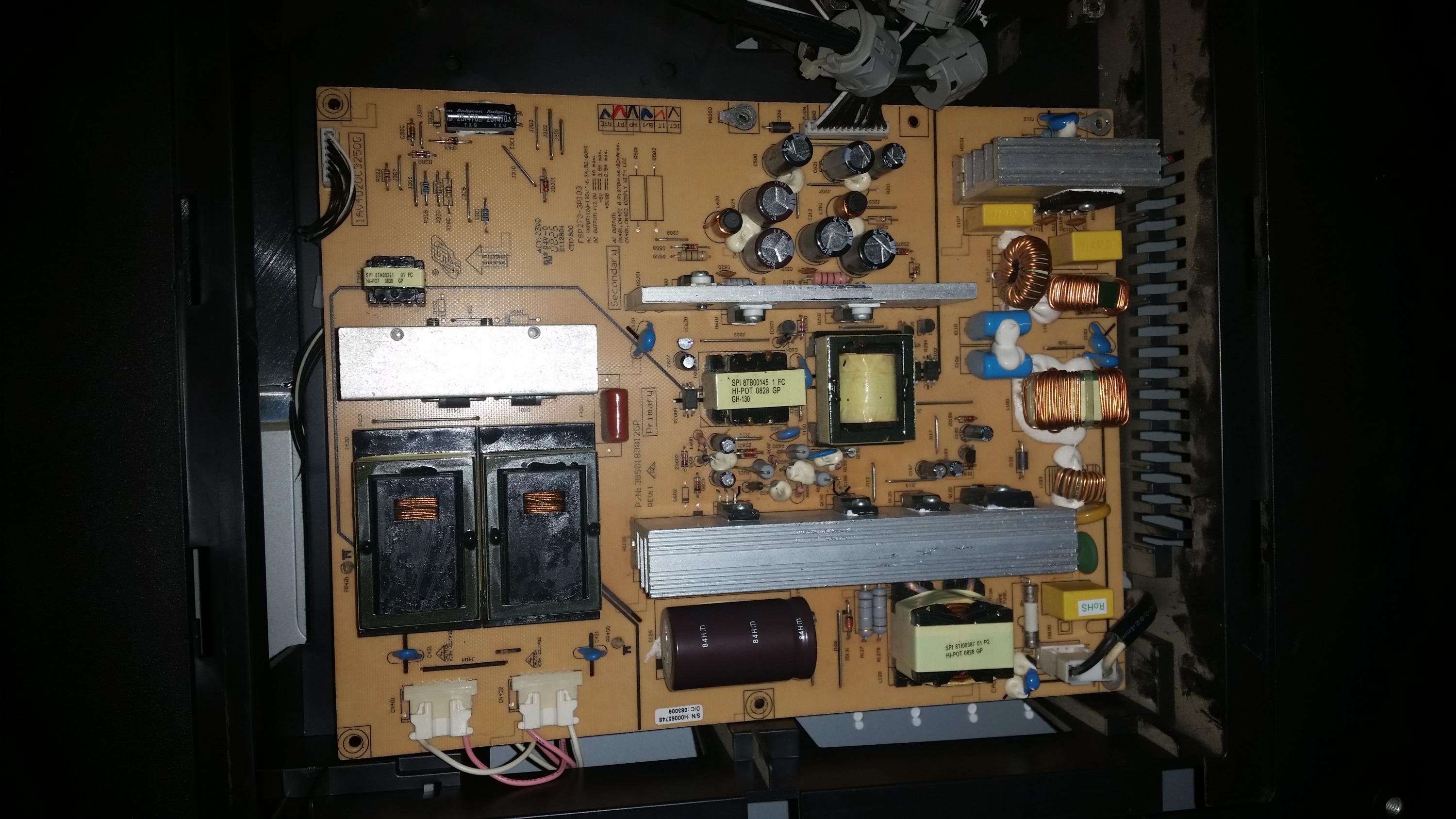

              Here ya go! This is the main board

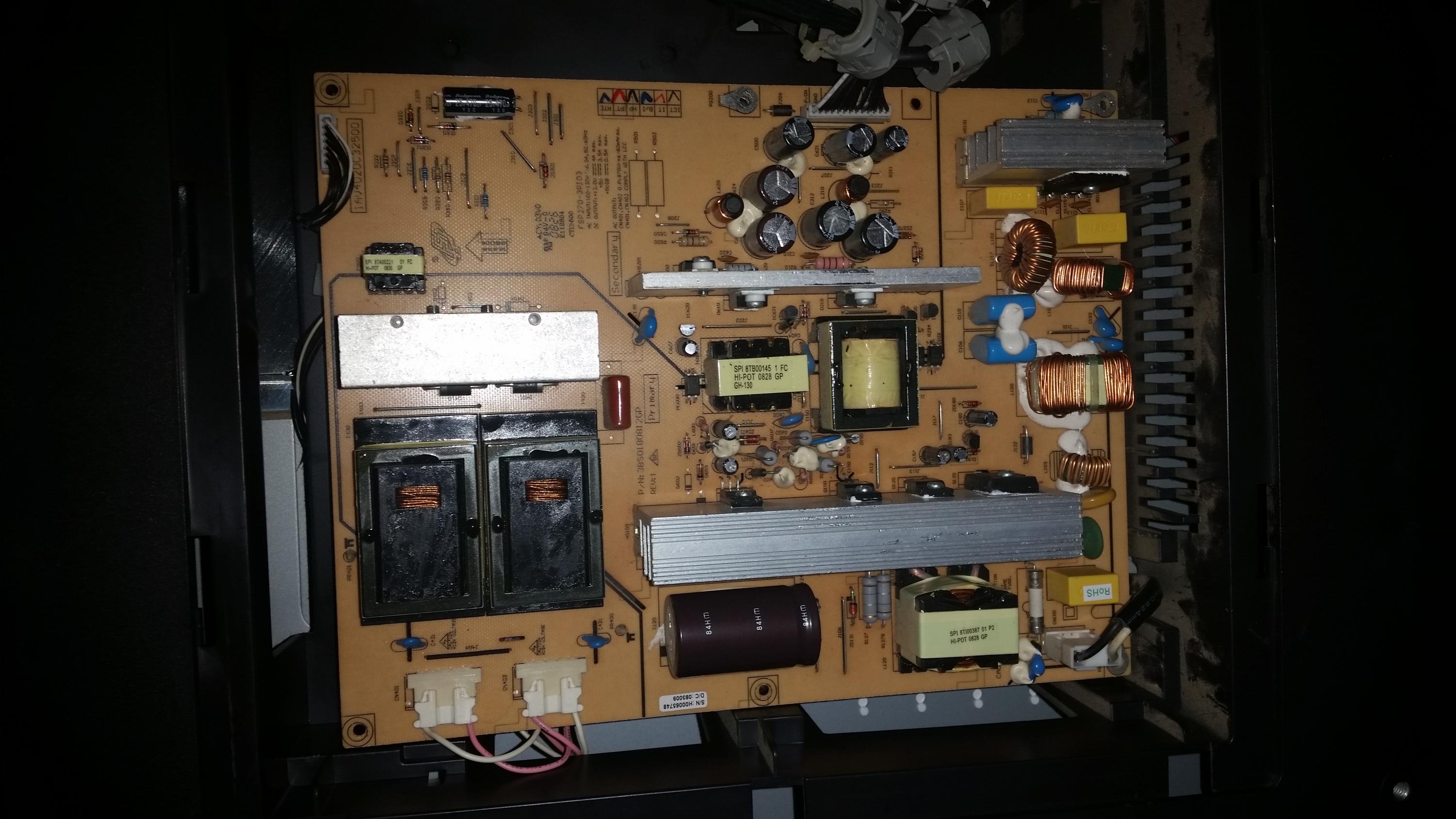

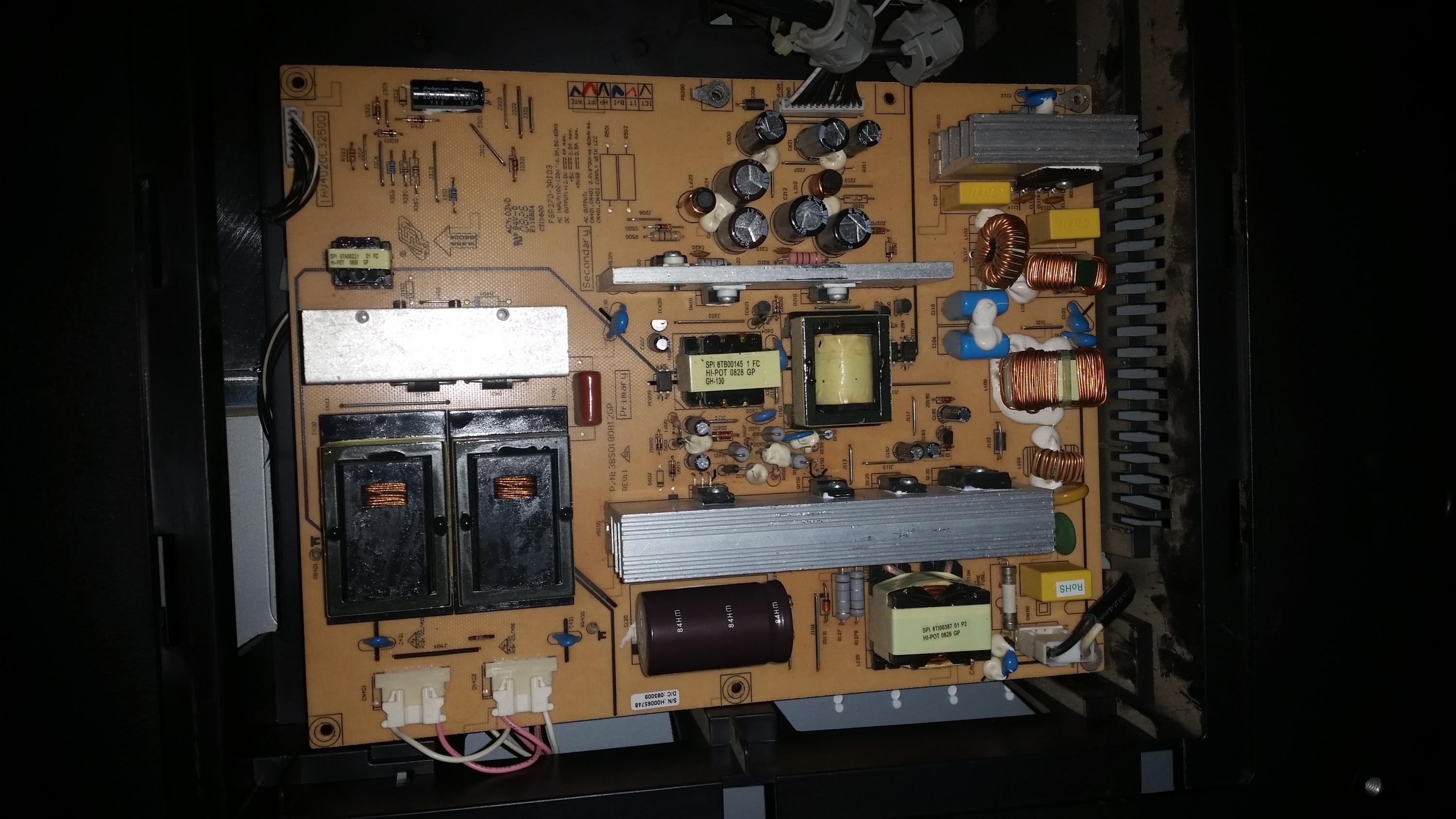

                Re: Sanyo dp46848 Power Surge Blues
                Also need the PSU. Just use the attach function next time. Other than that it takes to long to load and all that scrolling.
                  This board was bought used and replaced. I still have the original somewhere, but this one is a new used that is guaranteed to work for 60 days
                    O.k. on top of your PSU there is a ribbon cable plugged in. Note down the pin out names and measure the DC voltages on all the pins while the TV is on and off. That will tell us what going on.
                      I think you may be better off with the original PSU board if you are going through the fault finding exercise. As CapLeaker has asked, if you can list the Pin Names and what voltages are read on those pins would be a good starting point.
