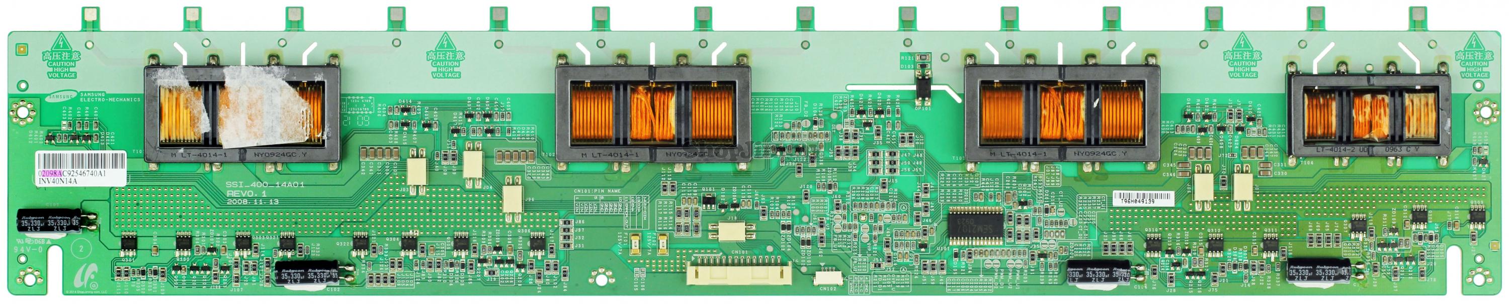

                      Re: Toshiba 40LV664D - No picture
                      Also need to read 24vdc at both ends of the SMD fuses on that inverter board.
                      You should remove that metal shield to get to the Inverter board.
                      It is probably similar to this one: Samsung LJ97-02098x.
                      Pictures provided by shopjimmy.
                      • h0ffman
                        • May 2013
                        • 20
                        Looks identical!
                        The SMD fuses I'm guessing the two small blocks next to the power connector? one of them reads 24 from both side, the other doesn't. I'm guessing one is blown then?
                        Edit: in that photo, just off to the right from the connector.
                          Yes, one fuse is blown can be due to shorted out power MOSFETs that reece was referring to. The board is only about $25 in the US.

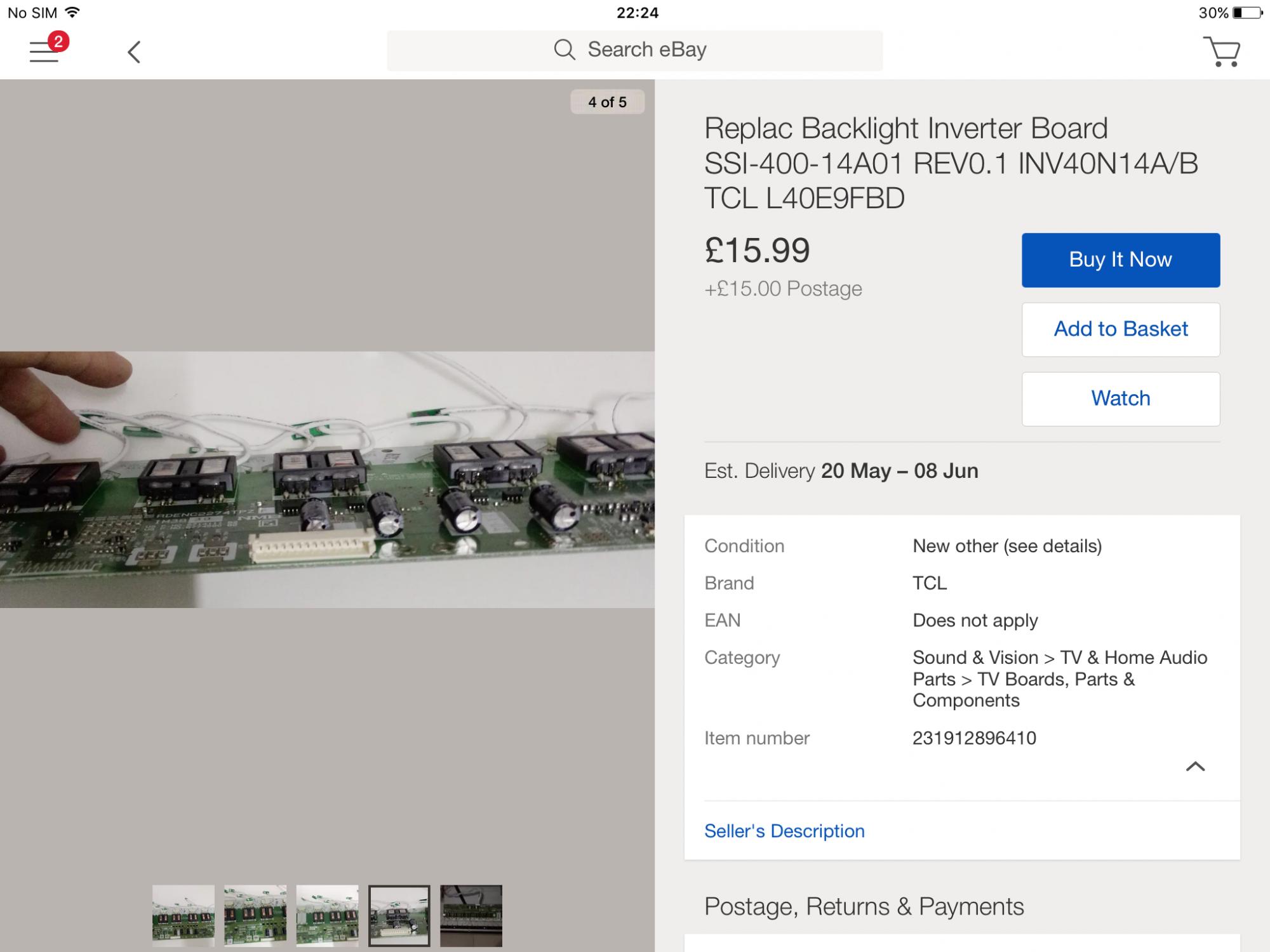

                                      • ReeceyBurger123
                                        Never Give Up !
                                        • May 2014
                                        • 7325
                                        • Britain
                                        What ever you do dont buy this board lol
