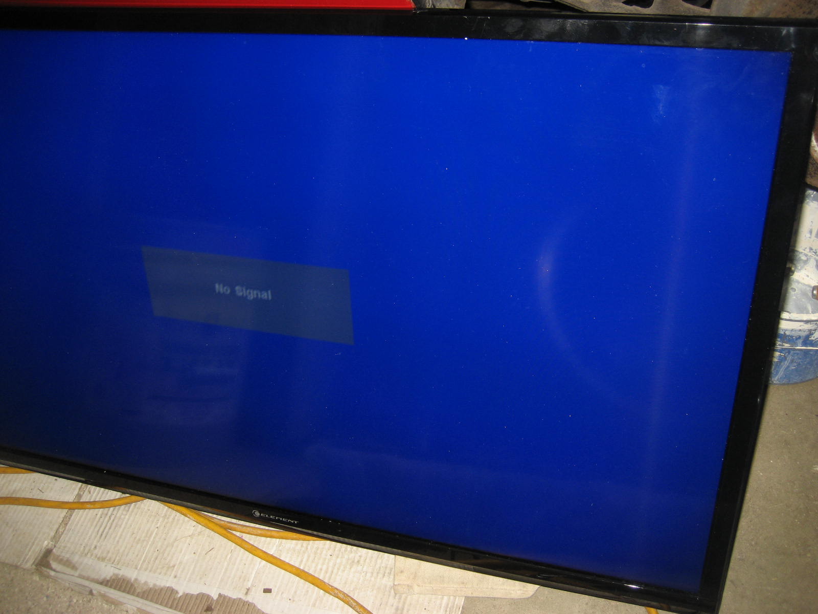

    Just picked this set up. It fires up perfectly, but after a few minutes it begins to develop vertical lines down the screen. After a few more minutes the picture goes completely black. Caps look fine, don't know where else to turn with this.

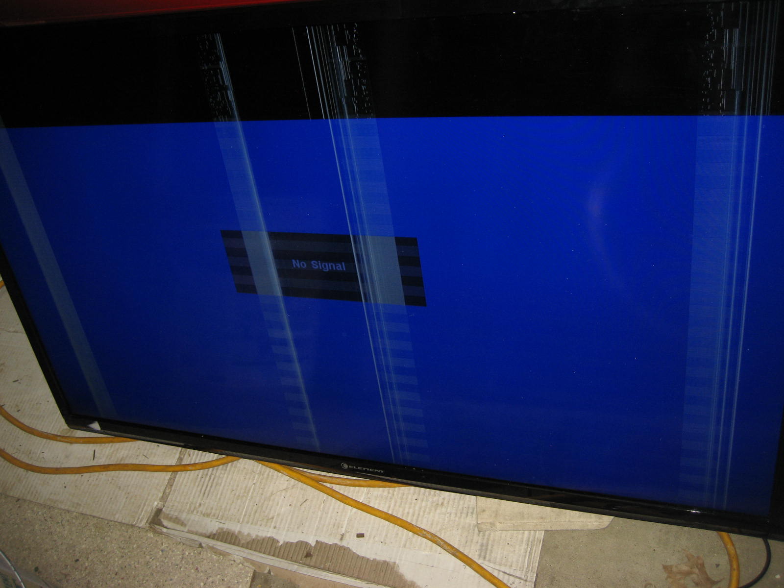

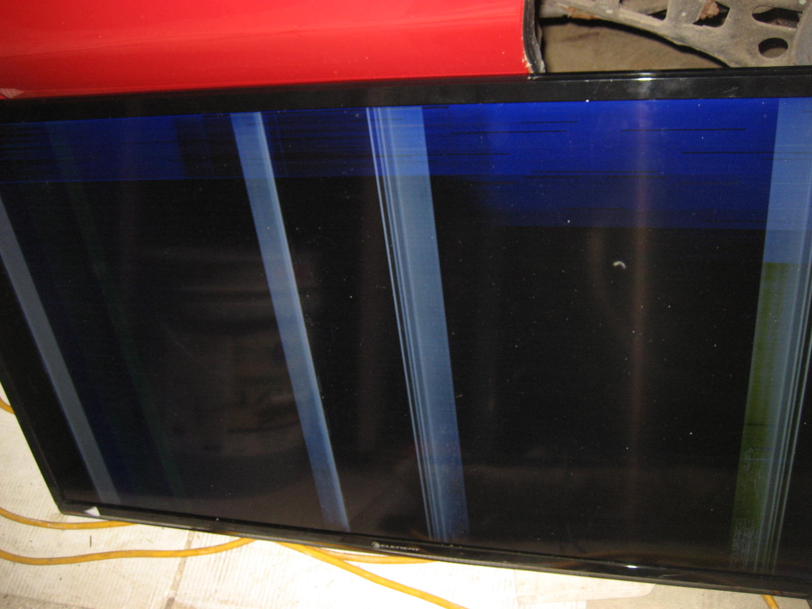

      Pics. It starts off cold just fine. After a very short time it develops faint vertical lines. They get worse, and then things become unpredictable. The screen goes back to normal, then striped, then checked, then black. Unplug it, let it sit for a minute or so, it's fine, then it starts over again.

          Did you try flexing the screen a little, squeeze or tap that plastic around the frame already? Either that and or clean the between the main board, Tcon and the LCD itself.

                  Ahh its one of them slim ones with gate in glass Lcd drivers. Thats a panel fault and wont be fixable I dont think sorry
                  You can try heating the mainboard in the Tv and other boards to see if the problem occurs quicker. Let us know if anything happens if you do.

                    Work has been keeping me running crazy, just plugged this in again a bit ago. I'm having trouble believing it's a panel fault though. The thing starts fine, and today I brought up the menu to see if it was affected. Not really, but it inverted, upside down and backwards, then the control buttons wouldn't respond. I really hate to dump much money in this, as I have way too many tvs sitting idle already, but I might if there was a decent chance to bring it around.
