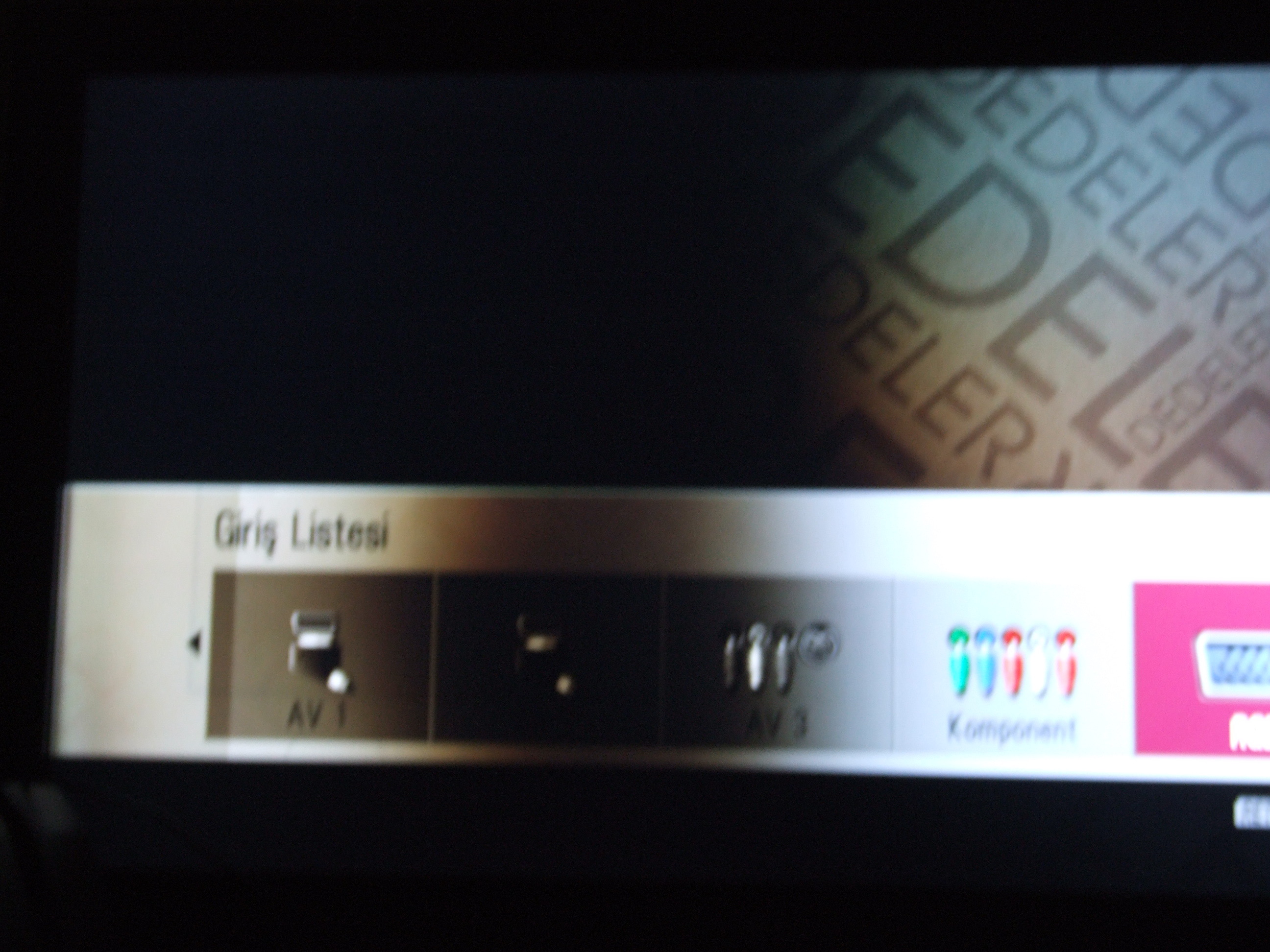

            Re: Toshiba 55HT1U LCD No backlight in section. Has sound and image.
            Can you post the pictures whole screen shot?

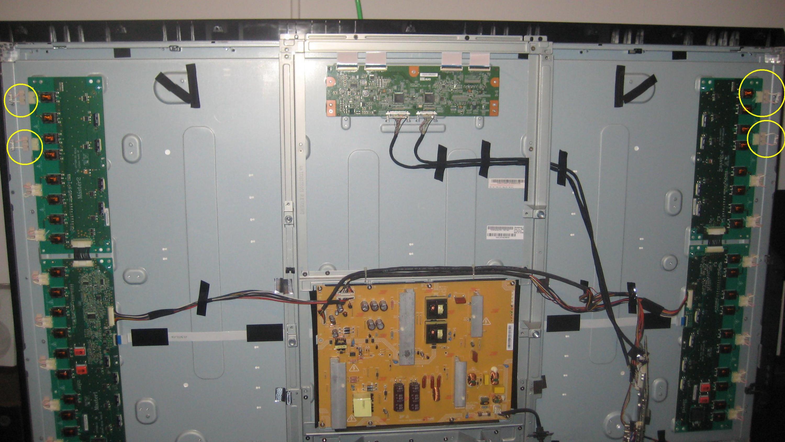

                It appears that the backlights inverters are made up of 4 boards. 2 boards on either side of the screen.
                I can't see how failure of any of these boards could result in just illuminating the centre of the screen?

                    That is why I asked to see the pictures of the whole screen, if one inverter is not working, the half of the screen will be lit up but not in section like that as shown on the screen.

                            Ok, I did more troubleshooting unplugging the lamps and I found that if I leave the top 2 sets of terminals on the master and slave boards unplugged the tv will attempt to boot and this gets rid of the center dimming, although now there is a horizontal section across the top that is now obviously dim. My gut feeling is that the problem has to do with the circuit for the top sets of lamps.
                            I also do not understand how the master slave setup works. I can plug in a master without the slave, vice versa and whatever side that is plugged in, I will get illumination from that side. I thought the M/S needed to be plugged in as pairs. Do the lamps span from one side to the other or are they 'U' shaped?

                              It is the push-pull drive circuit due to the long length of the lamps. I am still waiting to see the screen shot of the whole screen.
                              When you have only one inverter on one at a time, half of the screen will only light up. I cannot see how you can have all the lamp not lit up in just that section of the screen to produce that dark vertical band.

                                Try doing what BUD ask you.....this is no lamp fail...cfl lamps can't work just half way....if a lamp fails tv would ether not turn on or in some cases will flash and turn off while u can see picture with pointing with a flash light at screen to see picture......in this case am sure it's a panel problem tab bonding..

                                    According to previous threads on this set, Toshiba issued a recal because of inverter board problems.
                                    Does anyone know what Toshiba's repair comprised of.
                                    Also, to see some of the damage due to overheating on some of the interconnecting cables leaves me wondering why not all the sets were recalled.
