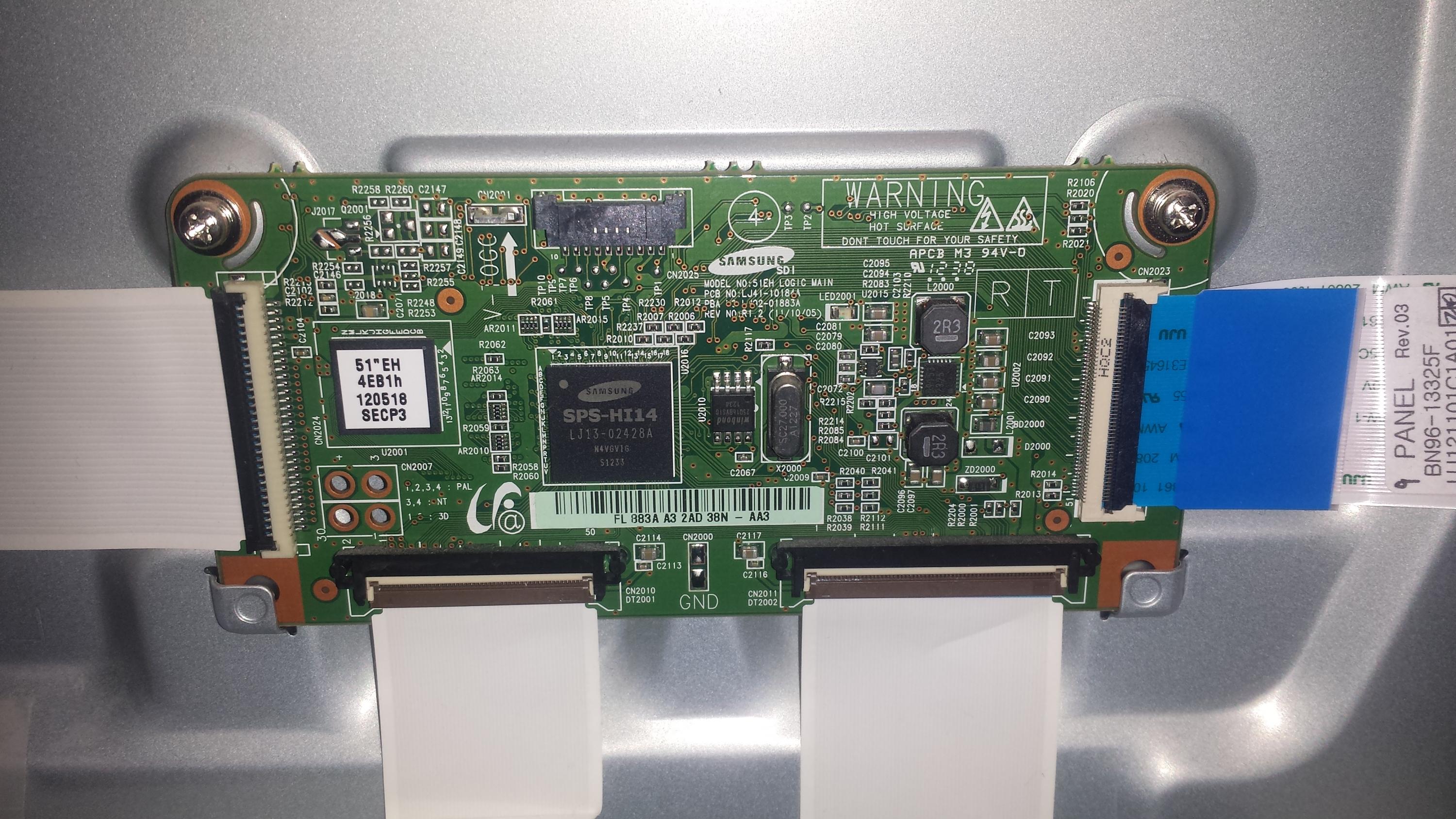

    Hello everyone.
    I have a friend samsung plasma tv with no video.
    Everytime when turns on, show very bright backlight for a second and the tv keeps on but with no video.
    I already check the vs,va and show voltage for a sec and drop.
    Something weird is vs show 250 volts when according the panel need to be 203 volts around.
    The x and y board doesn't show a shorts.
    Even the buffer show good.
    The logical control board show blinking light every 3 seconds.
    I don't know what is the problem.
    Any help can be appreciate.

    Re: Samsung pn51e450a1f no video
    the red light at front blink 6 times
      Your Vs wont be that high your measuring it wrong because the Tv would shut off if so. Have you tried running the test patterns ?
          So the screen stays lit up grey (not backlight called prime glow on Plasmas) but you dont get the test patterns when you jumper the pins on the control board ?
          • crdz66
            • Nov 2012
            • 242
            on control board can't find the pins for run
            no backlight
            it turn just for a sec (bright white) and keeps off or grey.
            the test patterns I try to running from remote control, you know mute-182-power on
