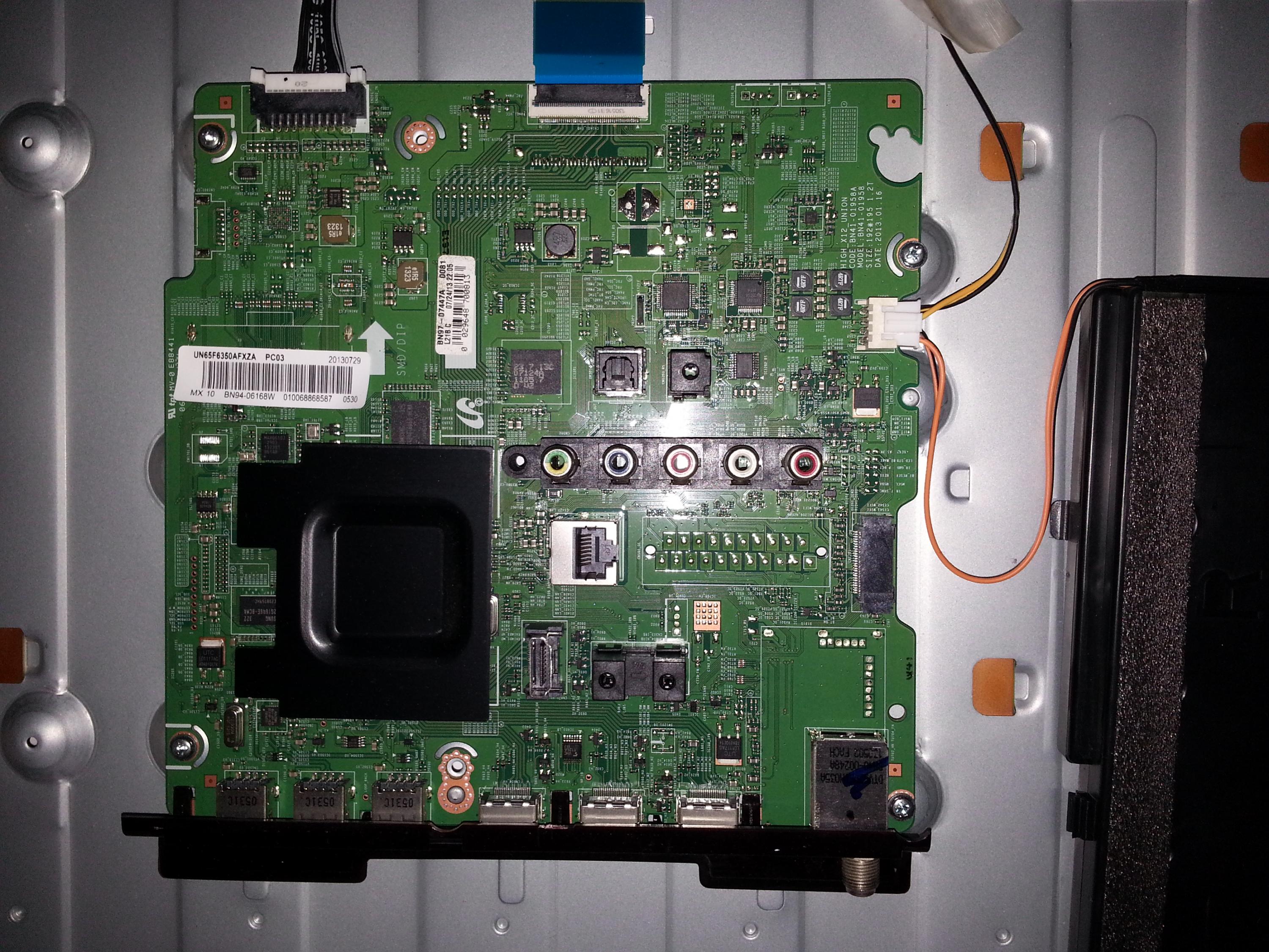

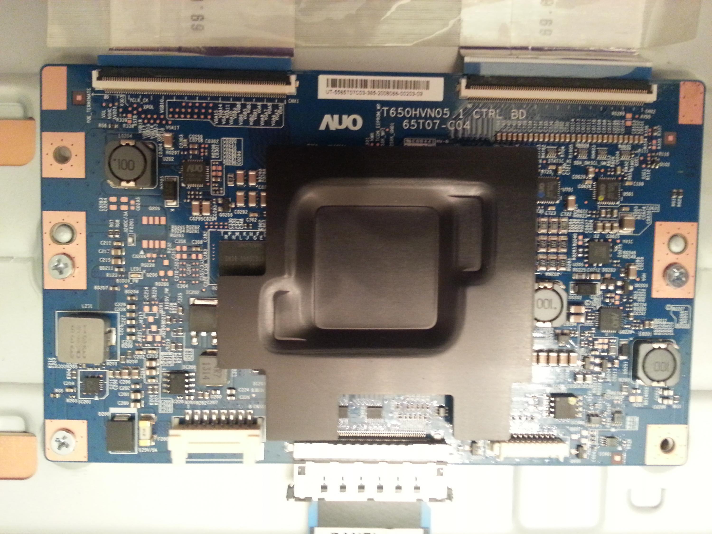

    Bottom half of tv is dim and flickers. Self diagnostics had TCom board as ng, replaced it but no luck. Seems to be a backlight issue. Is this the power supply or main board or backlight circuit. Any help appreciated.

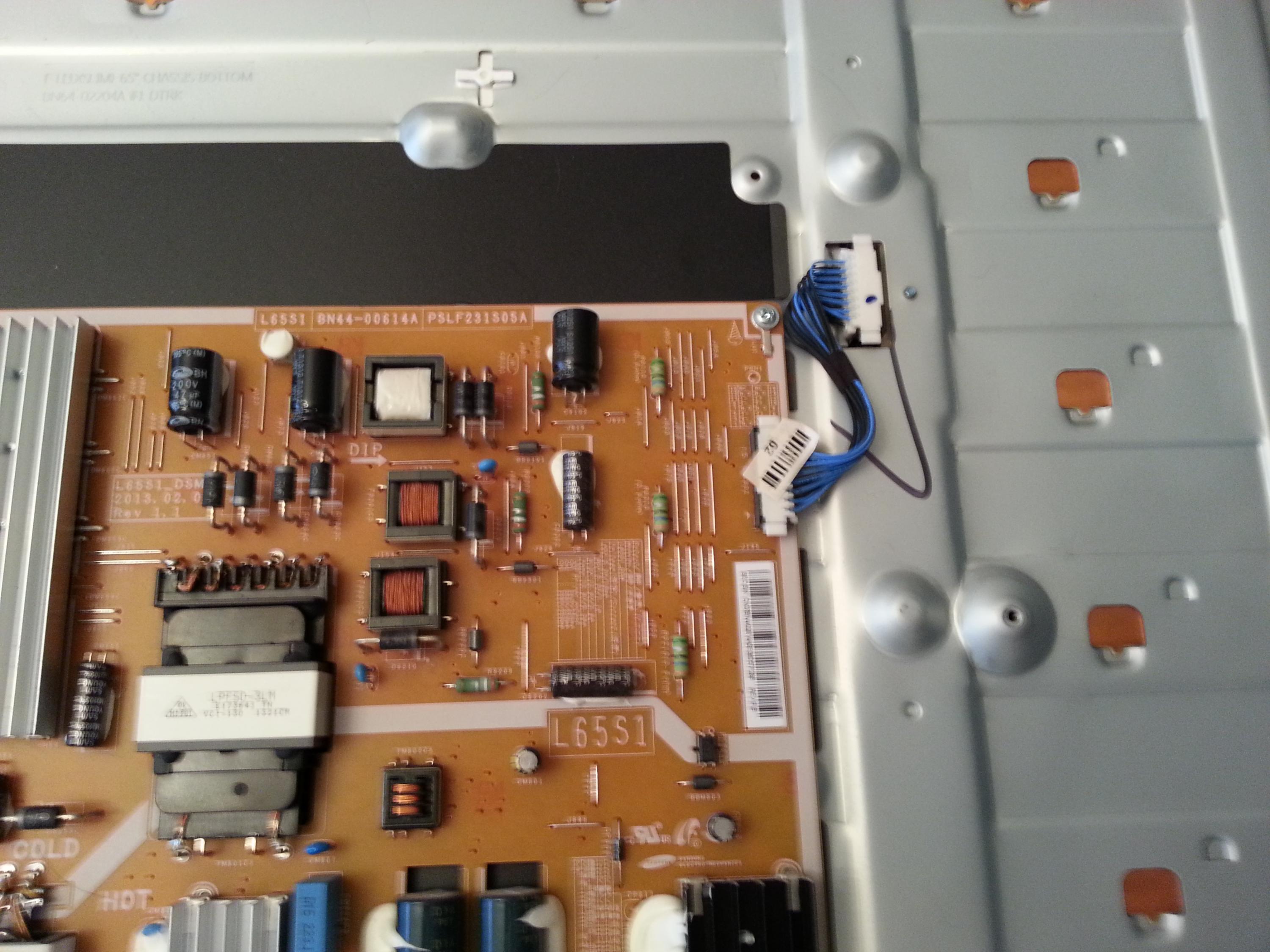

          Changed out power board no luck. I am not sure how to get at backlight. Do I have to remove screen.

                                Right now have it completely apart. Reconnected power board and Main board and the bottom half definitely flicker. I thought to test to see if its actually the led's was going to try the bottoms on top and the tops on the bottom. Any other suggestions since I do not have any testing equipment.

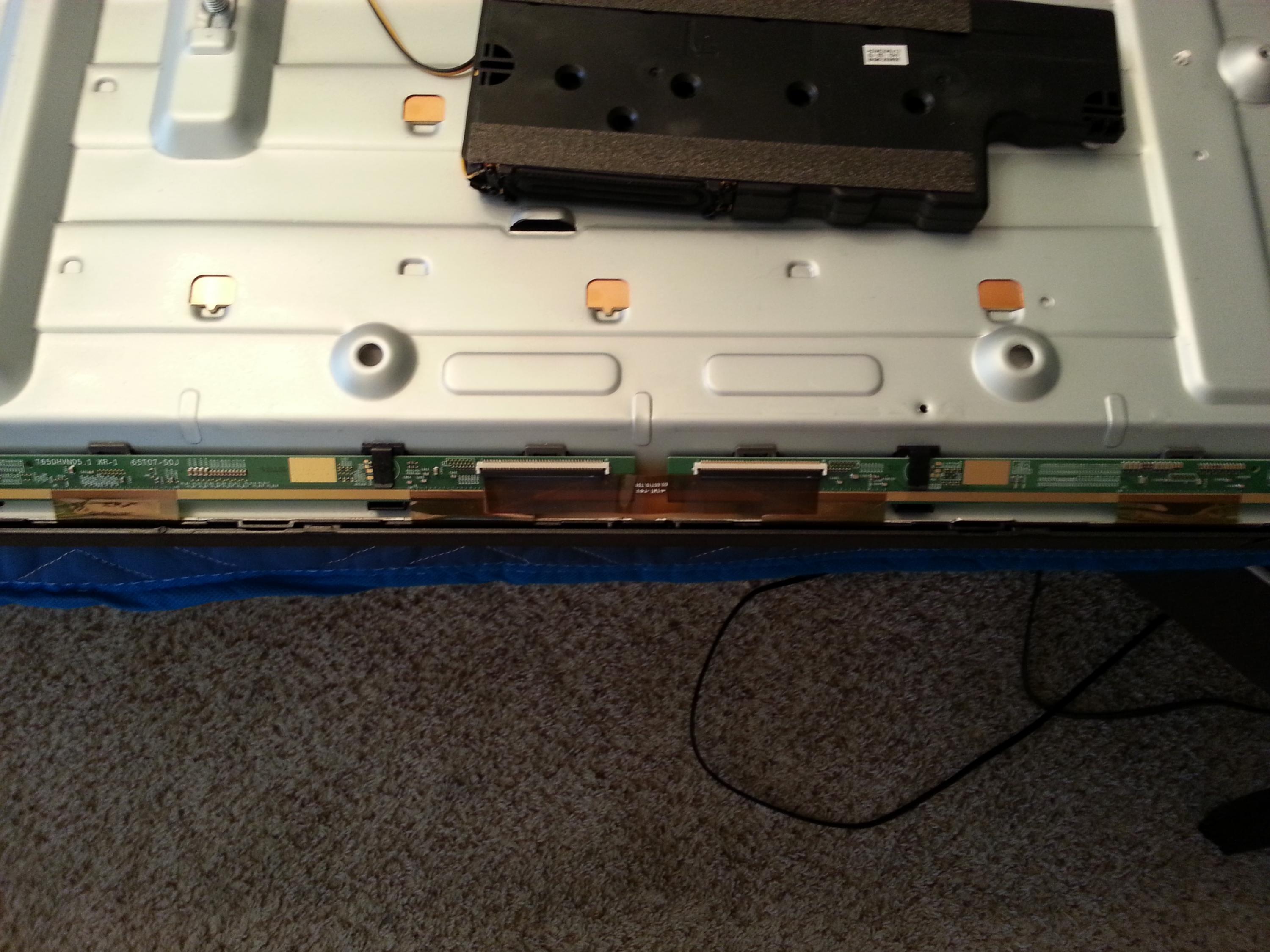

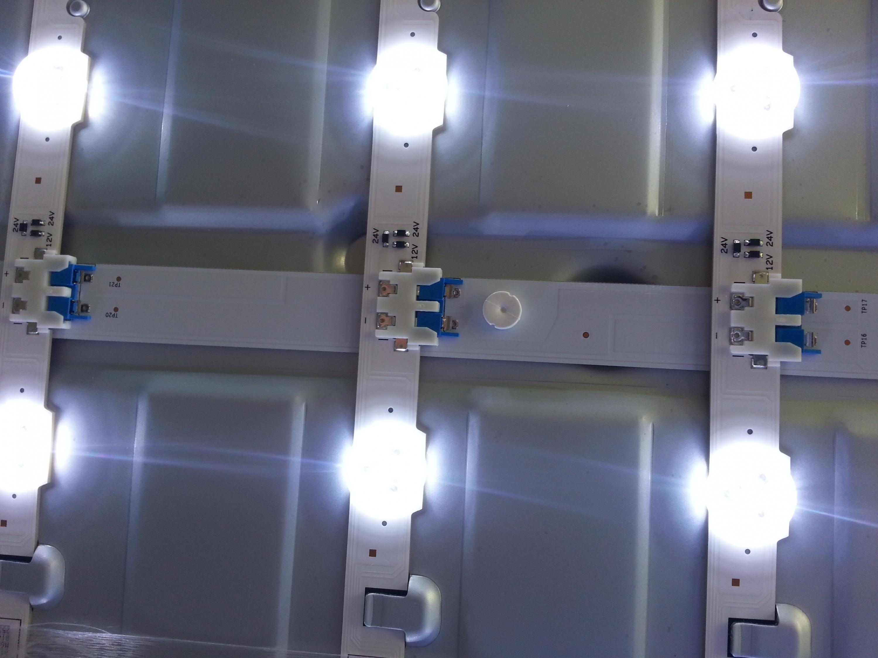

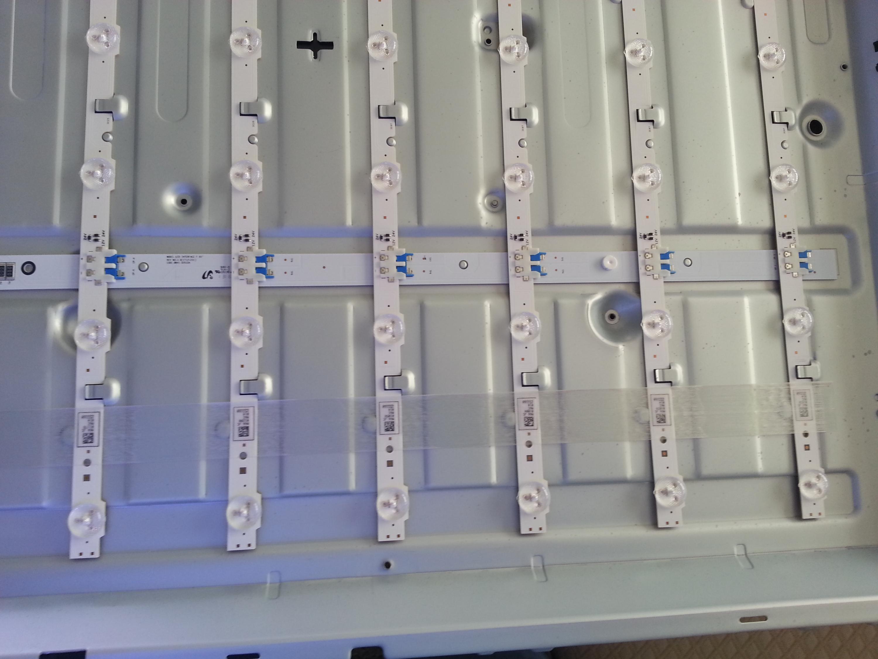

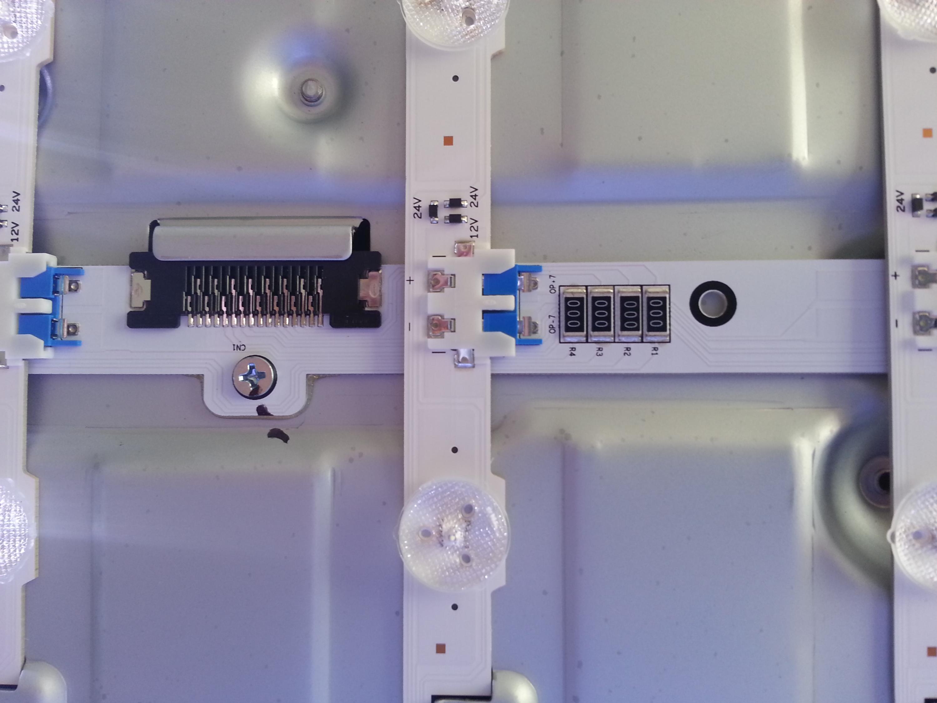

                                  Can we see the pictures of how the LEDs are setup?
                                  • moandkaren
                                    • Apr 2016
                                    • 16

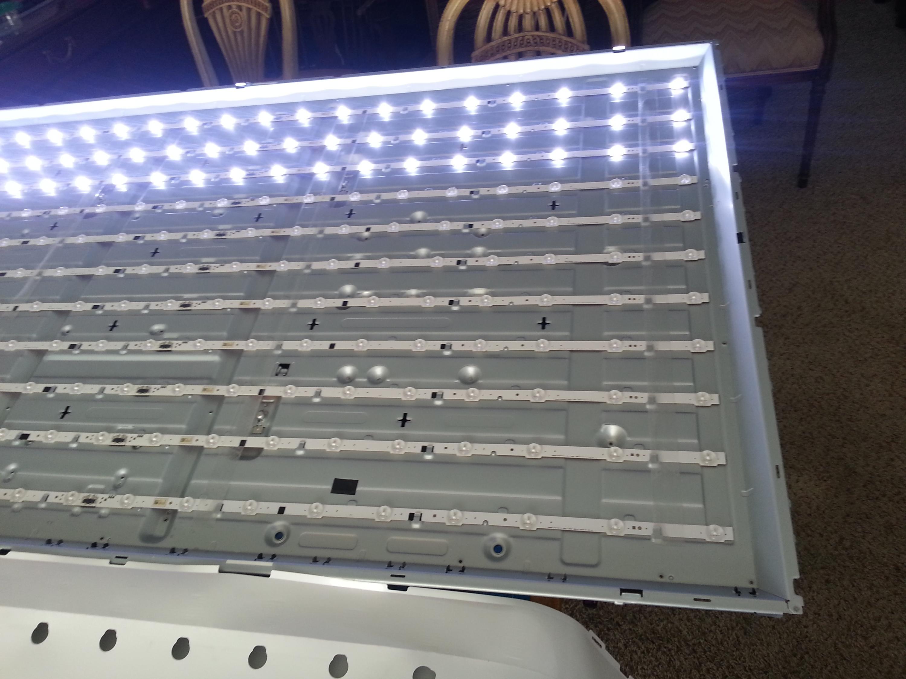

                                    Re: Samsung UN65F6350AFXZA
                                    A little more detail top 3 rows light, middle 3 rows are dead, bottom 5 flash.
                                    Middle ones need replacement? attached photos show connections and configuration
                                      on closer inspection, the bottom 5, one row only has half blinking
                                      • moandkaren
                                        • Apr 2016
                                        • 16
                                        Well I think I got it. Two left and one right are out. I am having a dickens of a time finding replacement. Need two 2013SVS65F L11 and one 2013SVS65F R9. Any suggestions appreciated.
