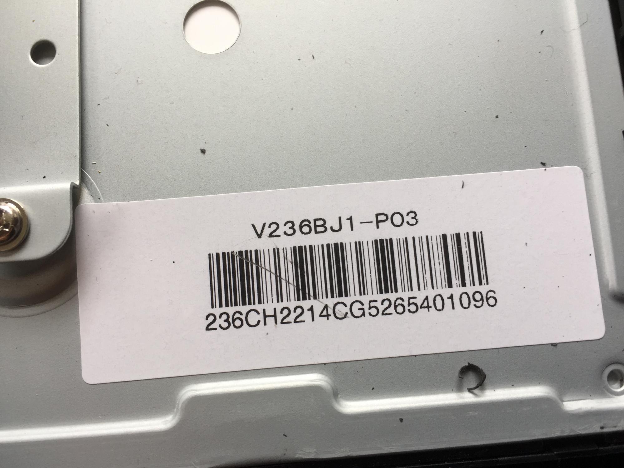

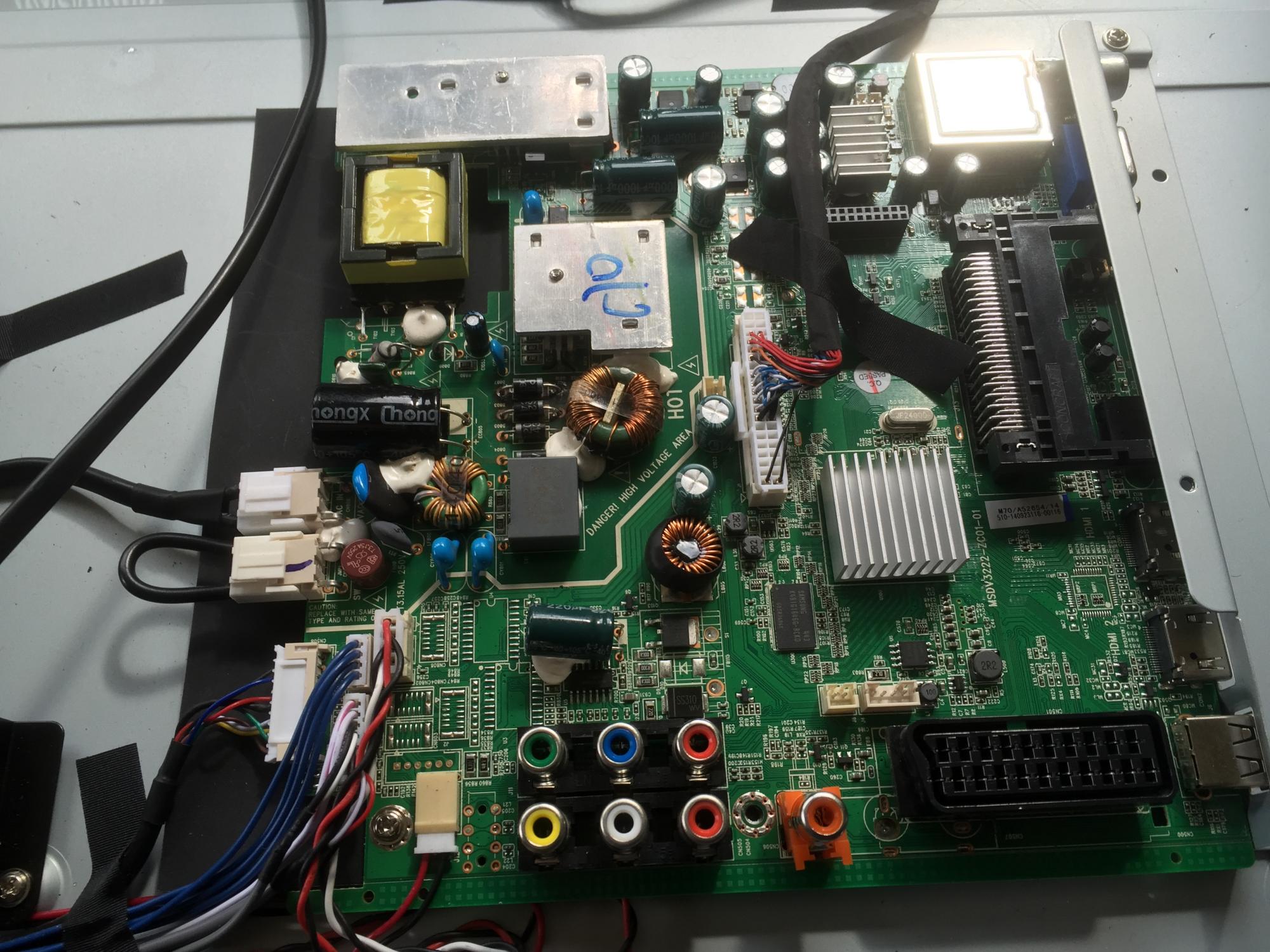

    As you may see in the pic , the Main cap went pop and took 2 diodes with it, replaced them but still dead.... My Wuestion is my screen model ends 03 but there are some boards available for screens ending 01, the rest of he numbers match fine, will it be ok to try an 01 ???

    I can't help there but did you check the mosfet under the heatsink alongside the large cap.

      Did you check the fuse ? Also what screen even is it for a start ?

          Here it is, if you mean plug fuse , yes , it had blown , if you mean board fuse, I'm not sure where that is , any help please on how to test anything else on this board is appreciated

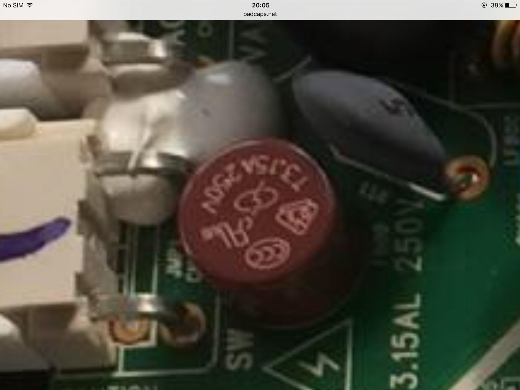

            Its a red ceramic type of fuse will screen shot it.

              Here it is, the red can looking thing test for continuity across its two pins also test the black thermistor next to it looks blown to me.

                Thank you guys , I never thought was a fuse, I will test tomorrow and get back. I will be pleased as punch if it is ....

                    I found a fuse on a similar old board, and hey presto, so after a new Capacitor , 2 x2 amp diodes in the rectifier line and that fuse it's alive , thank you, I have learned more today, when I asked for help on this board to my colleague, he just scathed, these all in one boards are rubbish, throw it ..... Maybe true, but it's not the attitude is it,
