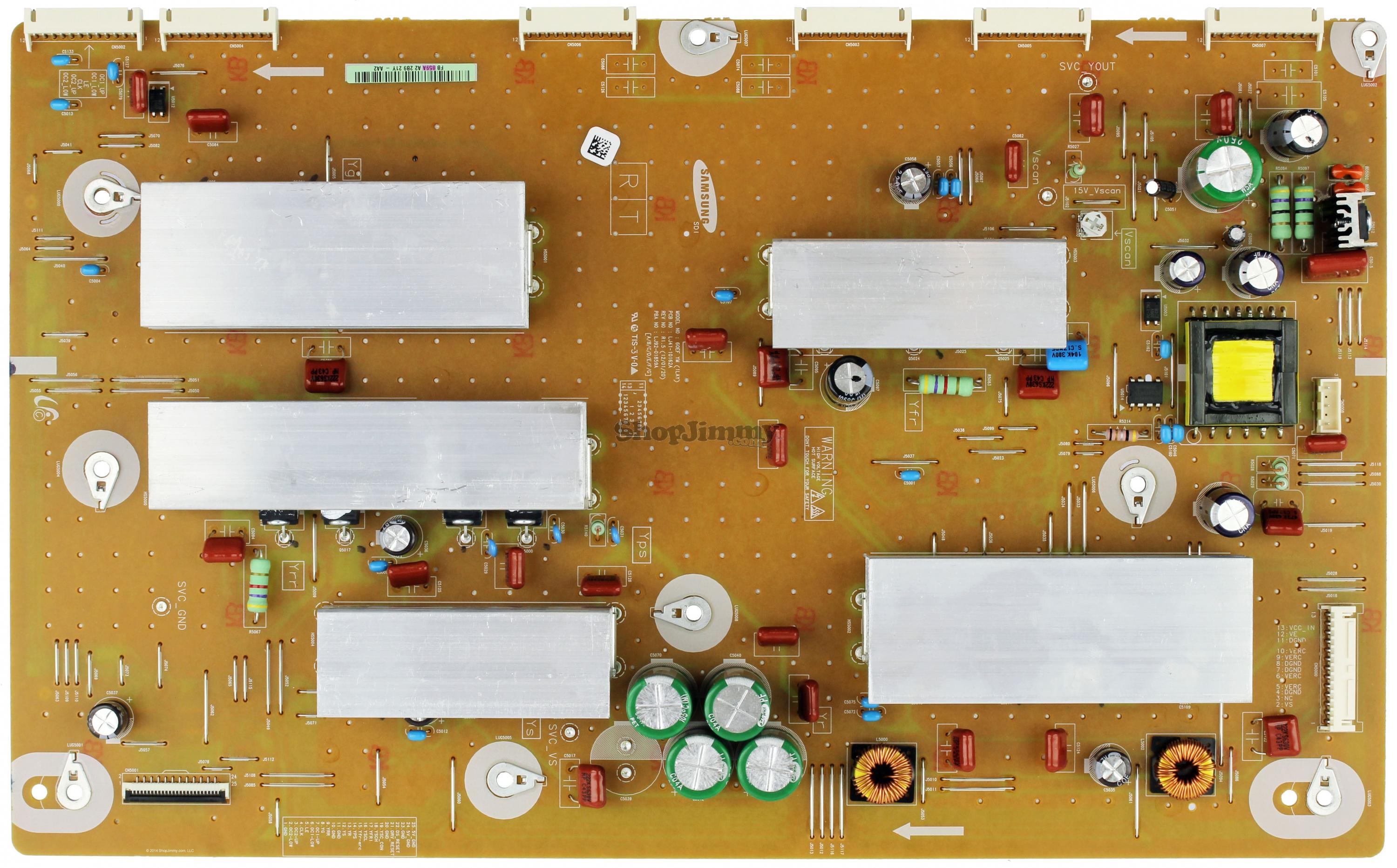

    this tv power's on normal with sound but no picture or even a glow.
    the logic board has a 6 second blink.
    both y buffers tested good.
    power supply voltages are good.
    y main anomalies:
    i tested all diode quick and think they are all good but will go over it again.
    the big green resistor (R5083) is open below the pic ic (U5014).
    the two green vertical resistor's(R5028) (R5029) to the top right of the pic ic are open.
    the one vertical green resistor (R5027) to the left of pic ic is open.
    the vertical green resistor (R5140) at middle bottom right of pic ic is open.
    the big bottom right resistor(R5067) is open.
    the two big green resistors (R5084) R5097) at top left are good.
    the pink resistor (R5214) one near the pic ic is good
    the 2 fet's (RJP30H1)that are shorted at (05004) &(05005) to pins 1&3 are shorted to ground screw but not each of the three.
    the other fets to the right with same number do not show these anomalies.
    my pic ic at (U5014) only has 7 legs and the one someone recommend's using ICE3b0565with 8 legs for the repair.
    i will need the specks on the 3 106 blue caps at (c5162 (c5046) c5160)
    these are my y main board numbers.
    sicker no: (JB 859A A2 29M 1l9-AA2Z)
    model no : 60ef ym (1LAY)
    pcb no: LJ41-10162A
    rev no: r1.5 (12/01/20
    pba no: LJ92-01859A
    is this the same version of board that is repairable with the 3 blue caps and ICE3b0565.
    even if mine are good i would like to replace them because they are know to go bad.

            i can get real pictures of mine later but this on one shop jimmy is identical.

              R5027, 5028,5029, 5140 are all standing so cannot tell what value they are.
              R5083. If Yellow, Purple, Red, Silver = 4.7K 10%

                all standing resistors have same color bands.
                idk what side to start but i figure the band closet the the end.
                the first color closest to the end is red ,purple, yellow, dirty gold or kinda metallic brown.
                the two standing at the top seem bigger than all.
                the standing to the bottom right seems smaller or same size as top two.
                the last standing one in the right top corner is smaller than all of the above.

                    So-4.7k, or 4700 ohms. This would read O/C on low-ohms range.

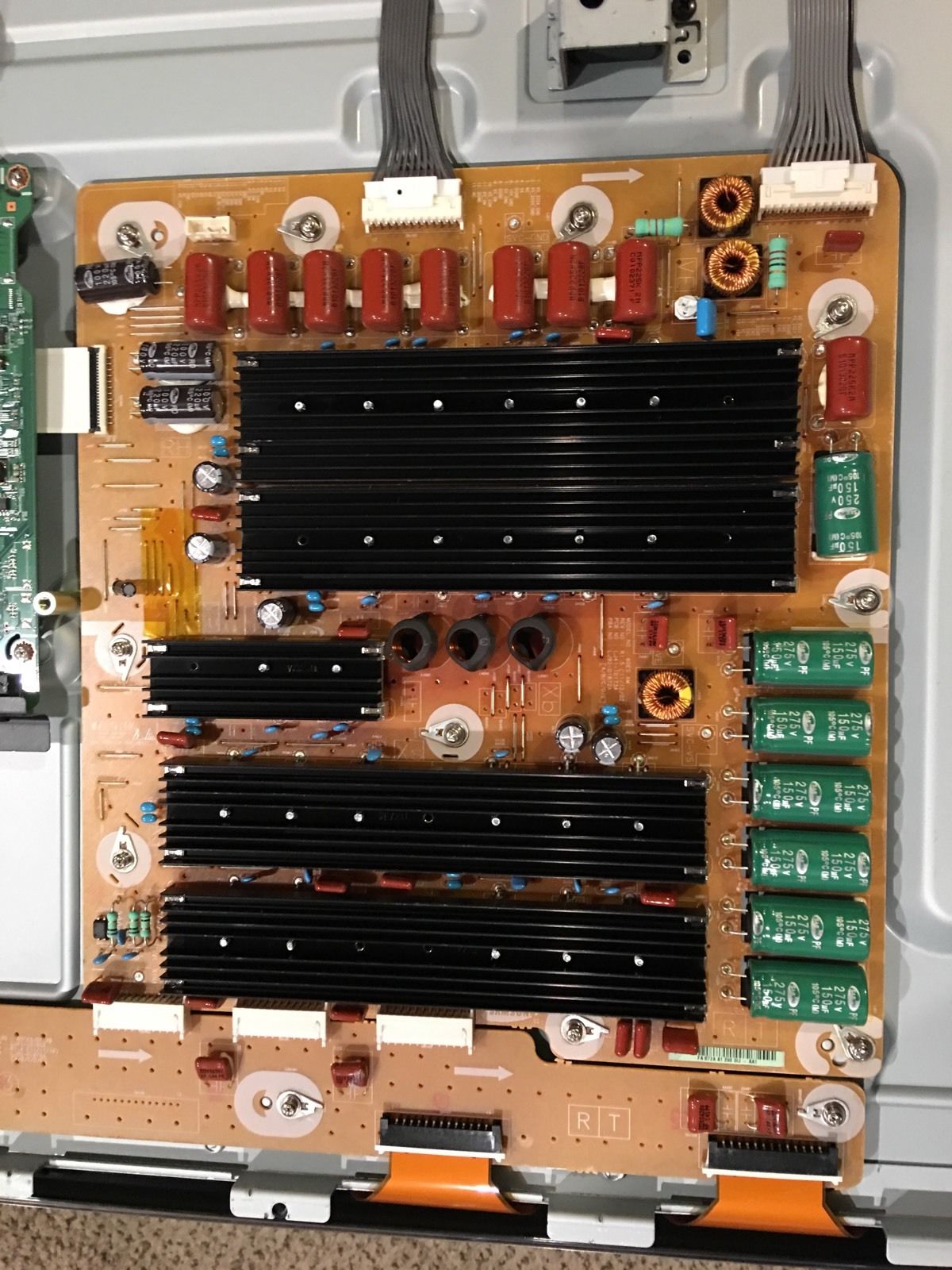

                        just found damage on x main so ill be needing one of those as-well.
                        found 2 dead 102ks360v caps dead on front left center.
                        found 1 smd ((smk) (630) (226)) diode,fet looking component on back left top to have weird reading on 1 side.
                        found 2 igbt (fgpf4536) that don't pass continuity like the other 6 fgpf4536.
                        the continuity is passed from pin 1 ground and pin 3 pos witch is gate to em miter but not the other way around.
                        the top part numbers on (fgpf4536) are different but i guess they are all the same.
                        the ones that pass continuity are( (fgpf4536) set in front bottom left, front middle left and front right,the front top right dose not have this anomaly.
                        also 1 open vertical resistor in front top center, the front bottom right vertical resistor dose not show this anomaly.

                          i noticed 2 630v caps on x main with different code on them don't read on either board.

                          old xmain might be good if those igbt anomaly of passing continuity is false.

                                        is there any other x &y mains that are compatible with this set?
                                        i see a different better built board such as the one in the picture below.
                                        this was with searching PN60E530 on ebay.
