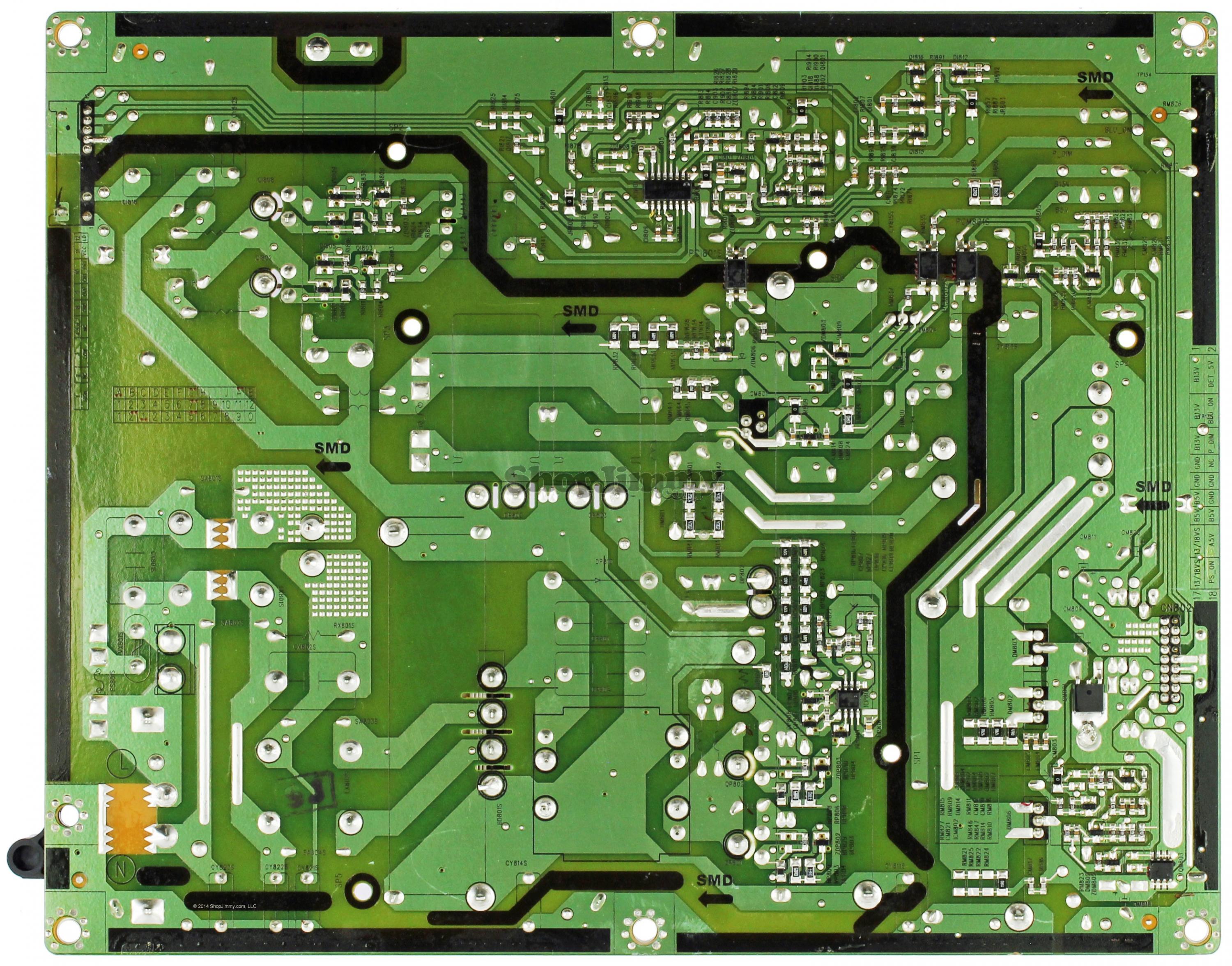

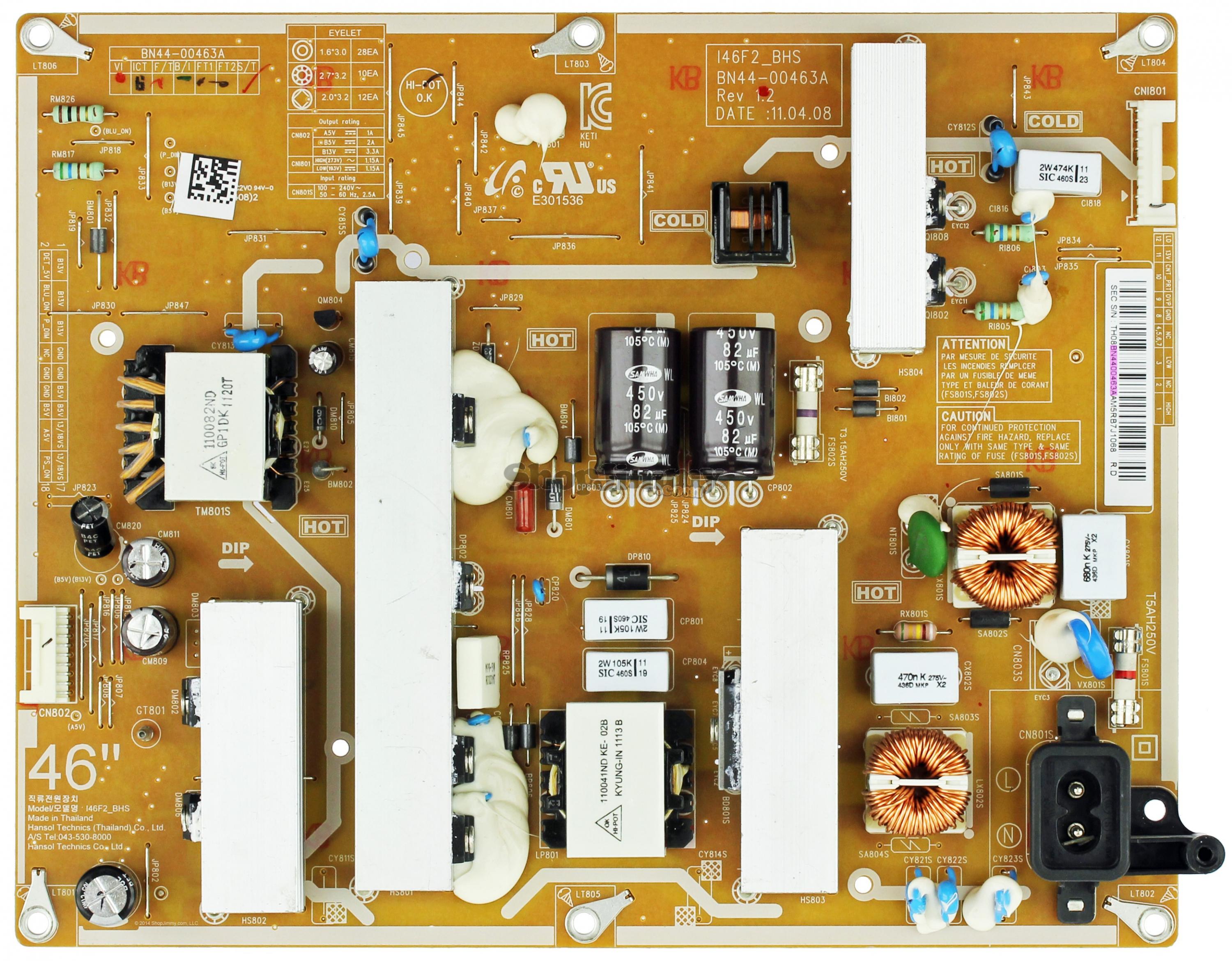

      Re: Samsung LN46D630M3F, TV powers on, sound works but no backlight
      Tracing out the board, pin 8 is the switched VCC pin which gets the VCC through a switched Transistor QM804 (turned on by OPTO PCM802, PCM802 is turned on by the PS-ON) from the AUX winding of the STBY transformer.
      So check the VCC on pin 8 with ref to the negative leg of the main filter cap when you turn on the TV and PS-ON is present.
      Pictures provided by shopjimmy.
