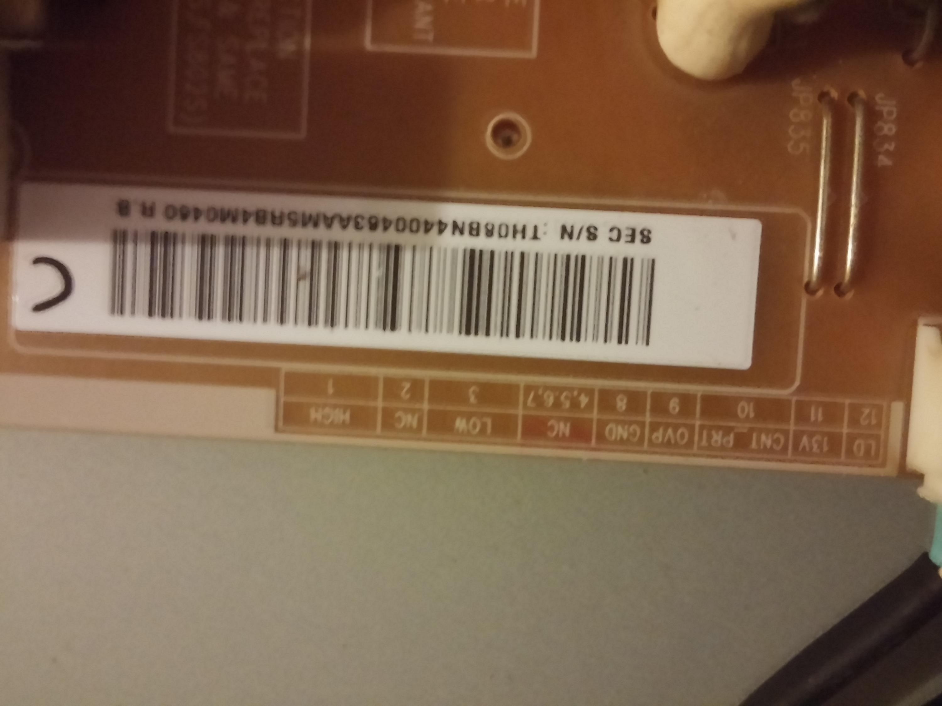

    Took some voltage readings at the inverter's connector tonight, which are;
    LD=10,8v
    13v=12,1
    CNT_PRT (current protection?)=11,6v
    OVP=0v
    GND=0v
    Also tried powering up the set without the main board connected; backlight lights up for half a second and shuts down. Tried taking readings at the inverter connector with the main board/inverter disconnected, but forgot to take notes. Will do it again tomorrow. Didn't bother taking primary readings at this point.
    After a google search, couldn't find the power supply schematic (BN44-00463A), so if anyone has it, that'd help a ton.

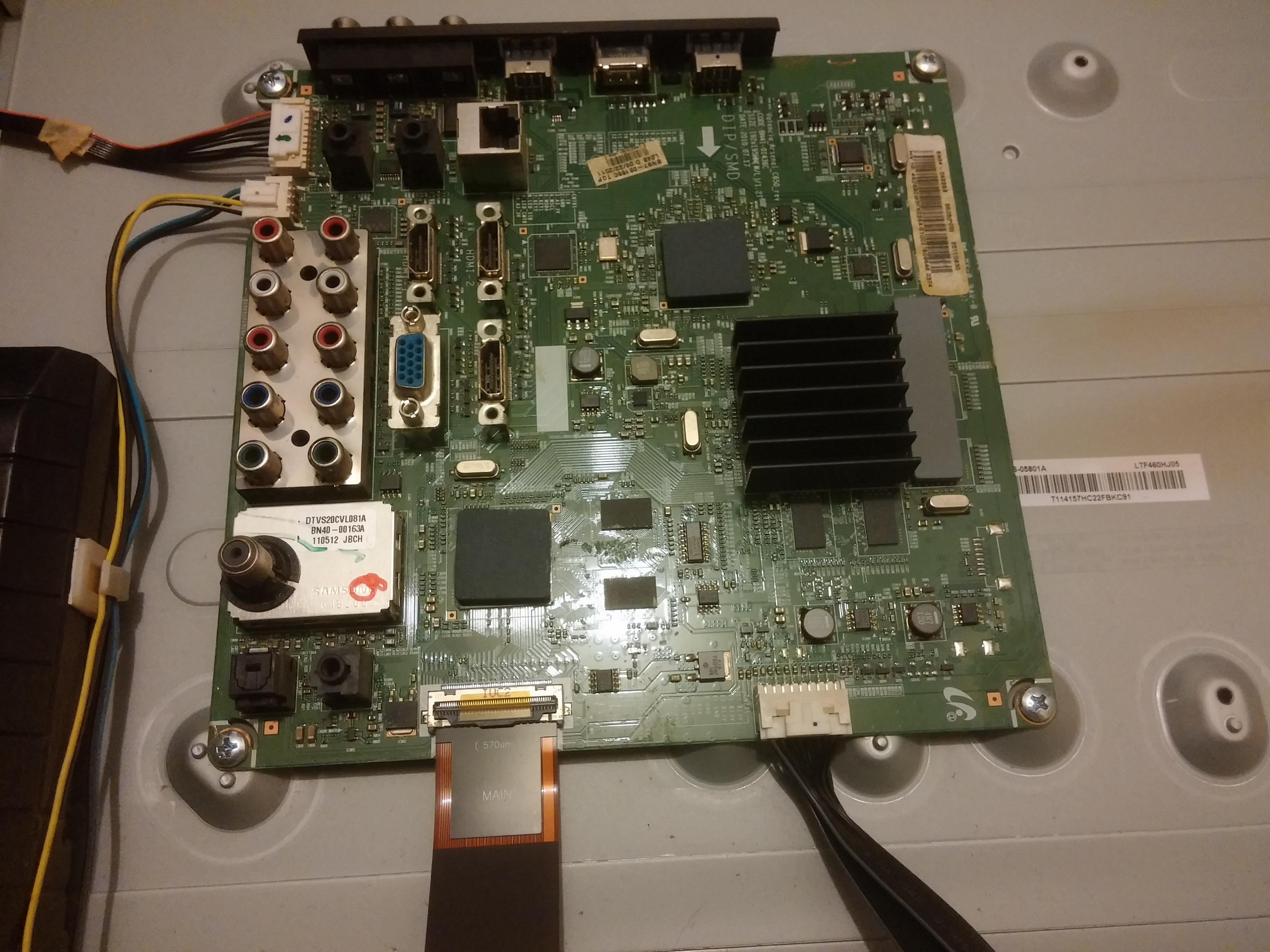

          Re: Samsung LN46D630M3F, TV powers on, sound works but no backlight

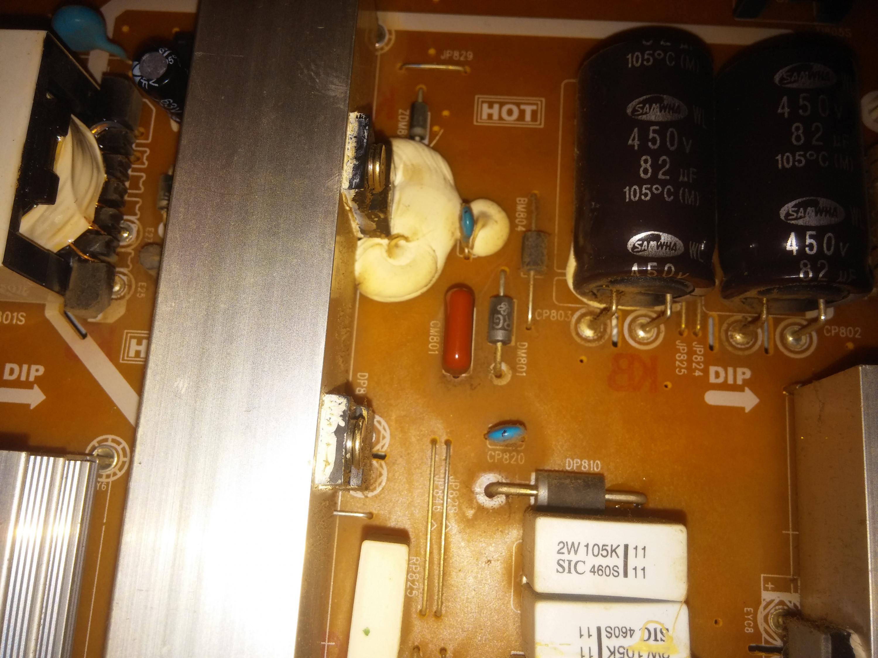

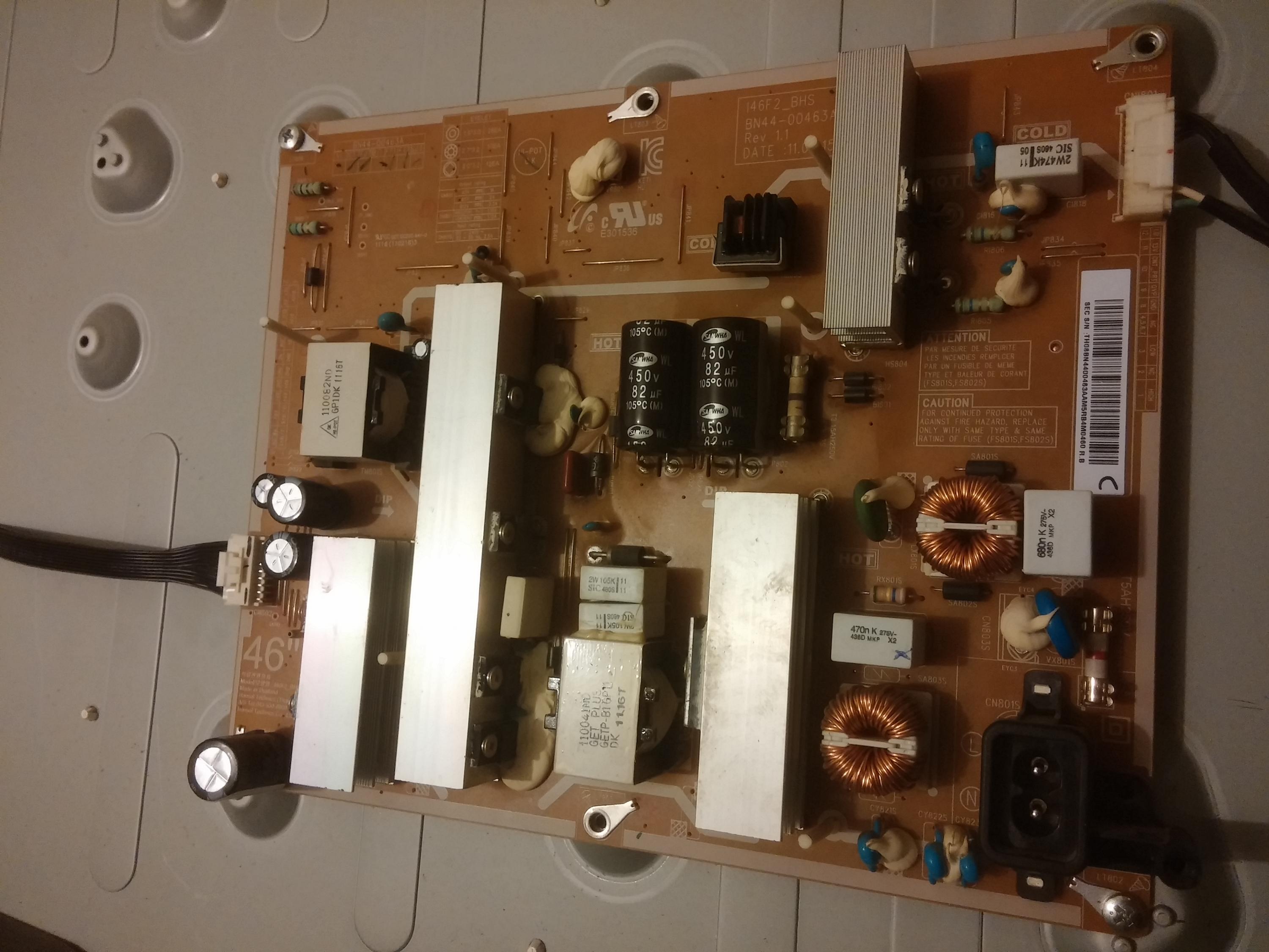

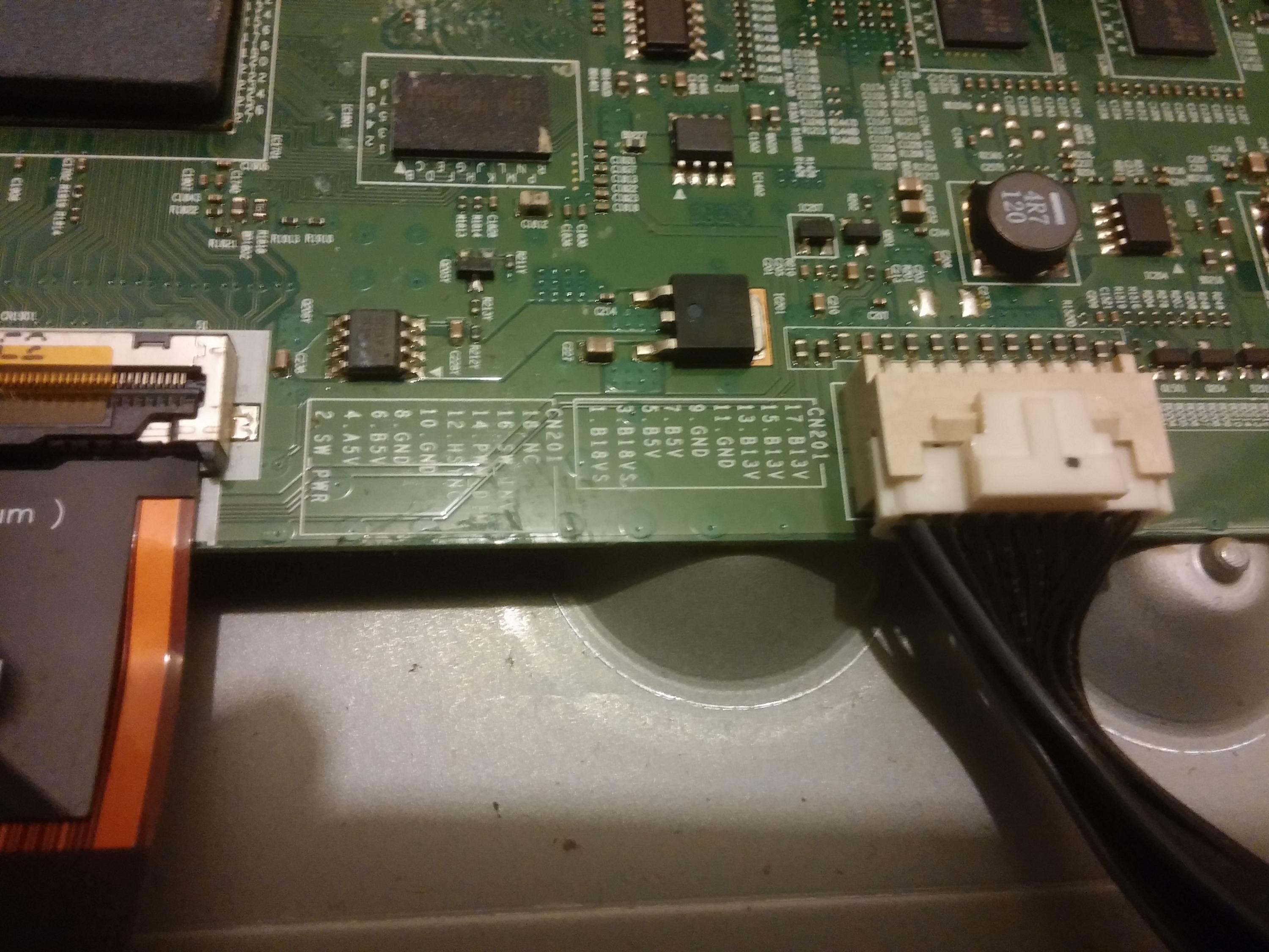

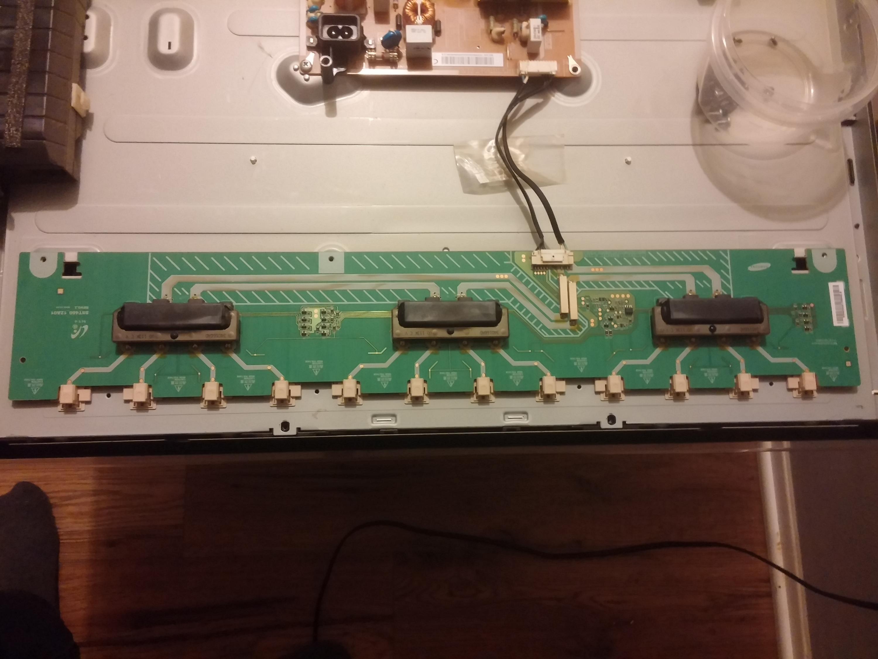

          Here are pictures of the main board, power supply and inverter board.
          Took the power supply to work today to test the ESR of caps. Turns out one of the electrolytic I put in is bad (30 ohms+). Also CM801 gives no reading, wondering if that could have to do with the value? I usually measure capacitors above 1uF. You can also clearly see heat marks near it.
            CM801 is part of the main power supply and you are getting the 12V, etc. so that will not be the problem.
            You have power supply-inverter transformers driver board (QI802, QI808 are the power MOSFETs for driving the inverter transformers (3) board).
            Fuse FS802S for supplying the B+ to the Inverter driver circuit is OK?
            You also need to check the cap CI818 (0.47uF) to make sure the capacitance is still within 10%.

                    Ahh that's one of them crappy slot in type of inverters. I have had the output connections on them that go to the lamps corrode and not make connection and more. Remove the inverter and inspect the output connections to see if they are worn down. If they are add fresh solder to them, then wick it off and clean the tab with Ipa.

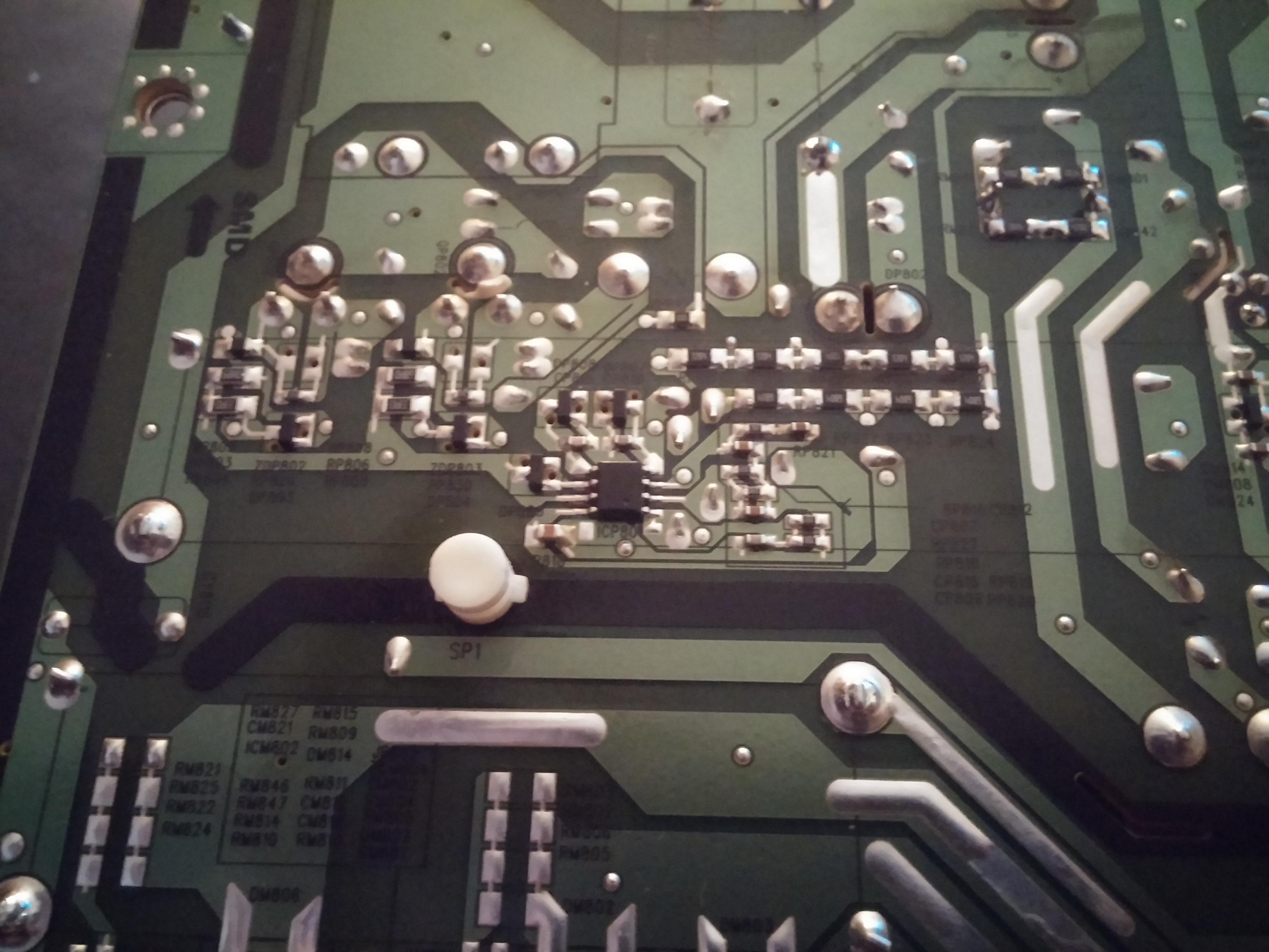

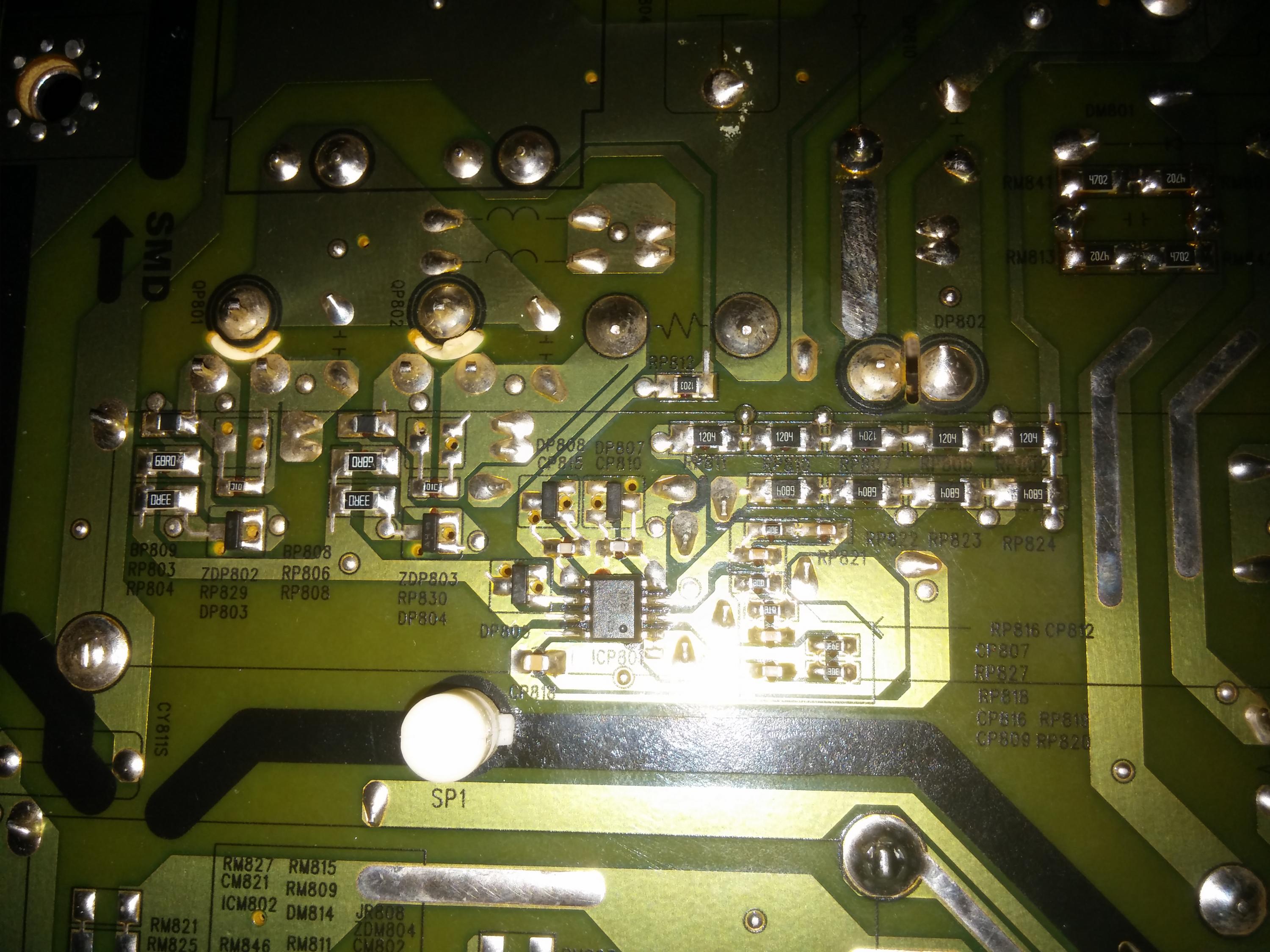

                                      Pics from the circuit around ICP801.
                                      There's a repair kit on ebay that includes ICP801 for this very board, but the P/N isn't listed -_-. Can't read the IC except for the bottom part (which usually isn't the part number, IIRC). If that can help you guys identify it or at least give you some kind of idea.
                                      PIN 4 and 7 are grounded. At least, PIN 4 goes through a ceramic resistor (0,4 ohms?) straight to the ground(kathode of main filter caps). PIN 7 goes to a diode (which isn't shorted), so either the pins are internally connected or it is shorted.
                                        Are you getting boost converter action--when the set is turned on? You will NOT see this in standby. The PFC ckt ONLY operates in the RUN mode--to reduce current flow and (theory--at least) power draw of the power supply. There should be close to 400 V dc on the filter caps in the RUN mode--around 160 or so in standby. 160 is NOT enough...for run...
