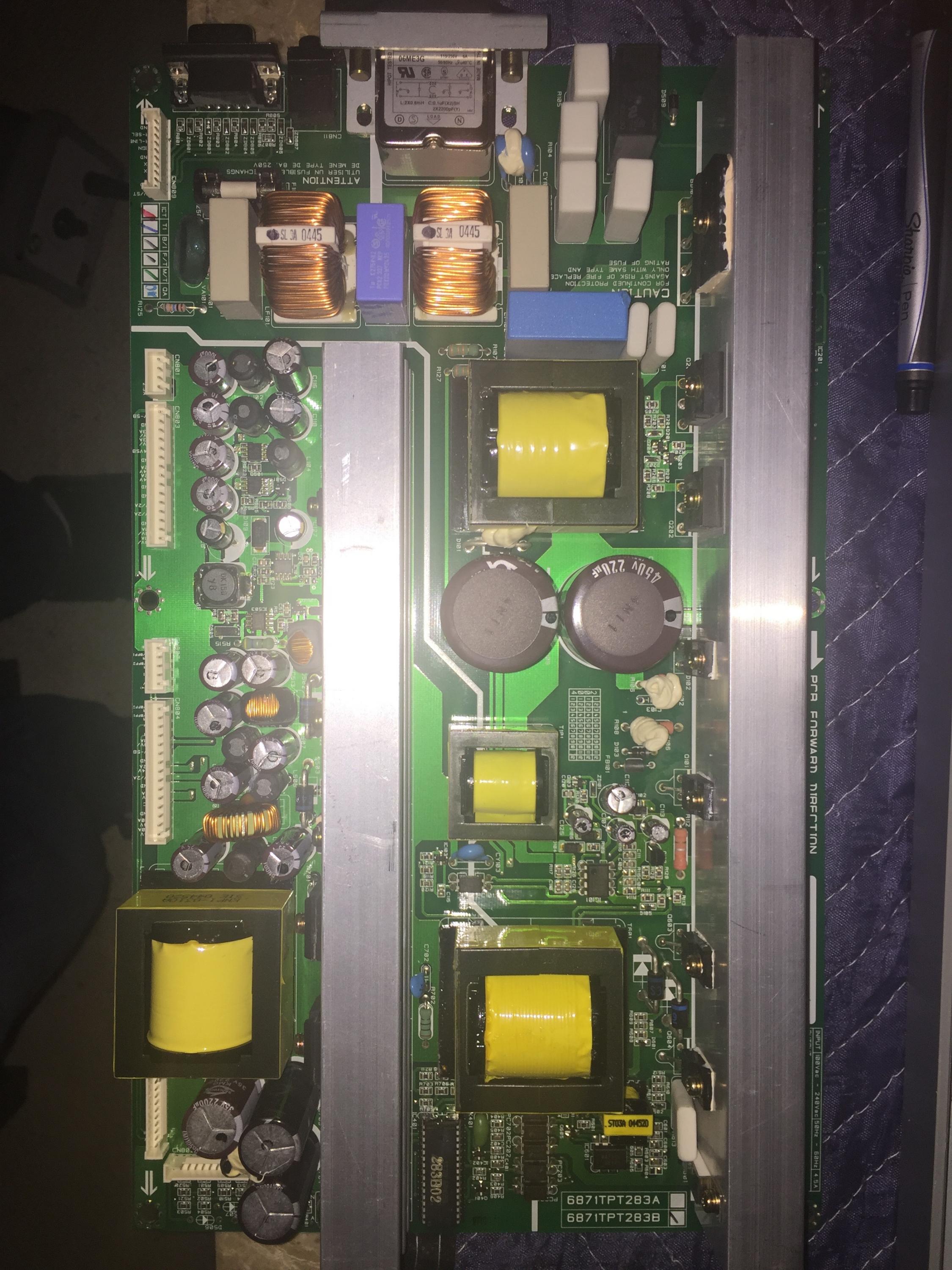

    Hello all,
    I'm new here and need some help. Has anyone had any experience with this model? The STBY voltage is not 6 volts. Its goes up and down 3v-5.8v
    Does anyone know which capacitor is the startup voltage? I have tested voltages/caps an changed a few caps with no success. Any help is appreciated.

    Would you like to post clear sharp photo's of your circuit boards as a good starting point when seeking help.

      Sorry about that. Here it is. The part number is visible also. The voltage across the bridge rectifier is good. The high voltage Caps are good as well.

        You have a number of white connectors running along one edge of the board. Alongside each pin of the connectors there is a printed label,.
        Can you measure the voltage on each pin and give the name and voltage read for each of the pins. That will help to identify where the fault is.

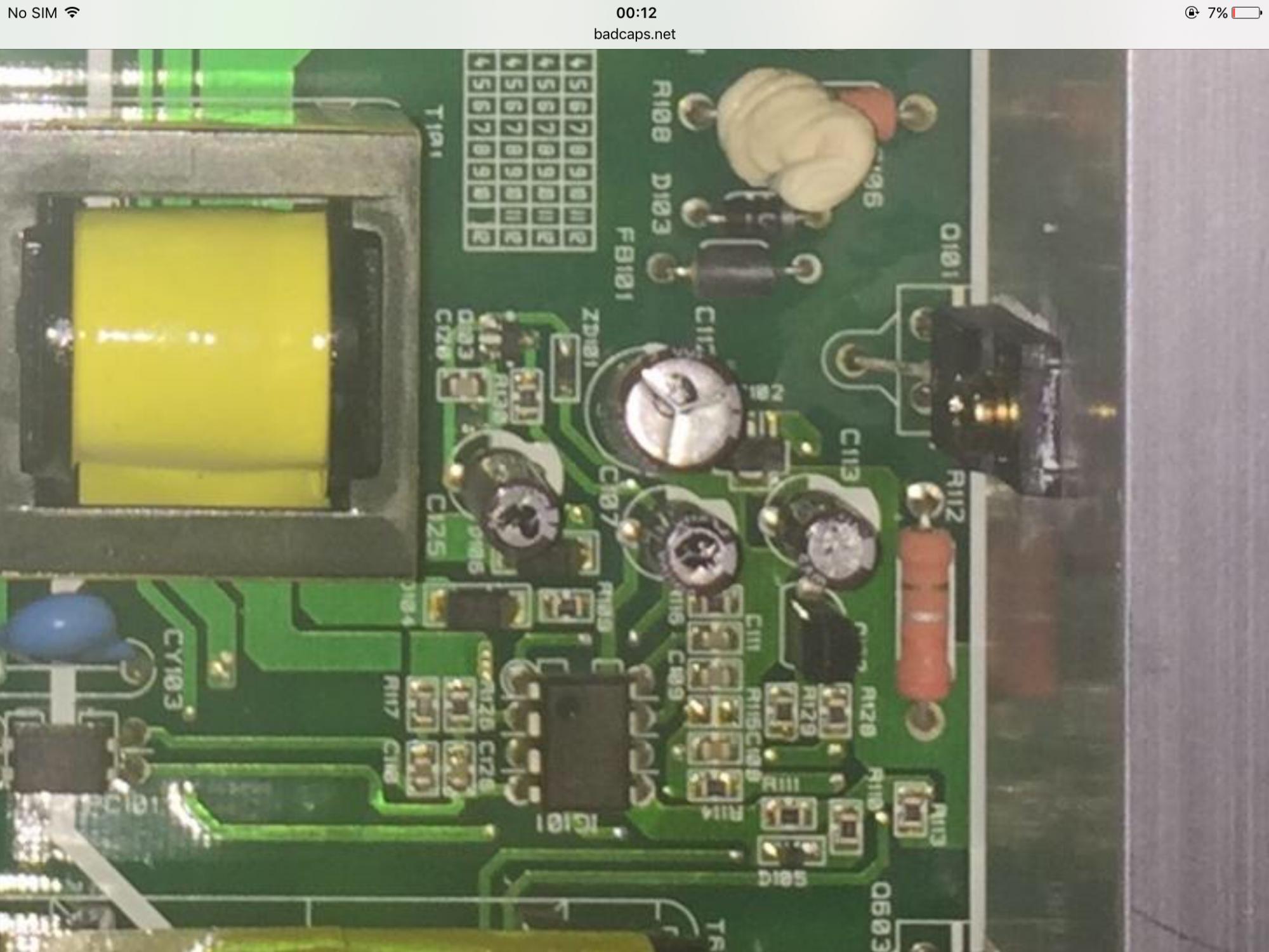

                    Mainly heat the area I have screen shot:

                      So I finally got back up and running. I believe it was the 47uf caps but I'm not 100% sure. I removed them, took readings and one of them was suspect so I replaced them all as well as most of the medium to small caps on the board I questioned. $11.00 investment. Can't beat that. Thanks for the help guys.
