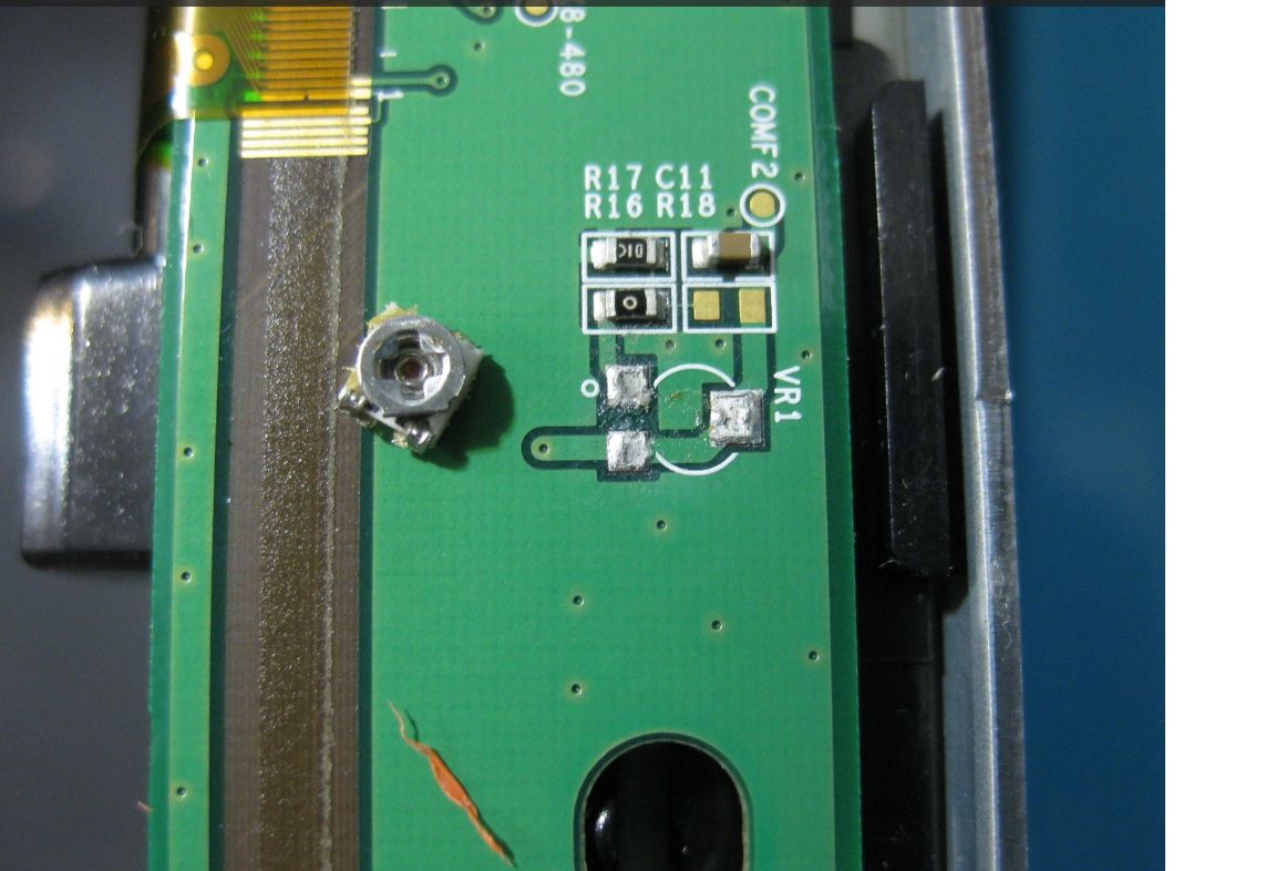

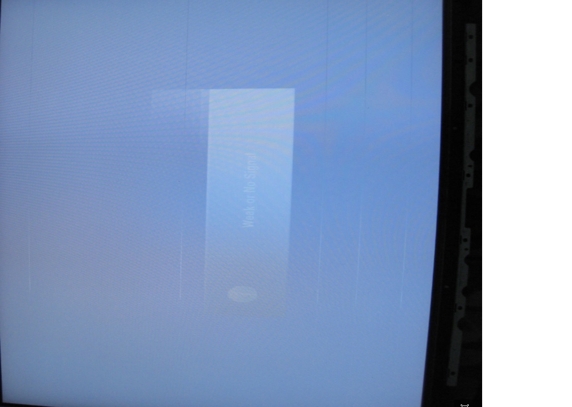

    Got this TV with white screen but picture can be seen as photo 1. This is not the t-con issues, but panel problem.

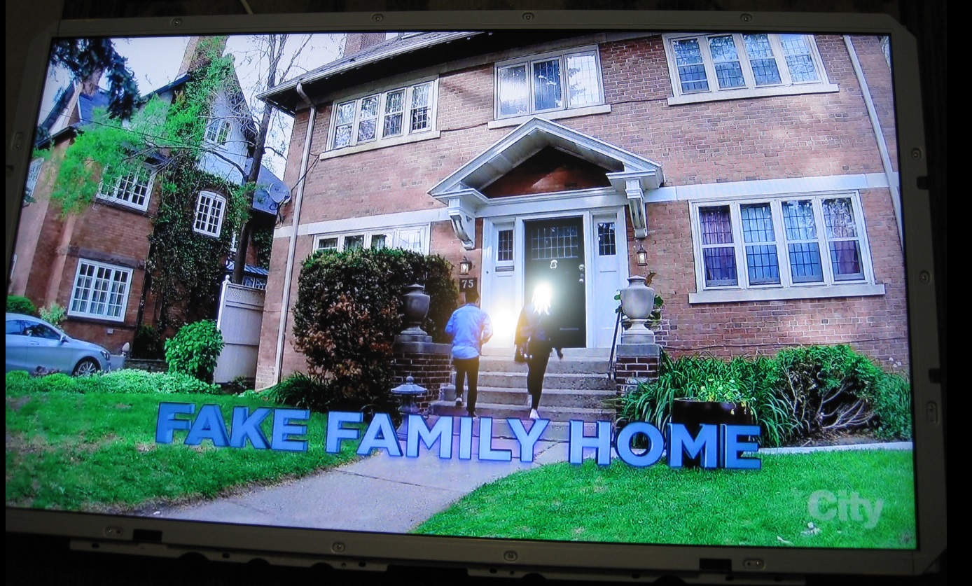

    The culprit is the soldering join of VR1 on the panel driver board. I soldered it out, cleaned and solder it back, TV works fine.
    I fixed two of this model tv, same issue, and both work perfect.
    (The first one when I fixed the tab bond issues, the VR1 was broken easily when move the mental frame and the screen was white, this wasted a long time to see this potentiometer issue).

    So glad I came across this post. After twice swapping the t-con board on my Samsung TV I decided to give this a shot before giving up and recycling it. I accidentally popped off this pot removing the LCD frame but was able to clean and re-solder it and my old TV looks like new again. Thanks!
