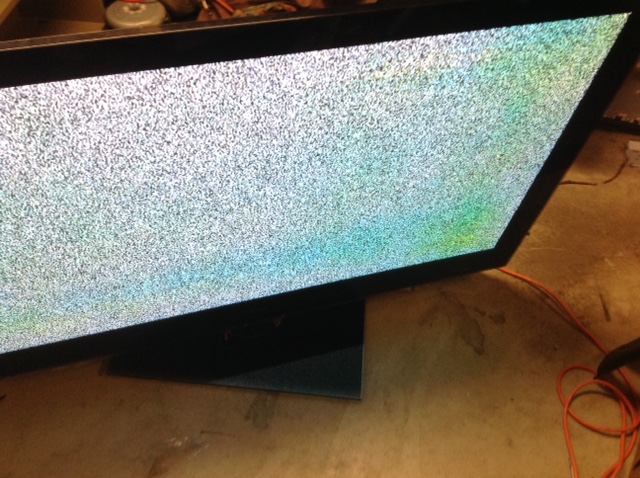

    In this LG PLASMA,lg 50ps70, RAINBOW COLOR problem.,
    Any help please.

    Could be burn-in. Run the test patterns see if the colouring is still the same.
    Seems kinda bright to be an zsus fault.

      Yes , with test pattern, same problem. do u think its panel?? With any input pict. is snowy and rainbow color or diff, color patch on all corner.

        Check your VS and VA voltages to that on the panel
