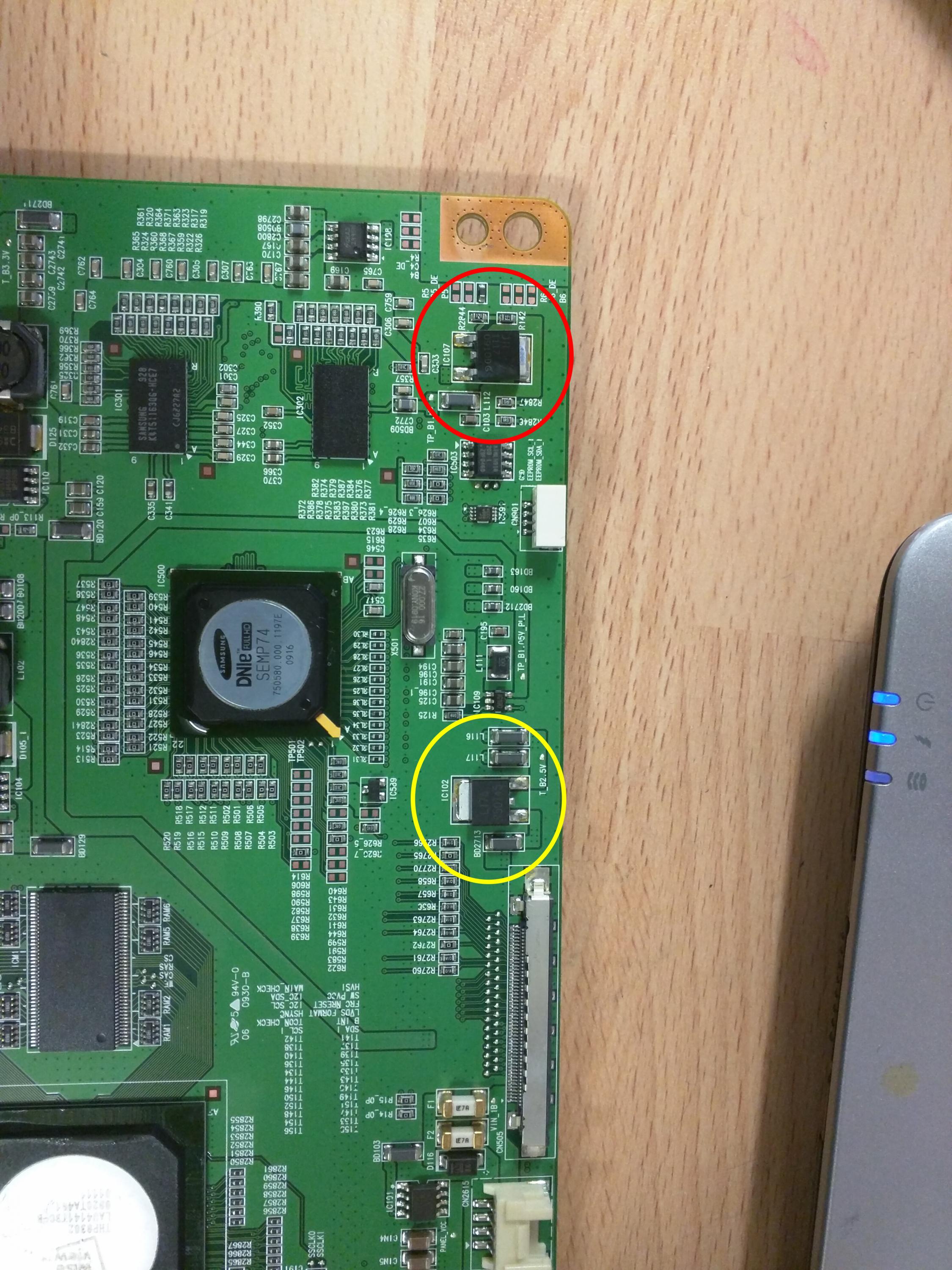

          Ok found these shorted trans.
          Red circle: 1117 0910DG
          Yellow: L176 950 145
          Anywhere I could find these or other names they come under?

                  'Red circle: 1117 0910DG' That is 1117 series regulator IC, not transistor.
                  'Yellow: L176 950 145', (need verification on those numbers) That is also IC, that is why the desigantors are labeled as ICxxxx.
                  The question is, what DCV do you have on the legs?

                    Re: Samsung le40b652t4w Video Issues
                    Sorry it's an L176 950T45
                    Got voltages of ~2v to ~3v
                      We need the dcv readding of each pin so we can see what you have for the input pin, output pin, and ADJ pin.

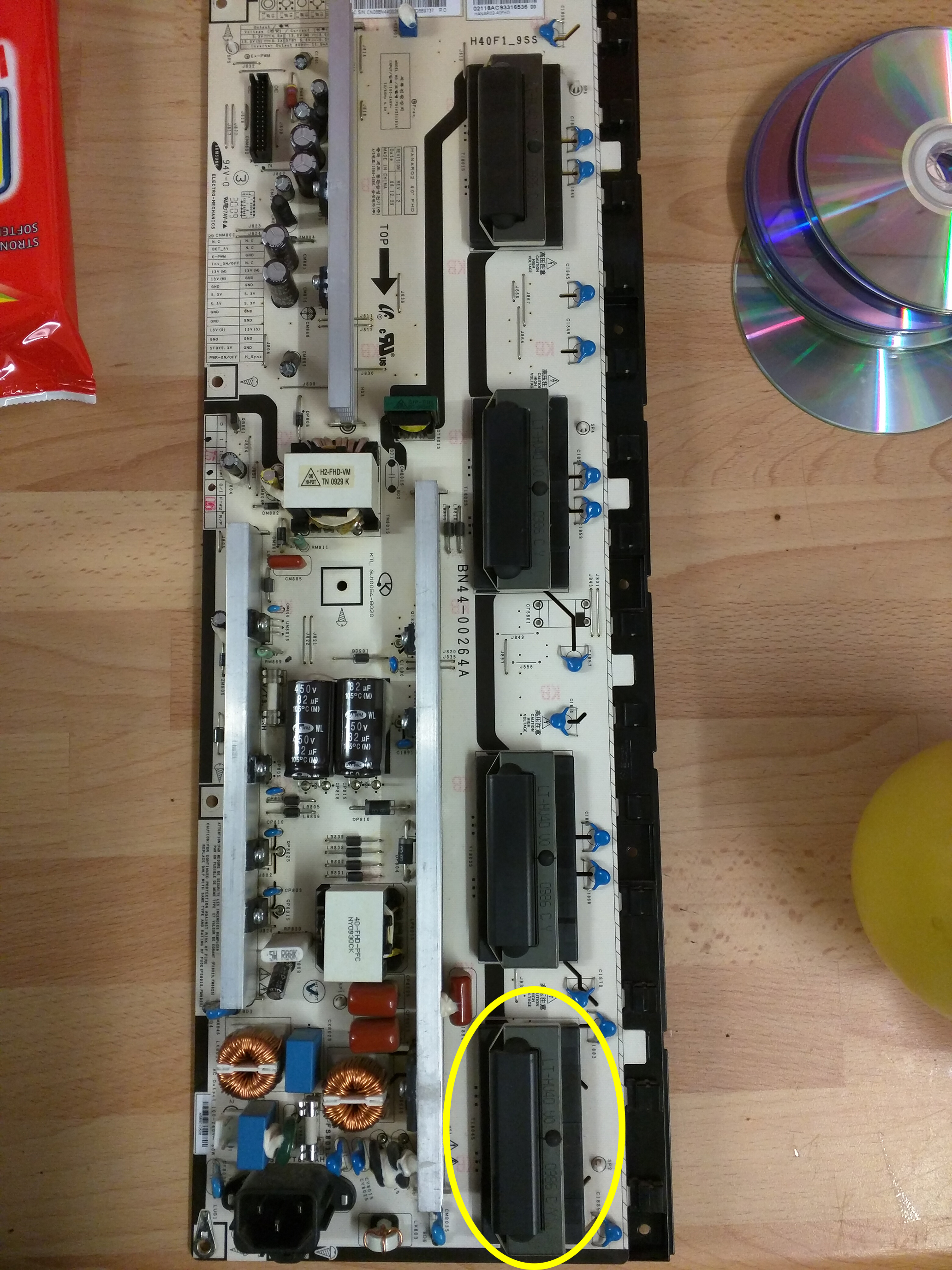

                        Guess it's not the t-con after all; the issue is with the power board: psiv231101a
                        Yellow circle is where I can hear a weird sound then after the sound cuts out, so does the backlight.
                          Have you measured the secondaries and primary resistance of each of the inverter transformers to see if the circled one is different.
                          • speedypro
                            • Feb 2013
                            • 561
                            • United Kingdom
                            Yes I have. From 1.5k ohms to 1.6k ohms. I'll be replacing the 1.6.

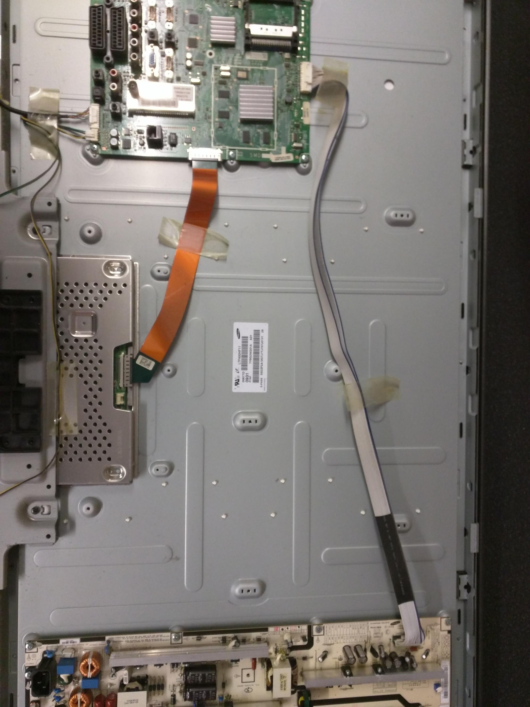

                              Did you take that plastic holder out with the power board?
                              I'm not sure but doesn't that plastic hold the tubes in place behind the screen? Or is this a different model and I'm mistaken?
                                That black strip should have stayed in but the bulds are ok. Im glad. Ive never pulled apart these before. But bulds are ok
