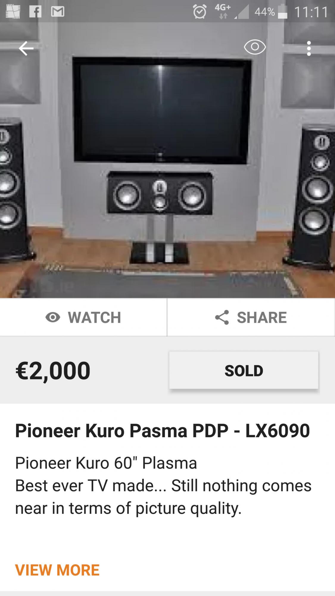

                                Re: Toshiba 32inch model No 32W1333DB
                                Originally posted by ReeceyBurger123
                                Best brand is Pioneer any day Samsung, Lg panasonic all shit. Only new brand I would say is sony.
                                Just had quick look with 2 local stores here and neither even sell Pioneer. All Samsung,LG,Panasonic,Sony and then some cheapo brands
                                Few second hand Pioneers on adverts sites locally but big money!!
