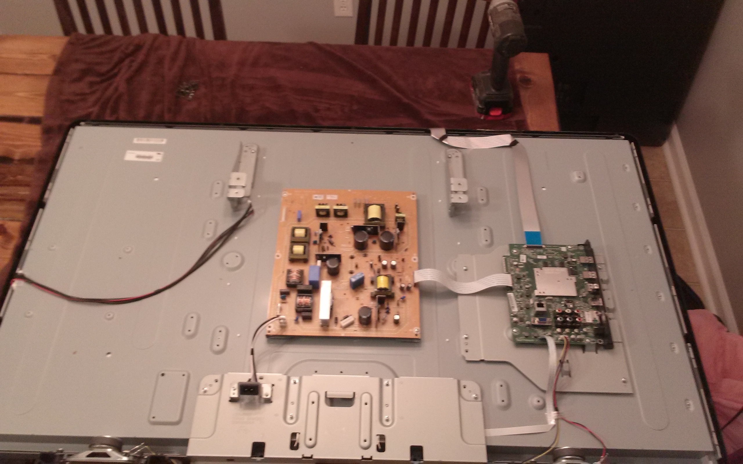

Phillips 50pfl3807/f7 blowing main fuse on power supply
  • snake91876
    • Feb 2013
    • 236

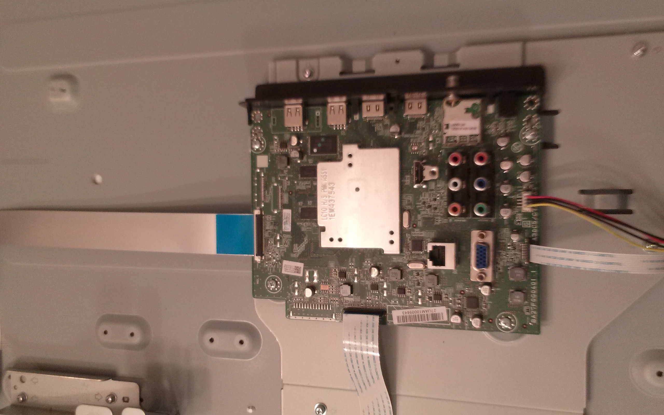

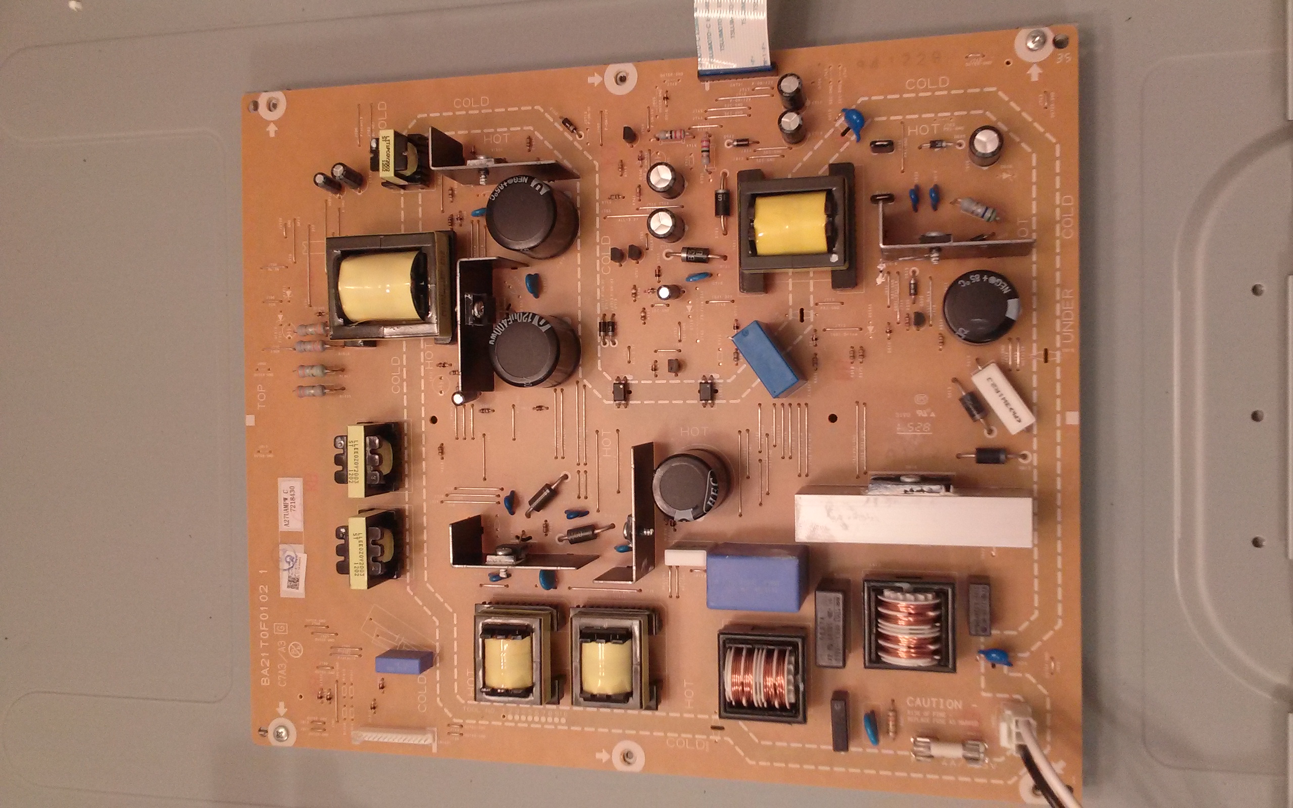

    Tv blew main fuse, replace and it is ok until I press power on and immediately blows fuse again, pictures below show boards.

    Re: Phillips 50pfl3807/f7 blowing main fuse on power supply
    What is the part number for the power supply?
    Did you check for shorts on the transistor?
      A27UAMPW-001 is the board #, which transistors do I check and can they be checked in the board.
        start by checking the bridge rectifier then the other transistors on the the heat sinks etc also theres a few diodes on the primary side too check you can check these on the board if any test odd remove them and retest them.
