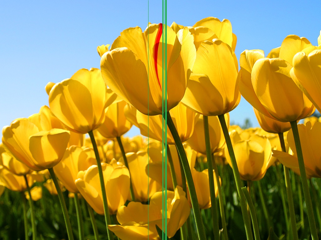

    Couple of months ago, it started to show green vertical lines, appearing in the same positions. There were only one or two at the beginning, then it started to grow to around the amount of 10. All of them were in the middle third segment.

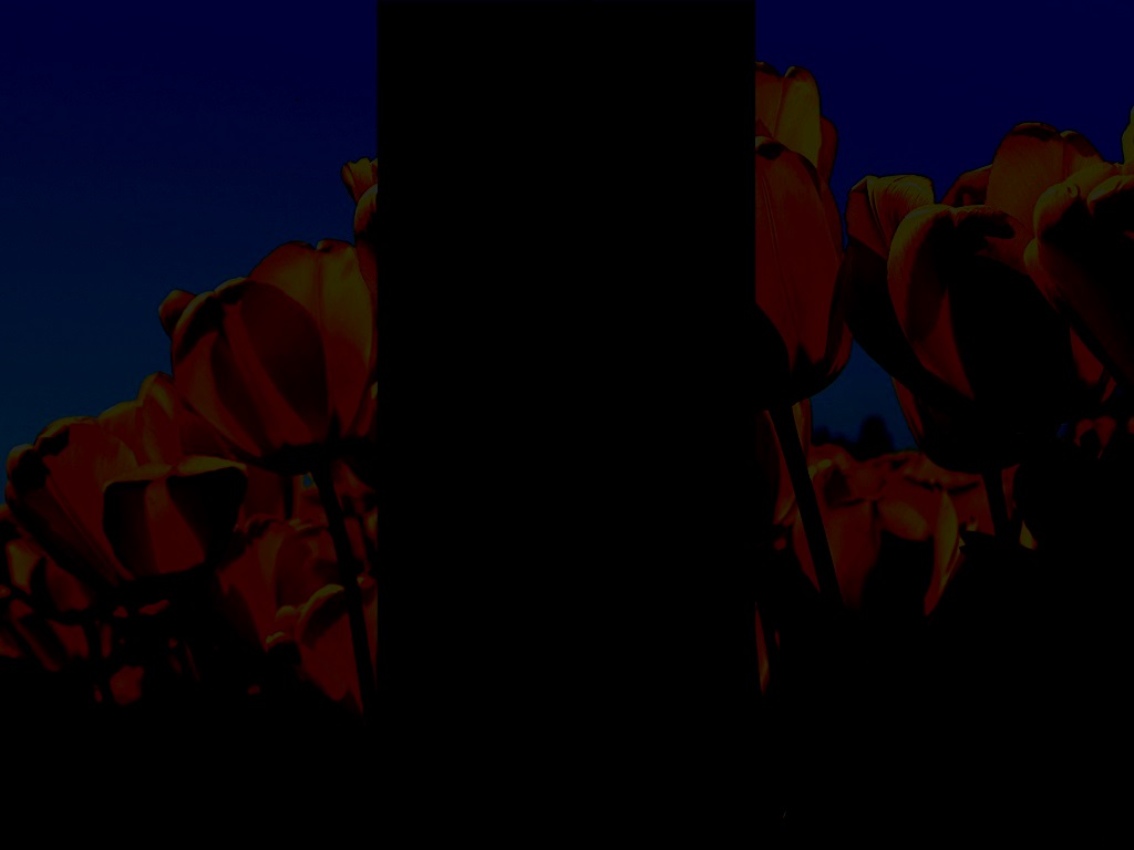

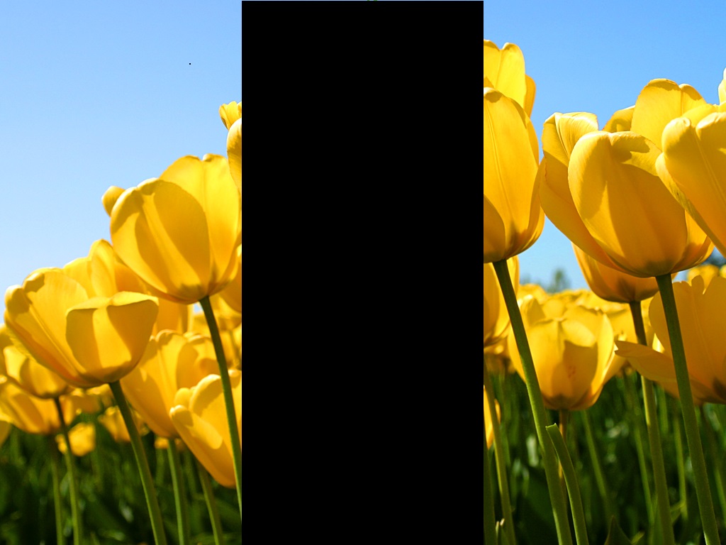

            I anyway attach some simulated scenarios how the problem got deeper during troubleshooting.
            Step1: some green vertical lines were present in the middle third segment.
            Step2: the middle third segment went out totally.

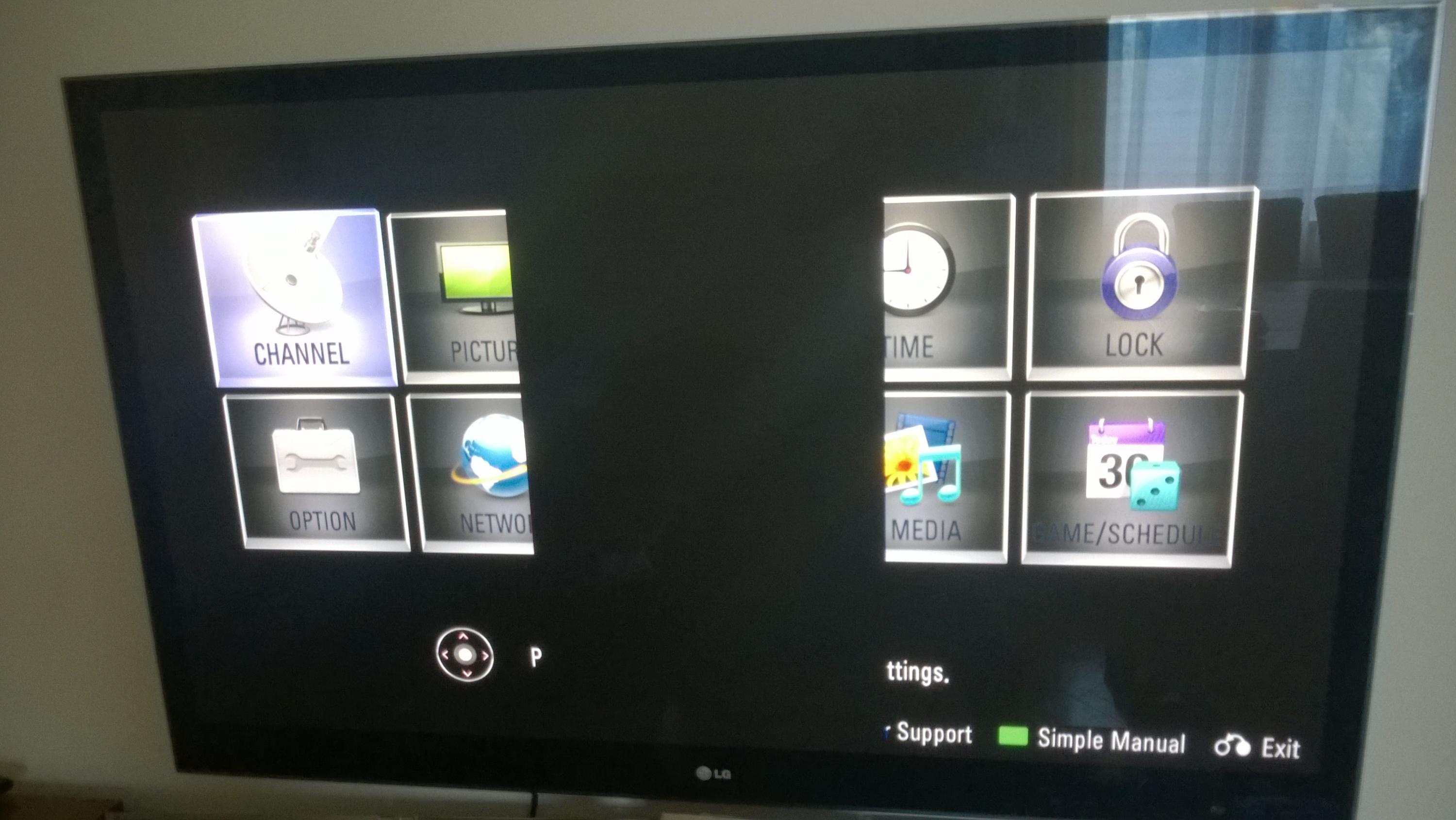

            Step3: simulated symptom when Z-SUS is removed.
            Step4: total blackness, TV turns off after one relay click sound, going back to stand-by when Z-SUS is attached.
            Do you mean by COF the chip which is integrated into the ribbon cables that are part of the plasma display and are connected to the X-Board?
            I suppose this assumption could be valid for all the cases, except for the last one. Though I think if only one COF goes wild, then not the whole third of the screen in the middle would be affected, but only some limited the ratio of the screen which is controlled by one COF. Of course, if all the COFs are out going to the center X-Board, then this case can be valid for Step2/Step3.

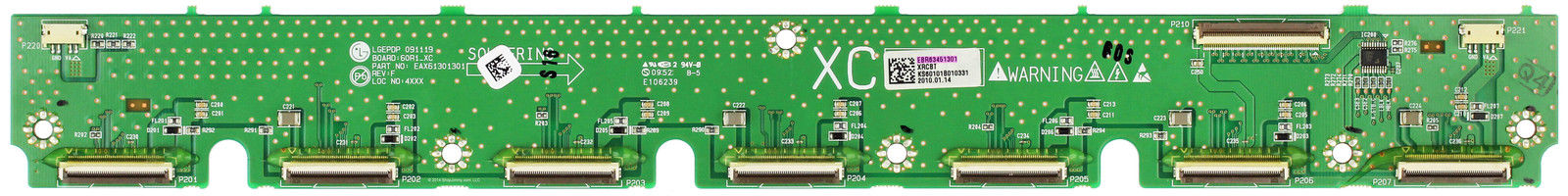

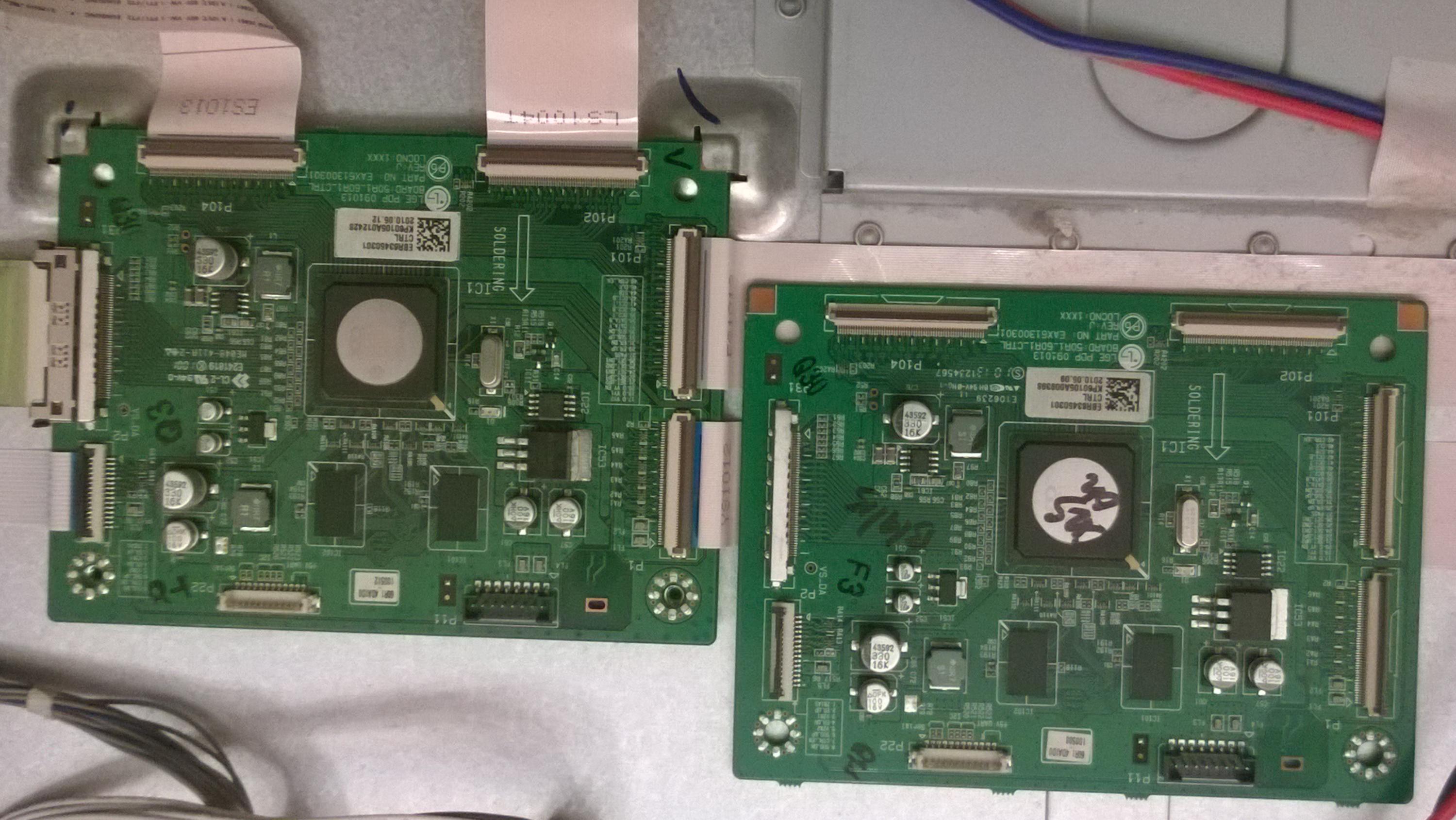

              Attaching the center X-Board (EBR63451301) picture.
                Re: LG 60PK950 - multiple issues, chain of events
                Why wouldn't it be valid for step 4 ? Though I admit it's odd for the whole third of the screen to be out, that points to an x board failure which you've replaced. I suppose thw control board could have failed but that's a new failure mode on me for a control board.

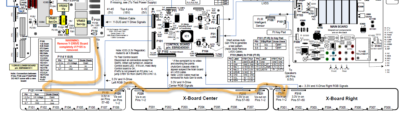

                    Are these x boards daisy-chained ?

                      I have attached the connection figure of the X boards.

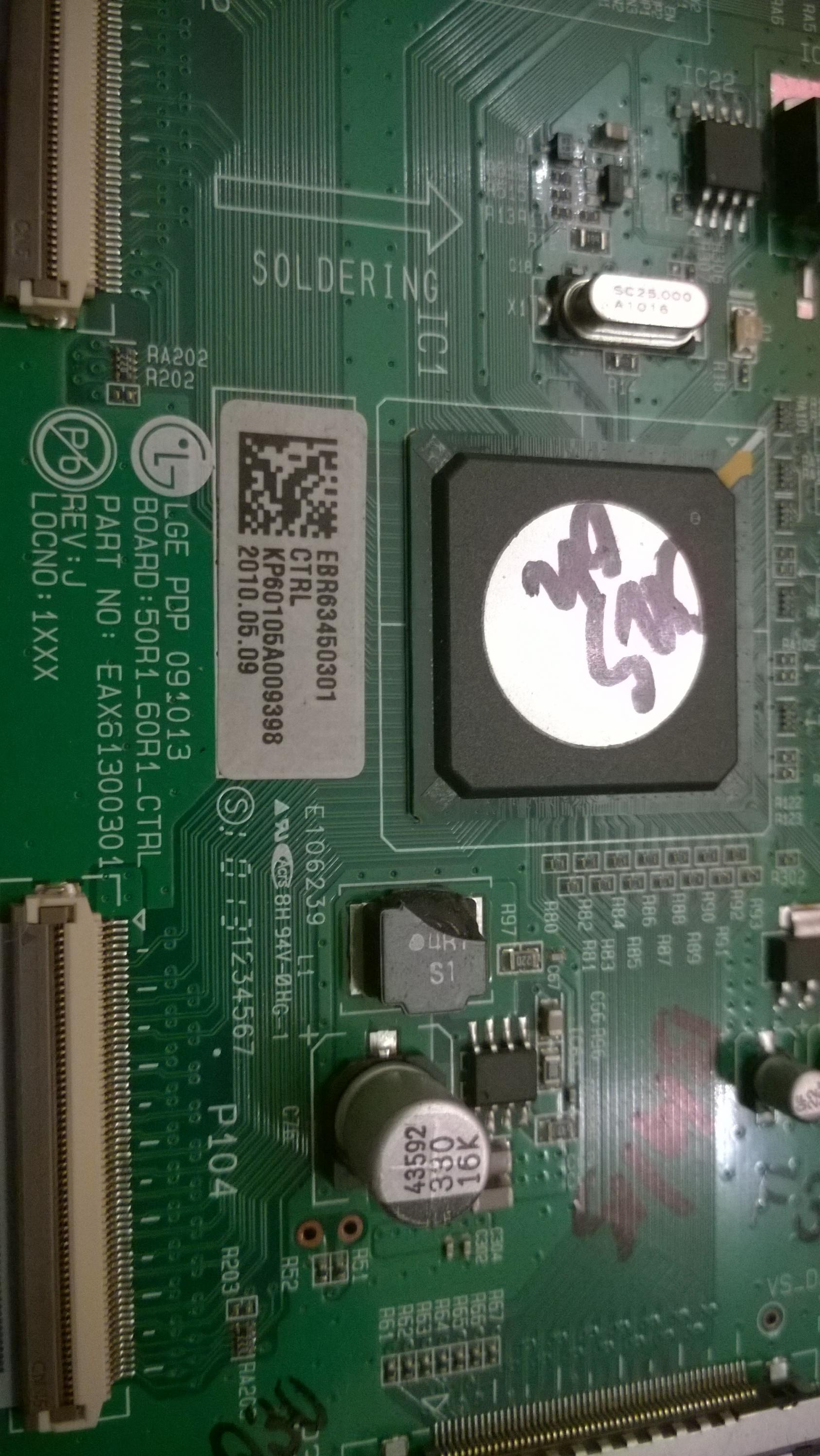

                            The other one is bad (Control Board) as a chipped 4R7 S1 device can already be identified visually and if I put it in, then there is only blank screen, at least does not go back to stand-by mode. So I am still using my original Control Board.

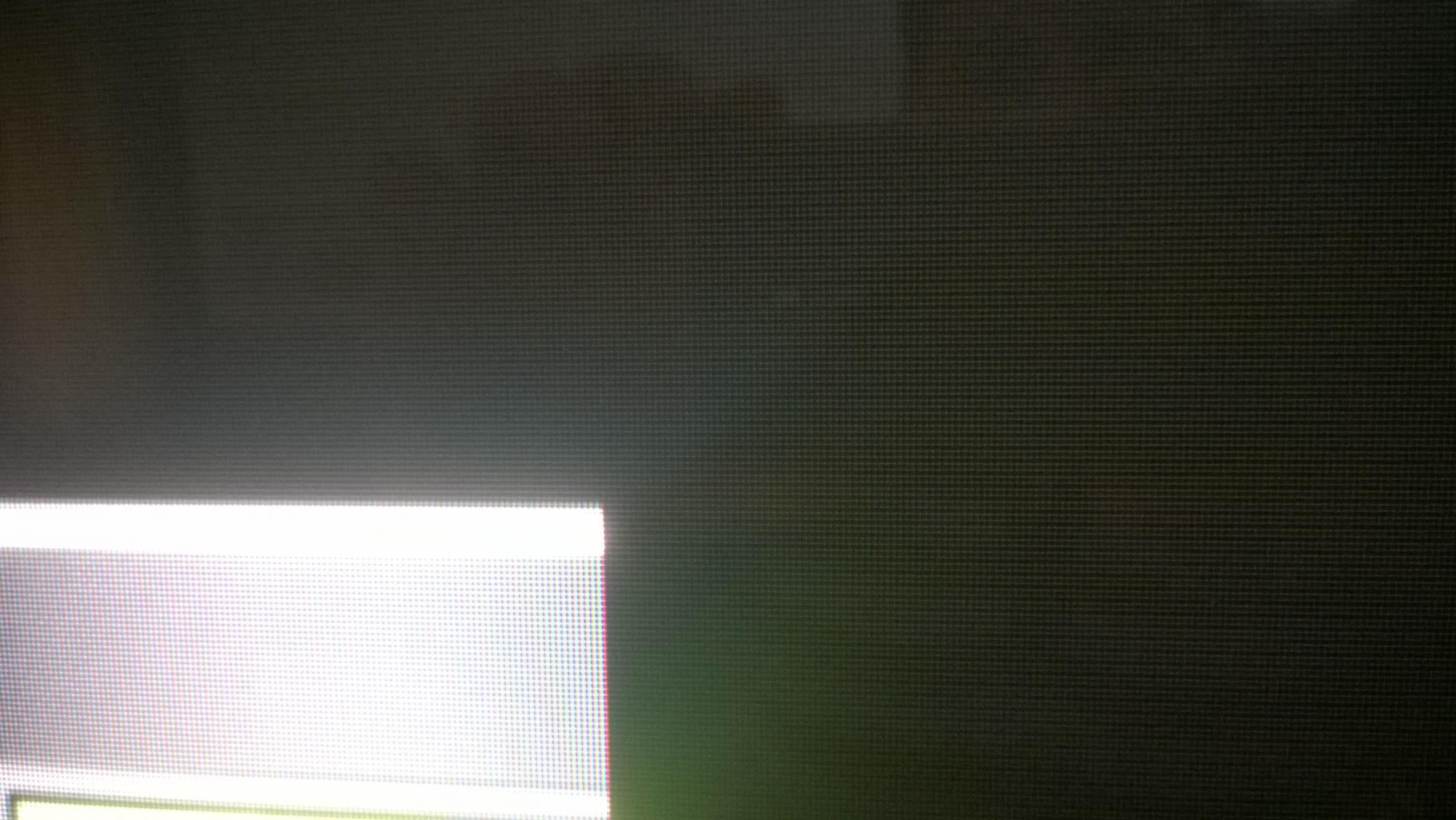

                            Now I have screen, but still only on the left and right sides.
                            Attaching some pictures.

                                After leaving the TV on for couple of minutes, I noticed a new green vertical line now belonging to the right X buffer segment. While I was inspecting it and the movie scene changed to almost all white, then the left X buffer part COF's gave some bursts and two smaller vertical black stripes appeared. I turned the TV off, but with an immediate realization of that my adventure with my beloved TV has just been over.
