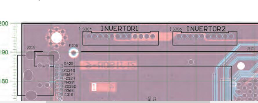

                            Do you got a cable running from connector S304 (or S306) that goes to an invertor board. If you have what is the part number of the board and do you have a photo of it.
                              Re: Grundig 32 lxw 82-8600 - PSU Problem
                              I will check and take a photo for you. Need to take out few screws to get the Inverter Board. Give me few minutes.
                                Can you check if there are any fuses on the board and check that they are not blown. Also can you check the voltages on S304. The picture shows where Pin1 is.

                                  Ok, no photo nothing now... When i took out the Invertor Board, one of the Light Bulbs came grabbed ..
                                  Thanks for the help, now nothing to do. Tv for the trash.
