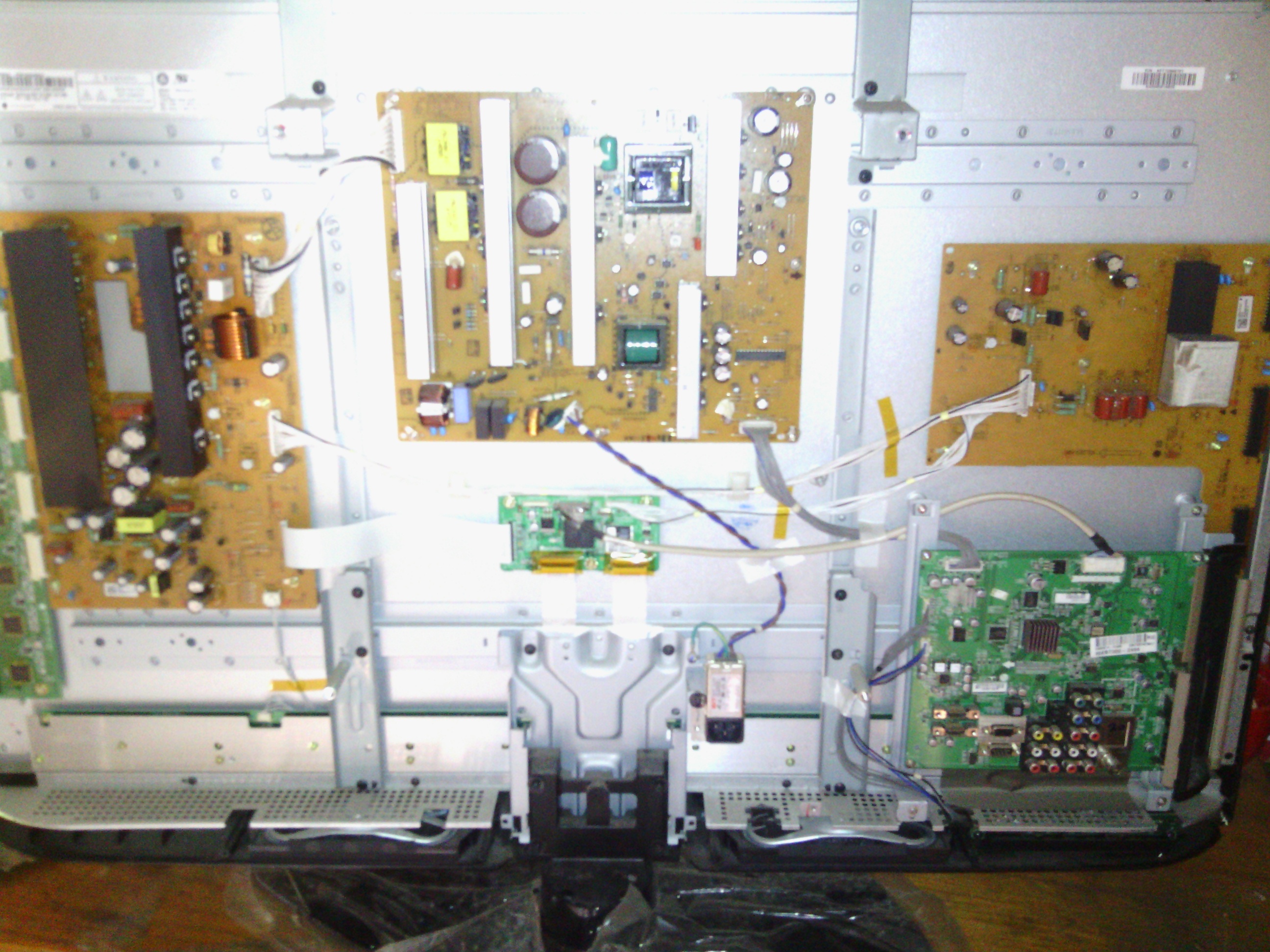

    Great looking TV pulled out of e-waste dumpster at rubbish tip. Still has protective plastic all over it.

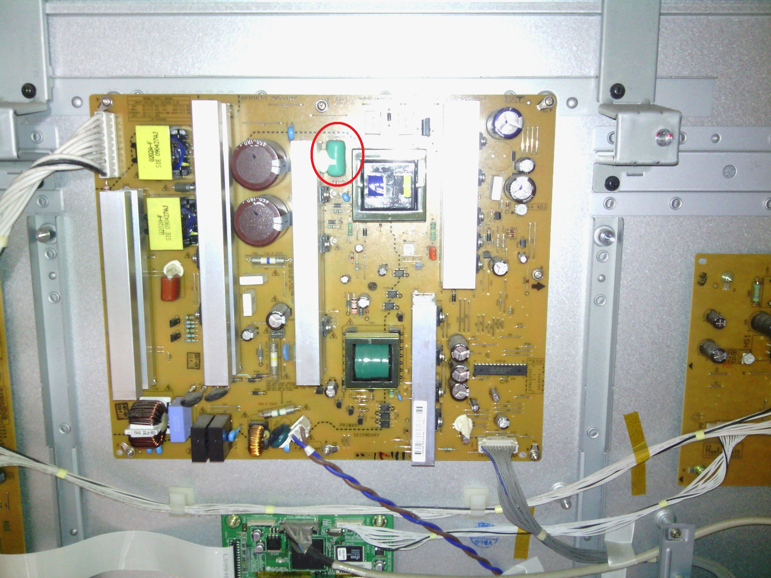

    The blue standby LED flashes and goes steady but no signs of life. After about 30 seconds it resets and tries again, and just continuously cycles through. I'm thinking power supply? I've yet to start taking any measurements, but as always, thought I'd take the lazy approach and see if anyone had an immediate thought as to cause of failure?
    I've posted some dodgy pictures of the overall layout of boards in the TV, and a close up of the power supply. Visually all looks OK to a quick glance. I've circled the cap that in other similar power supplies often fails and causes similar grief to that which I've described.
    All thoughts and opinions appreciated!

    What happens when you uplug the Y and Zsus boards does the set act differently ?

      It looks like it's the Y-Sus board has failed. Power supply generates correct Va and Vs voltages. When the Y-Sus board is disconnected from the power supply, the power supply holds up and doesn't re-set. The Z-Sus power is routed through the Y-Sus board. Disconnecting the Z-Sus does not change the symptom so I conclude Y-Sus board is the failure. I've tended to be a board jockey with plasma repairs but would like to see if I could repair this one down to component level.
      So what would be my next steps guys?
        Re: LG 42PQ20D repeatedly tries to start
        If Vs and Va collapse when the Y-sus turns on, or whenever it is plugged in, then it could be a short on the Y-sus. I'd check all IGBTs for short circuits. Rebuilding this would probably be quite easy, I've done a few sustain boards now and they're pretty simple. Having a scope is a massive help.

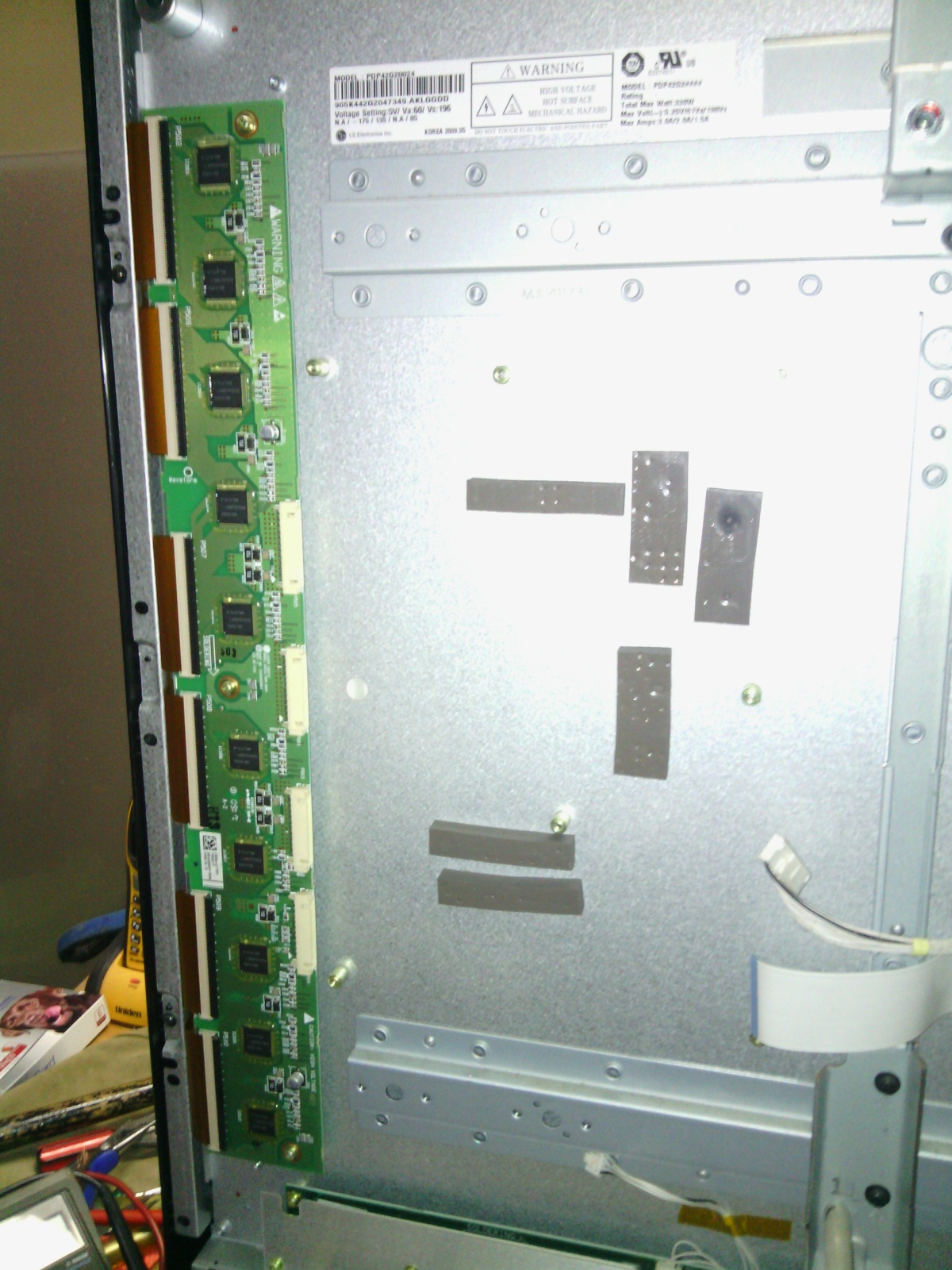

            I fear the set is uneconomical to repair. I pulled out the Y-Sus board and ran my meter's diode test function over the major semi-conductors on the Y-Sus board. About half show dead shorts between all junctions. I then moved onto the buffer board. The input sockets show dead short between all pins on all sockets with the exception of the bottom socket which only has about 50% on them shorted.
            A Plasma expert can probably confirm for me that this has gone beyond the state of repairability. What would cause a major failure like this? No obvious signs of stress when looking at the boards.

              By the way, the output of the buffers at the panel ribbon connectors all check out OK.
