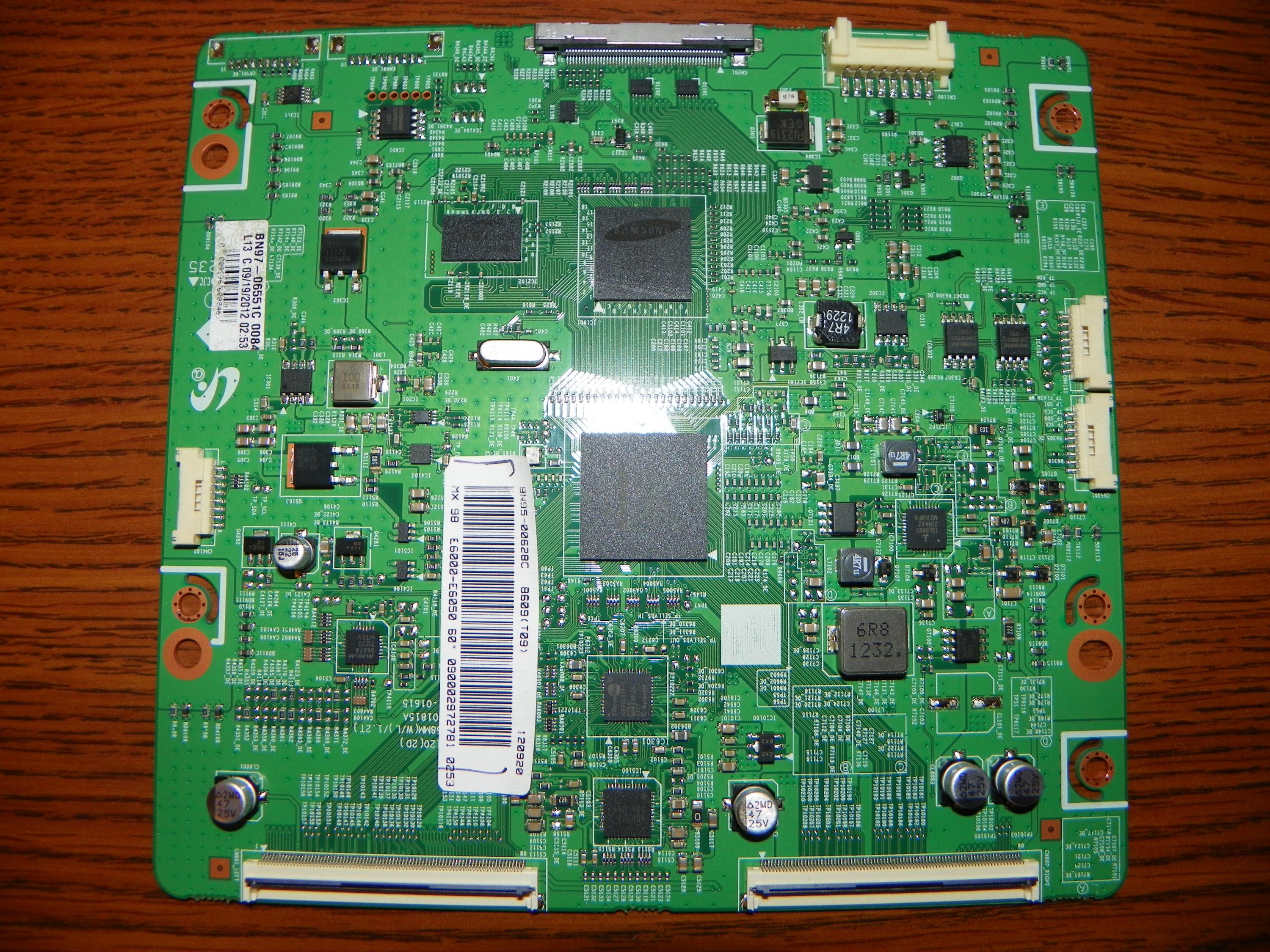

          Here is the TCON:
            Re: samsung UN60EH6003F Can I repair T-Con?

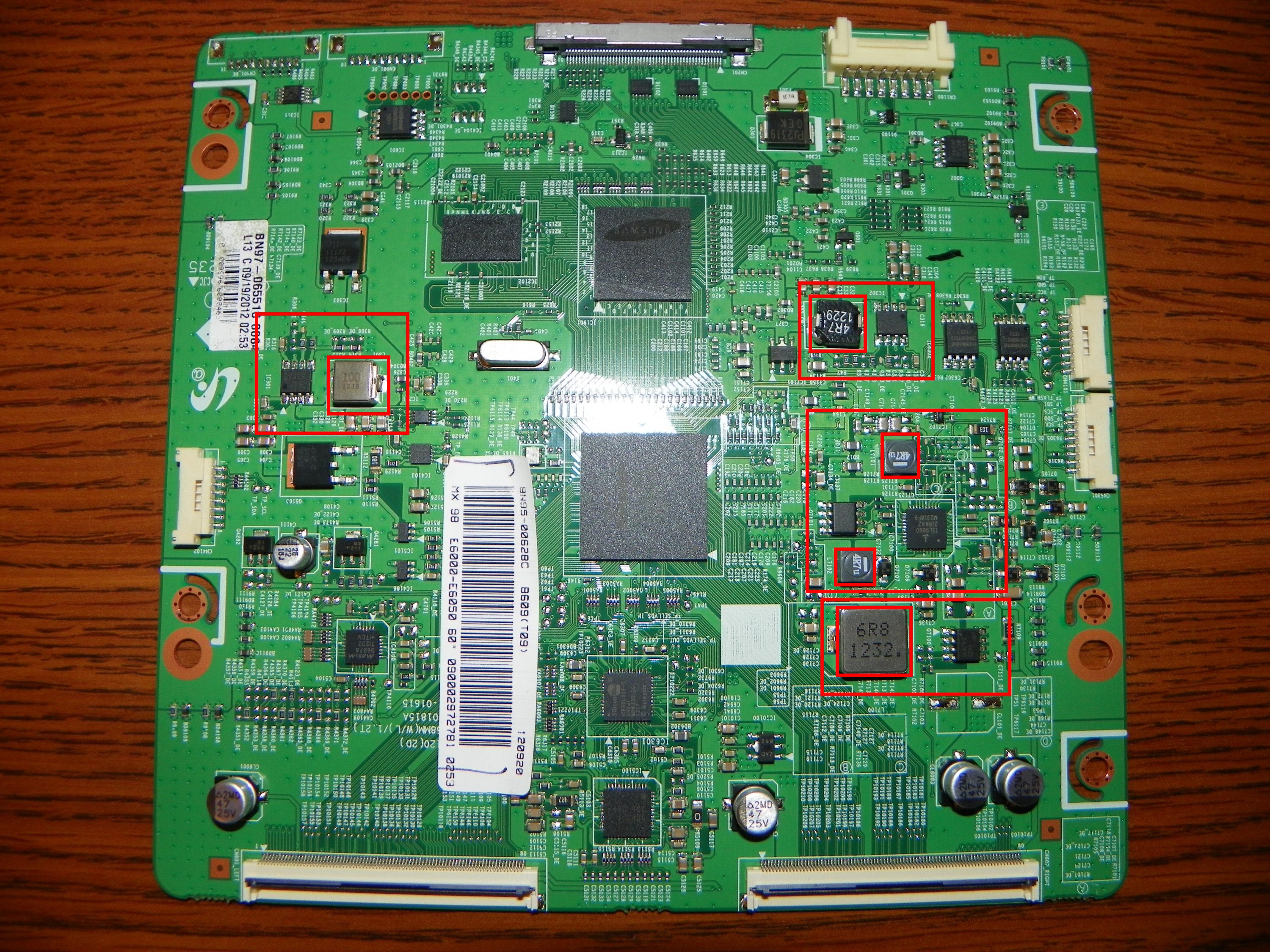

            Very difficult and just about impossible to get the diagram of the T-CON board, but as suggested by oters, you can get the IC spec so at least you can see the app notes diagram on how the ICs are used, I do that all the time when no diagram for the boards are available.
            I can see may be 5 switching power supplies on that T-CON, you can get the IC spec for the IC7100, IC301, IC302 so you can check to see if they are putting out any Voltages.

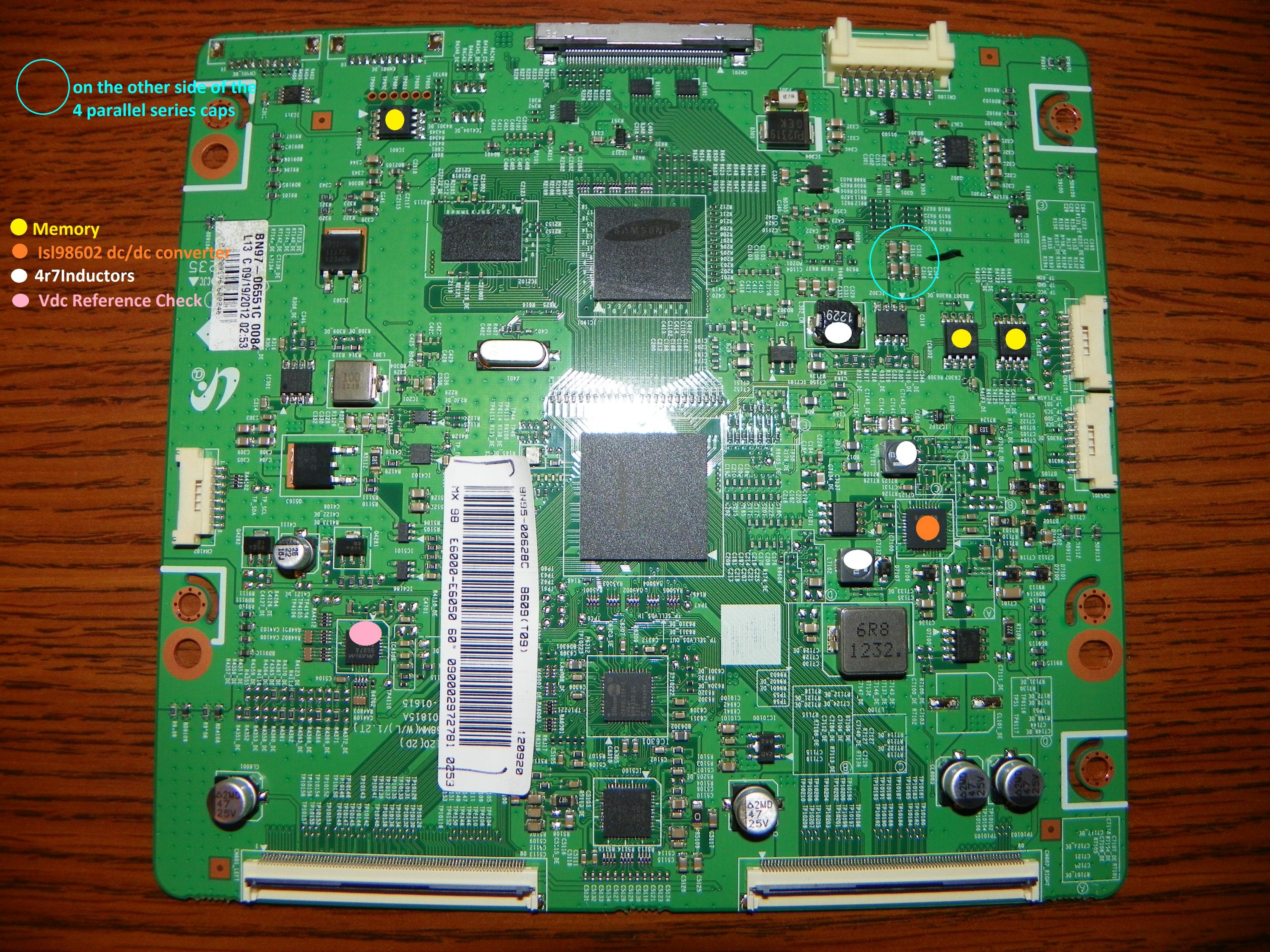

              Hi Bud, Thanks for the reply! I tried looking up IC7100 for 30 min or so...could not find the exact component. I did find something that led me to believe the chip ZI found would measure voltages? The updated picture is what I have so far...

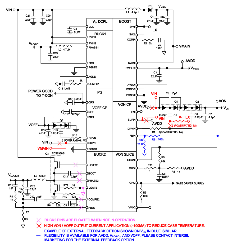

                Did you find the numbers for IC 301, 302?
                ISL98602 App notes Sch.
