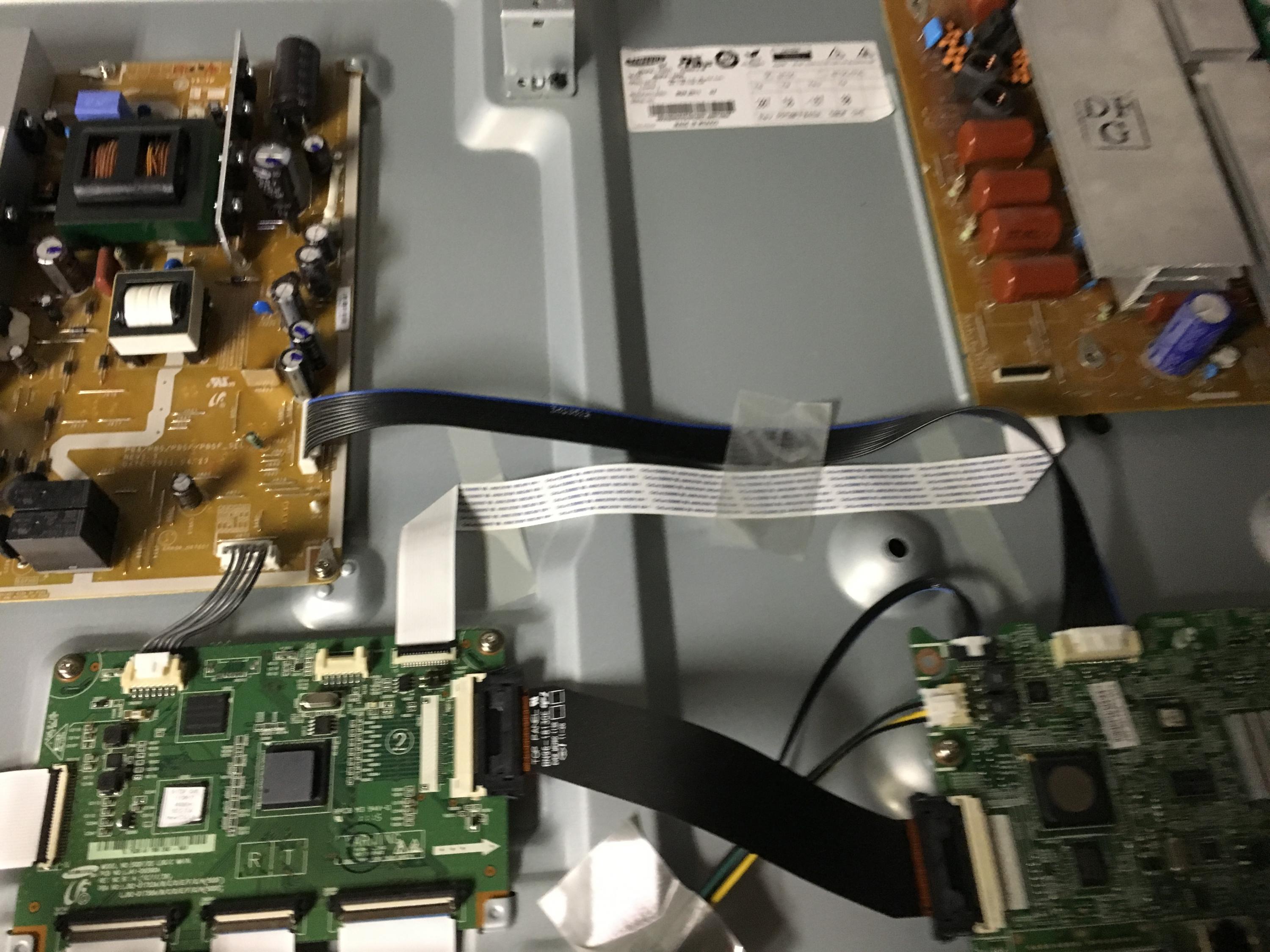

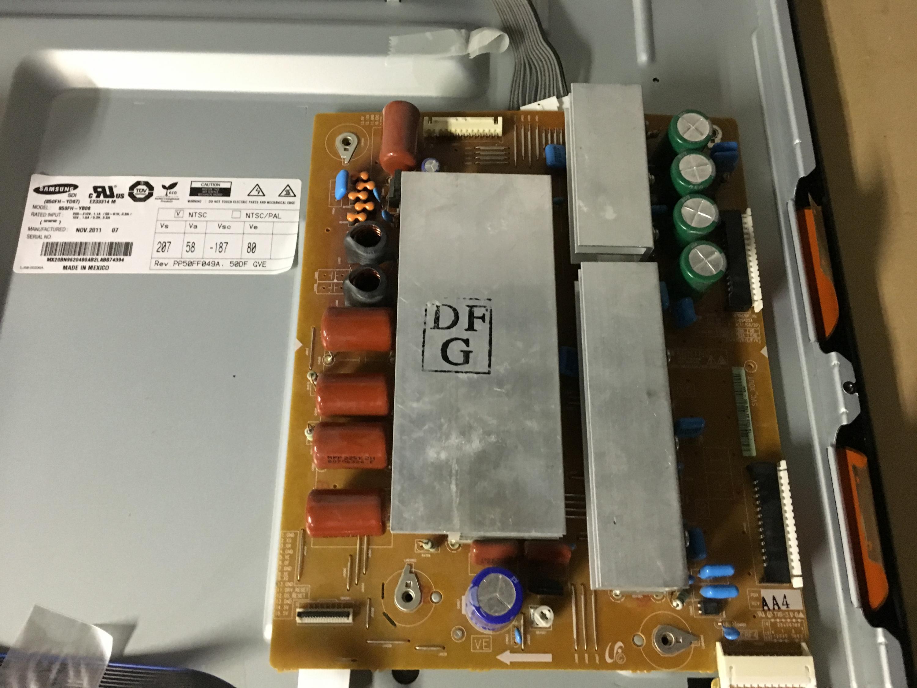

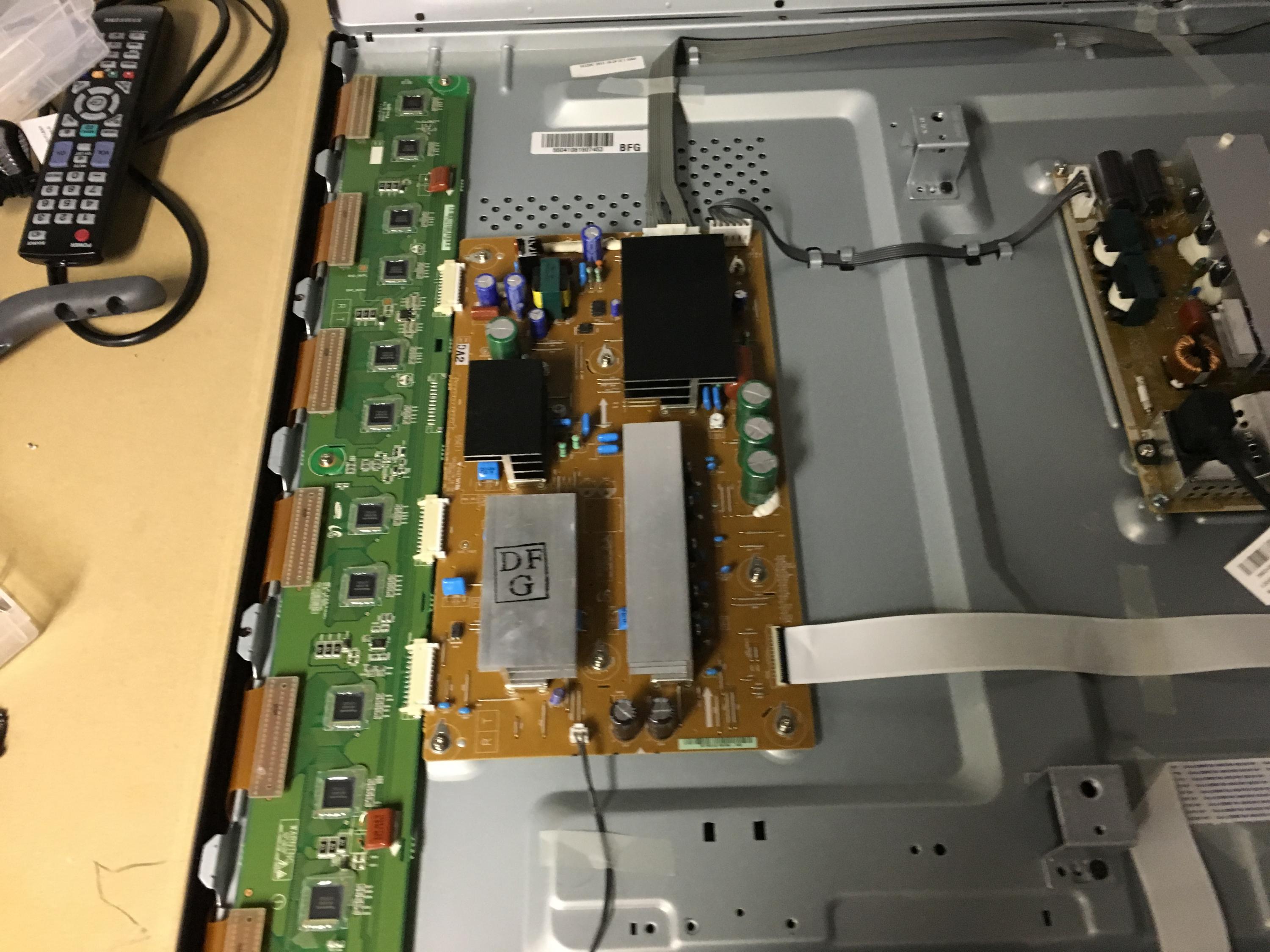

This tv would keep clicking when the power was applied. I found that when I remove the connector going from the XSUS board to the YSUS board, the voltages would all stay on. I found 4 shorted IGBT transistors on the X main. I replaced all of them and I even replaced all of the gate drive ICs. I connected everything except for the ribbon cable going from the control board to the XSUS. The power came on and all the voltages were present, VE, VSCAN, VS and VA. I then connected the ribbon cable going from the control board to the XSUS. I turned the power on and there was a pop and I found that all the IGBTs are shorted again. What the hell?? Worked fine until the ribbon is connected?
Any idea what caused this??

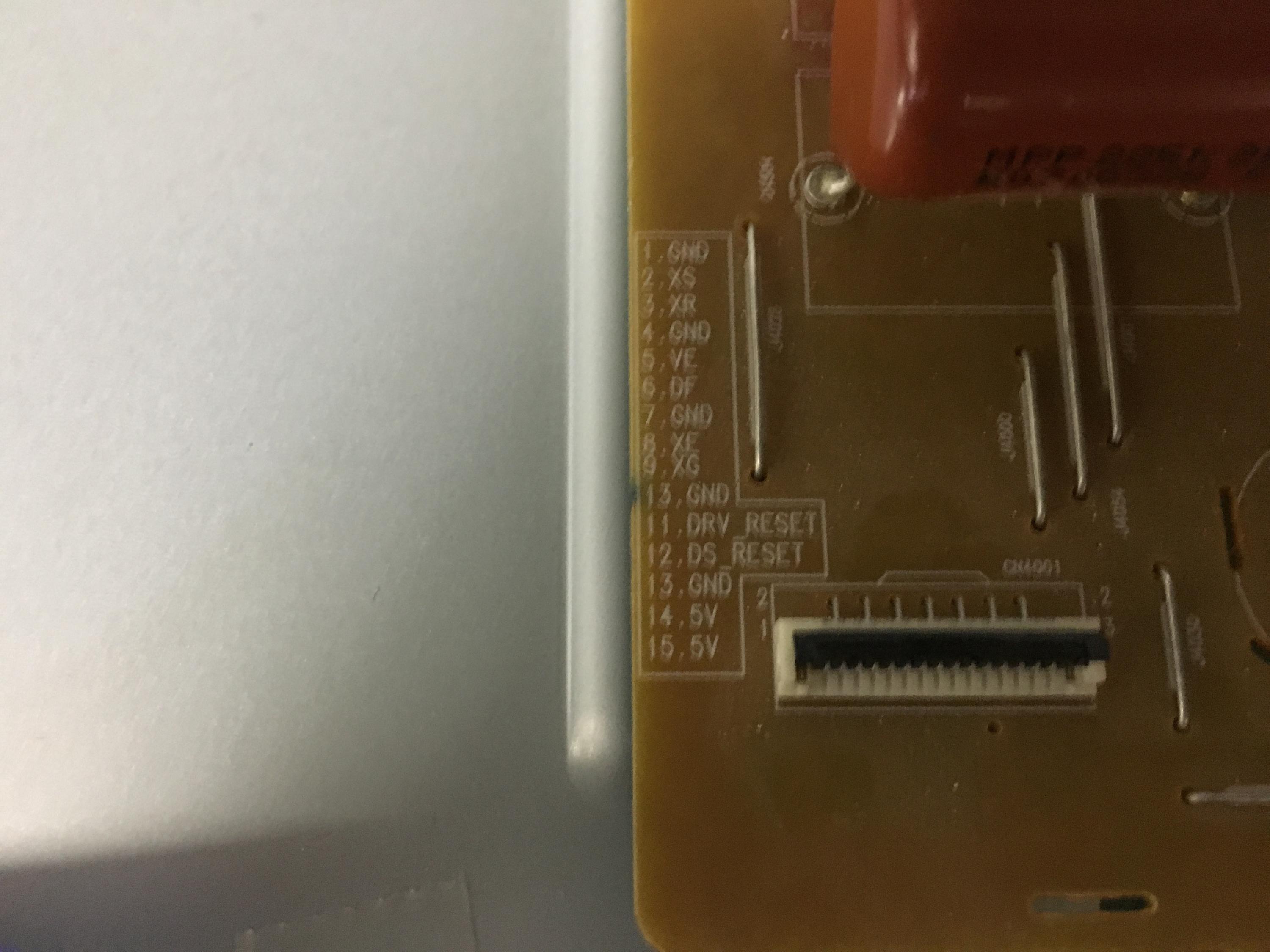

See pics below. One of the pics is for the ribbon cable that goes from the control board to the XSUS.
