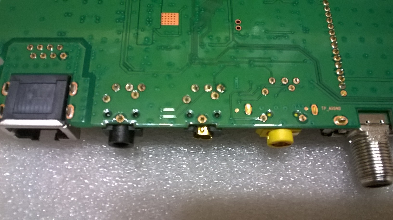

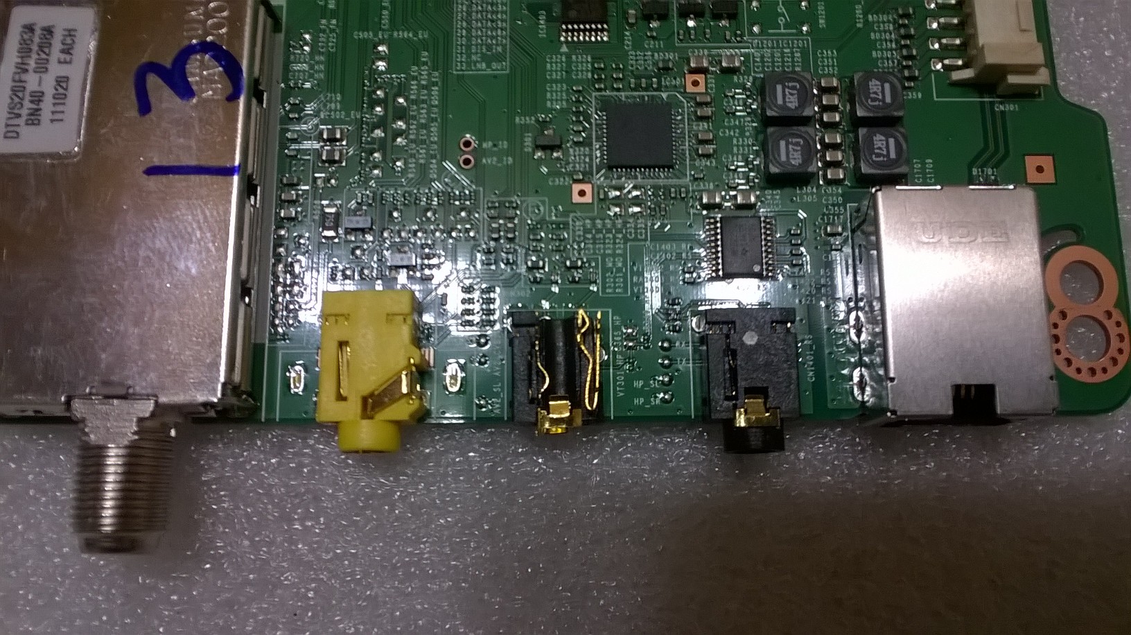

    Samsung UN55D6050TFXZA Audio output Jack
    Anybody know where I can buy a replacement low level audio output jack?
    This main board is expensive, 130.00 to 160.00 on ebay...
    I can replace the jack if I could find one Help
  • CapLeaker
    Leaking Member
    • Dec 2014
    • 8352
    Re: Samsung UN55D6050TFXZA Audio output Jack
    Go to mouser.com look into phone connectors and match something up.
    • high-tech
      • Sep 2010
      • 197
      I fixed this board using a headphone extension cable, I cut the cable and soldered the female end of the cable to the broken audio jack it now has audio output!!!
      Problem Solved
