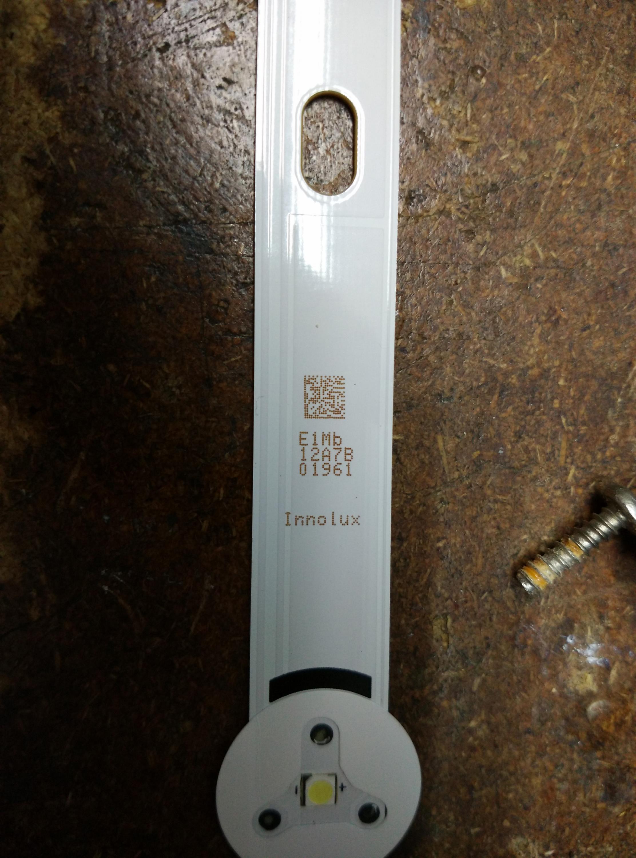

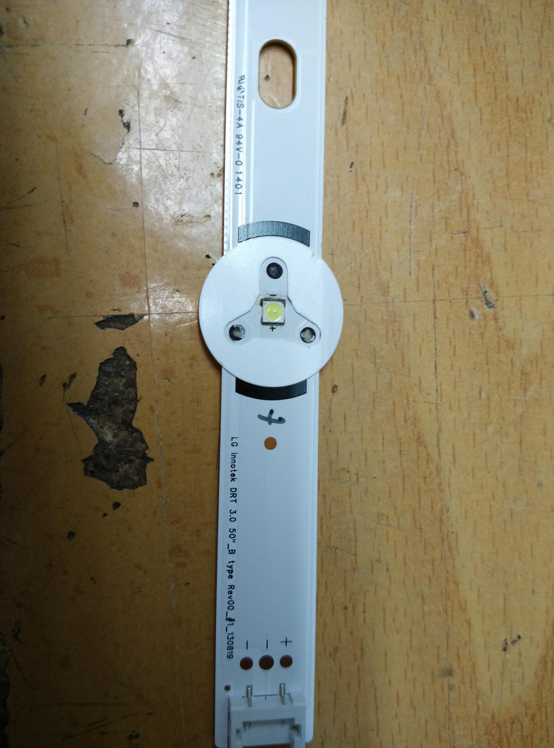

                    Can we see the pictures of the LED strips in your TV?
                    • PatrickSaw
                      • Nov 2015
                      • 20
                      • Spain
                      Re: LG LED 50LB5610: Display blinks
                      Yes of course! It lights on 4-5v.
                        Ah yes, those are commonly failed LED type.
                        LG INNOLUX LEDs
                        Luckily it is Back-lit not Edge-lit.
                        Once you get it fixed you should turn down the Backlights level in the on screen user menu as low as possible to extend the LED's life.
                            More room on the backlights LED strip than the Edge lit strip which LEDs are crowded together.
                            I would go with 1W, 0.5W is less than 200 mA current limit, some of these strips are driven with more than 200mA, not much room for margin with 0.5W LED.
