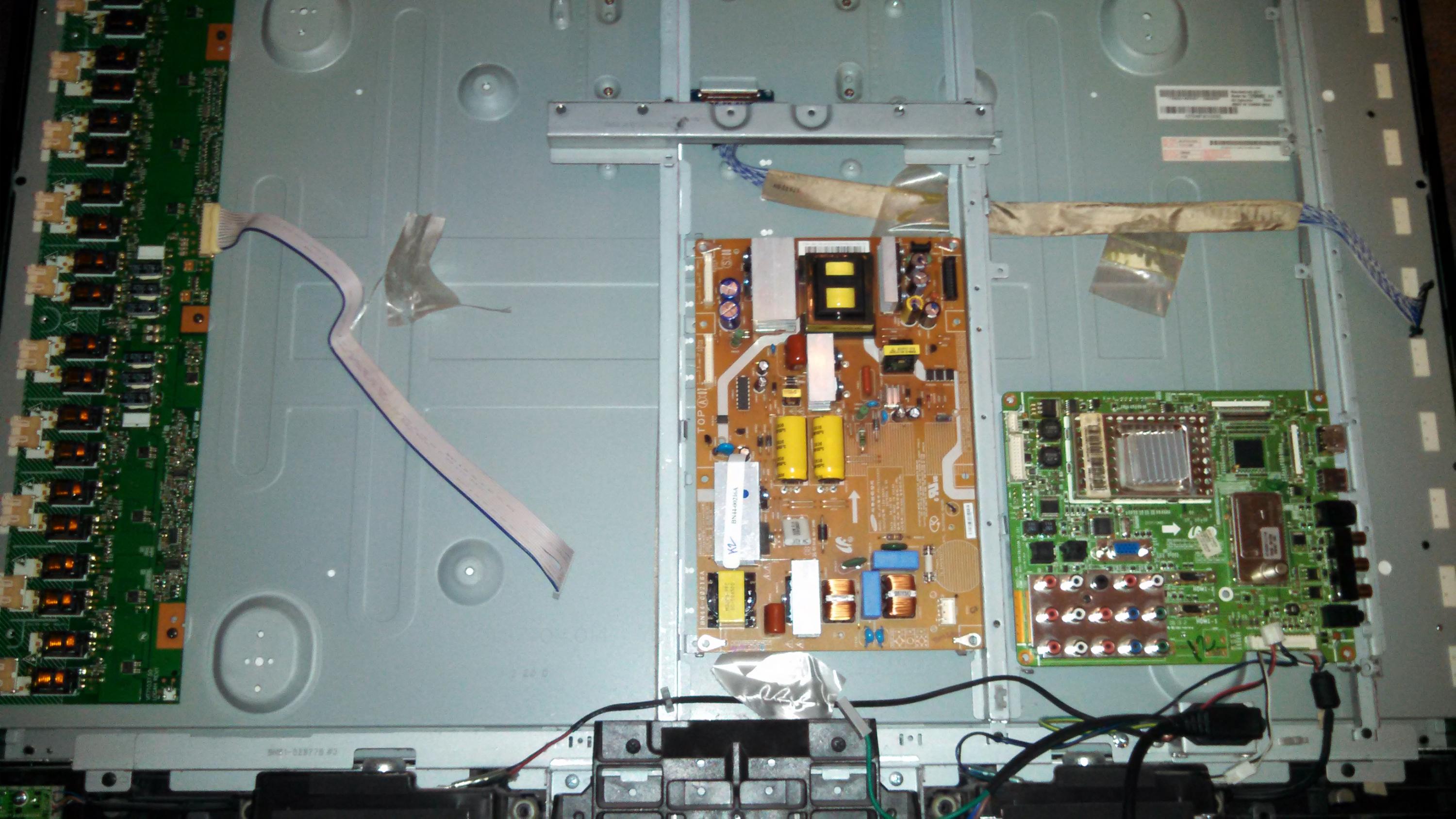

    I am a retired electrician trying to fix my niece's tv. Her house was struck by lightning. They lived with it cycling on off for awhile. I replaced several distorted caps. When the TV is plugged in standby light flashes, blue indicator comes on in front, chime sounds and backlight comes on for about 5 seconds. I have read through many posts and have gleaned a lot of good info. I tried resetting the eeprom which is on the front of the main board and it makes no difference. From my power supply CMN802, I have 4.1 vdc on pin 1 and the same on pin 3 st-by. I notice no drop in voltage when I hit the power on. The other voltages at that plug are where they should be. On CMN803 I have th 24v on pins 1-5, A/D 3.5 with BL on/off & PD with 0 v. I can disconnect connectors from the main board and jump 1 & 3 (CMN802) and 1 & 5 (CMN801) and turn the backlight back on. Where do I go from here?

    Re: Samsung ln37a550p3fxza
    Posting pictures of the back of your tv showing the boards with clear pictures may help you more with fixing your problem

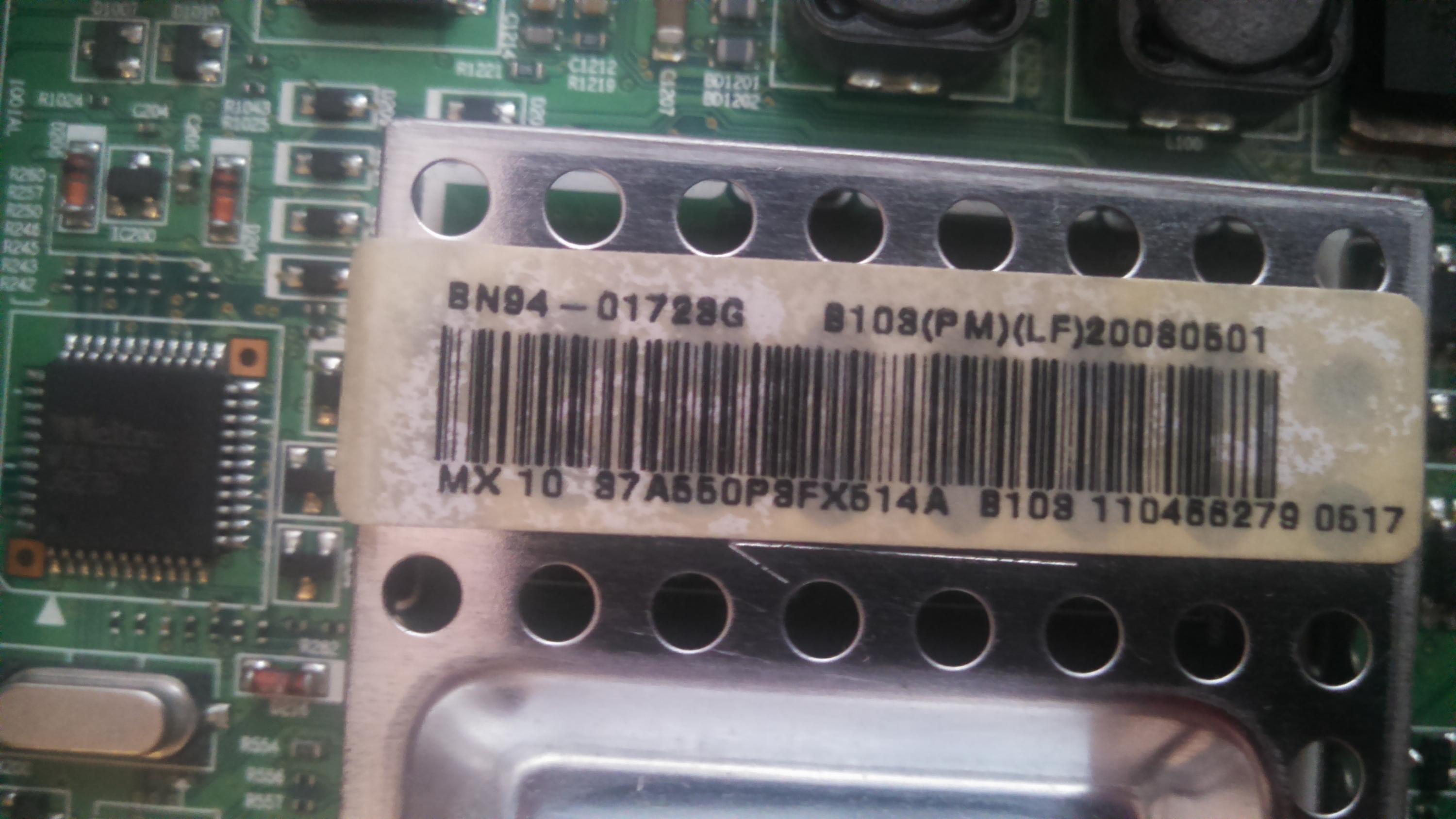

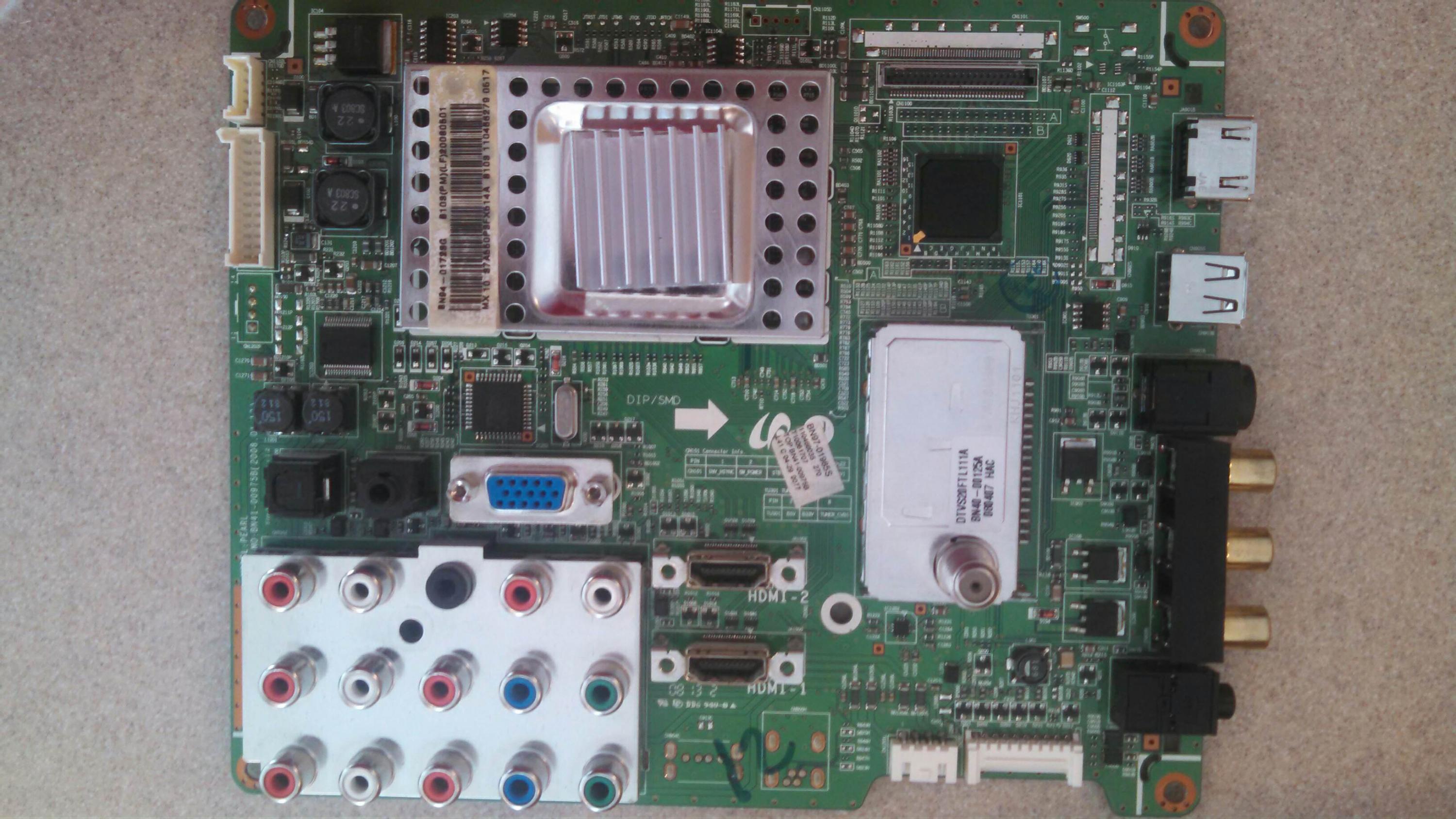

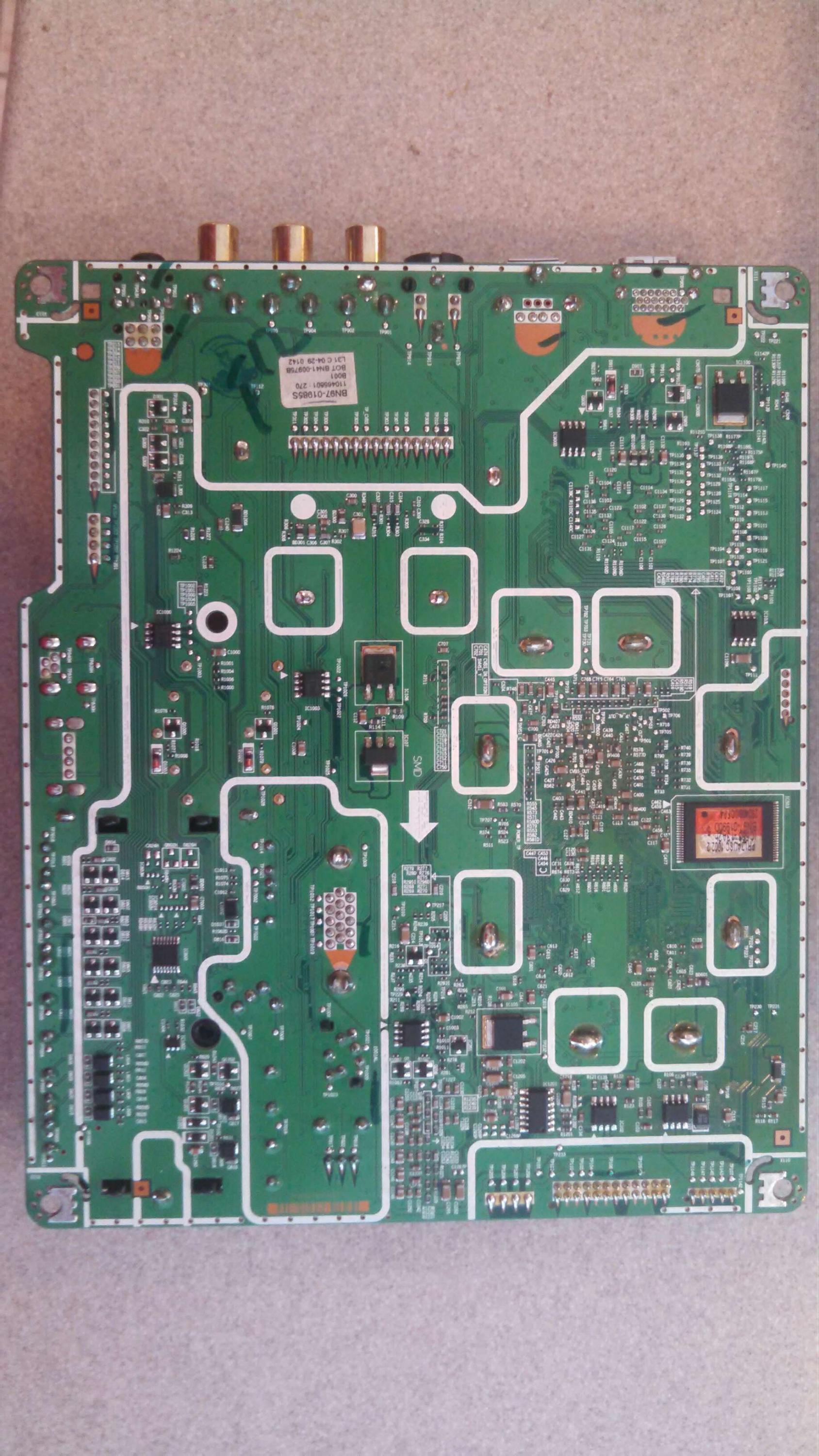

      Give us a good focused picture of the back of the main board. These "A" model main boards need C102 replaced.
        Hope this shows up clear enough.
