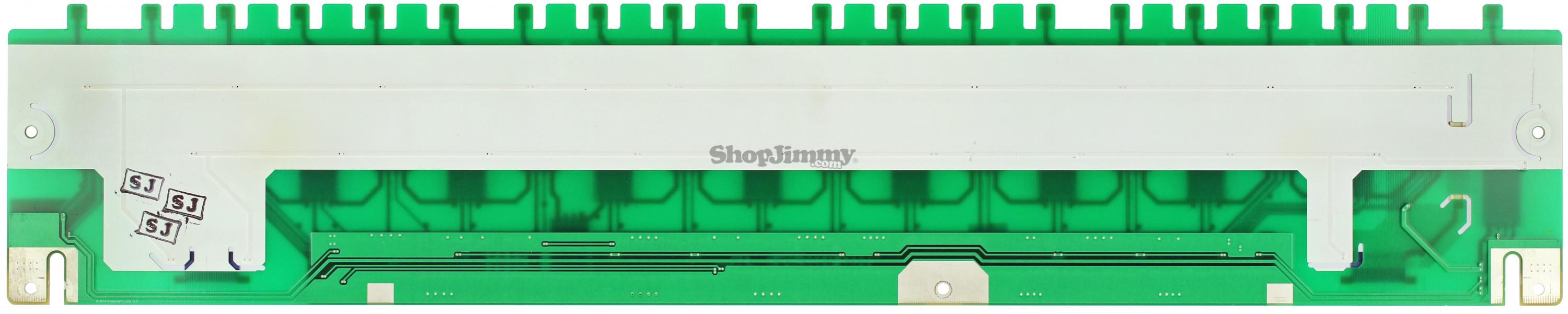

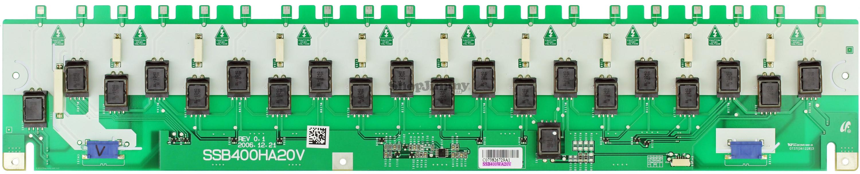

                                Re: Samsung LE40m87BD ... no backlight

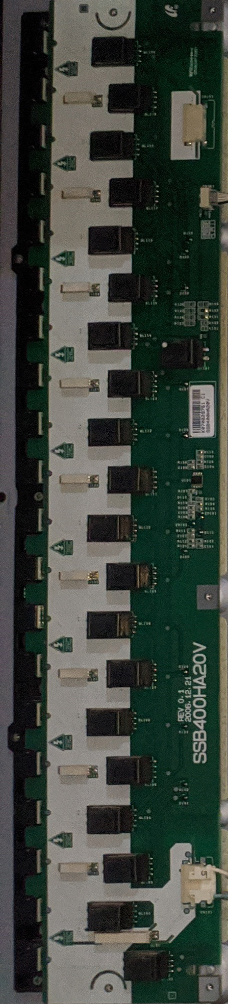

                                Reseat the HV connector on the balancer board, then check the resistance between the two top pins of those balance transformers to see if any one of them show open circuit.
                                Pictures provided by shopjimmy.
                                Samsung SSB400HA20V
                                  #36
                                  Samsung SSB400HA20V
                                  Nope, none of them is open, they all measure in the range of 270~285Ohm.
                                  But I think I screwed up and toasted the inverter transformer.
                                  I had unplugged that HV connector to take a look at the back of that inverter board but forgot to replug it; it managed to 'hide' between the housing and the inverter board and I didn't saw that. I turned on the TV and as soon the HV was getting through, the transformer began to hiss loud and that plug was half fried and black; I guess it was arcing because it was pushed against the housing (ground) by the inverter board. Now the resistance between the two HV pins is only 22 ohm, also the resistance between those pins and ground is 11 ohm. If I turn on the TV that plug is instantly set on fire so .... not good!
                                  You agree it's dead or are those resistances normal?
                                  I don't know how to check that transformer another way. I sure am not comfortable now to do that HV test with the CFL bulb.
                                  I think the CCFL's are dead anyway so maybe it's time to give up on it before I burn down the house.
                                    At this it sounds like the HV section is toasted.
                                    I am not sure how much money you will wnat to spend to get back where we do not have the lamps light up but have HV from the inverter board.
                                    But at least now you know how to find out if the HV is present or not in the inverter section using the lamp probe.

                                        Because I couldn't resist it, I desoldered the main inverter transformer (TI801S) and measured the two secundary windings and they both gave an OL, so 'open' winding. So I guess the transformer is definately toasted... pity.

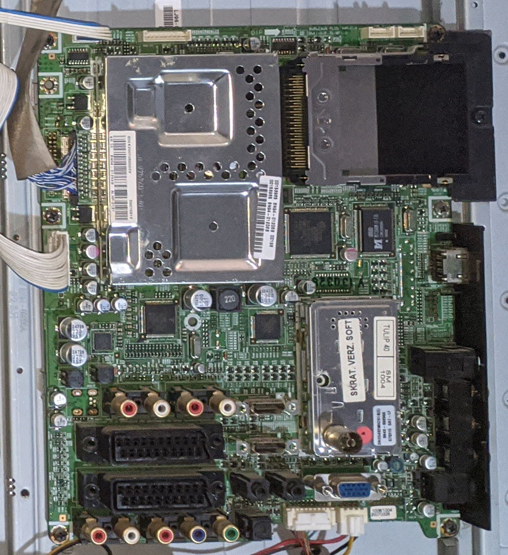

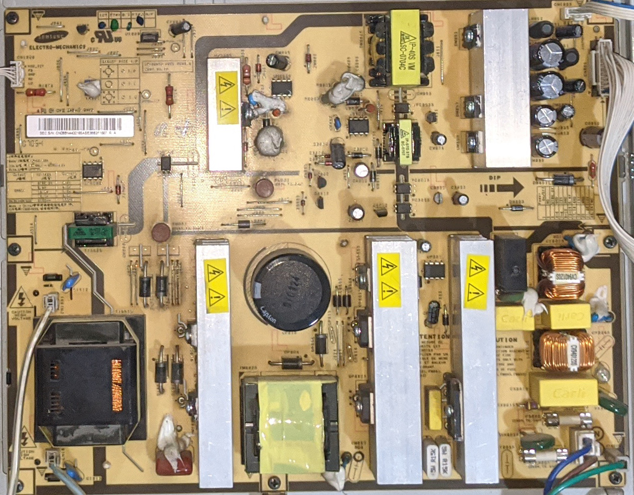

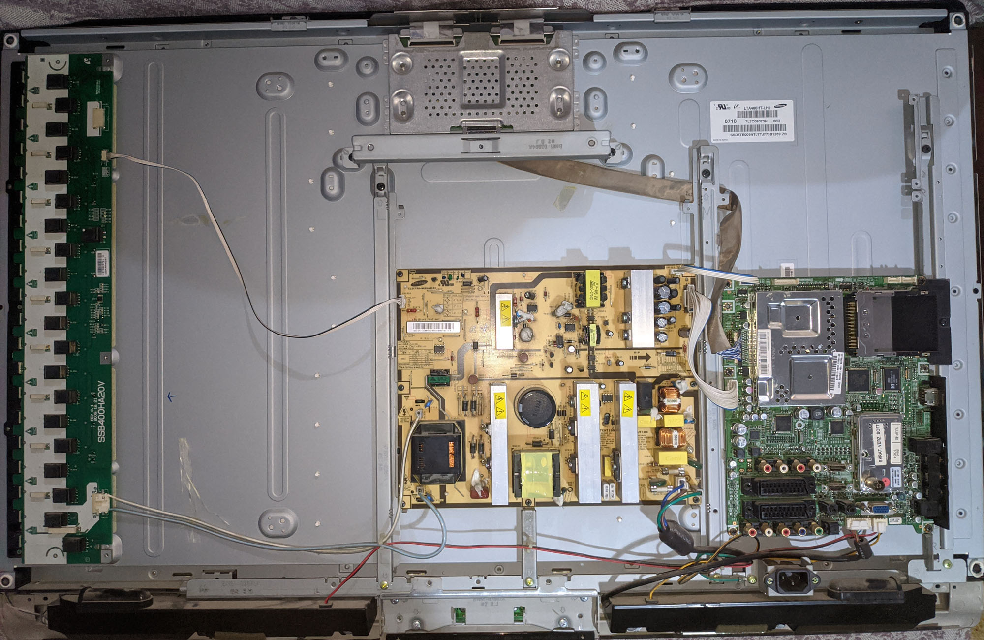

                                          This is what happens exactly:
                                          Eyou should see the backlights flash on for seconds then the protection circuity will kick in to shutdown the high Voltage.
                                          I can verify that I can see for a second the image on the screen, then the screen gets dark.
                                          Then I get a spotlight and I can see that there is actually image on the monitor, it's just the CCFL backlight that turned off.
                                          I already disassembled monitor and noticed that during the above test, I can smell something burnt from the area where the SSB400HA20V is located.
                                          I don't have experience with LCD TV repair.
                                          I only have limited LCD monitor repair, but nothing advanced, mainly recapping.
                                          The caps look OK on the psu and the mainboard.
                                          So, I don't know how to tell if the issue is in the SSB400HA20V board or one of the CCFL lamps itself.
                                          I painted a blue arrow here:
                                          https://www.badcaps.net/forum/attach...1&d=1642369772
                                          showing where the burnt smell seems to come from.
                                          So, what should be my next step? I absolutely don't want to make things worse with that TV set.
