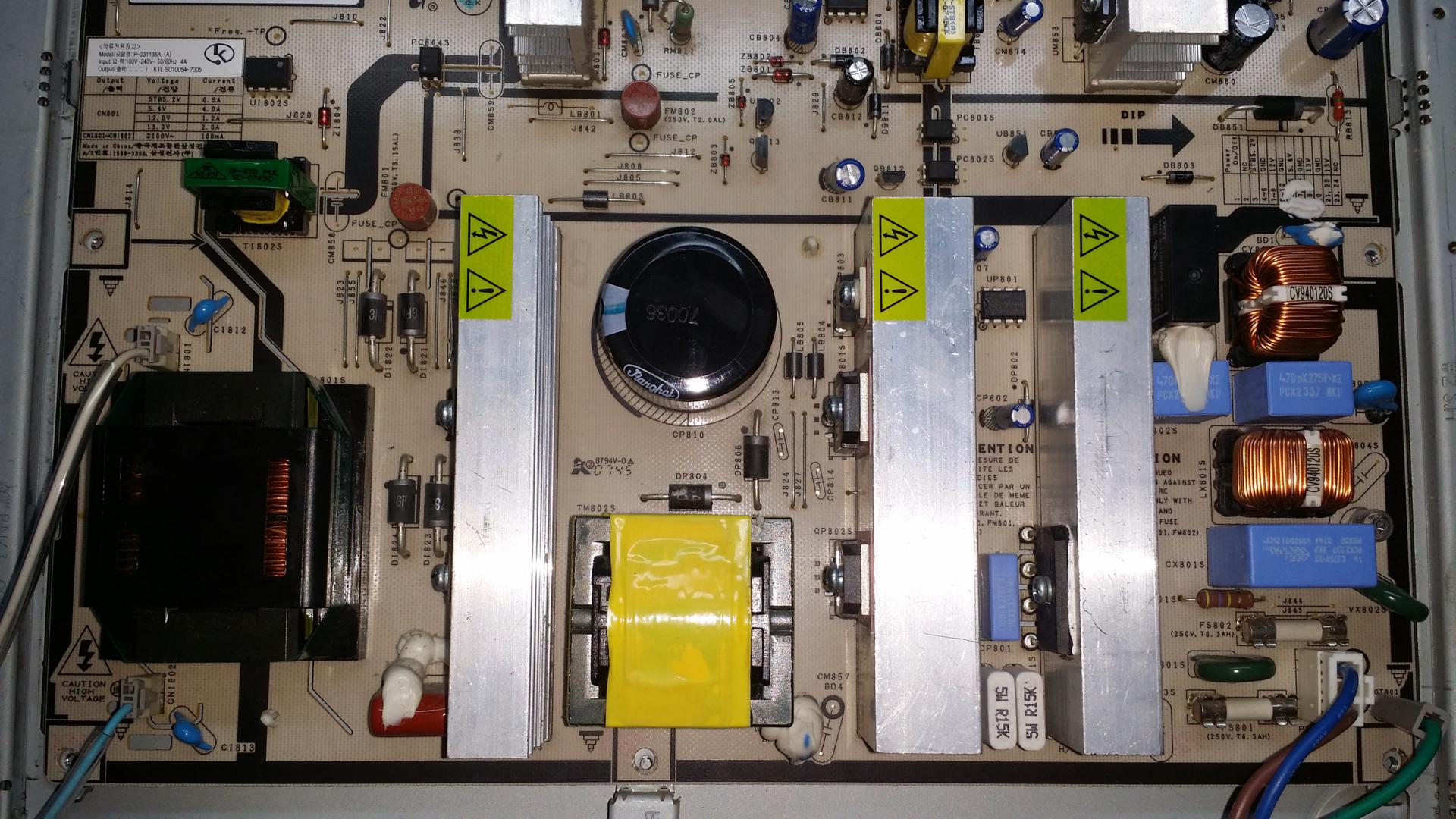

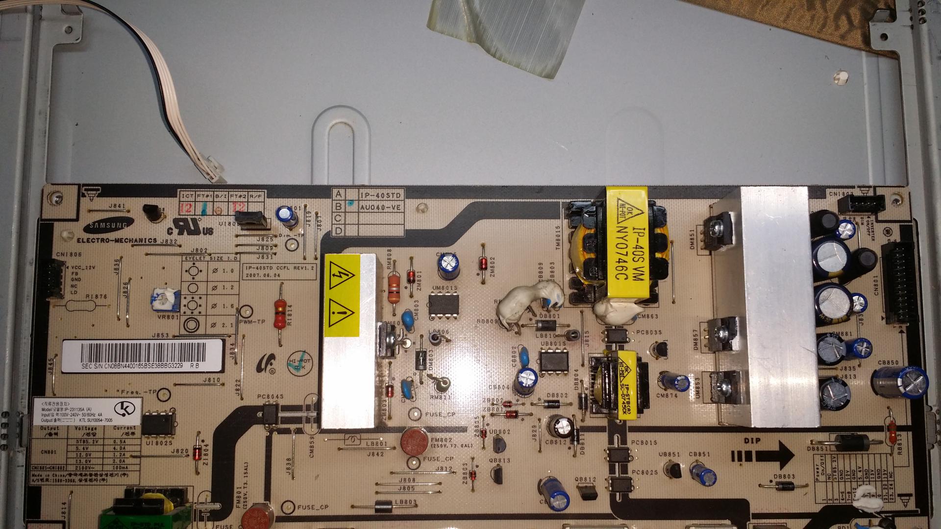

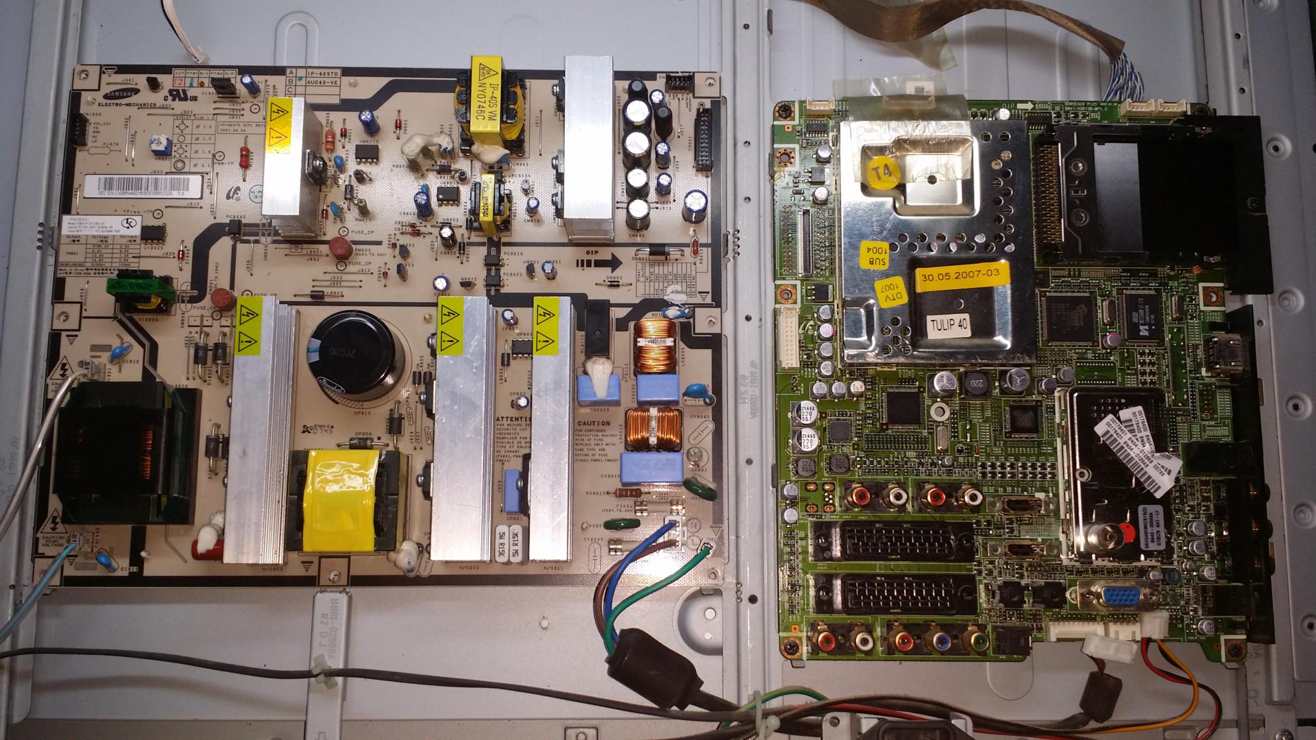

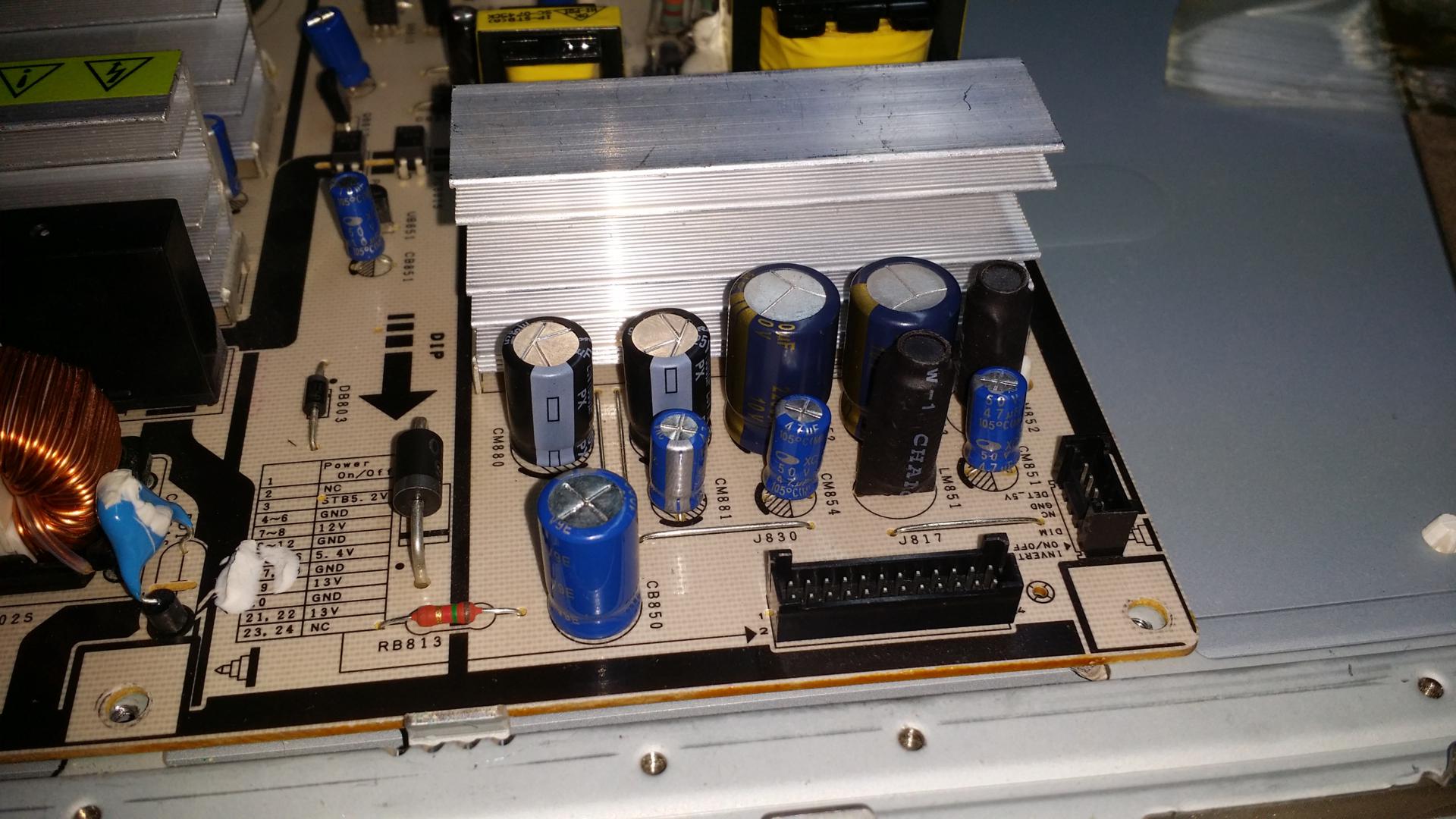

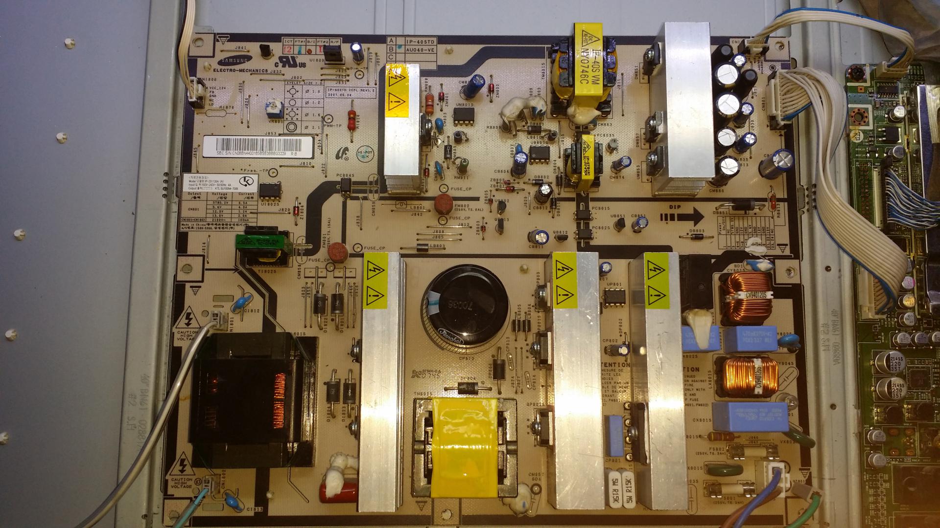

    Here I have this nice LCD television which from one day to the next gave no backlight anymore. The led in the on/off button flashes 5 times and then nothing at all. Relais clicks as usual when I push the button to power it on / off. Looked at it with a flashlight, I'm seeing the TV menu (no source connected) so the screen is there (so, T-con board OK?!) but no backlight, not even a flash. When I turn on the TV and let it stand for awhile, he switches off so I guess something is going hot and goes in shutdown. Also, if it stays a while in standby mode, it switches on, so I don't really know what is going on exactly. My priority is to get the BL back on and then to the auto shutdown/activate issue.
    I have changed the four caps on the right top side of the powerboard, these are 2x 1000uF 25v and 2x 2200uF 10v ... kept the capacitance but changed the 10v ones to 25v. The originals where Samyoung brand and were not bulged or damaged in any way but changed them anyway because others had these four caps bulged when having problems with their display. The large filter cap is doing some 320v when in standby mode and 390v when powered on, so I guess that's OK and also means the PFC booster is working (I guess).
    I already measured the most common voltages on the powerboard which is a power/combi board with modelnr: IP-231135A / BN44-00165B (yes, not an 'A' on the end, so it's another revision than other folks has so the schematics don't match completely).
    All these voltages were taken with the TV running.

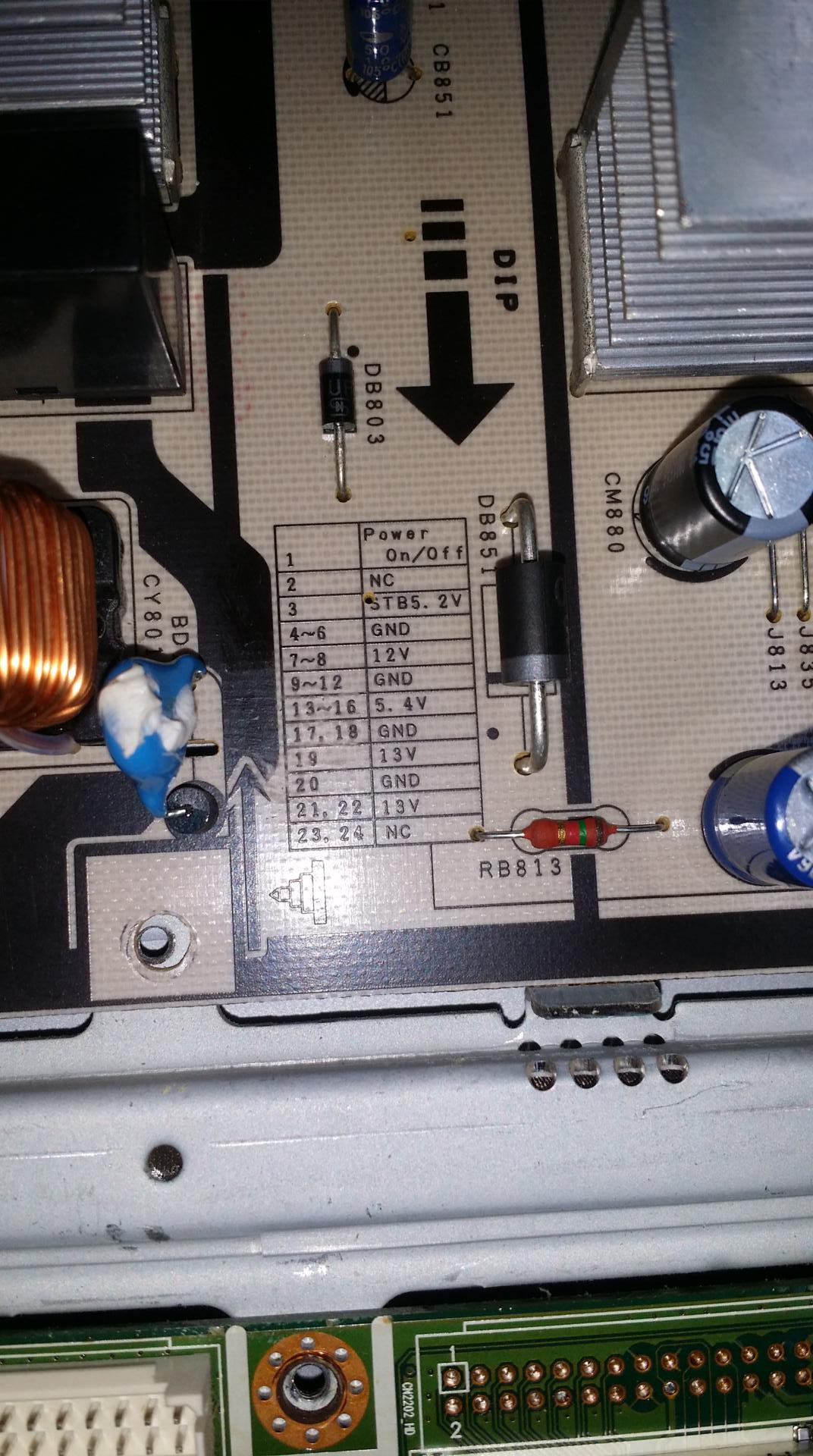

    CN801, (top right, right side), 24 pins, comes from main board):
    01. (pwr on/off) = 2.18v
    02. (NC)
    03. (stb5.2v) = 5.99v
    04~06 (GND)
    07~08 (12V) = 12.04v
    09~12 (GND)
    13~16 (5.4v) = 5.55v
    17~18 (GND)
    19 (13v) = 13,54v
    20 (GND)
    21~22 (13v) = 13,54v
    23~24 (NC) = 0v
    As you can see are ALL voltages accounted for, I only don't know what voltage pin 01 (power on/off) would be normally and pin 03 (standby 5.2v) is nearly 6v, a bit too high but maybe that's normal. Also, the 13v pins are also 0.5v higher.

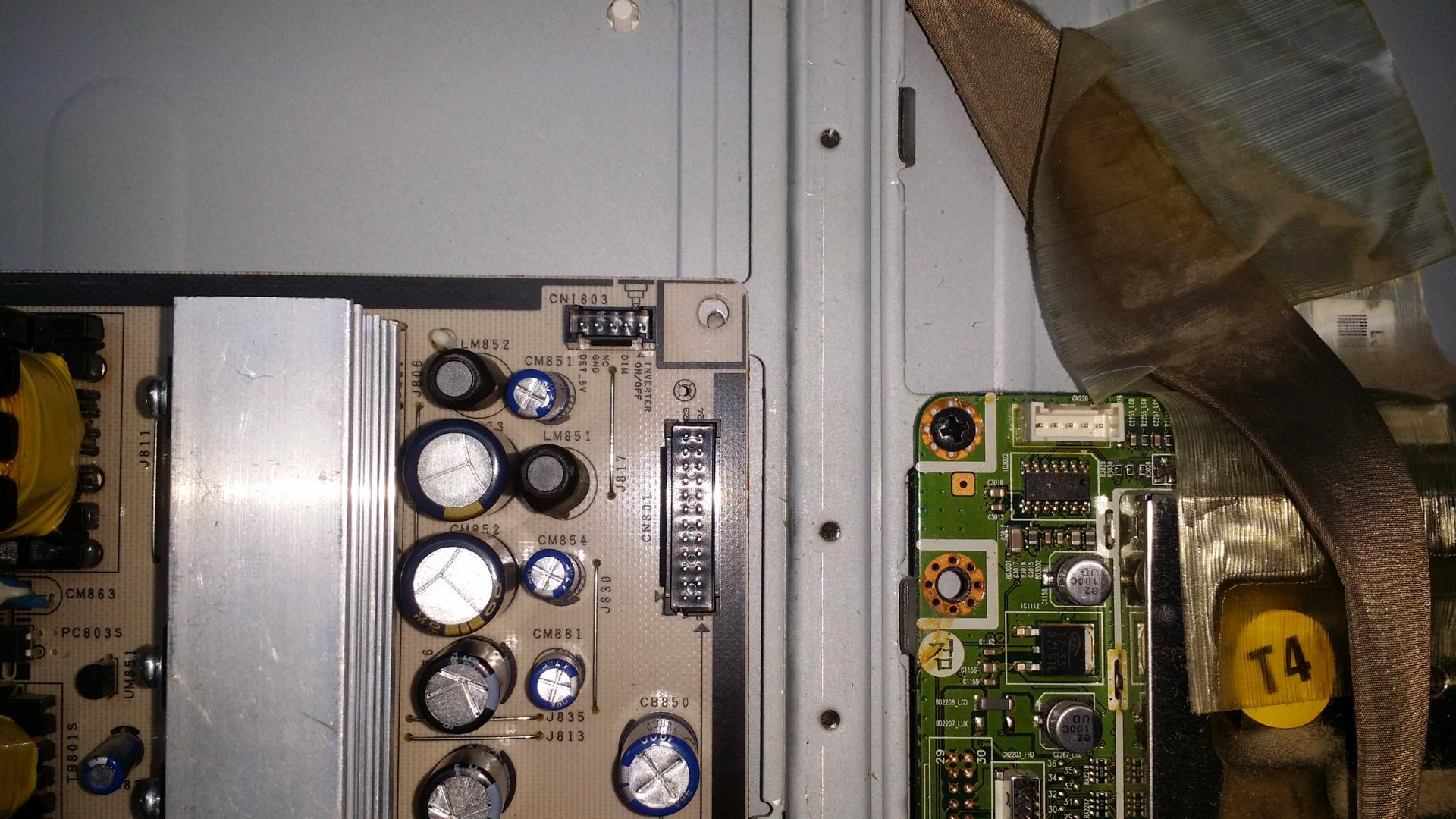

    CNI803, (top right, top row), 5 pins, comes from main board:
    01. (Inverter on/off) = 5,35v
    02. (DIM) = 3,45v
    03. (NC) = 5.8v (??)
    04. (GND)
    05. (DET_5v) = 5,58v
    pin 01 goes to 5,35v when the LED has flashed 5 times and an image is displayed but the BL remains off. I'm guessing this Inverter pin is the same as the BLON pin on some other Samsung TV's so the BL is getting its 'turn-on' signal from the main board.

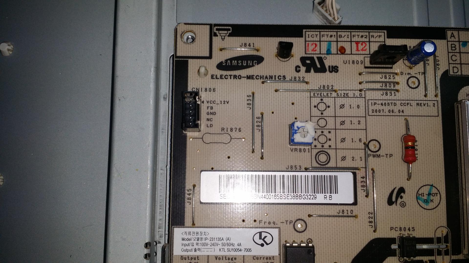

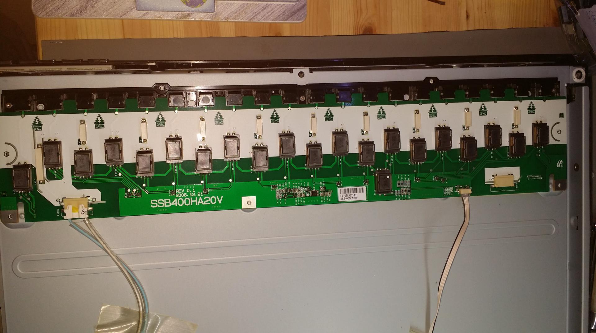

    CNI806, (top right, left side), 4 pins, going to inverter balancer board with modelnr: SSB400HA20V.
    01. (VCC_12v) = 12.04v (must drop when BL goes lit... doesn't now).
    02. (FB) = 0v
    03. (GND)
    04. (NC) = 0v
    05. (LD) = 10.58v
    I don't know if 'FB' has to show a voltage, what's it for anyway? And what is the 'LD' pin for? I can't seem to find the 24v for the BL, where do I have to measure for it?
    The four fuses on the powerboard are OK. The inverter balancer board don't have a fuse on it. The two power mosfets next to the inverter transformer are OK.
    If more (detailed) pics are needed I'll post them.

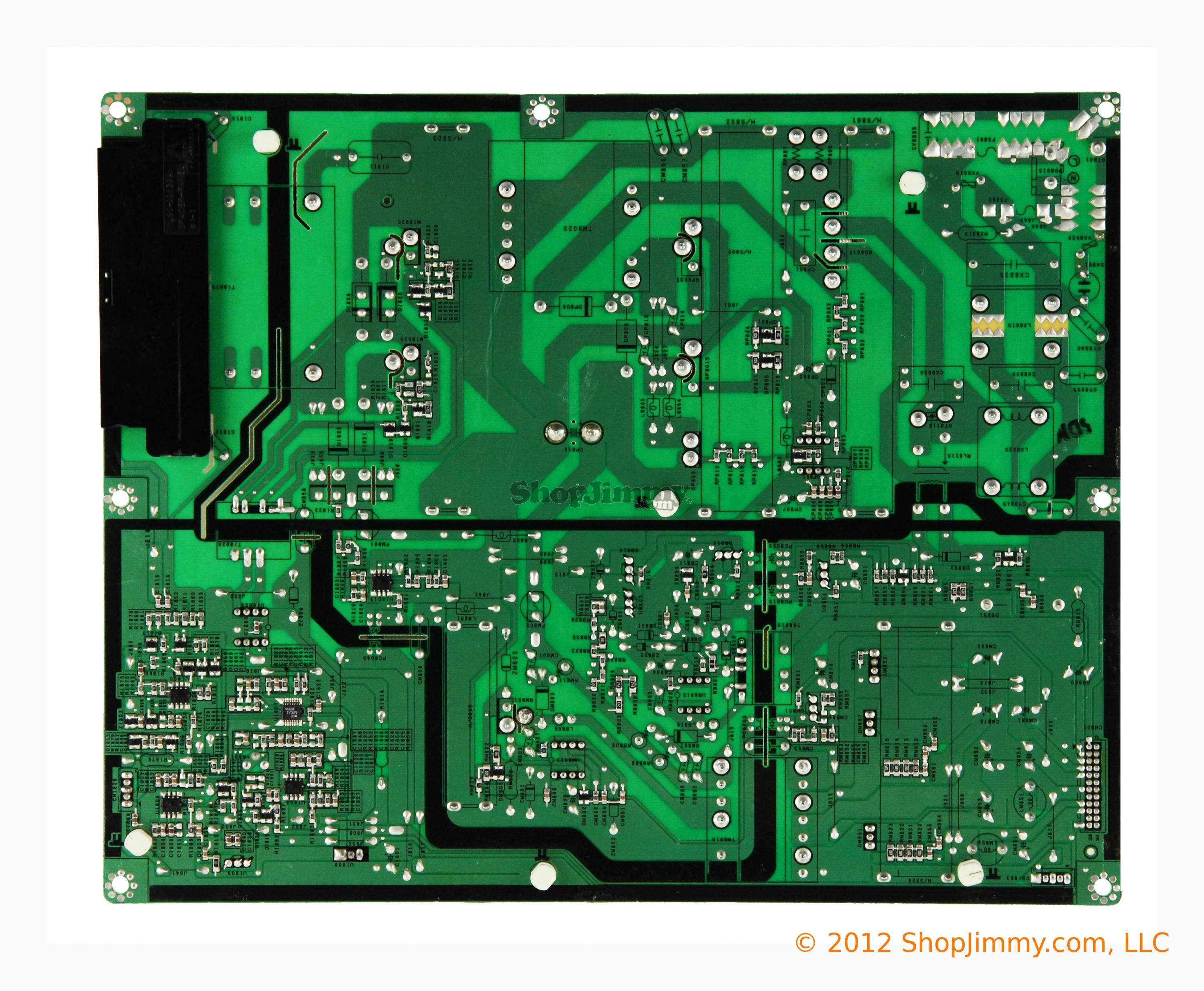

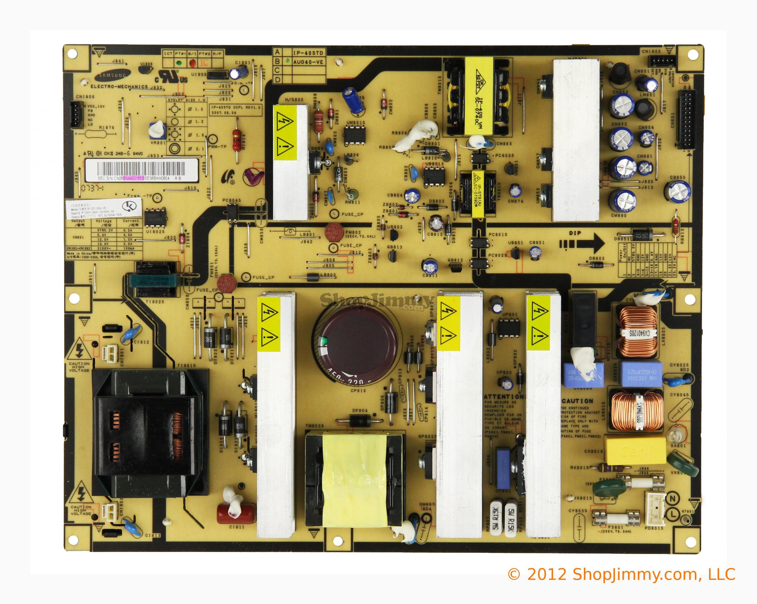

        Is that the reading with black probe of the meter connected to the negative leg of the main filter cap which is the GND ref for the DC primary circuit?
        If you are getting only 290VDC then then the PFC Voltage booster is not working, please recheck the DCV right between the two legs of the main filter cap, it should be close to 400VDC.
        May be typo, 390V is the correct number, right?
        http://www.shopjimmy.com/samsung-bn4...pply-unit.htm#
        Pictures provided by shopjimmy.

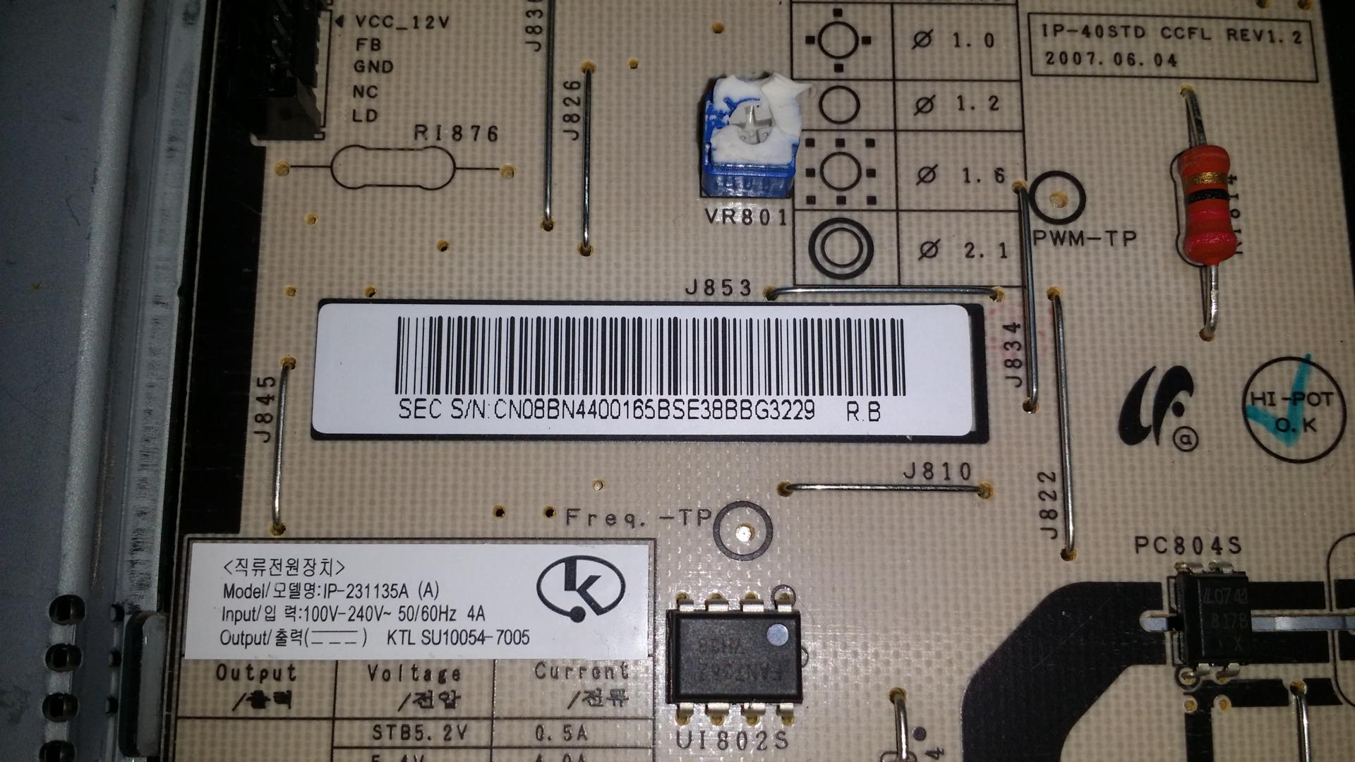

          Can you read the P/N of one of the inverter circuit 8-PIN DIP IC UI802S? FAN7382? This IC drives the Gate drive transformer TI802S which drive the two Power MOSFETS MI801s, MI802S which then drive the Inverter transformer.
          So far the A version SCH seems to be pretty close as fas as the circuit topology and the parts designators in the inverter section.
            Re: Samsung LE40m87BD ... no backlight
            I rechecked, the voltage on the large filter cap is 390v when TV is powered on.
            The voltage on the two red fuses is also 390v.... I measured it wrong the first time, I used the housing as ground... OK for the secundary side but not the primary.
            That UI802S IC is a FAN7382VH36.
            Only pins 1 and 8 have 12v, the other pins range from 0 to 0.15v.
