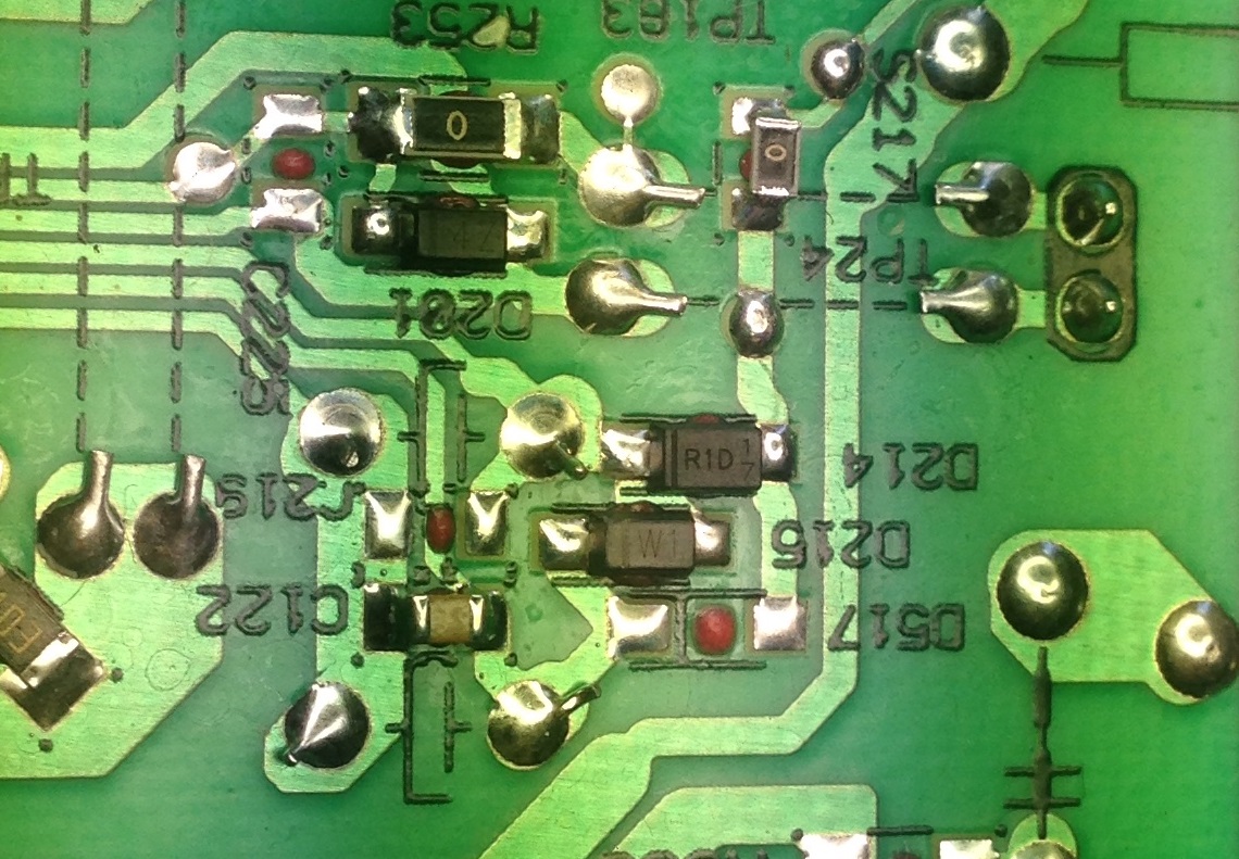

    toshiba 40L1333b psu blown diode help
    I have d201 blown on the back of the psu.
    its marked up as c12v
    what would be a good match for it.

    Re: toshiba 40L1333b psu blown diode help
    Crap ass Vestel. The making you stated is not the diode we need images of it and its position.
      typo
      Diode d201 is blown
      On the schematic is it is shown as d201 c12v
      I cant read anything off the acutal diode as it has popped on where the markings would be.
      I hope that makes it clear.
        so it is a 12V zener going to GND, right next to the opto.
          The marking C12 usually relates to a 12 volt zener diode.

                  • zomi
                    • Nov 2011
                    • 511
                    Pic added
                    off a working board
                    Diode is marked
                    z4 from what I can make out
                    What value is this ?
                      Can I sub in this
                      http://uk.farnell.com/diodes-inc/mms...123/dp/2061479
                      • michael dranfield
                        • Jan 2016
                        • 232
                        • England
                        This does look to be the right diode , yes, the marking on the diode does not mean much as different manufactures use different letter and numbers .
