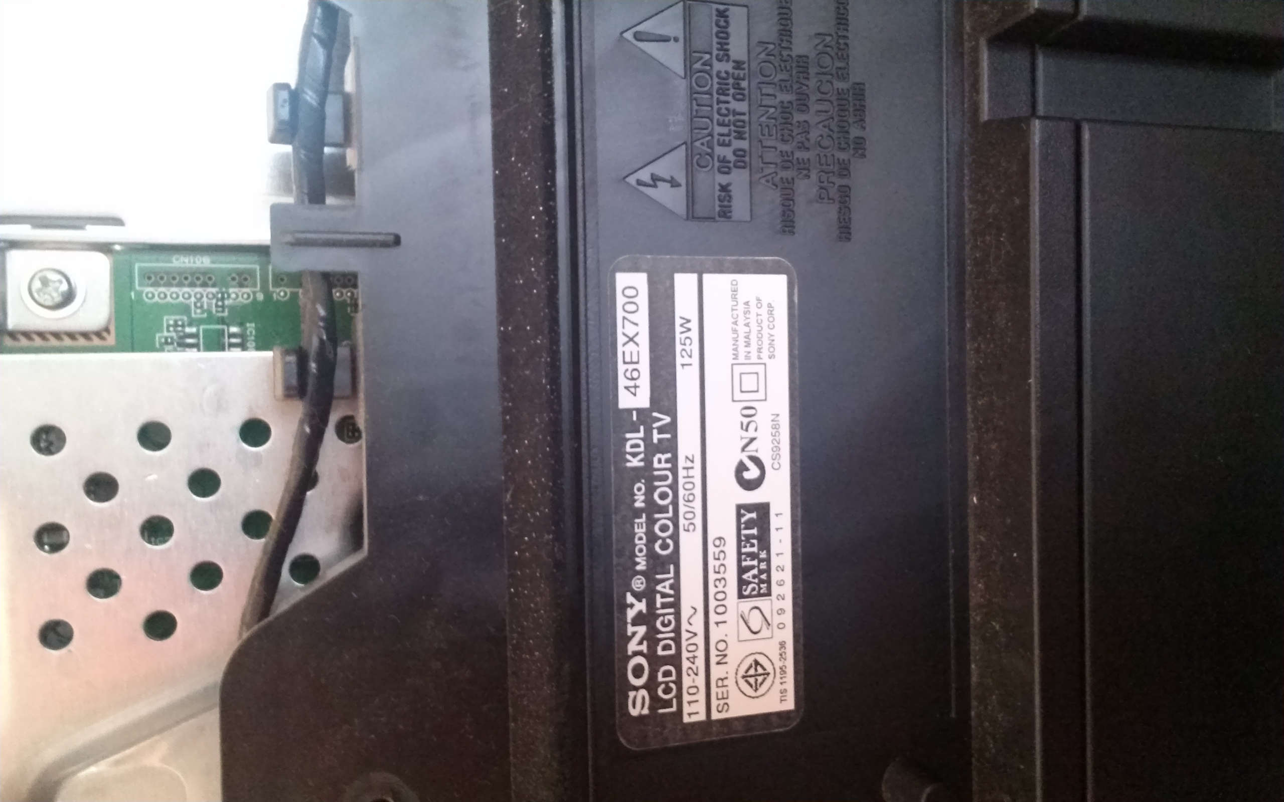

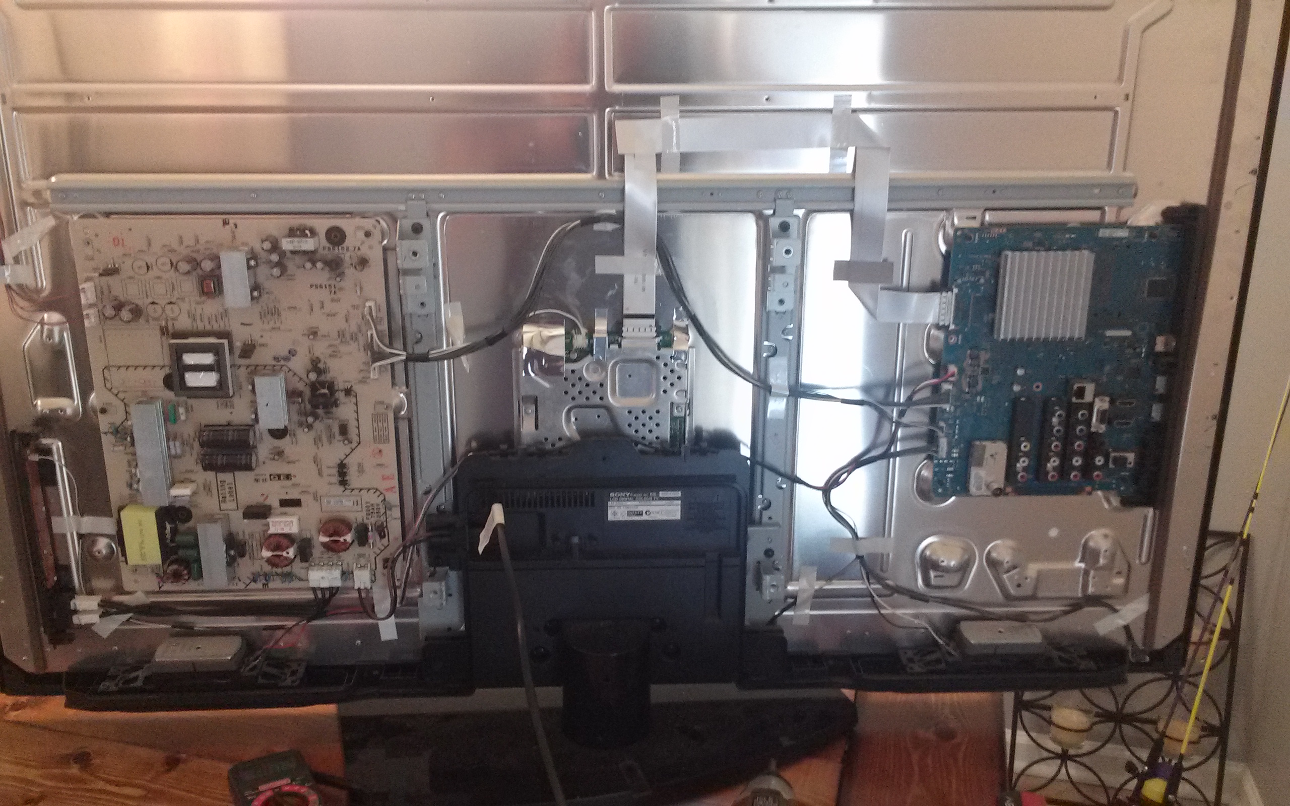

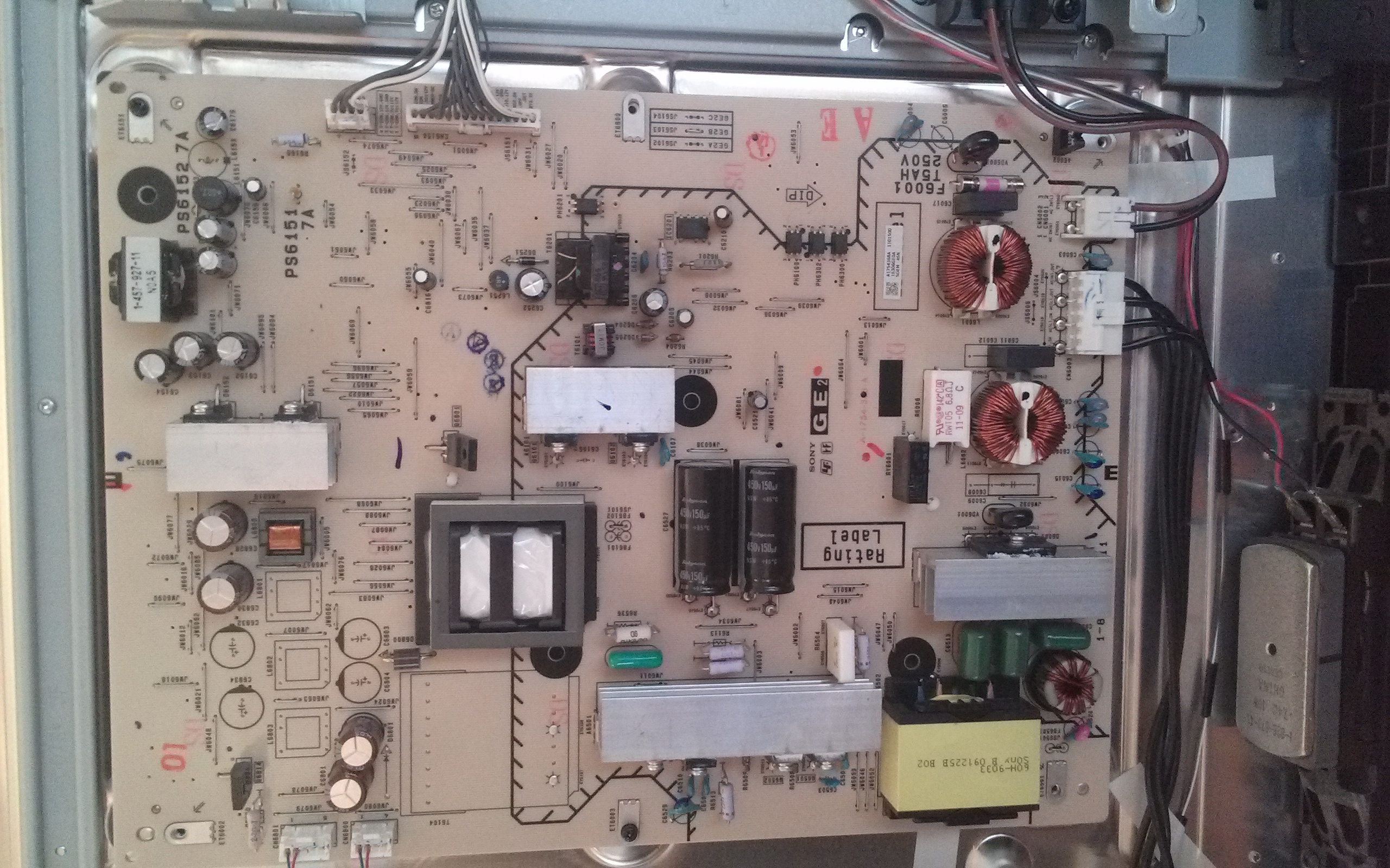

    Tv has standby light on front power supply has stay ,clicks relay once when plugged in then clicks a second time 5 sec later. Here are my voltages in stby
    Main filter caps each 168v
    Cn6150 plug to main board
    0v tcon on
    0v tcon 12v bcc
    0v dimmer
    0v dimmer
    0 bl on
    0v reg 12v
    0v reg 12v
    0v reg 12v gnd
    0v reg 12v gnd
    0v audio 12v gnd
    0v audio 12v
    0v power on
    3.3v a.c. off debt
    3.3v stay
    Cn6151 plug to tcon
    0v 12v gnd
    0v 12v gnd
    0v 12v vcc
    0v 12v vcc
    When power button is pressed I get
    Cn6150 plug to main
    0v tcon on
    0v tcon bcc
    1.6v quick flash dimmer dc
    .5v quick flash dimmer
    0v bl on
    3.3v quick flash bl err
    12.8v regulated till relay clicks about 3sec
    0v 12v reg gnd
    0v 12v reg gnd
    0v audio 12v gnd
    12.8v audio on
    3.3v ps on
    3.3v a.c. off debt
    3.3v stay
    Large filter caps go to 392v
    Cn6800 backlight plug
    Out 1- flashes to about 190v
    Out 2- flashes to about 190v
    Can u help me ? Lol

    Well the 0V measured on the BLon pin isn't doing any good when the TV is on. That comes from the main board.

        Re: Sony kdl-46ex700 wont power on
        BLon = Back Light On.
        STBY voltage is on all the time from the power supply and that gets fed to the main board. When you turn on the TV with the button, the main board sends PSon (power supply on) and BLon back to the power supply. It in turn will turn on all voltage rails and the back light. TV is on.
        Check again the PSon and the BLon at the power supply with the TV on.

          I double checked and I get no bl on voltage when the TV turns on. It only turns on for a few seconds then shuts down. I have to unplug and reset to get it to turn on again. Is it shutting down into a protection mode. Also I have voltage to the lamps.
            Do you see any LED error codes?
            • snake91876
              • Feb 2013
              • 236
              I have 7 blink error, flow chart leans toward bal board aka main board, I guess without
              Bl on voltage coming from main board I have to go with it before panel.
                unfortunately yes.
