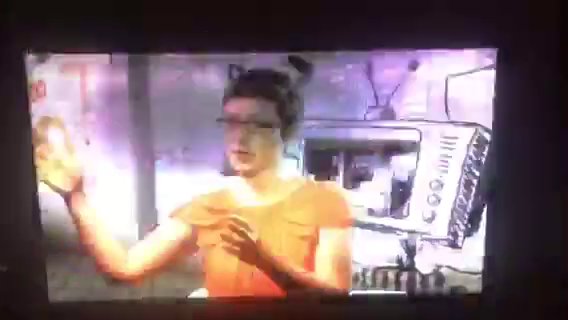

Pink bands
  • hotcoffee
    • Jan 2016
    • 14
    Pink bands
    What is causing this?!?!

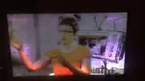

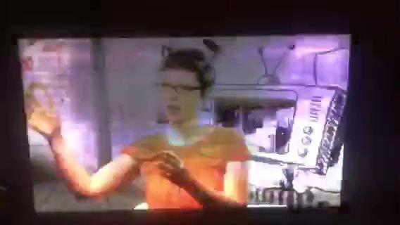

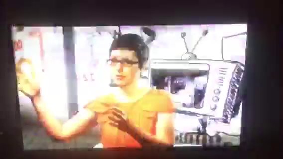

          Ok new observations. Now when i pull up adjustement menu and turn down cell and turn it back up it stops but when it switches to another commercial with brright back gound it starts. Already tried vs adjustements and reseated ribbon cables on on each side of screen and t-con. Its like it resets. This also affects the menu.Main board? t-con? power supply? y sus? x sus?
          • hotcoffee
            • Jan 2016
            • 14
            Re: Pink bands
            Not power supply board or panel because test pattern displays white and it stops doing it like something has been disconnected. Leaves t-con, main, logic and x sus y sus

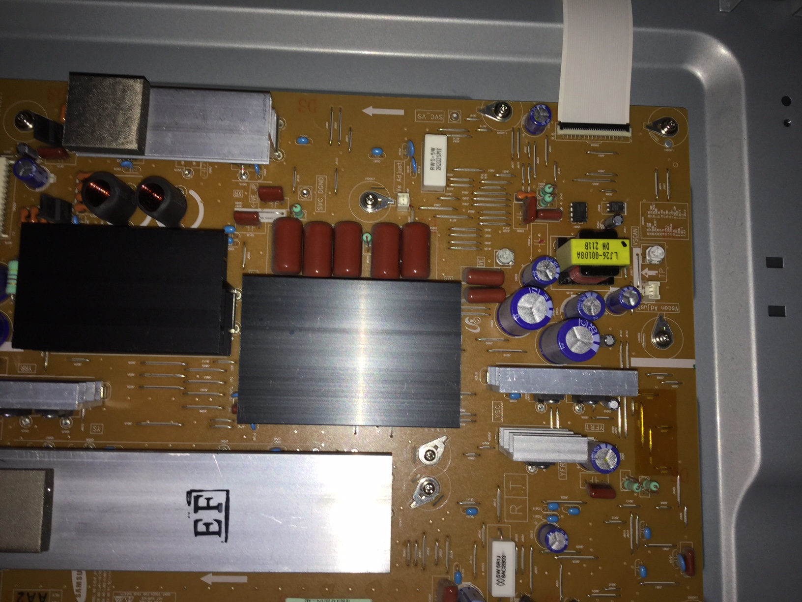

              Re: Pink bands
              Aged/old/worn plasma-panel.
              Sometimes you can cover it up by increasing the Vs about 5-10v, but the prob will return in time.
              TELEFIX
              • Moreno83
                • Jun 2014
                • 2008
                • The Netherlands
                Re: Pink bands
                As Alastair says. Try to increase the Vs voltage. You need to measure it so you wont inmediately go 20V up.
                The potmeters are on the Ysus board , maybe a little tweak on the Zsus board also helps. Last one helpt me on a old panasonic plasma. White was more green , i turned up the Zsus and it was gone.

                    y and z on one board for my model
                    • Moreno83
                      • Jun 2014
                      • 2008
                      • The Netherlands
                      Re: Pink bands
                      Can you post a picture of that board? Try to make it as clear as possible so we can tell you which pot meter you need to alter.

                          Re: Pink bands
                          like this?

                            update turns out it was power supply all along!! thanks to all
