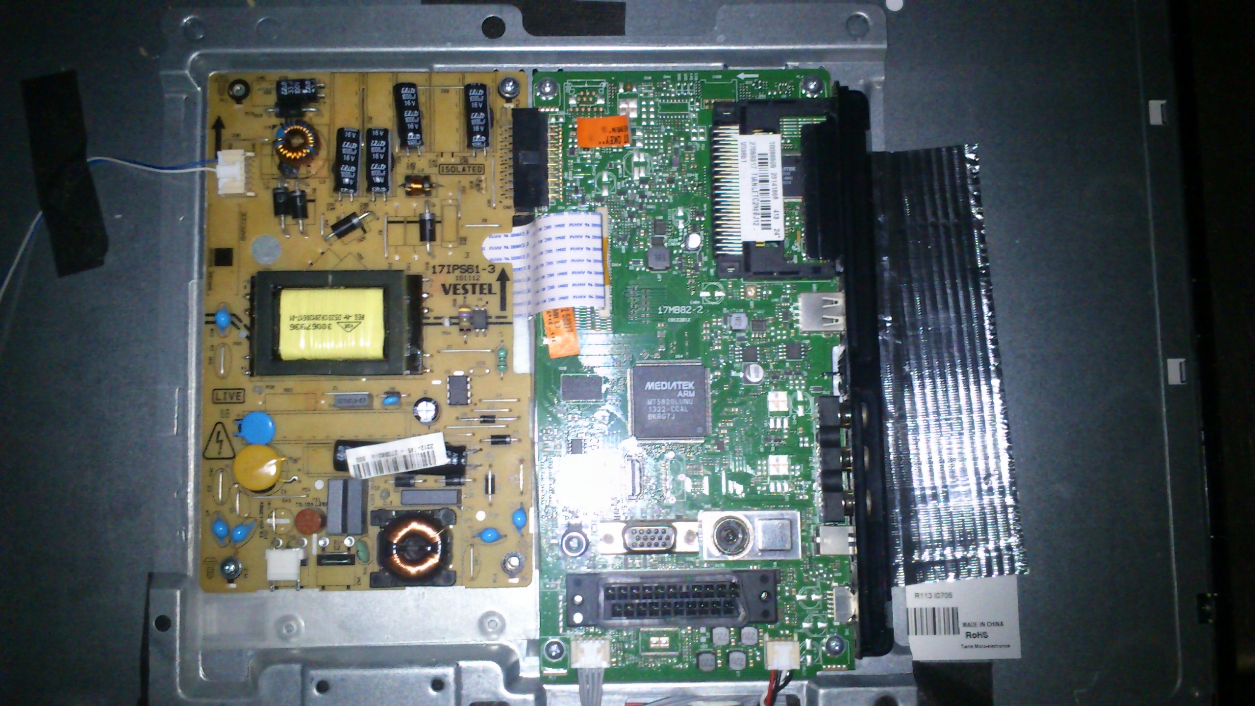

Hi frends .i have a hitachi 24hxc05 tv ,when i plug it, the red stand-by led is on ok. When i turn on from the remote or the main red and blue flashes . i checkt the caps 12v ok . can someone help . thanks
hitachi 24hxc05 red blue led flashing
Re: hitachi 24hxc05 red blue led flashing
can you upload some pictures of the boards used in this set. -
Corrupt firmware, you will need to either re-flash the firmware Ic which both Mboot and core update or if you freeze the Spi flash chip then load Core update it will work. Need info on the board used.Please Do Not PM My Page Asking For Help Badcaps Is The Place For Advise, Page Linked For Business Reasons Only. Anyone Doing So Will Be Banned Instantly !
