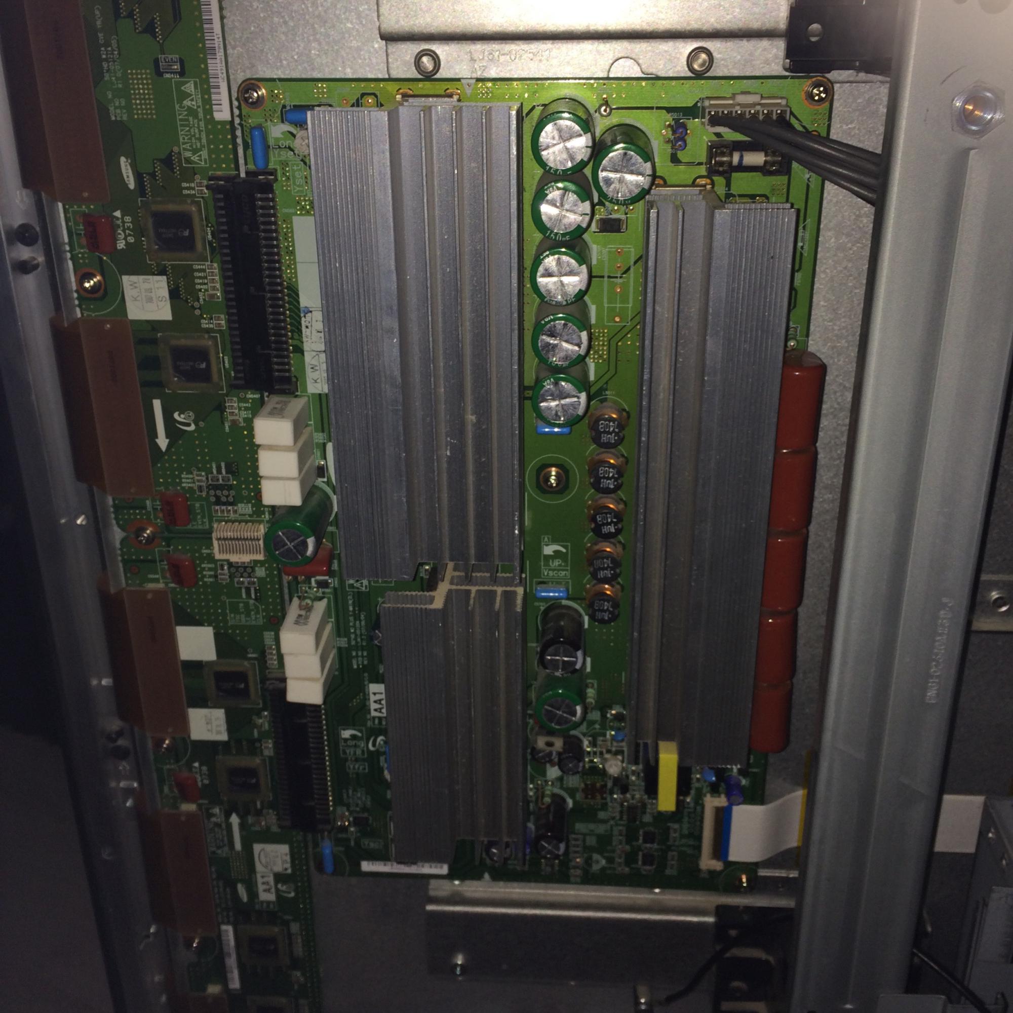

    hello
    i need help with my plasma tv it turns on for one minute and shuts down with flasing led 5 times. when the tv is running all voltages are good vs va etc..
    even when i unplug y and x and low buffer board the power supply still shutsdown after 1 minute.
    all help is welcome.

    Re: ps50c77hdx/xec
    Did you comment on my video ? Also we need images of the boards please mate.

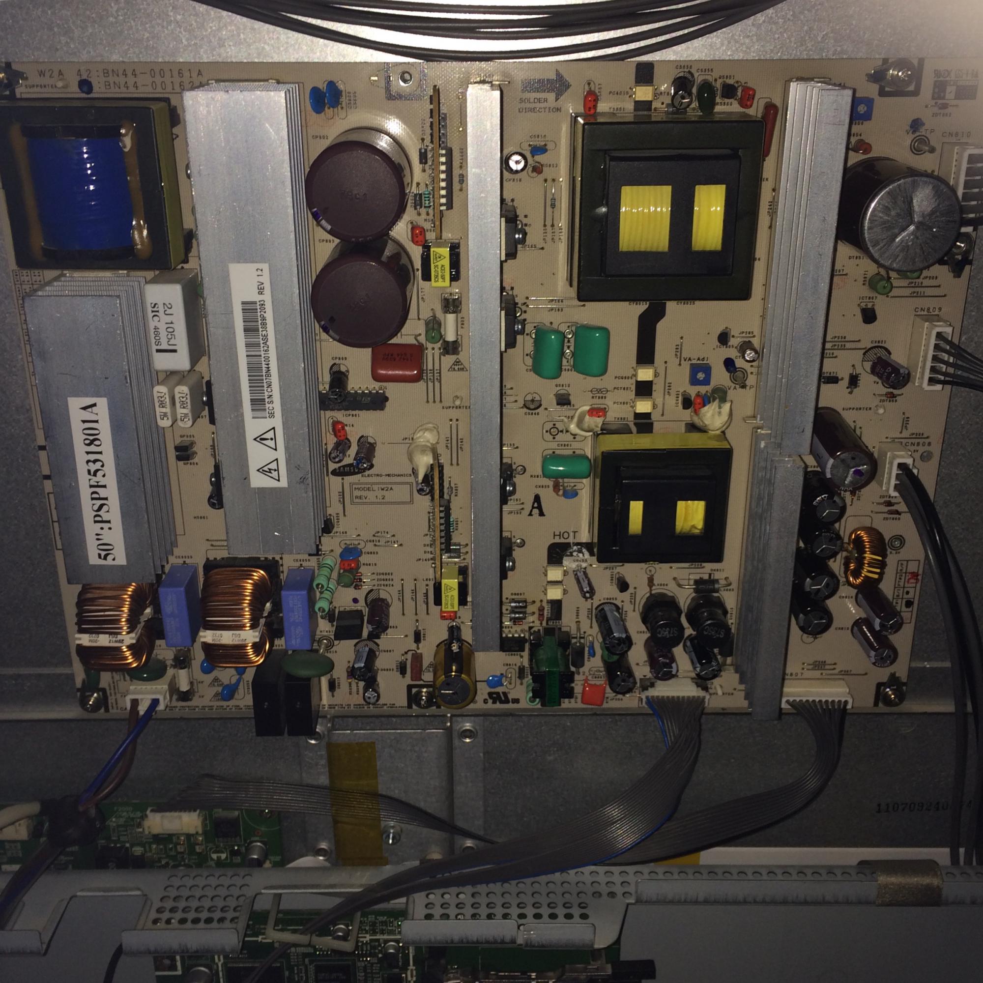

        Re: ps50c77hdx/xec
        Yes i think so. Here are some pictures of the powerboard etc..
        Number of the power supply is bn44-00162a
        Ps: i measured the big capacitor on the right the 250v 850uf an i got only 685uf
        Do you think that is the problem i already ordered a new one.

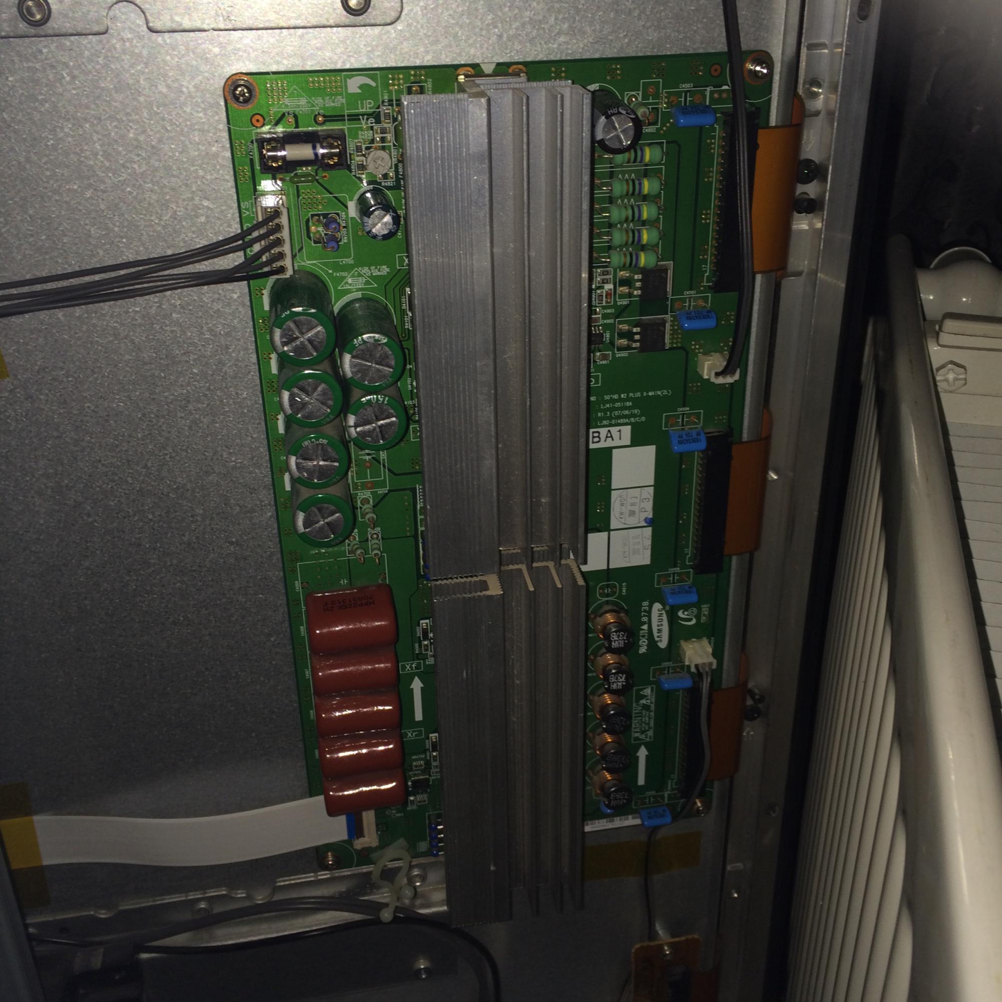

          Re: ps50c77hdx/xec
          Picture 2

            Re: ps50c77hdx/xec
            Picture 3

              Re: ps50c77hdx/xec
              Checked for cold solder joints ?

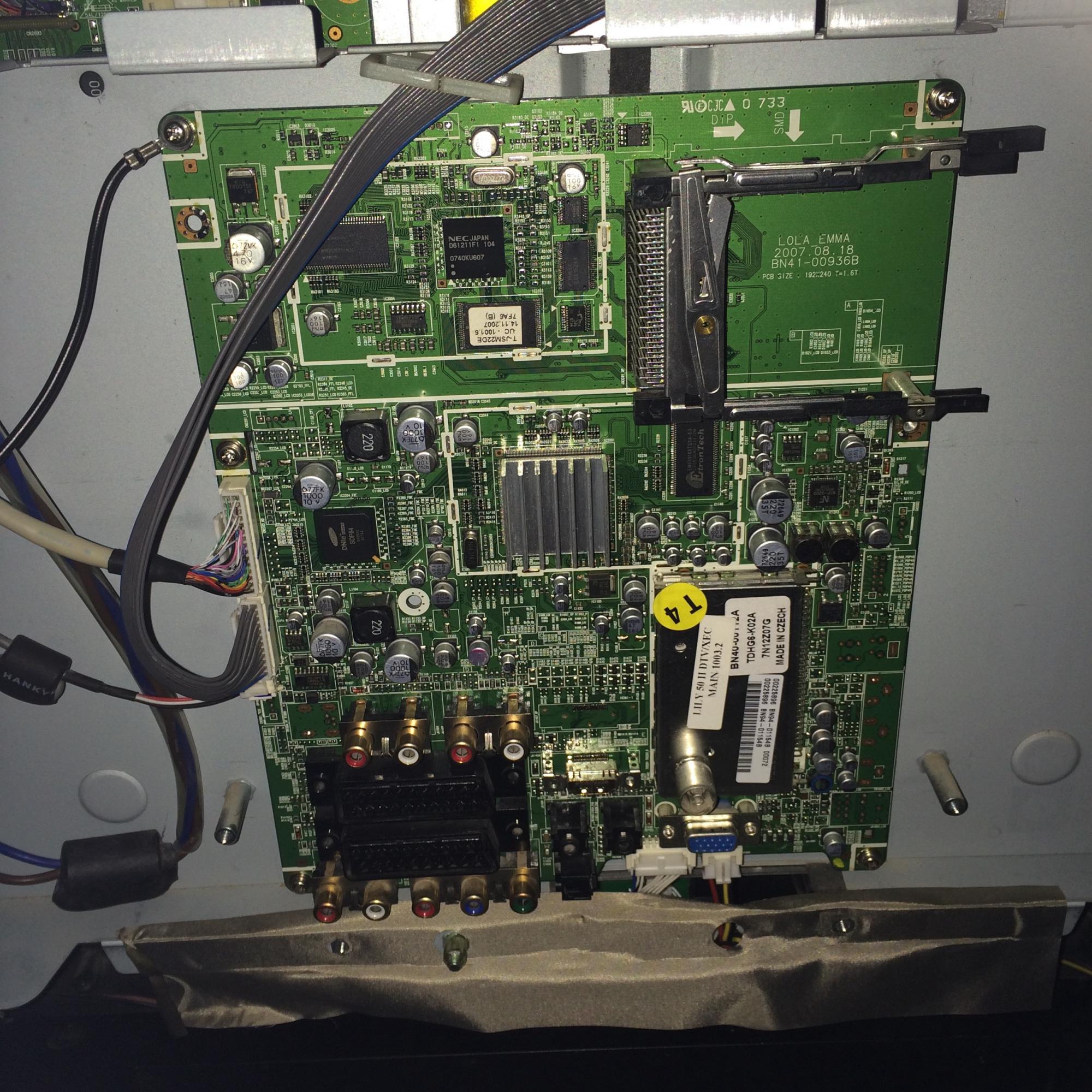

                Re: ps50c77hdx/xec
                Picture 4

                  Re: ps50c77hdx/xec
                  Yes i did and resoldered a couple but the problem still remained.
