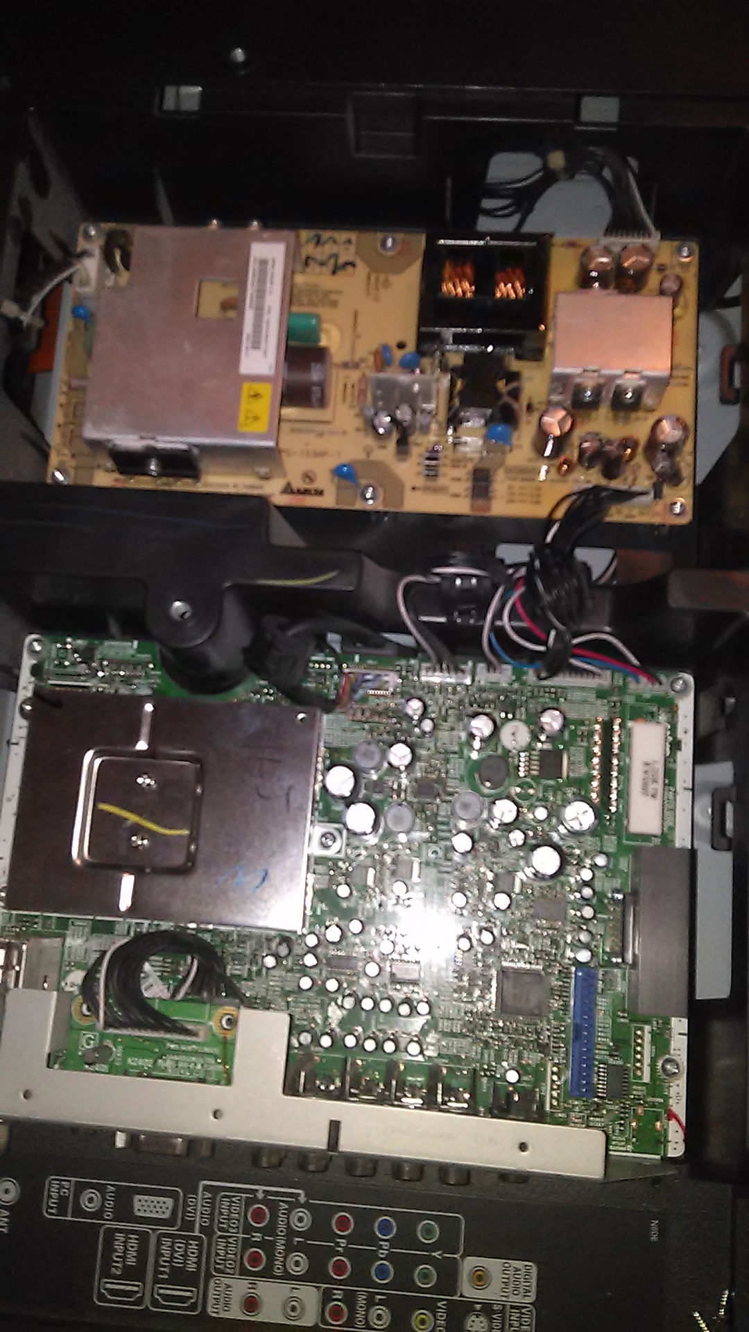

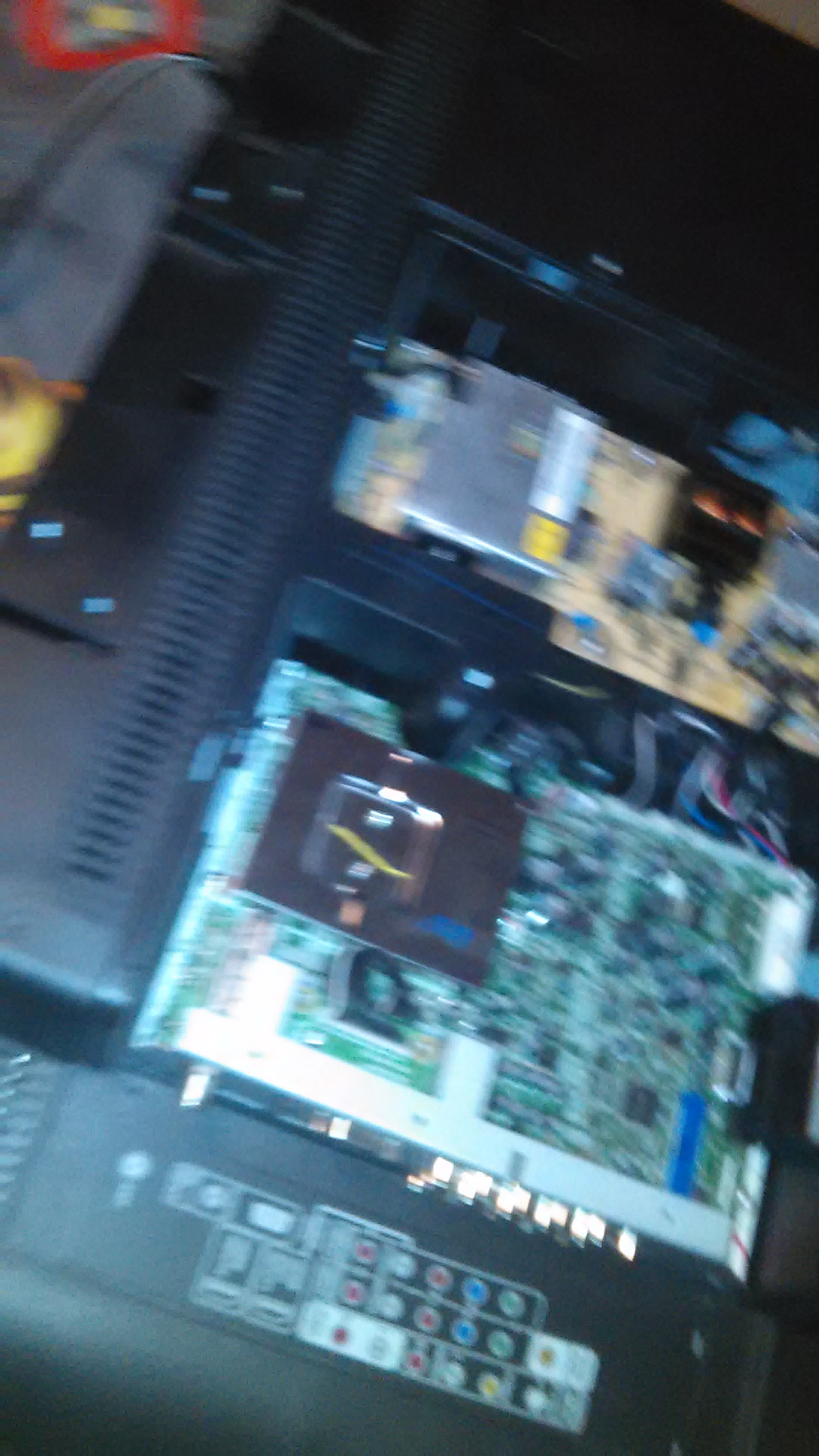

      And what exactly are we supposed to make out from the image ? Seriously can you make anything out ? We need better images before we can help.
        Re: Sanyo DP32628 display turns off

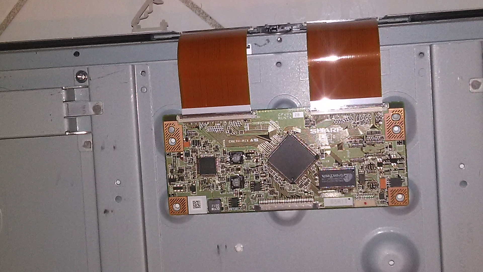

        New pictures for you.

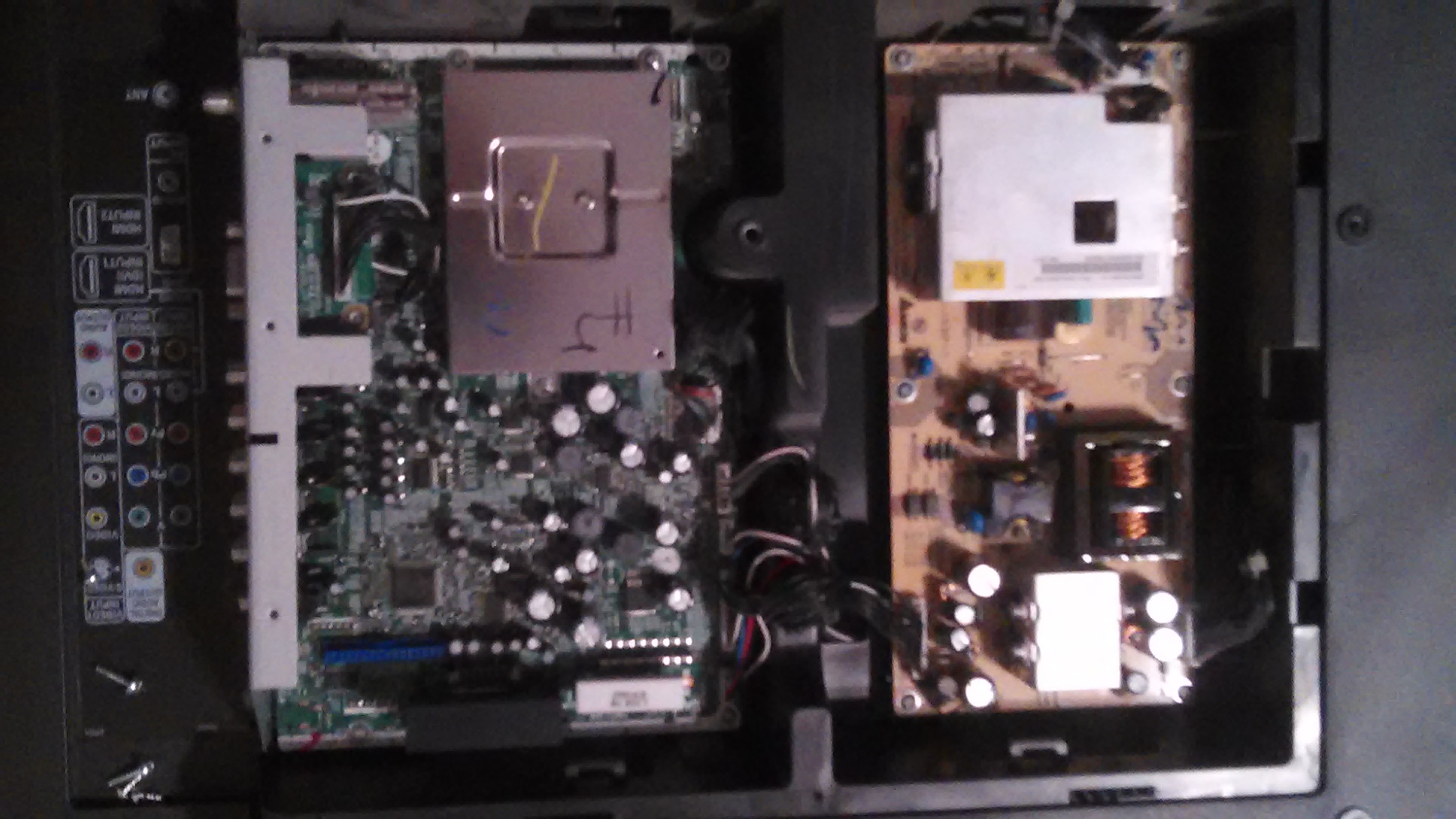

                  Your pictures only show the main (green) board and the power supply (brown) board, there is inverter board that you do not show in the pictures. You need to show the whole back side of the TV. You need to removed that TV's back cover, this is very badly designed TV hard to get to all the boards when the back cover is removed and hard to power them up too.
                    that's what I was trying to figure out. I tried to see it last night when I had all the screws out but couldn't see another board. I will try again and report back.
                      When you try to lift up the back cover, do it real slow or you will break lots of cables. If I remember correctly , you need to remove the cables from the boards to allow you to freely remove the back cover.

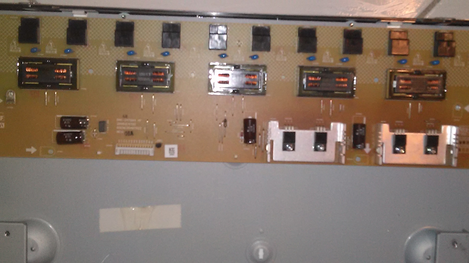

                            I see why man. I did not expect to have to take this this far apart. Speakers unscrewed, board unscrewed, covers... anyway here is where I am at. Still no sign of the board I mentioned in the original post. I think this is all to the back of the screen.
                              https://www.badcaps.net/forum/attach...8&d=1451349933

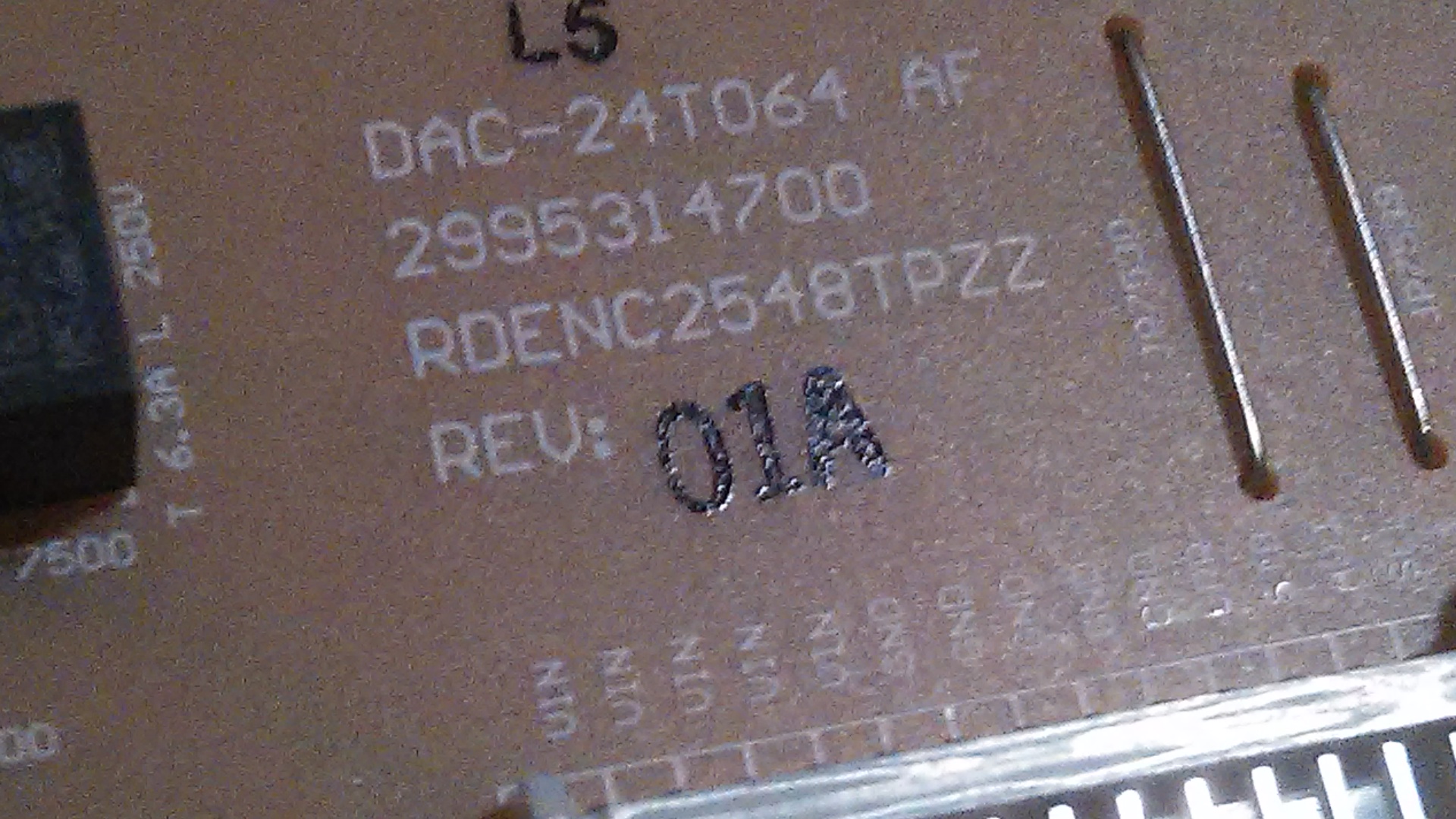

                              That is the inverter board, so there must be more than one version of this TV model because the link to the EBAY does not have the same inveter board as yours.
                              The picture is too blurry for me to read the make and model of the inverter board.
                                sorry it's the only way for pictures for me.
                                there are 4 rows of numbers
                                DAC-24T064 AF
                                2995314700
                                RDENC2548TPZZ
                                REV: 01A
                                On the far left of the board, there is a
                                LF
                                LA
                                tag

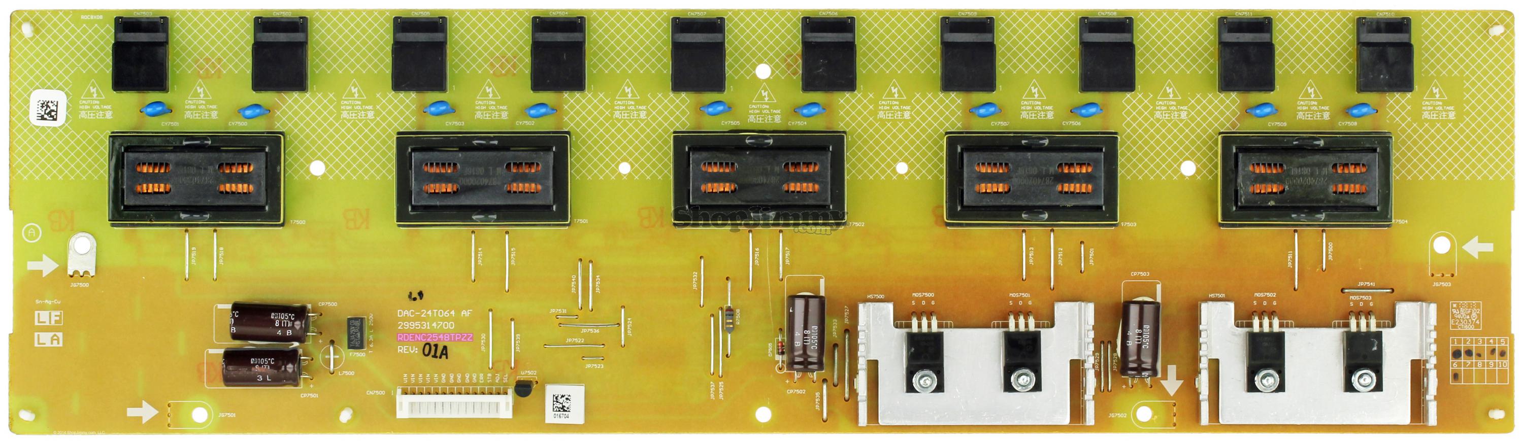

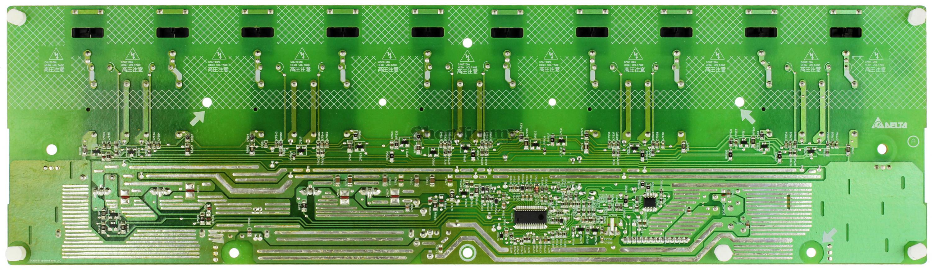

                                  Sharp RDENC2548TPZZ Backlight Inverter
                                  http://www.shopjimmy.com/sharp-rdenc...-inverter.htm#
                                  Pictures provided by shopjimmy.
                                  So you do have backlights on for up to 15 seconds and then they go out so it means that the inverter board did get the 24VDC to run and the BL-ON (Backlights ON) command signal to turn on the backlights.
                                  The possibility will be that the BL-ON signal from the main board drops out, the 24VDC drops out, the inverter circuit (inverter transformers, MOSFETs for driving the inverter transformer) failed after 15 seconds or so, one of the lamp stop conduction (it only take one bad lamp to cause the inverter circuit to kick into protection shut down), bad black socket contacts where the inverter baord plugged into, bad lamp sockets that has poor contacts.
                                  As you can see, there are many possibilities.
                                  Right now I would check the to see if the 24VDC and the BL-ON (STB pin on the inverter board, > 2.5VDC = ON)) are still present when the backlights go off, if they are present, then that will eliminate the power supply or the main board problem.
                                  The hard part will be having everything all hooked up together to check the DCV.
                                    Shame that board isn't available. So you want me to power on the tv and test the board? how will I be testing?I see the STB pin but where would i be putting the ground lead on my multi? I have that inverter board disconnected, the smaller board in the other pic, and i think a ground strap on the main board. Also, that board is only held in by plastic pins. Can I undo these to test the board?
                                      Originally posted by hairywbush View Post
                                      So you want me to power on the tv and test the board? What exactly will I be testing? I have that inverter board disconnected, the smaller board in the other pic, and i think a ground strap on the main board.
                                      You will be checking the DCV on pins of the inverter board connector, they are labeled with pin names, you need to check any one of the 24V pin, the STB pin.
                                      All of this has to be done with all the boards are connected back together and powered up. It is not going to be easy.
                                      You can also look at the inverter board real close to see if you can see any section of the board has turned dark brown from the heat.
