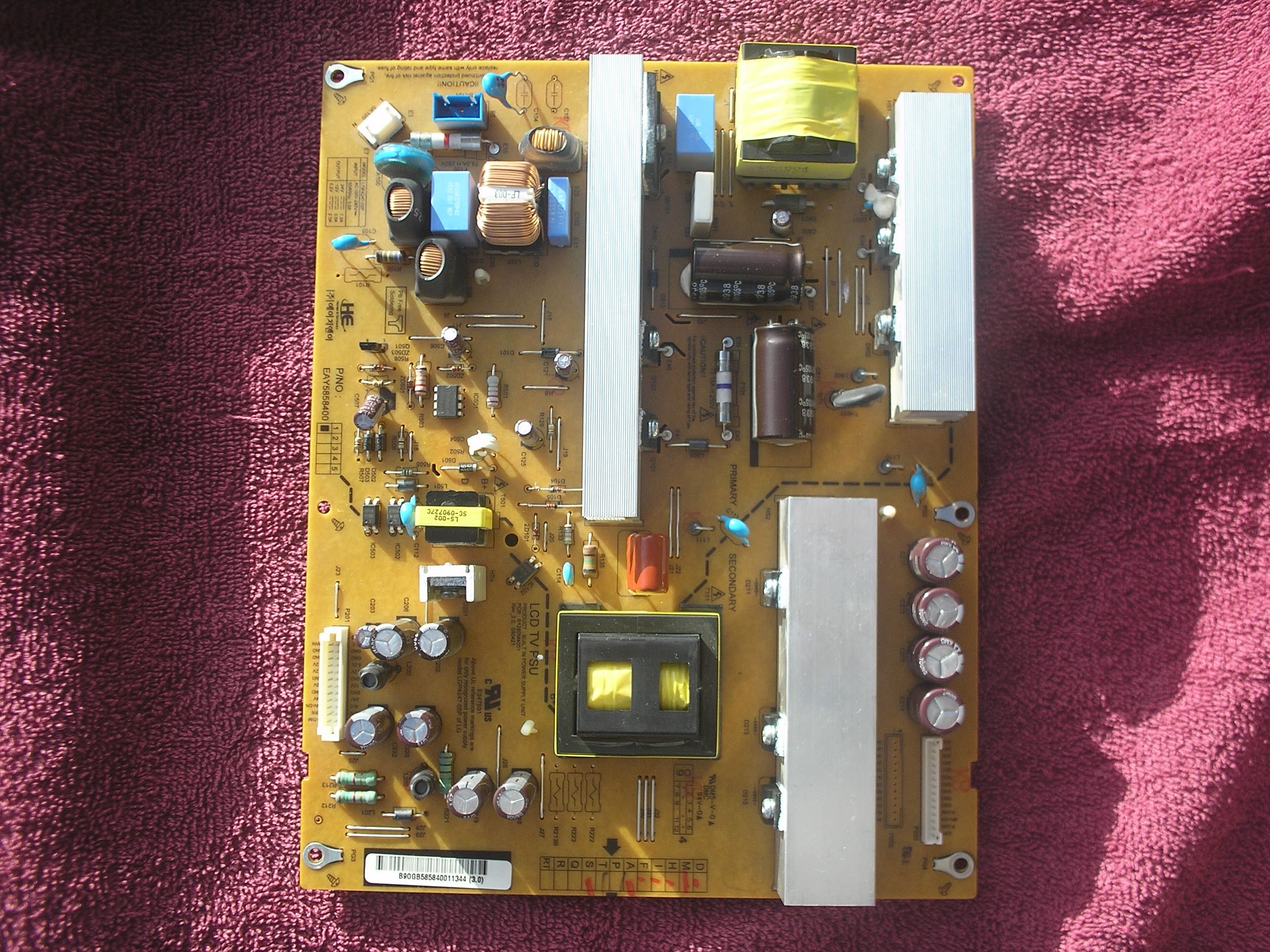

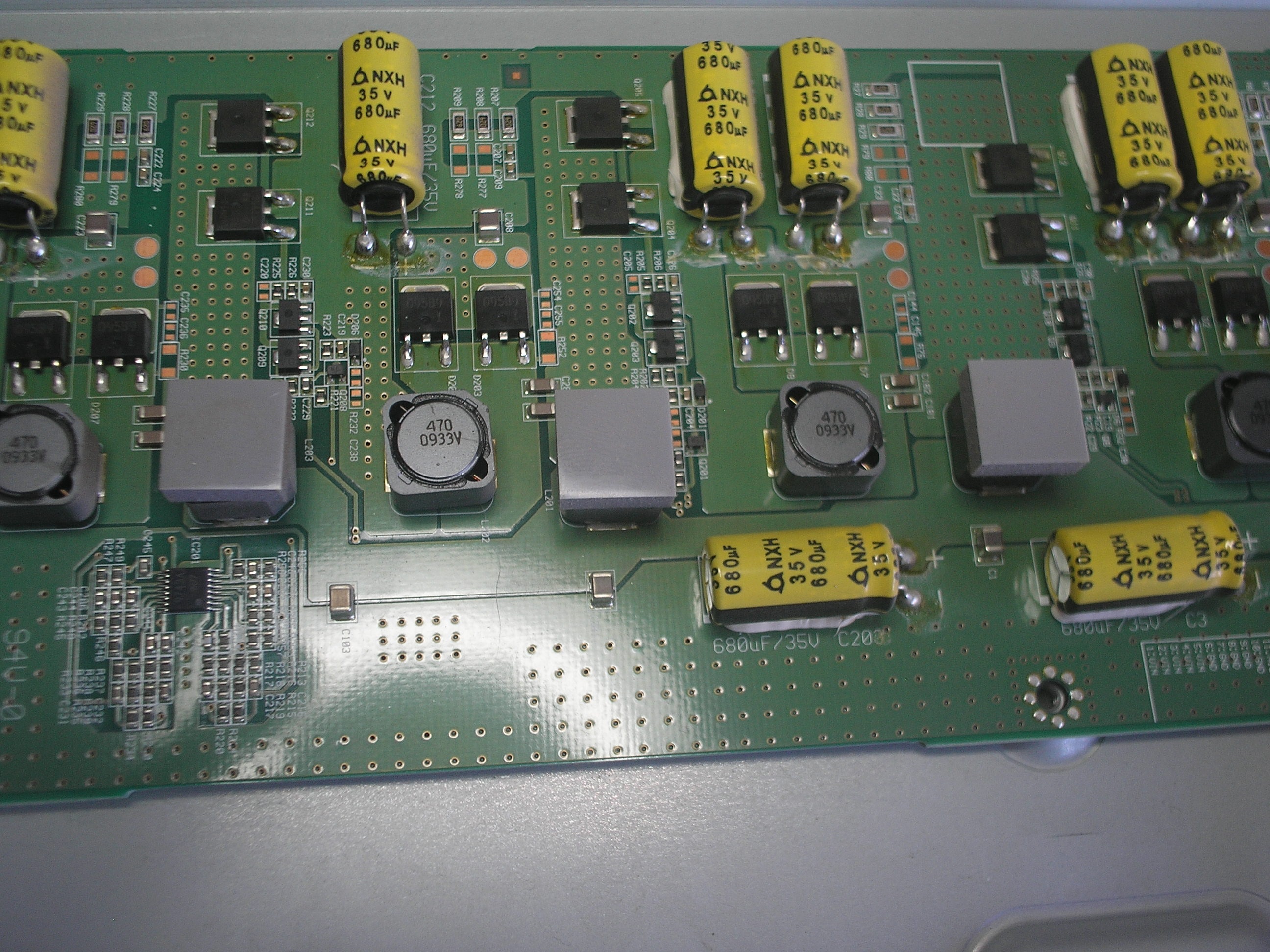

    2. P.O. told me he took off the back and looked at the caps. check the inverter picture. He more than looked at them. Underneath ok. but still very concerned about this board.
    3. Which brings me to the first and real problem. No 5 volts with main board unplugged so I know it is on the ps board. This supply runs the bridge rectifier at 160 volts on standby all the time. Then it jumps to around 380 when powered up.
    Ok.. here is where I need help. Since I cannot find a power supply diagram or schematic for this.. I do not recognize the 5 volt supply path from the bridge rectifier to the output connector. . I have 166 volts on the Bridge Rectifier. (power off) and measuring from neg side of large cap (circled on pic) I have 46 volts when measured on both sides of the fuse (also circled).
    Don't know if that is way low or ok... and I am stuck at this point.

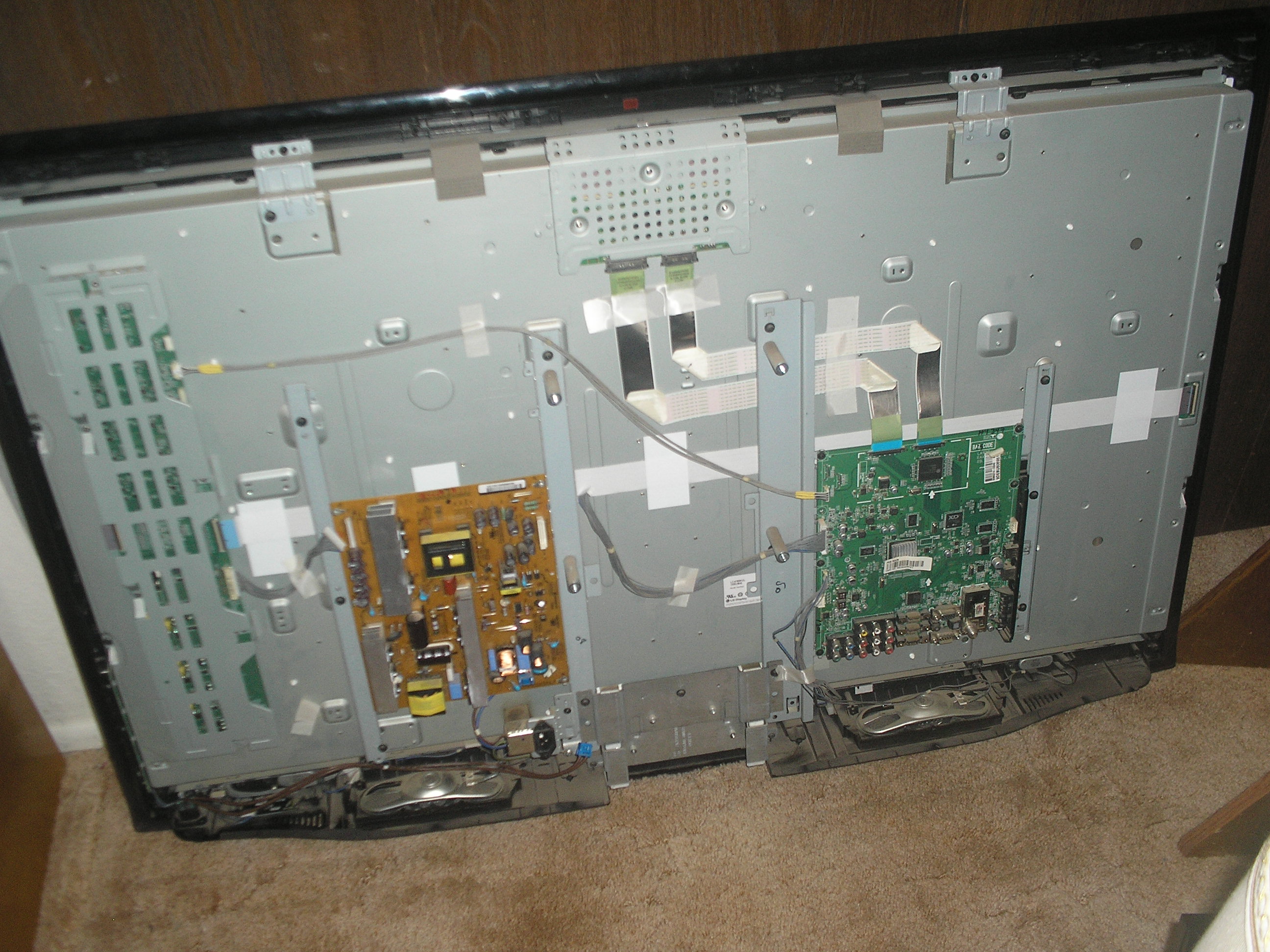

    Can we see the whole back side of the TV so we can see how all the boards are connected together?

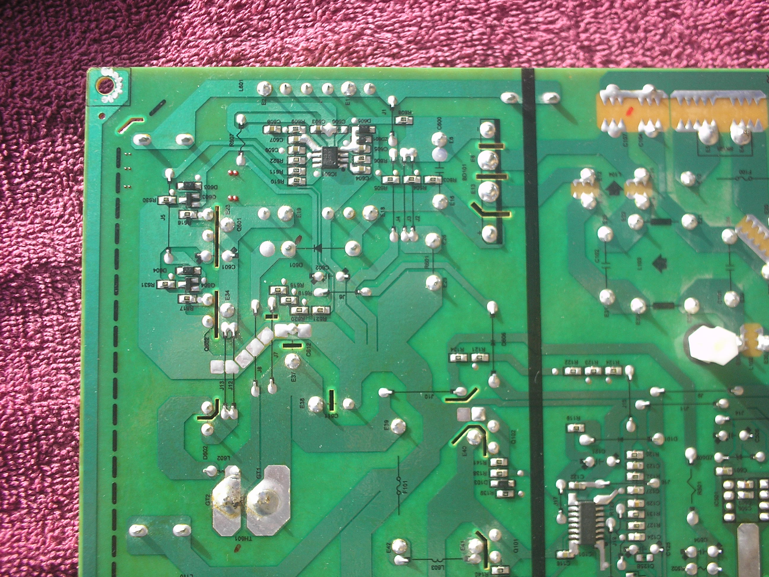

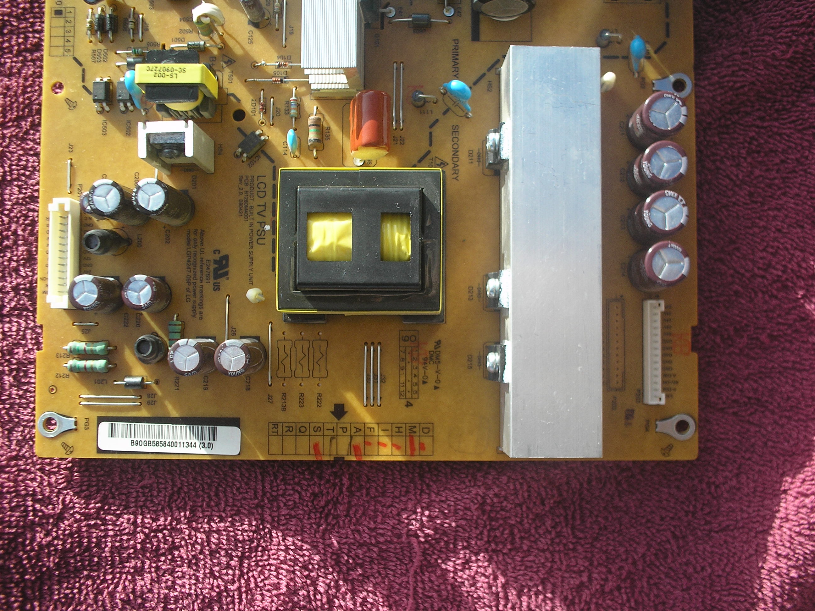

    Also need straight shot pictures of the whole power supply board top side and the bottom side.

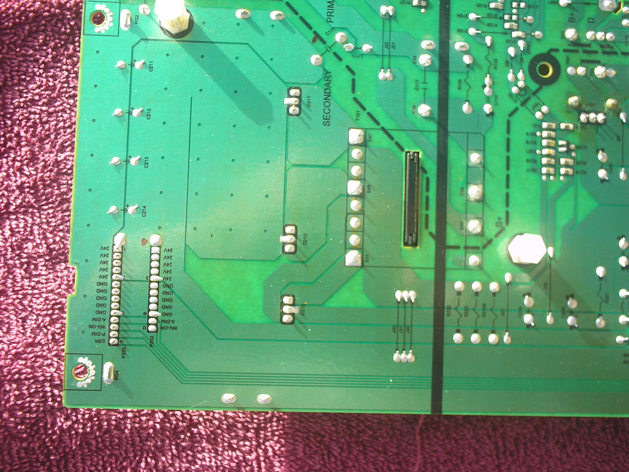

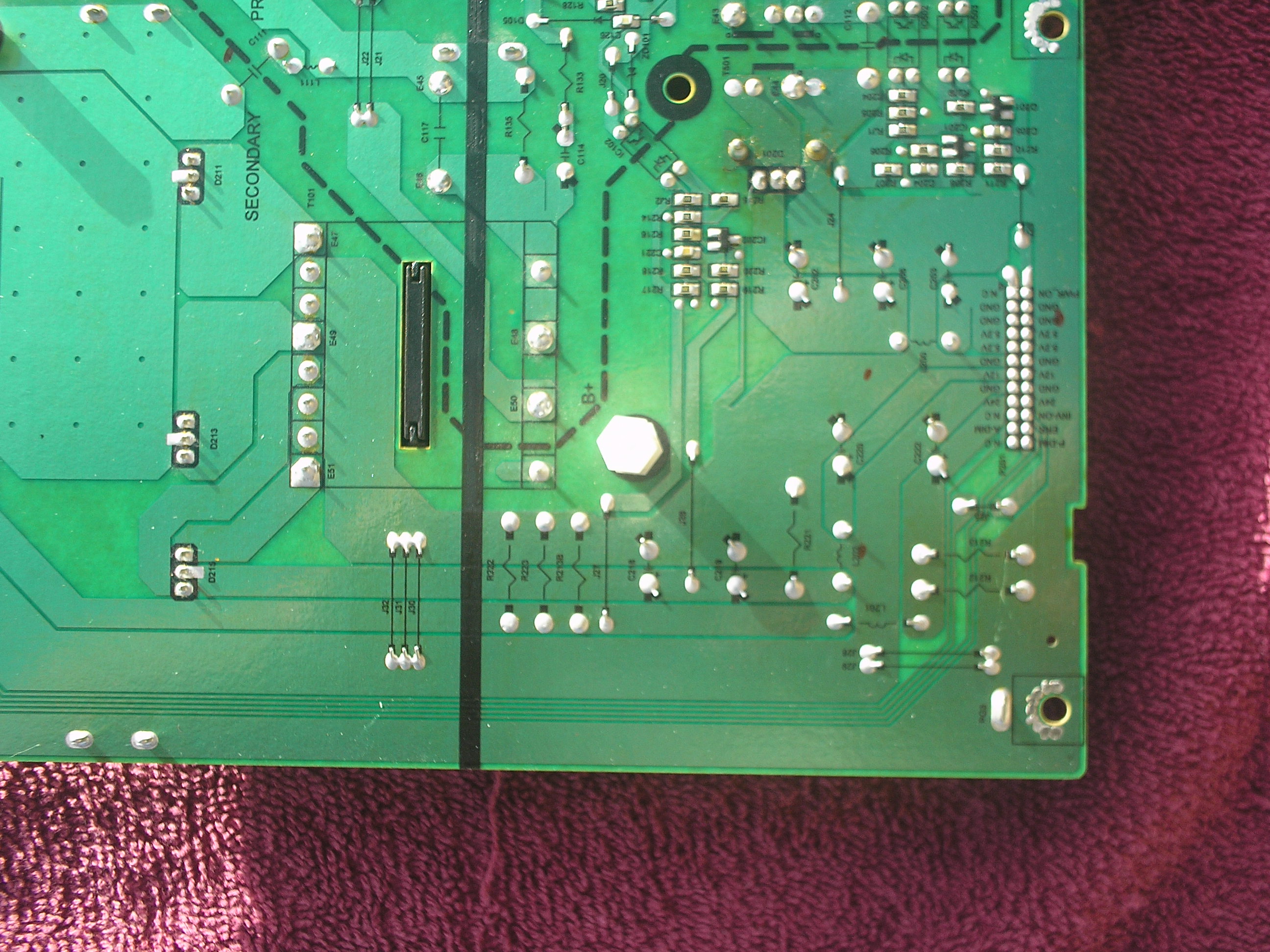

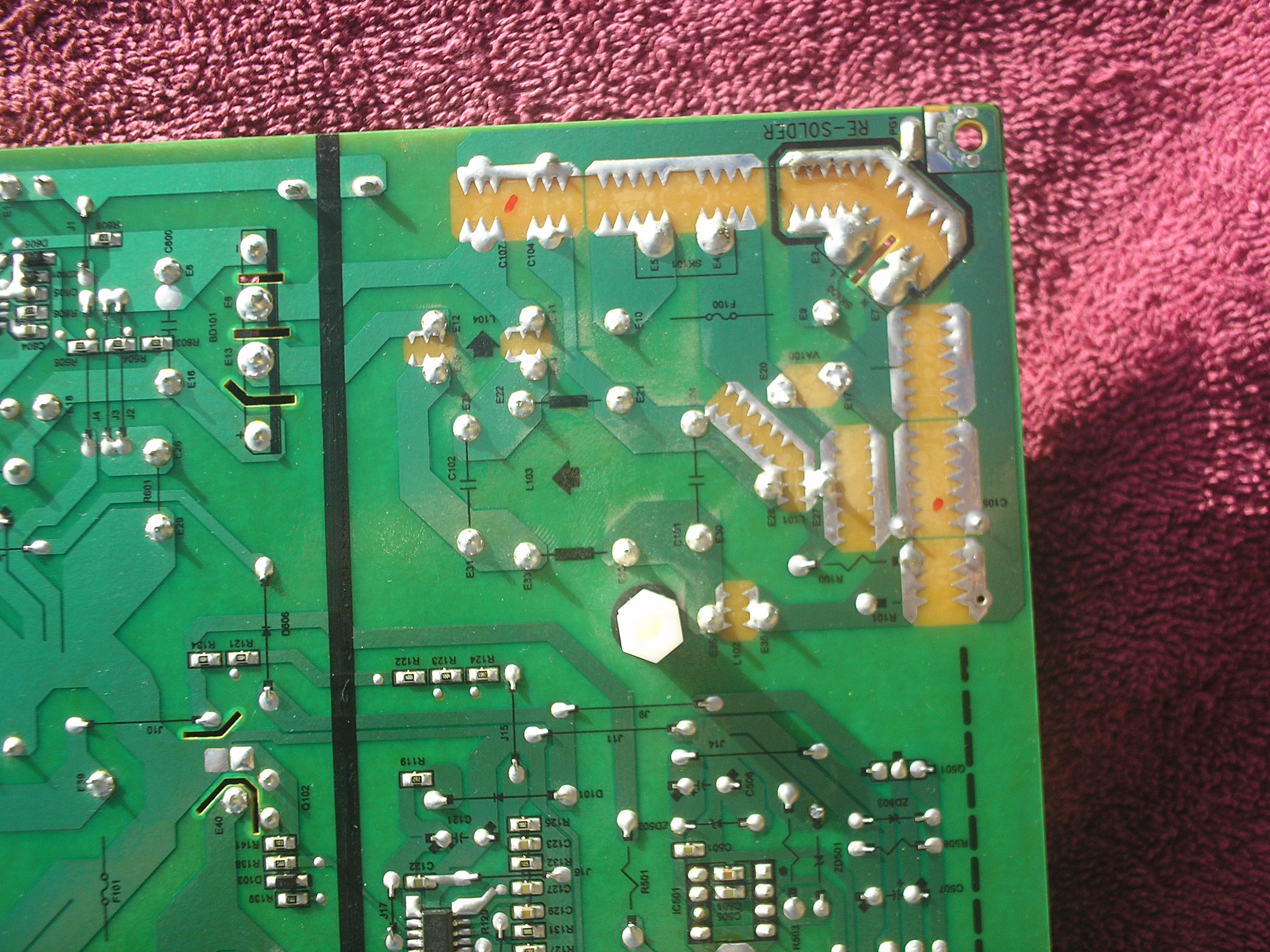

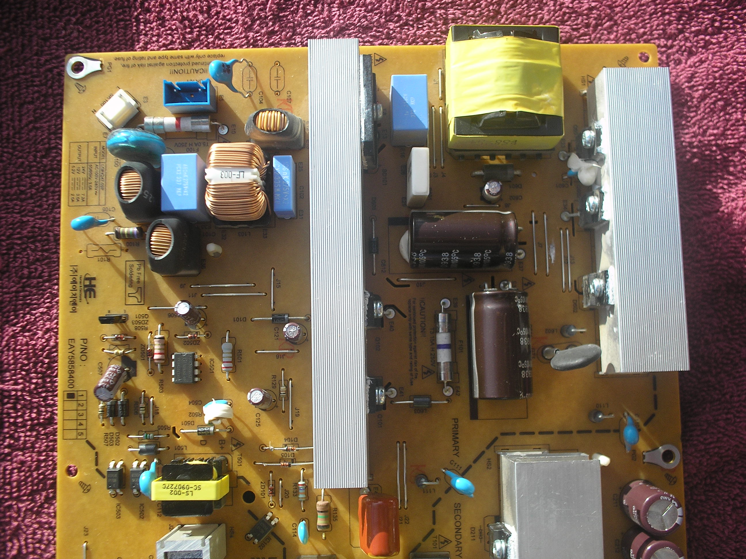

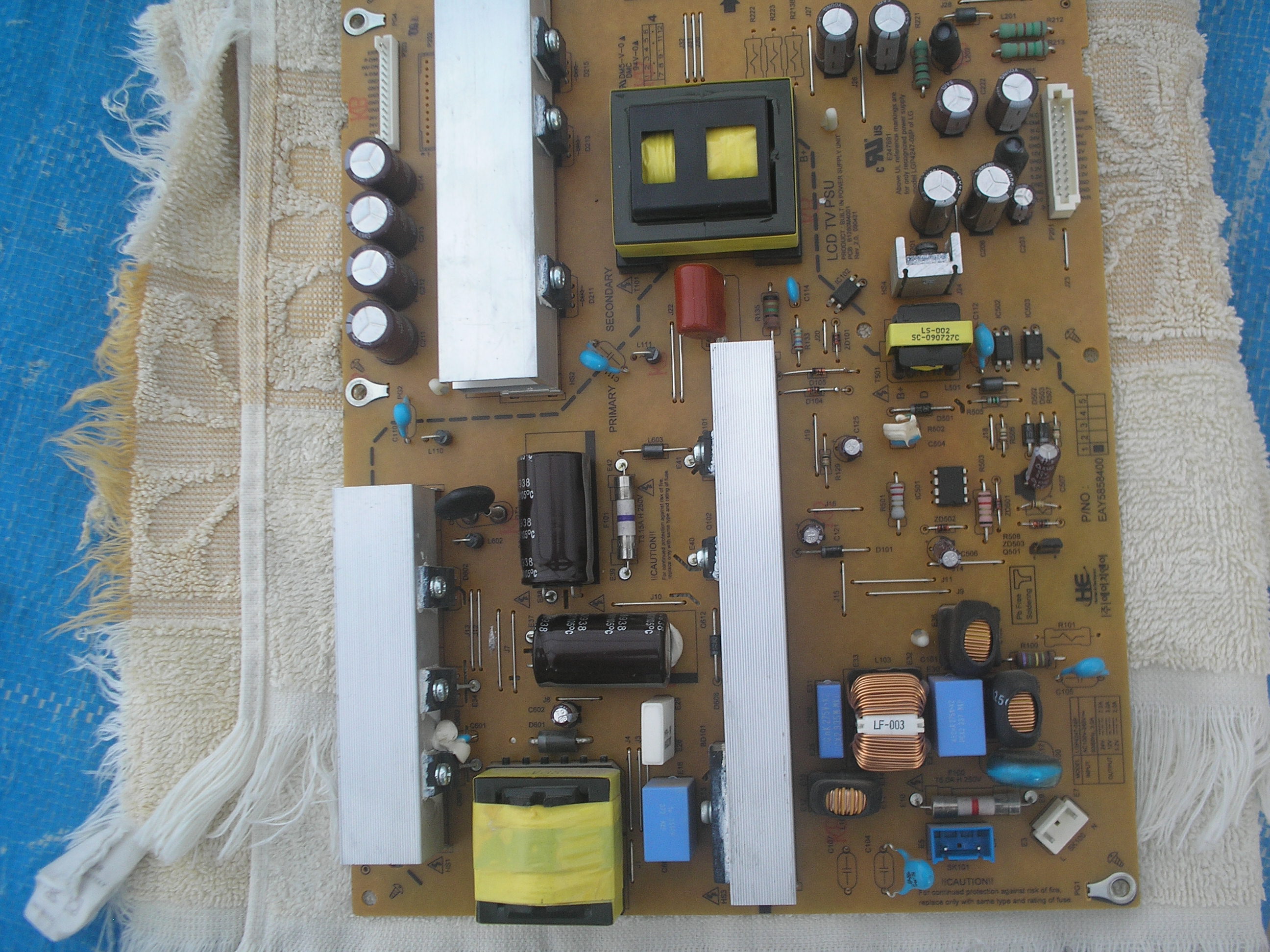

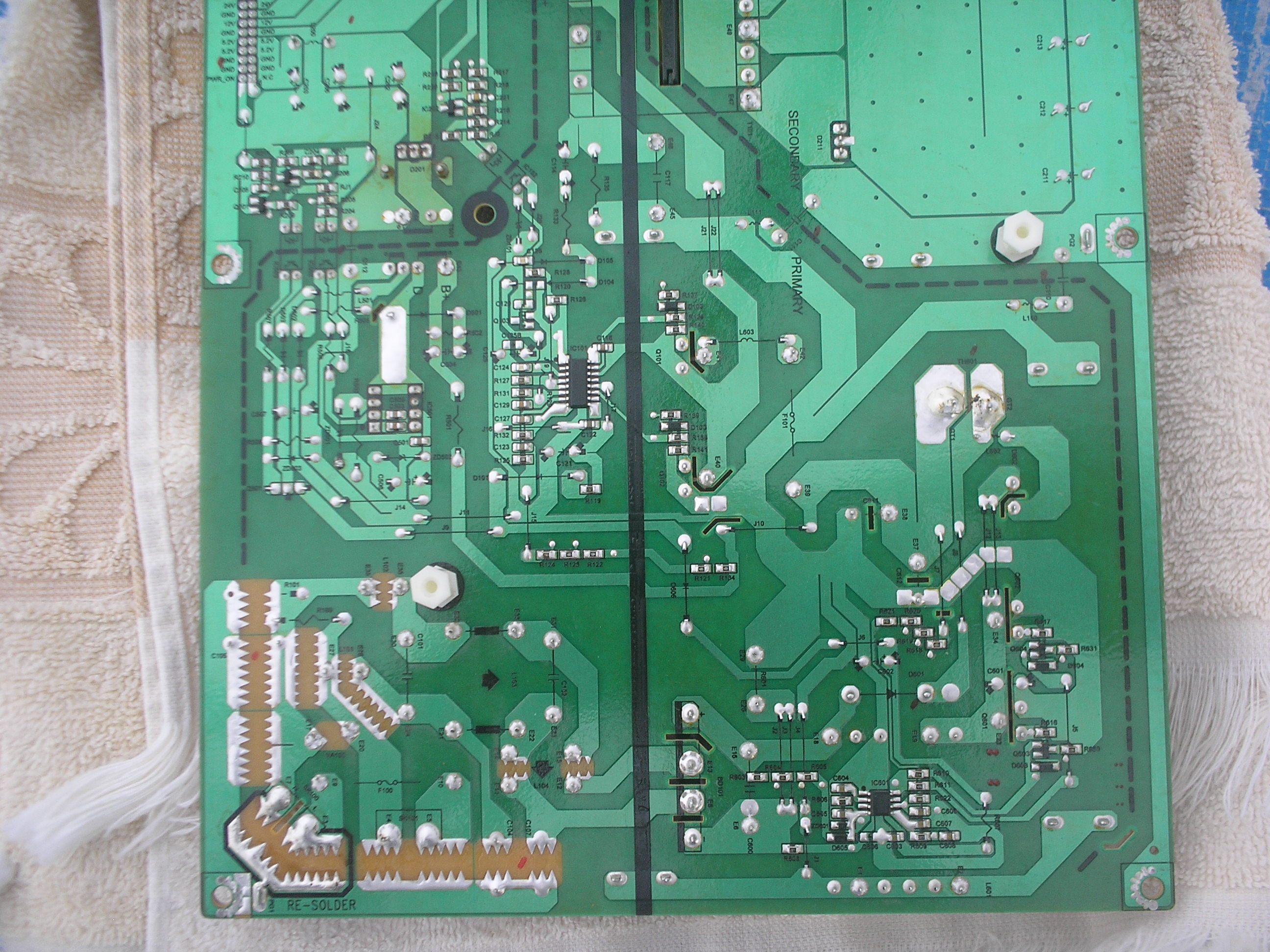

          Here are the requested pic. No sun today so....
            Re: LG 47LH90 No standby voltage
            Here is the spec of the IC ICE3B0365J.
            I will have to wait to see the pictures of the whole board to see if there is and fusible resistor for feeding the B+ to that STBY section or not.

                    BTW, I need straight shot pictures of the whole board, pictures are still cutout so I cannot trace circuits.

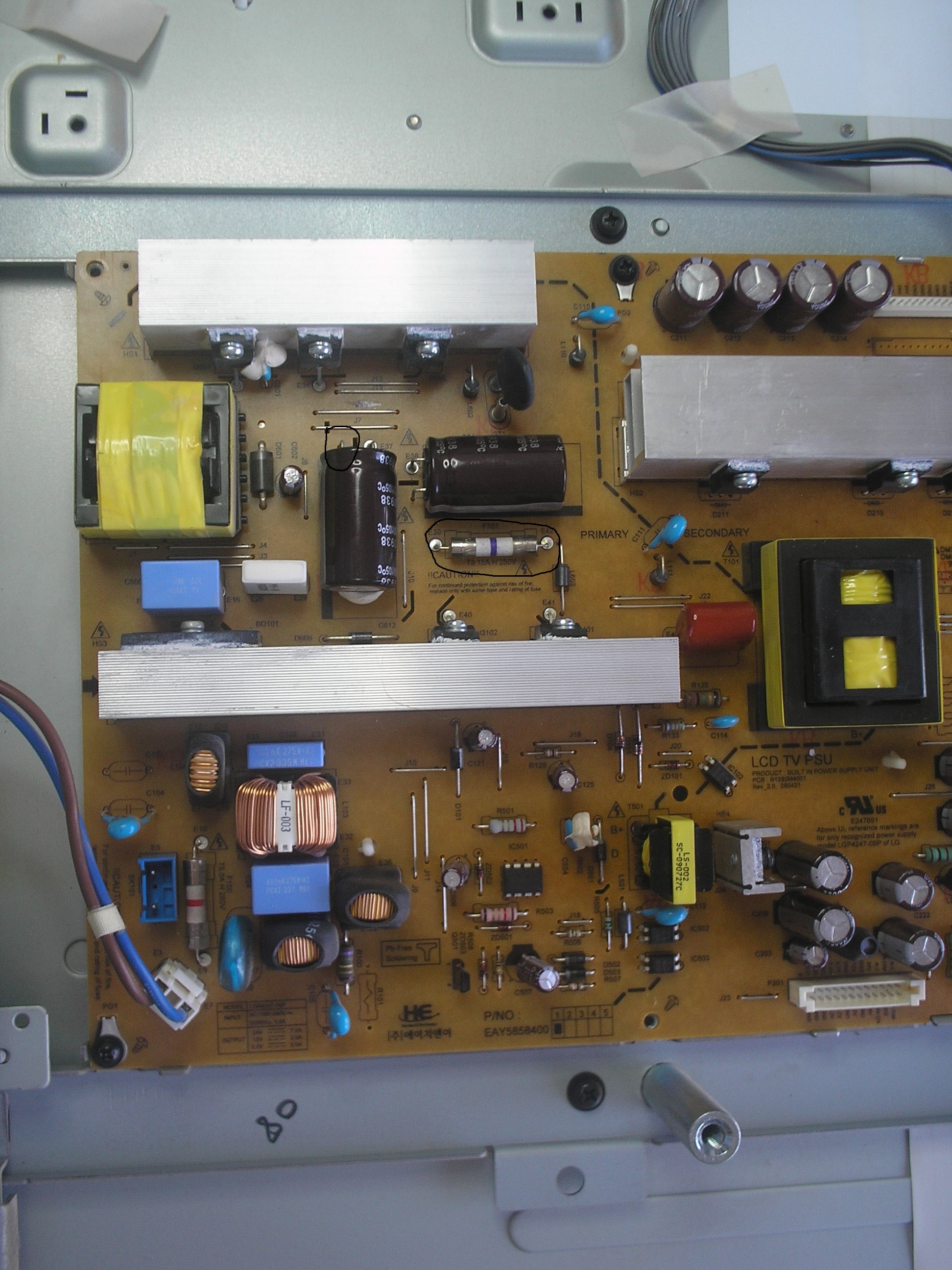

                          Here are some more pictures.. hope they will work
                            OK, so the fusible resistor is OK which means we do have 160VDC for the IC501 to run.
                            You can test the power supply board by itself without having other boards connected to it.
                            We need to check the DCV between the two legs of C506.
                            The Voltage on that cap must reach 18VDC (per spec sheet page 16) when first the power is applied to the board for the IC to start running.
