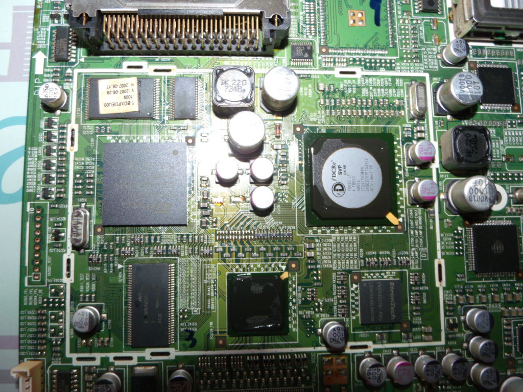

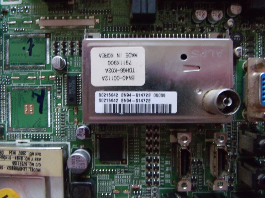

            Hello again peeps so just to clarify we are talking about the board below and the two large caps that were under the heat shield labeled V0013 1000 10T? C1110 and C1177
            • ReeceyBurger123
              Never Give Up !
              • May 2014
              • 7325
              • Britain
              Re: Samsung LE40R87BD clicking/bad video then all good
              Yes replace those two, you can use standard caps just with the legs bent over.

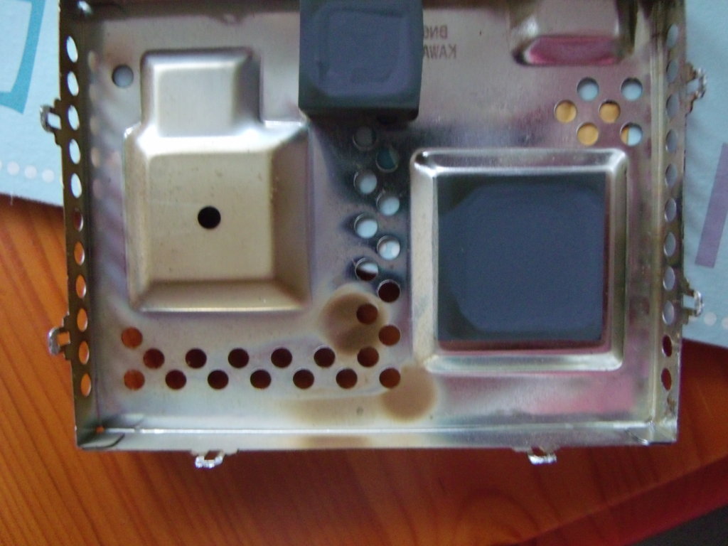

                    Thanks for your help guys I don't have any around here so I've ordered some localy I took some pictures of the heat shield underside are those scorch marks from the caps or dust deposits? I'll post back once its all up and running again :-)
                    • flocko
                      • Nov 2012
                      • 1121
                      • uk
                      They sit under that heat sink and cook, did you go for SMD aluminum caps ? I have not seen one of these sets in a long time, but have repaired a lot with this fault in the past

                                    Could I also add that the heatsink pads leak an oily liquid,
                                    that can get under the IC's and give give similar problems,
                                    wash/clean with isopropyl alcohol
                                    • flocko
                                      • Nov 2012
                                      • 1121
                                      • uk
                                      That will be the Thermal grease that is there for heat transfer between heat sink /pad and processor, remove that and the main board will be toast in no time unless its replaced ?it has no electric conducting properties only heat so leakage should not be a problem
