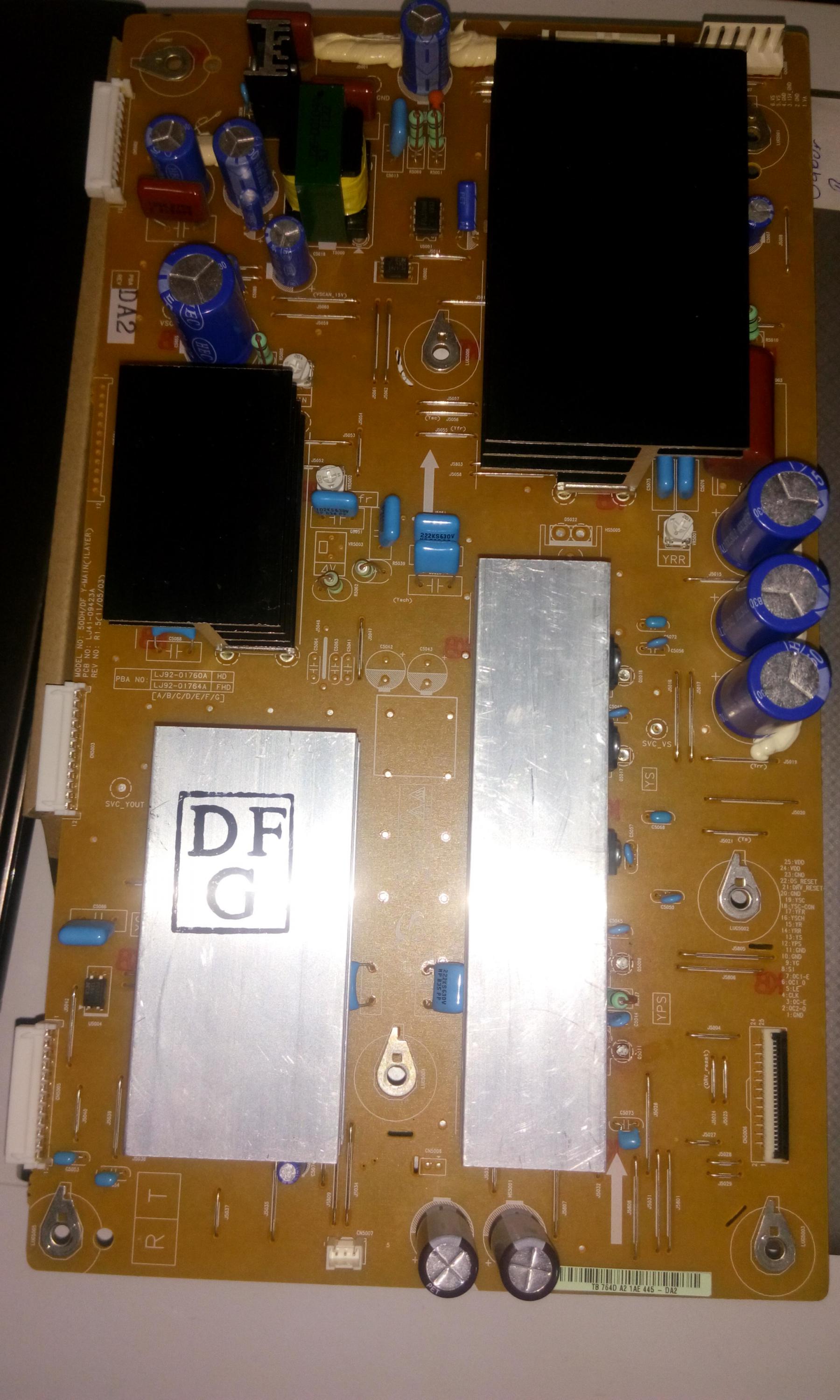

    I want to learn that we have a samsung plasma tv. We changed it's Y-Sus and x-sus cards when we connect to power that panel burns 2 cards again. I think there is a shortcircuit problem on plasma pdp . can we fix a shortcircuit on pdp?

      Firstly a shorted PDP is very rare ! Can you at least give us the model of the tv ? Maybe upload pictures of the boards used ?

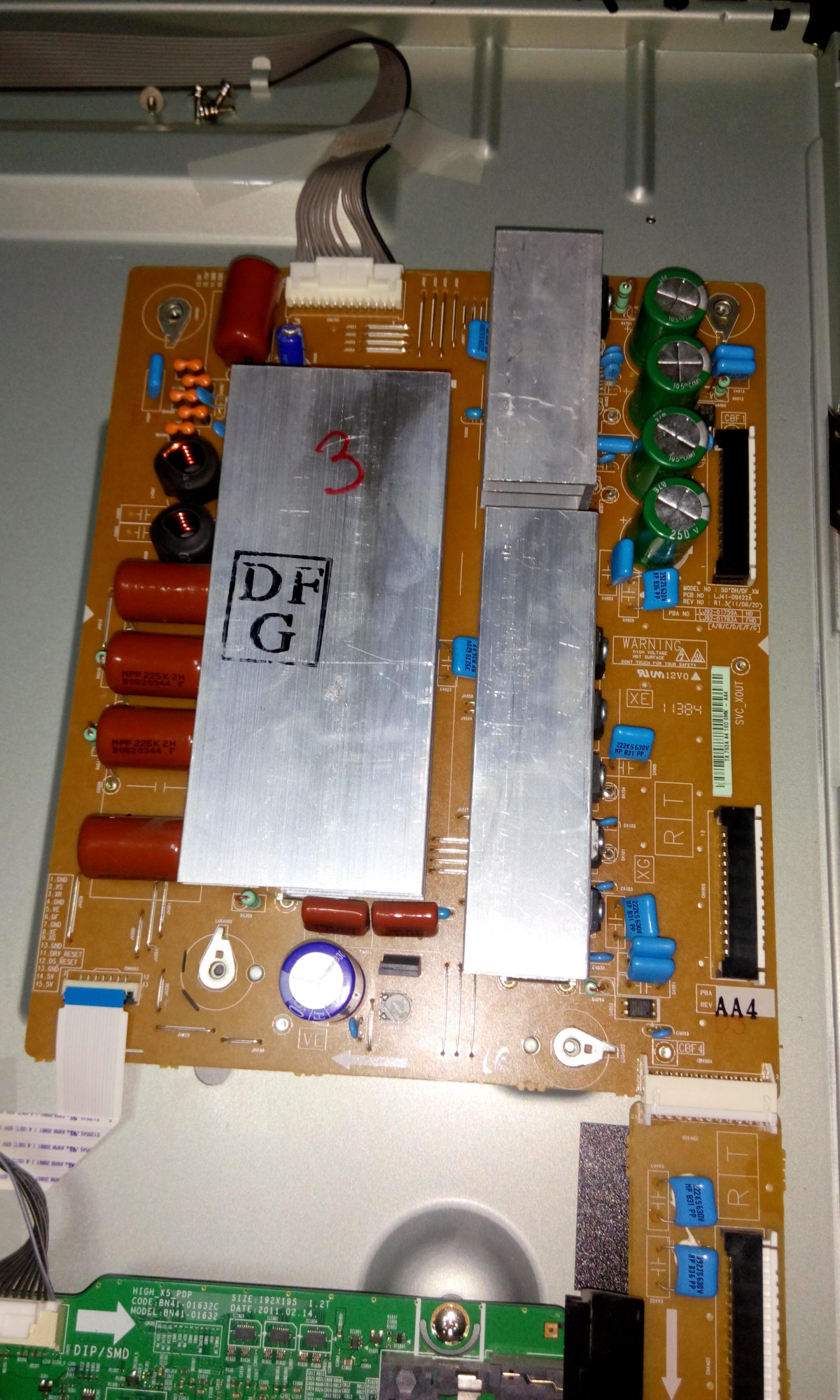

        I attached pics of my TV. We changed its cards but new cards are broken again.So ordered new ones. Now we are waiting for new cards.
        Before we plugged PDP cards worked fine. after attaching PDP cards was short-circuited and broken.

          Re: Is it possible to fix Plasma panel?
          Its because when you plug the boards into the PDP the whole ciruit is complete and all the boards are working together. This set uses combined engery recovery, so a bad buffer can kill a Ymain and that can kill Xmain and vise versa.
            Would expect a shorted chip on y buffer, causing the y and x to blow again, y buffer boards should always be tested before replacing other boards on plasma TV! Tom666 has a good video showing how test buffer boards
                We solved problem. PDP is working fine. We changed buffer cards with another versions and problem solved. So circuit problem was on buffer cards which wasn't found on tests. Thank you very much for your helps.
