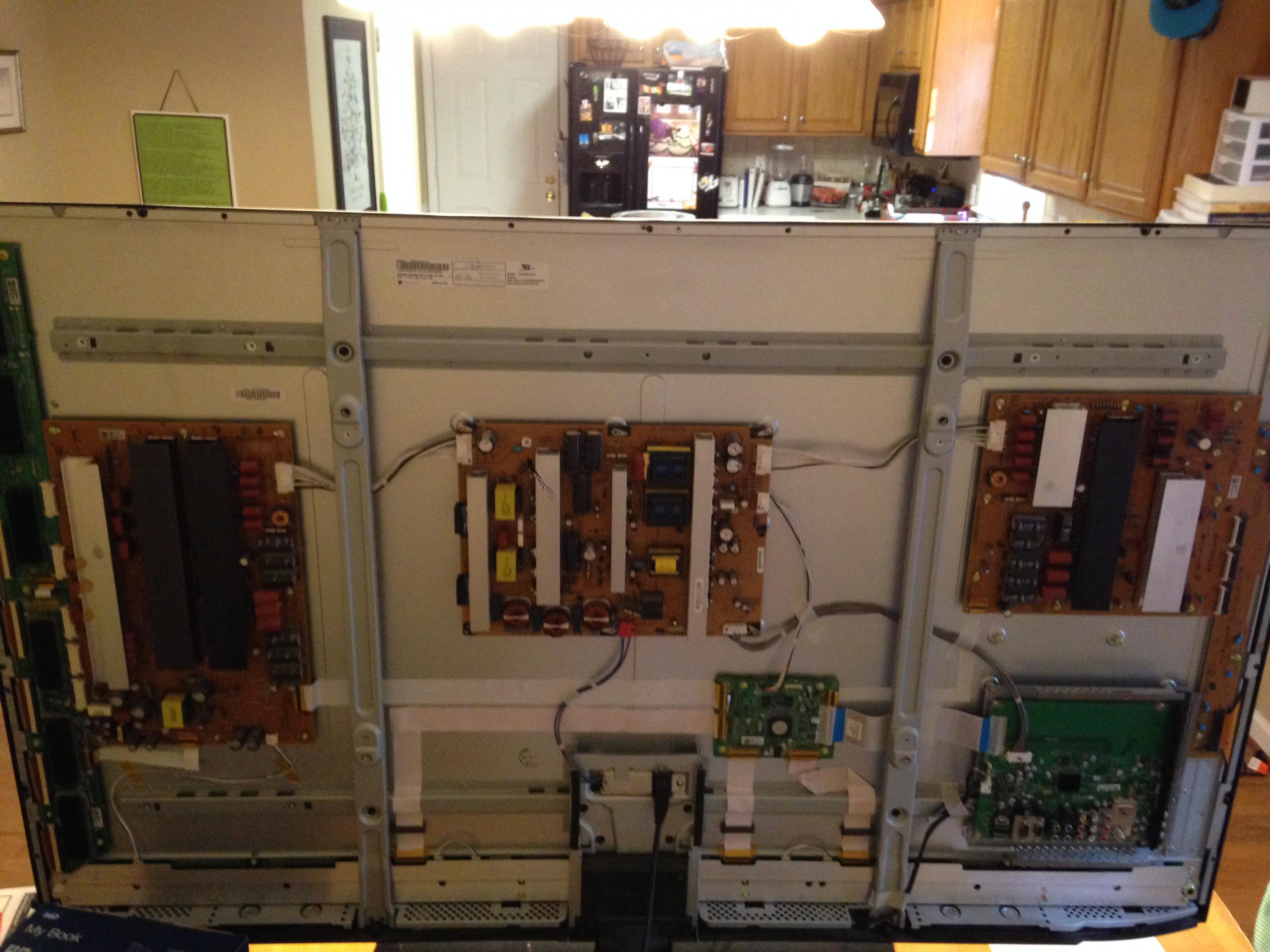

    Hey guys. First off I want to say I've tried looking around the forum in hopes of finding a fix for my TV. I haven't found anything that caught my eye, but that may be because I just didn't understand what I was reading. My electronics experience is next to none and I'm having a hard time diagnosing what is wrong with my LG 60PV450 plasma. So, if there is a thread you think I should look at, please direct me there.
    That being said...the TV was given to me for free from my brother in law who didn't feel like dealing with it. He said that it was working fine, then one day it just wouldn't turn on. When plugged in the TV shows the red standby light. I'll try turning on the TV from both the power button on the actual set and the power button on the remote. Neither do anything and I can't get the TV to do anything. I only hear a click when you plug the TV in and again whenever I unplug it.
    From the little research i did online, I figured it might be the power supply unit. I ordered a new board from ShopJimmy, replaced the old board with the new one, but unfortunately that did nothing for me and the TV still does not power on.
    I really don't know where to go from here and don't know how to tell if any of the other boards are the problem. I was really hoping I'd just replace that power supply board and the thing would turn on.
    If anybody is willing to give me any help I'd sure appreciate it. Please let me know what additional information I'd need to give and I can get that to you. I'm attaching a picture of the back of the open TV as a starting point.

    Re: LG 60PV450 Power Issue
    2 Things:
    1- upload good clear pictures of all the circuit boards.
    2- do you have a digital multimeter?

        Thank you for your response!
        I've attached photos of each board. Please let me know if you need more pictures and I can get them.
        I disconnected that wire you told me to, plugged in the TV, and still nothing. Pressed power button on both remote and on the actual TV. Black screen with solid red standby light.
        I do own a digital multimeter, so I can follow any directions you may have for me. I just don't have a clue where to even start with this project.
        Thanks again.
        -James

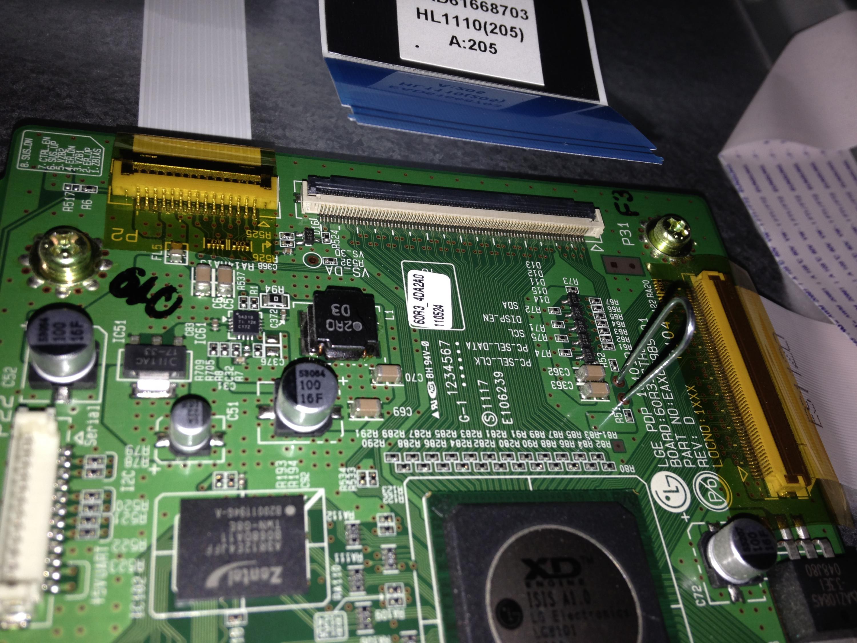

          Ok plug that connector back in.
          Now, on the control board (smallest board in the tv)
          You'll find 2 holes, I can see them located here:
          With a piece of wire (paper clip etc) connect the 2 holes.

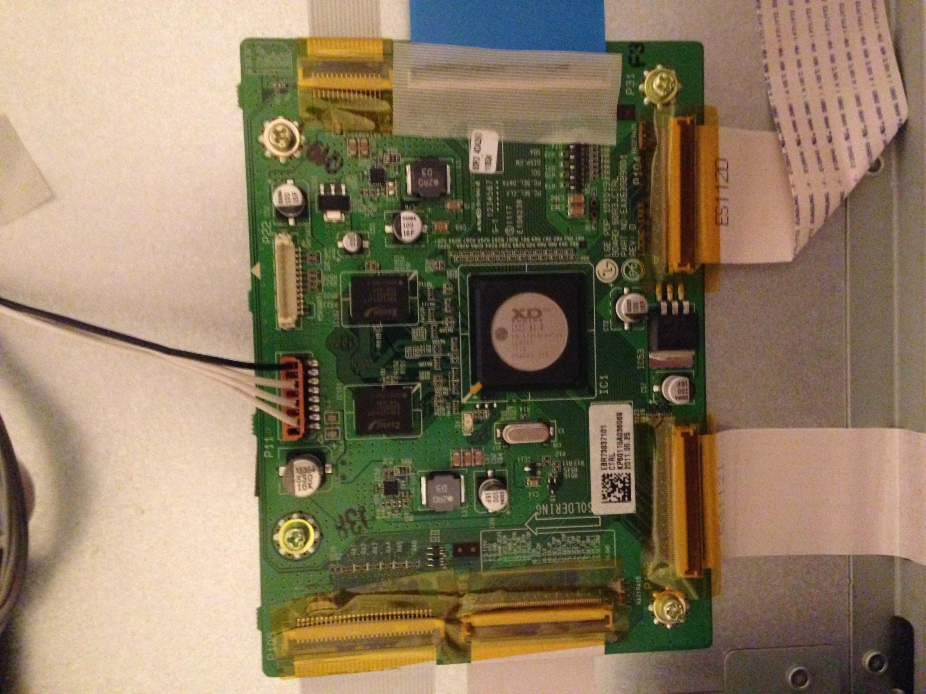

            Now, Disconnect the lvds cable (the flat cable with the blue tab) labelled P31.
            Power on the tv.
            Do you get test patterns?
            If so you have a faulty Main AV Board.
            If not, you will need to check some voltages.

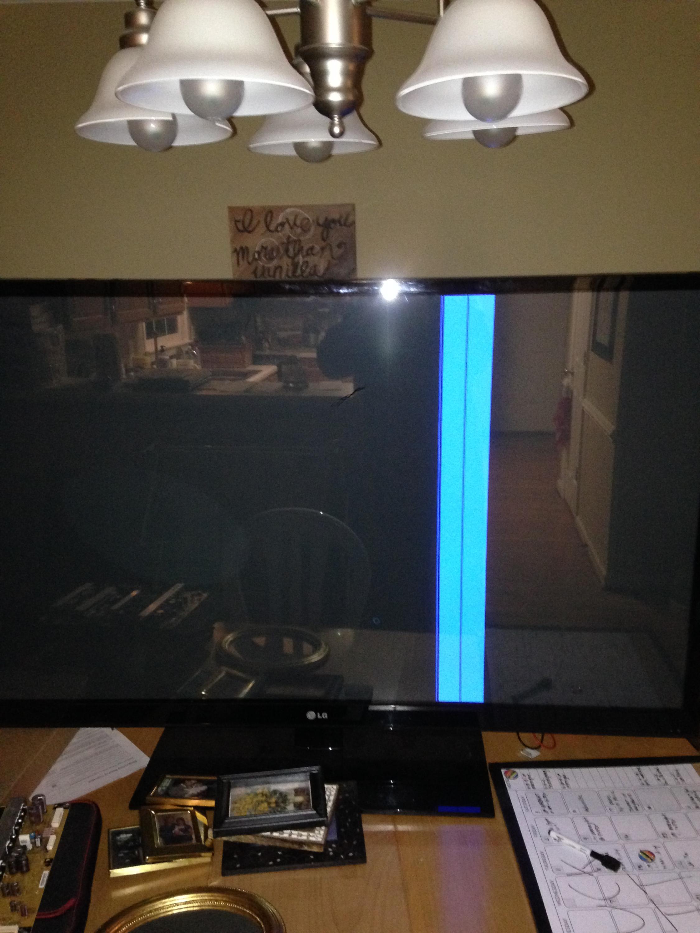

                So I did what you said...see attached picture. Pressed power button and still can't get anything to happen. Blank screen with solid, red standby light.
                Should anything be happening when I hit the power button?
                Any more ideas?
                Thanks again for any continued help.

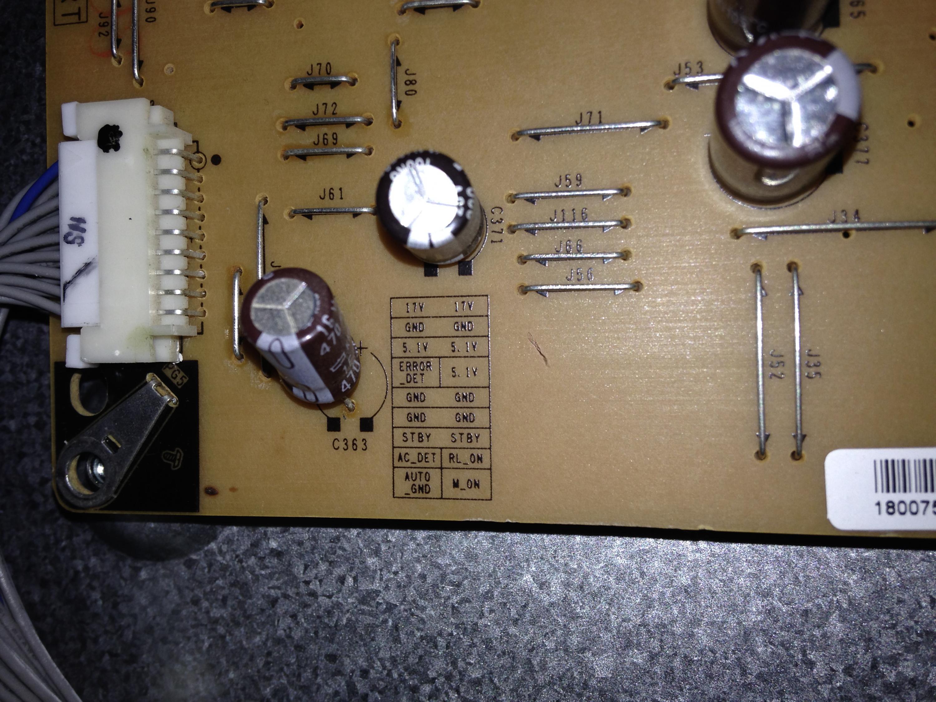

                  I need a close up picture of this part of the board.
                  I need to be able to see the legend table

                    Here's the picture you requested.
                      Ok so we need to connect STBY with RL-ON
                      Disconnect the mainboard form the power supply. (At the mainboard end)
                      And with a piece of wire jump the points mention above together.
                      Power on the tv.
                      Do you now get test patterns?

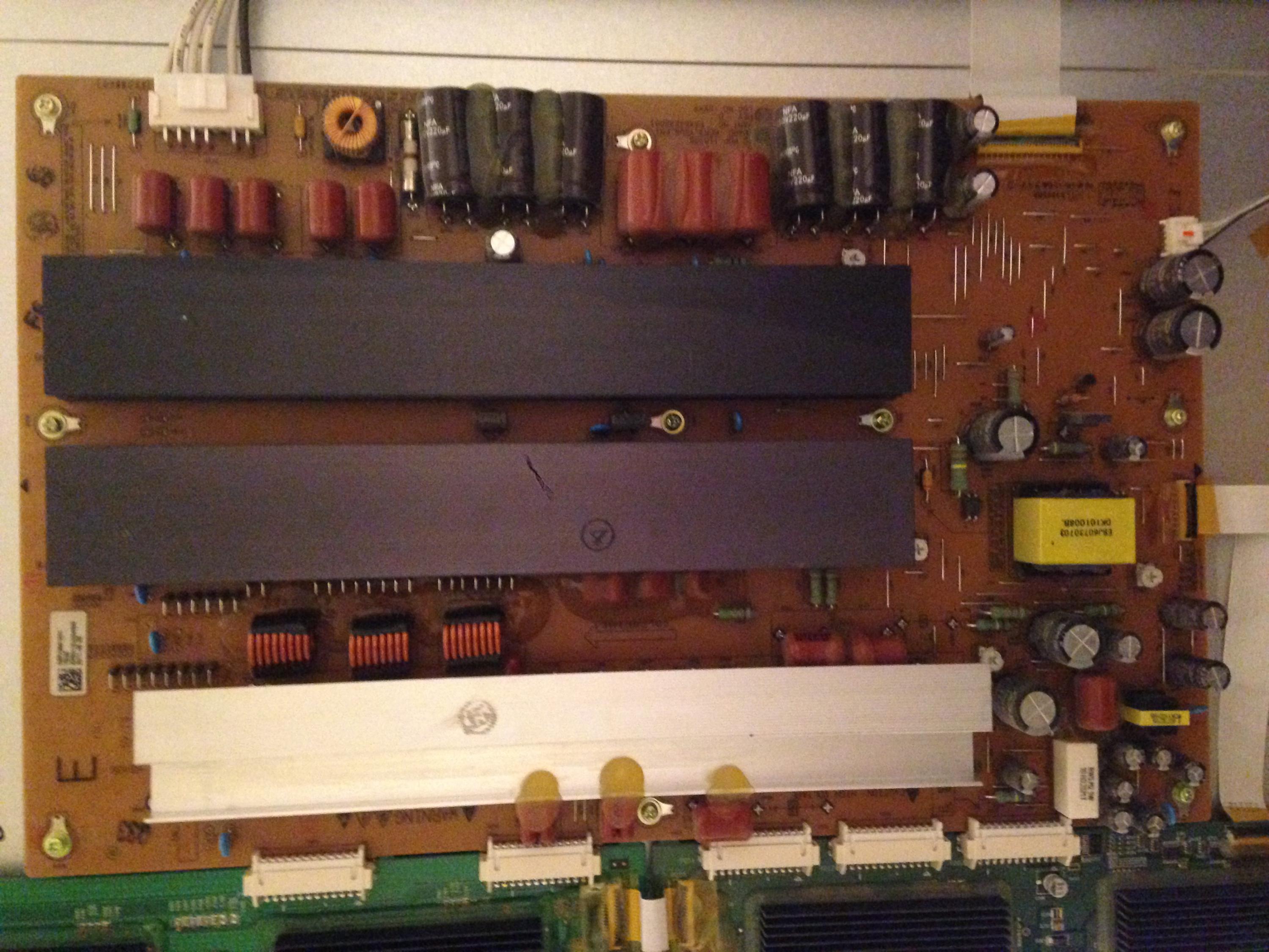

                          If you still don't get test patters.
                          Unplug both the y-sustain and z-sustain.
                          Plug back in the tv and test both these test points marked VS-TP and VA-TP
                          (Red probe to the marked wire, black probe to the Tvs chassis. Multimeter in DC volts)
                          Vs should be roughly 200v
                          Va should be roughly 60v

                                  I never asked you to remove your paper clip joining the 2 holes on the control board.
                                  Put it back in place.
                                  Test patterns should look like.... Well... Test patterns!
                                  Full Red screen, then blue, green, selection greys blacks and whites etc
                                  Btw that blue bar isn't a good sign. Panel might be bad.

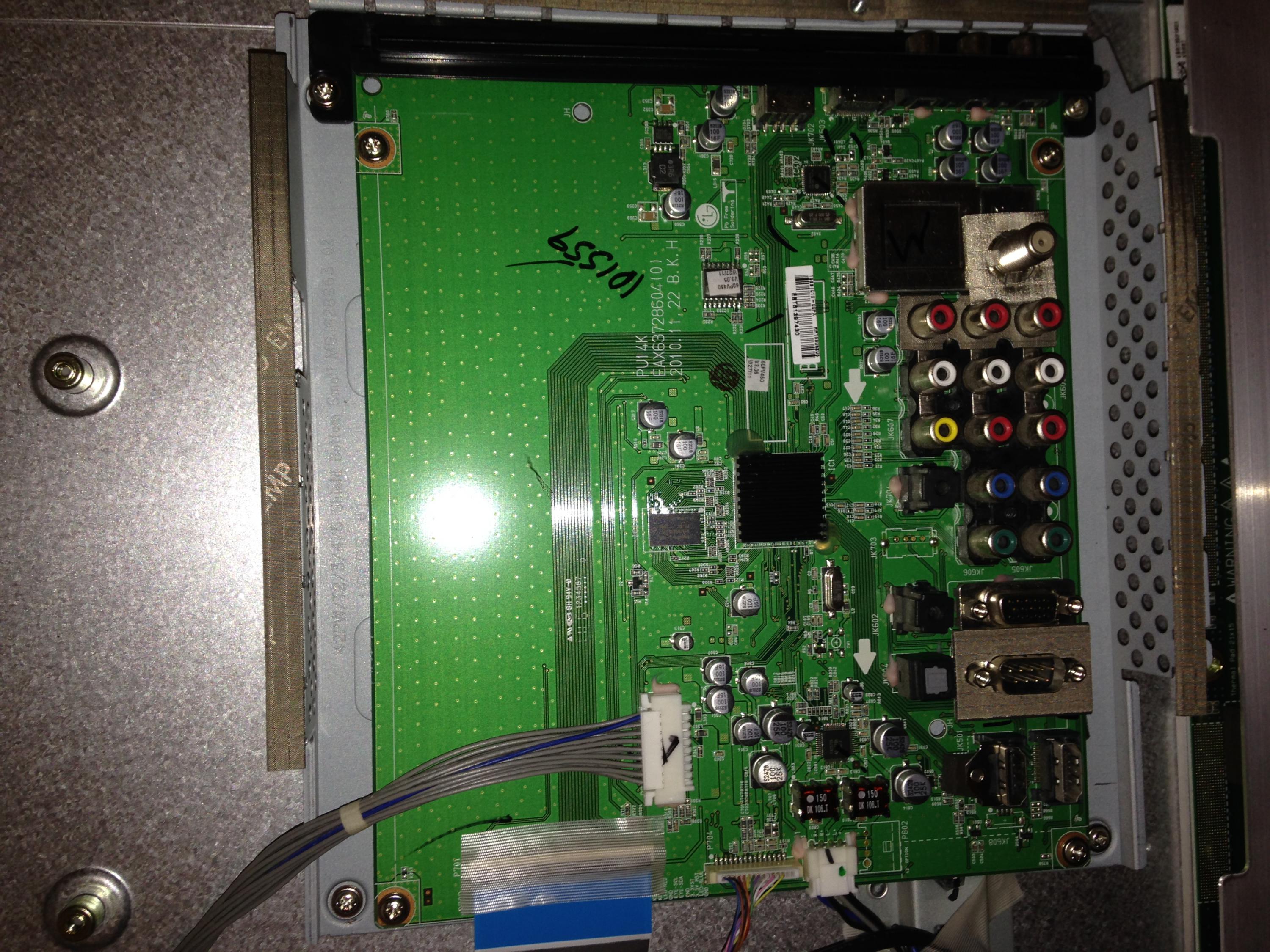

                                      Well unfortunately it's going to be bad news.
                                      The 'not turning on fault' is caused by a faulty Main Board or maybe even just has faulty remote receiver and buttons.... But because it's LG And they are notorious for bad main board id say it's that. (You can do some tests to find out if it's the mainboard or the buttons quite easily by monitoring the voltgage to the buttons and pressing them at the same time, the voltage should jump around as you press them.) if it does, it's almost certainly a bad mainboard.
                                      The bad news: the 'blue streak' is caused by the screen (panel IC) and almost certainly won't be fixable without replacing the whole screen.
                                      The good news (I suppose)
                                      Is you can guarantee that every board in the tv is working (apart from the main board.)
                                      So you can sell them off, they are probably reasonably valuable.

                                        As far as the blue line, what is the main cause for that? Again just curious. Is it from something like overuse or physical damage or something?
