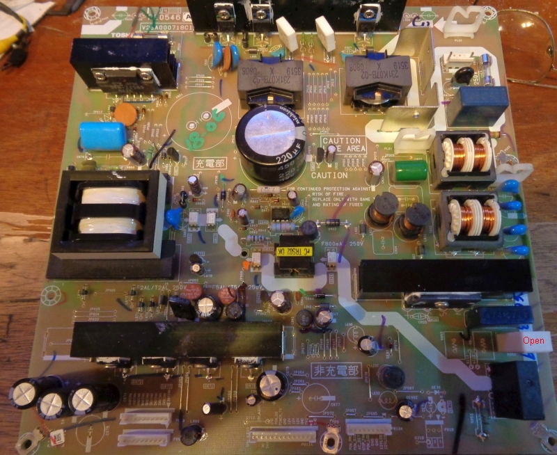

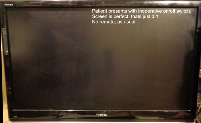

    --Please see all the below pictures (800 x 600) which go along with the story and are in chronological order. This Toshiba Rezga 42RV530U was picked from the curb, and had no signs of life. The fusible resisor 1.8 Ohms was found to be open and was replaced with the new recommended 2.0 Ohm replacement. TV was working fine, so I swapped it to a friend for some automotive work, but after three weeks he brought it back with the shutdown syndrome.

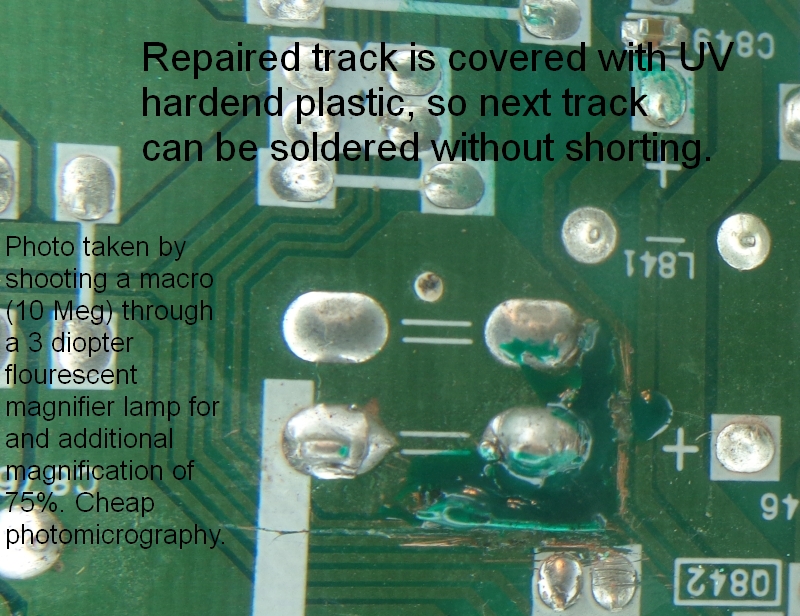

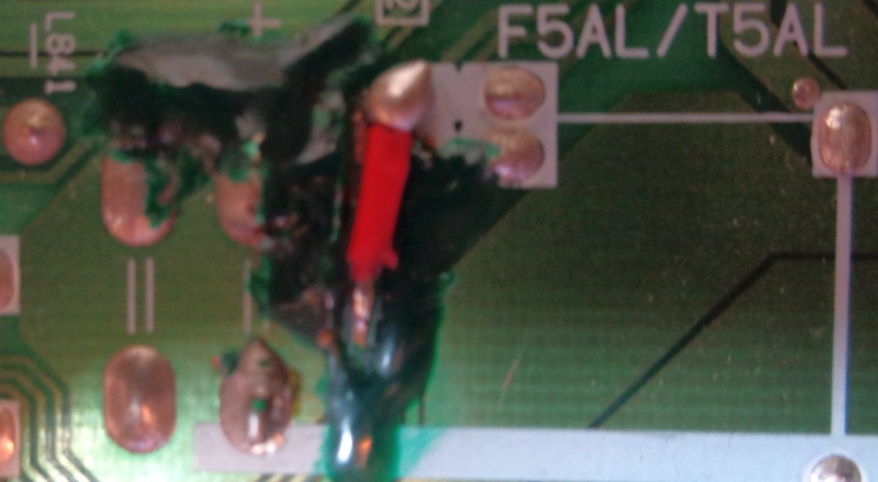

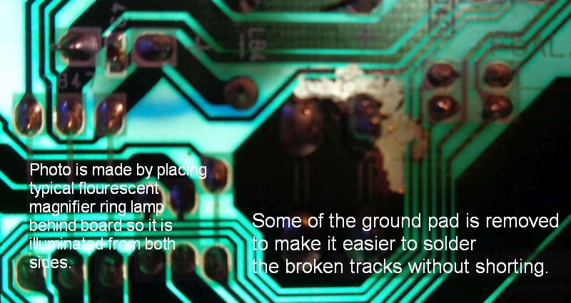

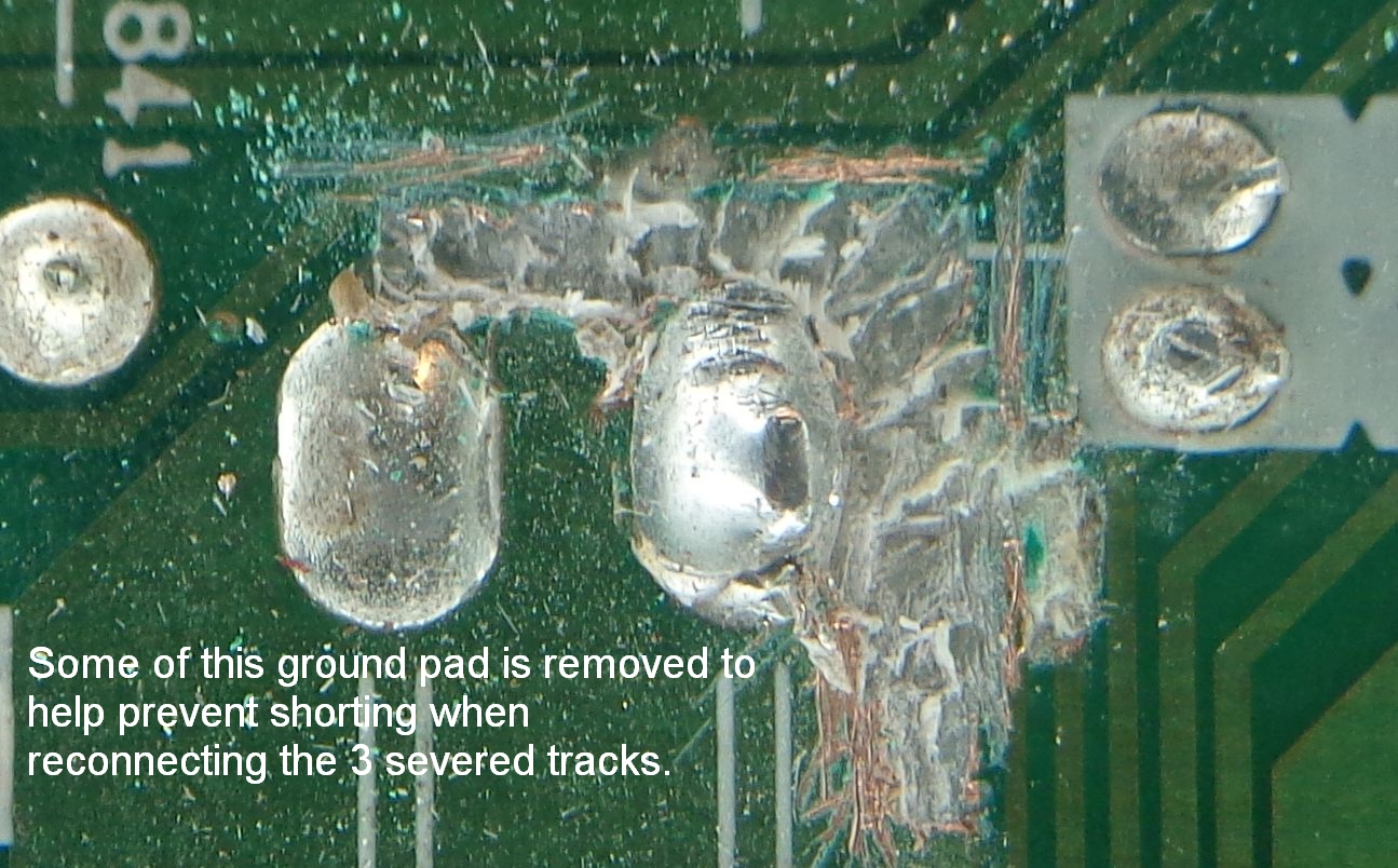

    --In attempting to remove a component for testing, I invertantly damaged three tracks. Pictures with text explain the repair and a couple of photography tricks. In any case the tracks were repaired, and we are back to trying to fix the two seconds to black.

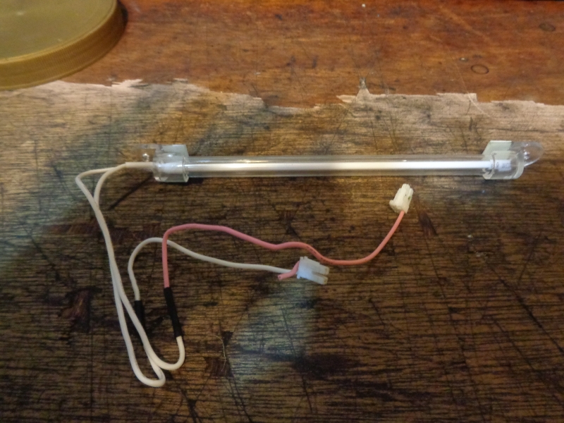

    --TV comes on for two seconds then shuts down, then comes on again briefly and shuts down. Next time you have to push the power button (or the remote) twice to get it to start up as before. Green standby light will go out after a half hour if no buttons are pushed. I have tested each of the 20 CCFLs individually with a tester and they all light up. Also I obtained and installed another used slave inverter board, which makes no difference. I include below pictures of the voltage listings on the power supply board cables. I am standing by with an old Fluke 87 DMM, and a Sony Vario 20.1 Megapixel camera at ready. Your advice is humbly solicited.

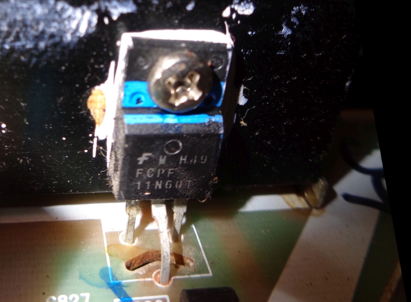

    As per suggestion by RetiredCaps, I made up an inverter tester and tested all 20 inverter outputs. They are all turn the lamp on just fine. Interesting thing! If I try to measure the voltage at the drain of either 11N60T 600V 11 Amp MOSFETs. It tries to blow my Fluke 87 DMM rated for 1000V. Just drives it haywire or shuts it down. I do not have enough experience to know if this is normal or not. Any Suggestions?

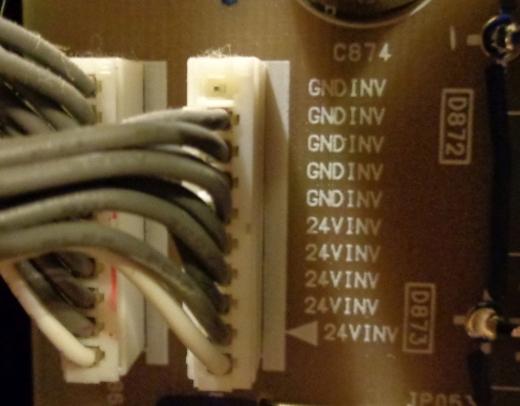

        Re: Toshiba Rezga 42RV530U 2 Seconds to Black.
        Do you have persistent 24v going to the inverter even after shutdown ?
          Dear Reecey:
          --Yes, indeed I do. Thanks for the prompt response.
          Cheers!

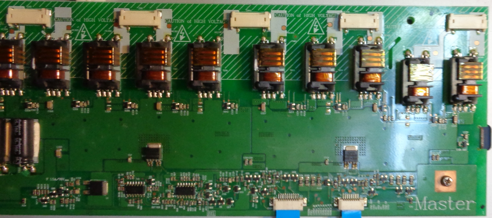

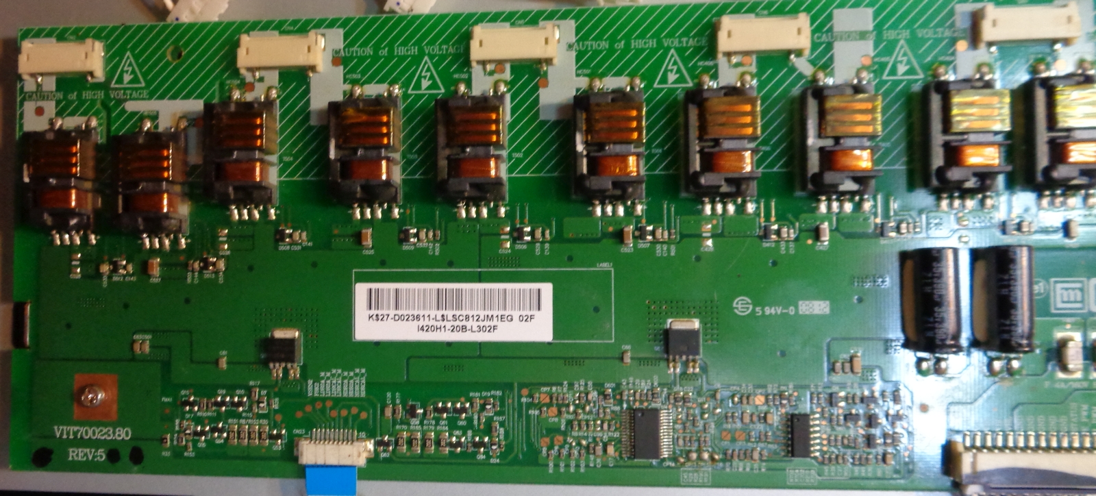

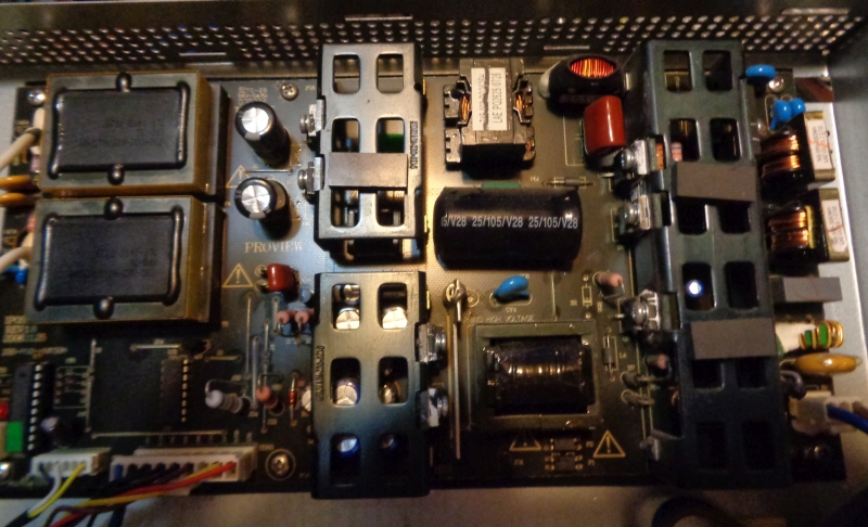

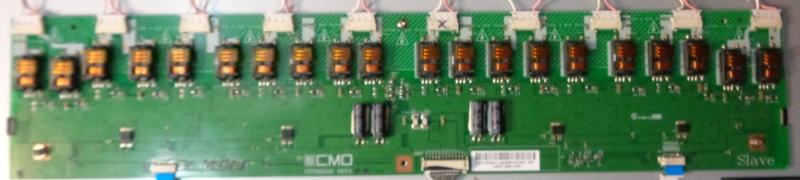

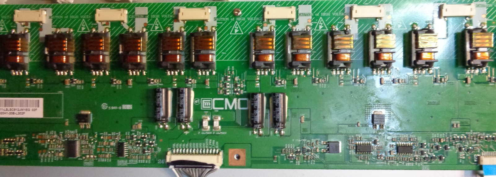

            Ok alright, now could you upload a picture of the inverter Pcb please cheers.
              Dear Reecy:
              --Included are a picture of the master inverterboard with 3 close ups, plus one picture of the slave board. I bought an extra slave board for checking and for the extra inverters and silicon. Just let me know of anything else you need. Many, many thanks!
              Cheers!

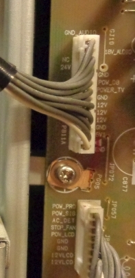

                Check the "BLON" pin voltage -- see if it drops off when the TV turns off.

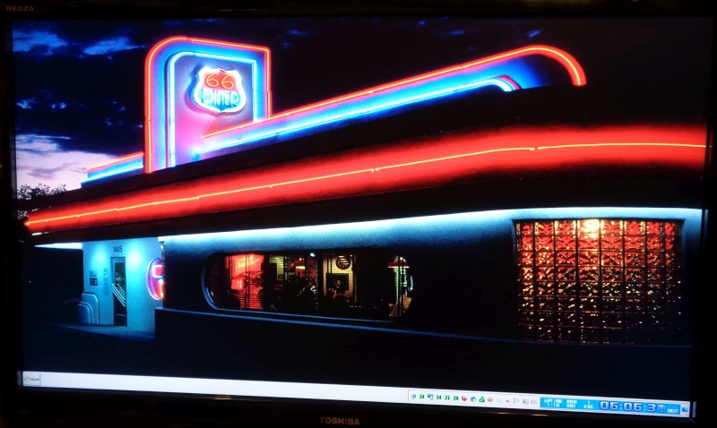

                    --I can find no BLON. Pow-DB is at 5.00V and remains so when power button is pushed. Pow-TV is at 3.301V and remains so when power button is pushed. Power-Pro is at 3.012V and remains so when power button is pushed. Power-Sig is at 3.280V and drops to zero when the power button is pushed the first time. The second time the power button is pushed Power-Sig returns to 3.280V and the back light come on.

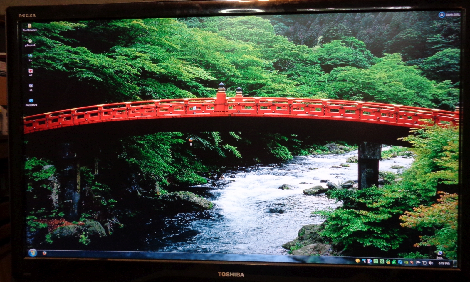

                    --Hold the phone! The backlight are now remaining on, and the TV has a beautiful HDMI 1080p pic. Indeed, I do not trust this. But I am leaving it on for the moment pending further advice.
                      R and F:
                      --Here are a couple of examples of the picture. I did manage to get into the menu and change the backlight to 50% from the previous 70%, just in case that helps.

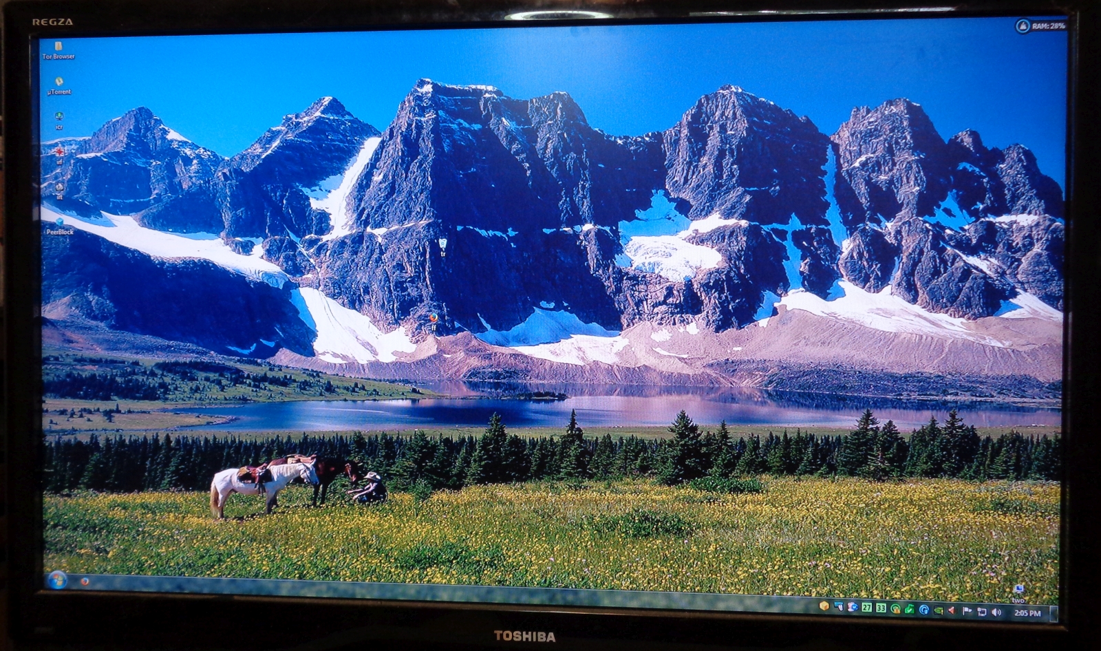

                        R, F and T:
                        --I left it off long enough for the green light to go out, a couple of times, and it starts back up with no problem. It comes on with the backlights at max and drops to 50% after about a half second. I am guessing that Freak is correct and that there is an imbalance. I will return it to the owner, and see what happens. If it fails again, with the backlights set to 50%, I will dissassemble all the way, and have a look at CCFL tubes. Unless there are any other ideas at this time. Again many thanks to Reecey, Freak and Tom. As a famous Ozzie said "It bites a pike in the eye, might."
                                The highest voltage I have measured is 400V DC and Fluke meter worked with no problem. The Fluke 87 should measure 600V with no problem.
                                That mosfet, Q820, is on the hot side. Did you use the negative leg of the large filter capacitor as ground when taking a voltage reading?

                                  --As I recall, I held one lead on the Drain and probed some points which I guessed might be the neg leg. I guess you could say I was just blundering around like a d***ned fool, grasping at straws. Unfortunately, the TV is all back together now and I do not really have the time to take it apart again. If there was some way to get an overvoltage, that is no doubt what I did. When I was in the Air Force a senior NCO once told me that if I was locked, naked, in a rubber room with two ball bearings, that I would lose one and break the other one.

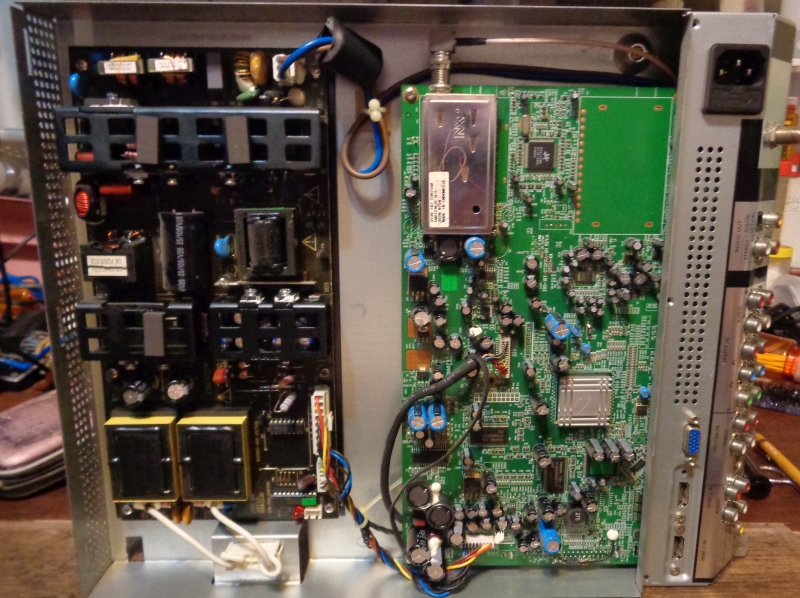

                                      --I noticed the the Toshiba Regza 42RV530U is very well built and uses good 105C jappers everywhere. I just scrapped a couple of Polaroids, 32" and 40" from the same era 2007/2008 as the Toshiba. One look at the inside of the Roids convinced me junk them. Really outdated construction tech, with crap no name caps everywhere. I include some pictures from the Polaroid TDA-03211C 2007, which would come on but had a intermittent display problems like way too bright and washed out, definitely not worth my time. I did not disassemble the Polaroid 4011-2LXB also from 2007, which had a broken screen but I could see that the construction is just like the 32", I.E. the Mainboard and the PS board are both in a square metal fruitcake pan which rattles around loosly under the back cover. If any one wants any of the parts from these two I will be glad to send them to you for the most economical cost of shipping, usually USPS Parcel Select or Expedited. If no word in the next 24Hrs, to the nacker they go, RIP. P.S. I have a remote for the 4011-2LXB.
