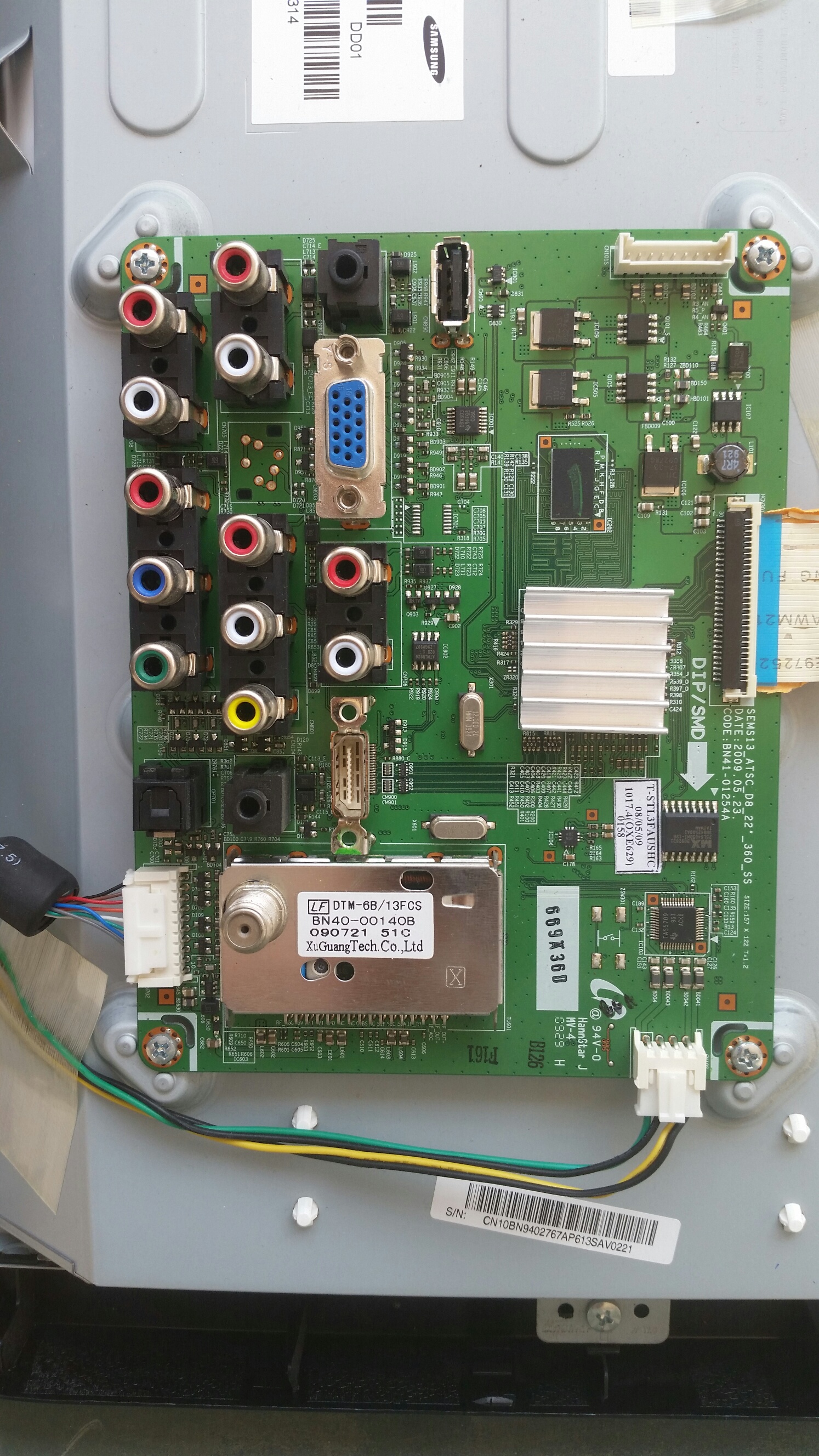

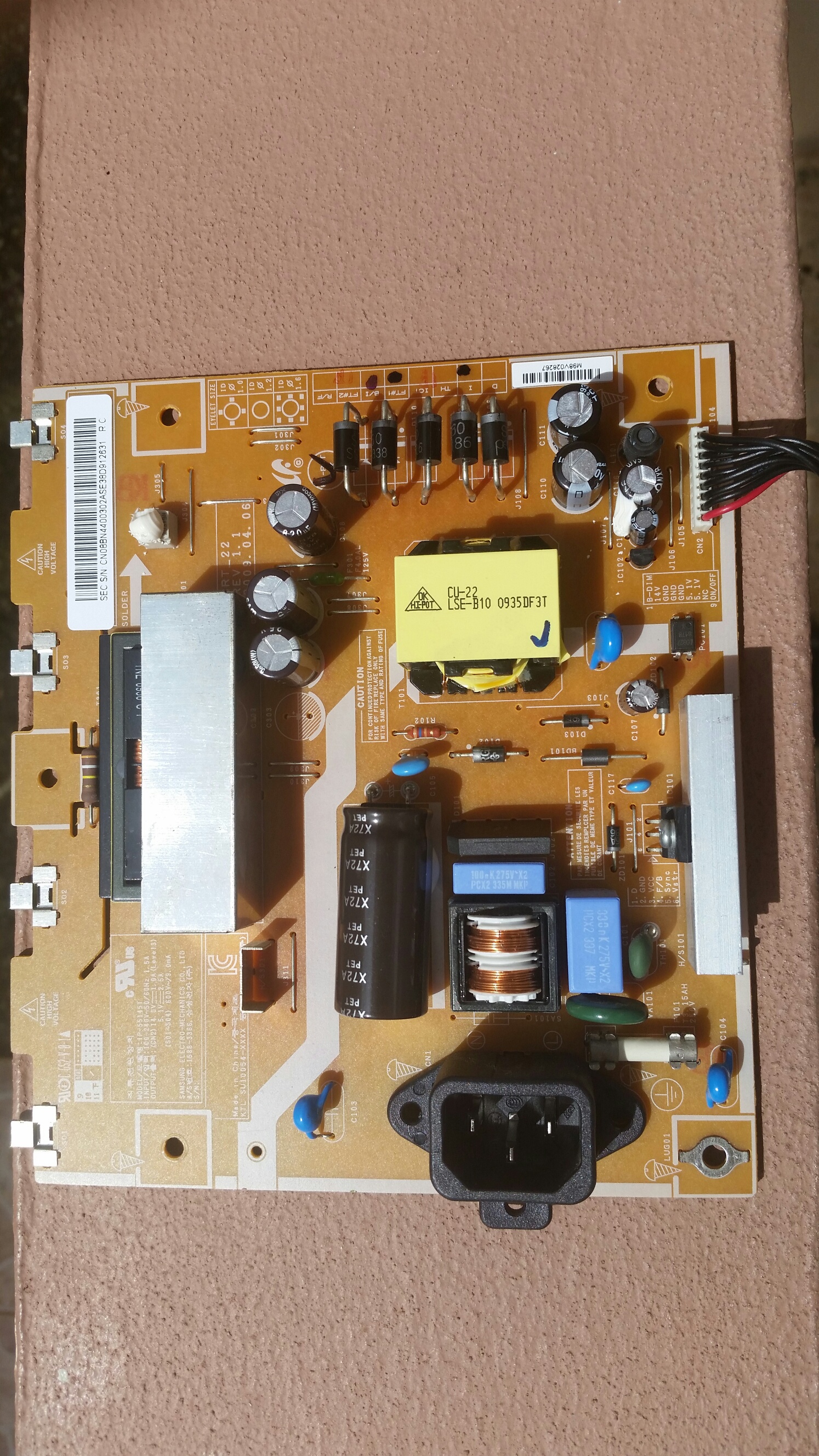

    This is a Samsung LN22B360C8D with Power supply BN440302A and the main
    Board is BN41-01254A.It has the red light on but when trying to turn it on the
    red light goe's off and blink twice and the stay on but the tv doesn't turn on.
    The voltages at the output for the main board (board disconnected) are:
    Pin B-Dim---0v
    Pin 14v------fluctuate from 13.99v to 14.32
    Pim 5.1v----5.02v (there are 2 pins with same voltage)
    Pin NC-------0v
    Pin on/off---0v
    With board connected voltages are:
    Pin B-Dim--0v
    Pin 14v-----15.2v
    Pin 5.1v----5.08v (both pins)
    Pin NC------0v
    Pin on/off---0v
    On the Big Capacitor C105= 173.3v
    Ic PC 101= a)46.5v b)3.57v (pins on the cold side)
    c).2v d) 0v (pins on the hot side)
    D101= a)0v b)85v c)83v d)173v
    Please somebody tell me what to do now to fix my grandsons tv.

    Those are excellent clear focused pictures. So many people who come here looking for help can't understand the importance of this.
    The red light is your standby light indicating 5V standby is likely good.
    Pin on/off---0v
    Pin on/off---0v
    The last pin, on/off, is likely the command from the main board to tell the TV to turn on the backlights. It should be high or greater than 3V.
    If your multimeter has min/max, see if on/off temporarily spikes at 3V and then drops to 0v.
    In addition, if you hookup a DVD player, do you get sound? Can you see a picture if you shine a flashlight on the LCD screen?

                    was the main board a exact match as in all numbers on white stickers etc match 100% can you retake all the voltages again with the new mainboard in too.
                    • ruben53
                      • Sep 2015
                      • 37
                      Re: Samsung LN22B360C8D doesn't turn on
                      Thanks for answering.
                      Yes the replacement board has the same numbers is an exact match.
                      The voltages that I posted are with the new mainboard.
                      I want to be sure the problem is in the mainboard so that I can return it to the
                      seller,the problem is that seller doesn't have another mainboard to replace this one.

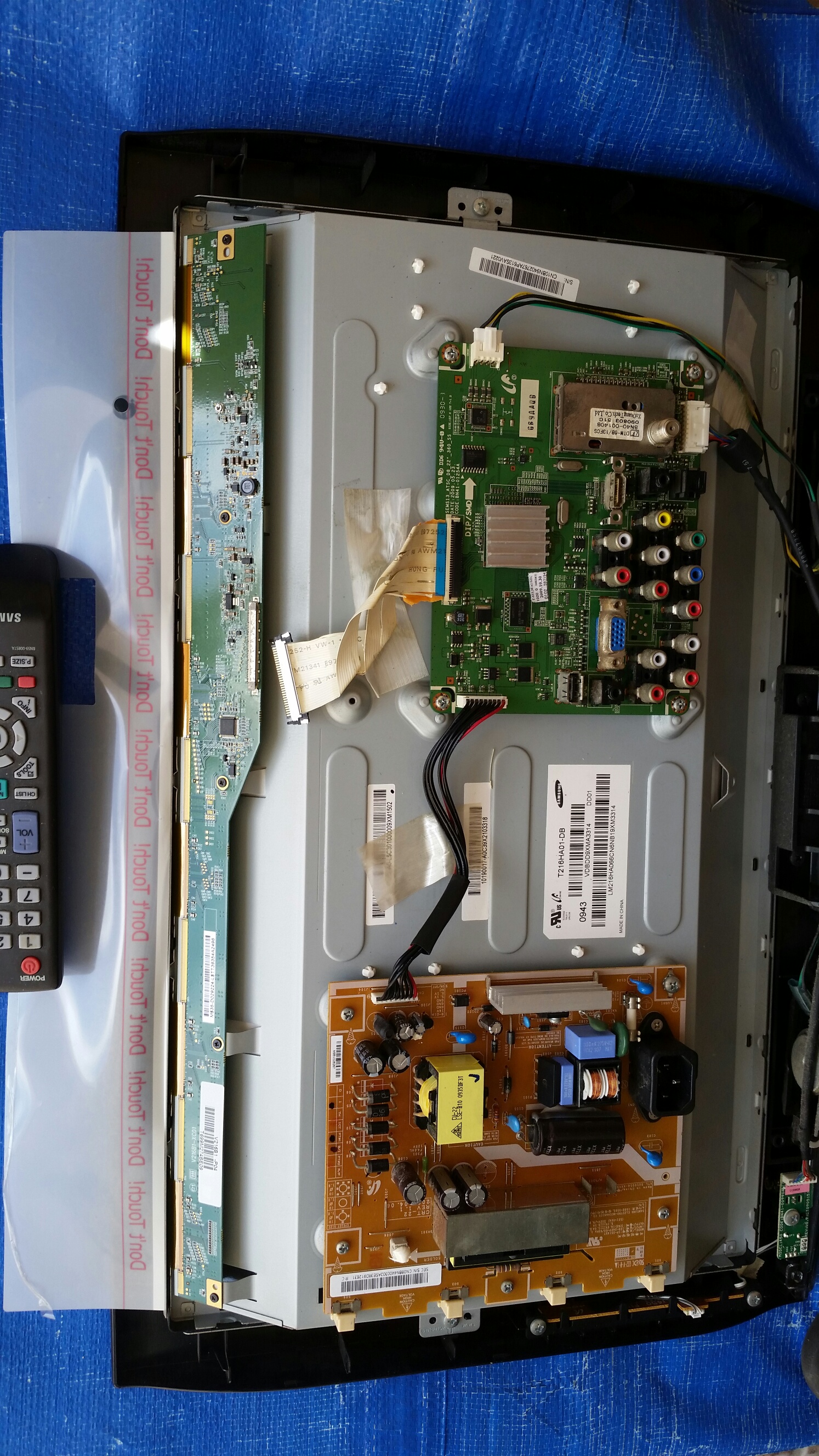

                          This is an update,when I take off the plug that goes from main board to the
                          T-con board and hit the power the screen turns on but with the T-con plugged
                          in the screen doesn't turn on.
                          Does the T-con board and the screen panel is one piece or it can be replaced
                          apart?

                            does should like the panel or tcon has a short can you upload pictures of the tcon and back of panel so we can see what were dealing with as some of these smaller sets the tcons cant be removed as are part of the lcd screen assembly.
                            • ruben53
                              • Sep 2015
                              • 37
                              Here is the picture of the back of tv.The T-con board looks that is part of the screen.
                              Can this T-con board be fixed?
                              Iam sorry for the picture isn't complete,I will try again.
                                Here is another picture,hope this one is OK.

                                  yes thats fixed to the lcd so cant replaced, im not sure what else to suggest you too test maybe wait until a more experienced member chimes in with ideas
                                  • ruben53
                                    • Sep 2015
                                    • 37
                                    OK, Thanks.Lets see if somebody else can give any idea,because this panel is
                                    not easy to find a replacement.
