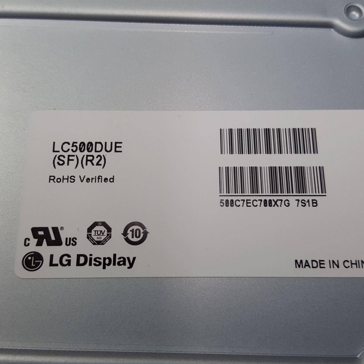

    Hey gang,
    I picked up an LG 55LN5700-UH that has an issue and I figured I would have a go at trying to repair it.
    I've searched here and I have some ideas but didn't really want to hijack any existing threads. Didn't find any of this exact model.
    Attached are the model sticker and software version. And the last youtube video link is a short video of this exact set showing the issue.
    The set software is up-to-date and the behavior of the screen dimming every 2.5 seconds and then going back to normal and while the slight dimming occurs faint horizontal lines appear. This is much more noticeable in a white screen and/or brighter areas and it also seems more pronounced on the left side of the panel as viewed from the front.
    The symptom occurs with the picture reset, all picture enhancing functions turned off and the backlight turned all the way down. Also it occurs with all HDMI ports and different HDMI cables and devices. I can not test the component video connection.

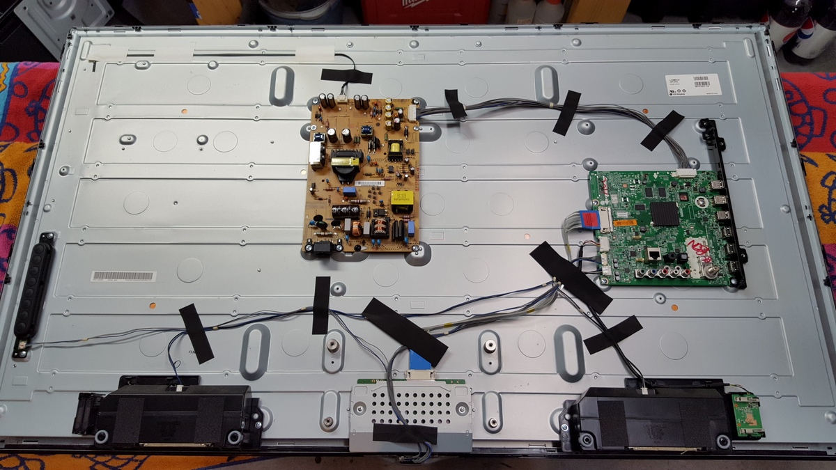

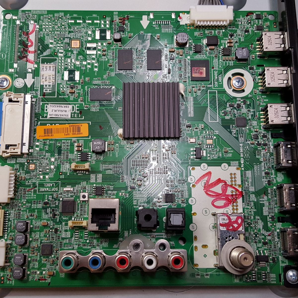

      Re: LG 55LN5700-UH dimming every 2 seconds...
      How about good clear pictures of the whole back side of the TV so we can see how all the boards are connected together, then good clear pictures of each boards.
      • niswanger
        Roy Niswanger
        • Oct 2015
        • 33
        Thanks budm,
        Been busy with real work. Here's a start...a lot different than a Panasonic Plasma I tried fixing. I'm assuming there are more boards under the large metal panel?
        Attached are the images.
        Thanks,
        Roy

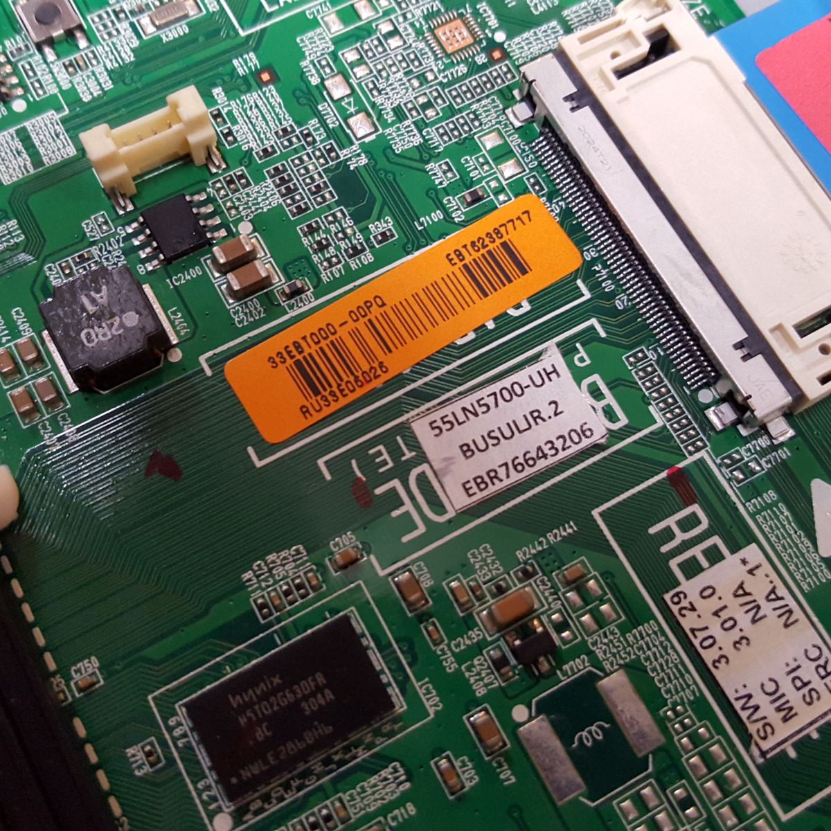

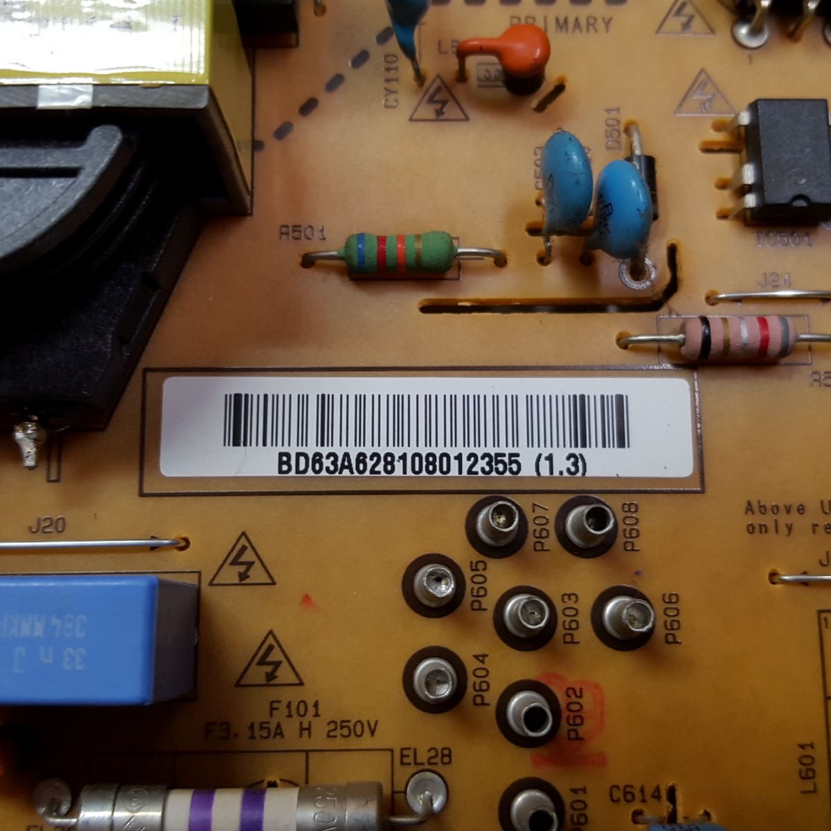

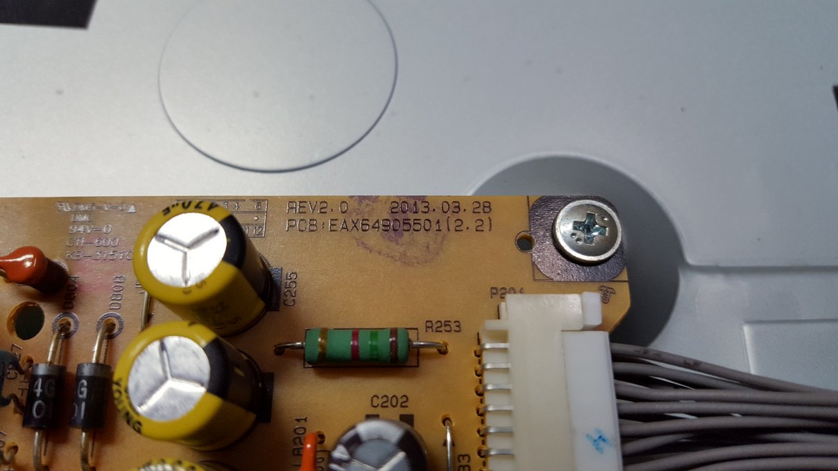

          Looks like posts have edit expiry...too bad it's not more like 12 hours. Anyway, here's some more info. Attached is a close up of the p/s model printed on the board.
          Notice the top line says REV 2.0 but the the second line says PCB: EAX64905501 (2.2). Just checking over on shopjimmy.com and all I found is one that says (2.0) http://www.shopjimmy.com/catalogsear...05501%282.0%29
          So I'm itching to test and rule out the p/s first if that's possible. Hopefully that's where the issue is at. Recall the symptom in my OP...the panel looks 100% GOOD for 2 seconds, then for 2 seconds the panel dims, exhibiting some horizontal faint lines where mainly the left side of the screen seems to dim more than the right. So I'm thinking the statement from shopjimmy.com "PLEASE NOTE: Models that use this power supply are also HIGHLY susceptible to LED failure. What may seem like a power supply failure may be caused by the failure of one or more LEDs inside the panel (screen)." doesn't fit my panel since the display does work seemingly perfect for 2 seconds at a time.
          Thanks,
          Roy

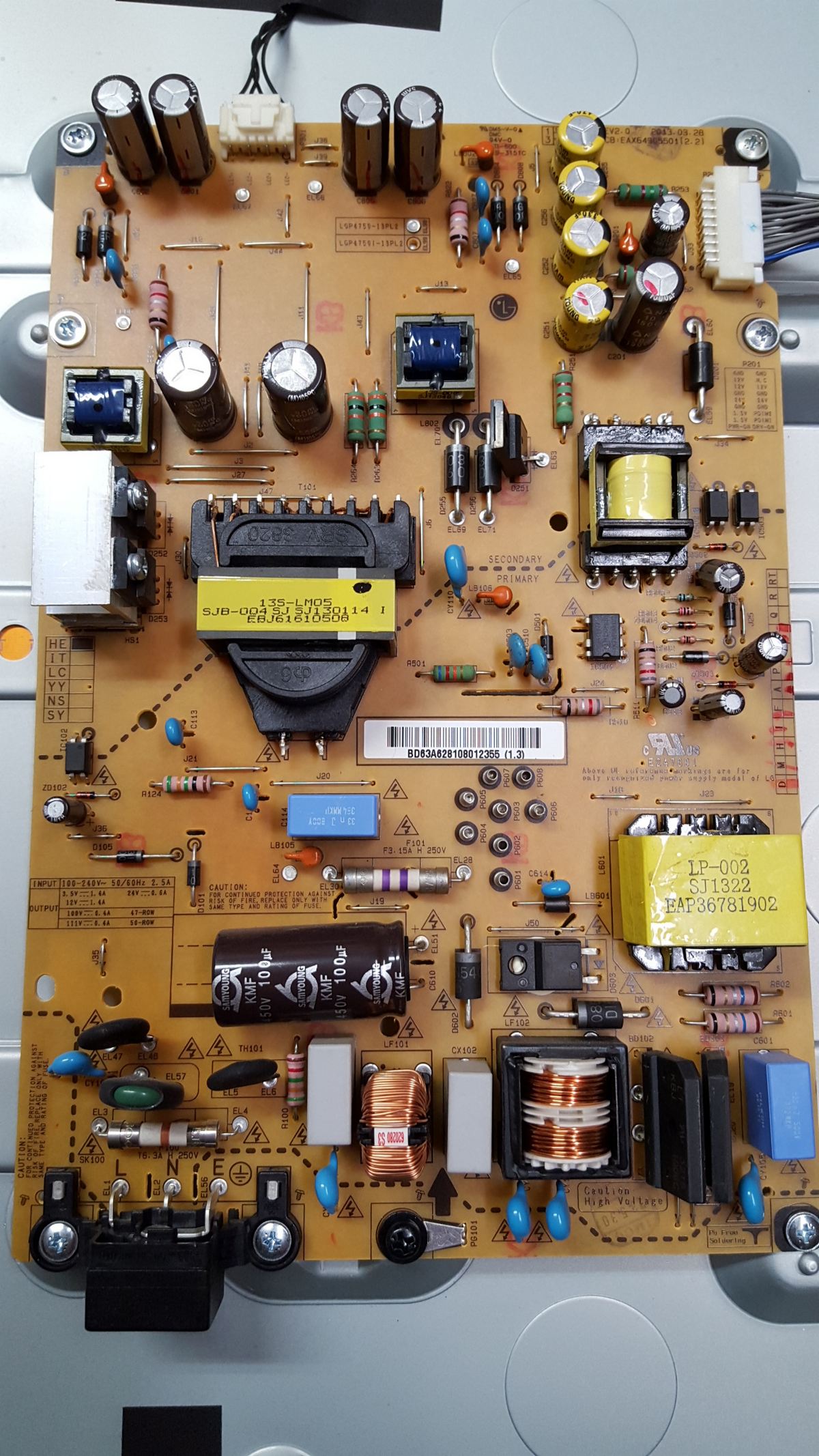

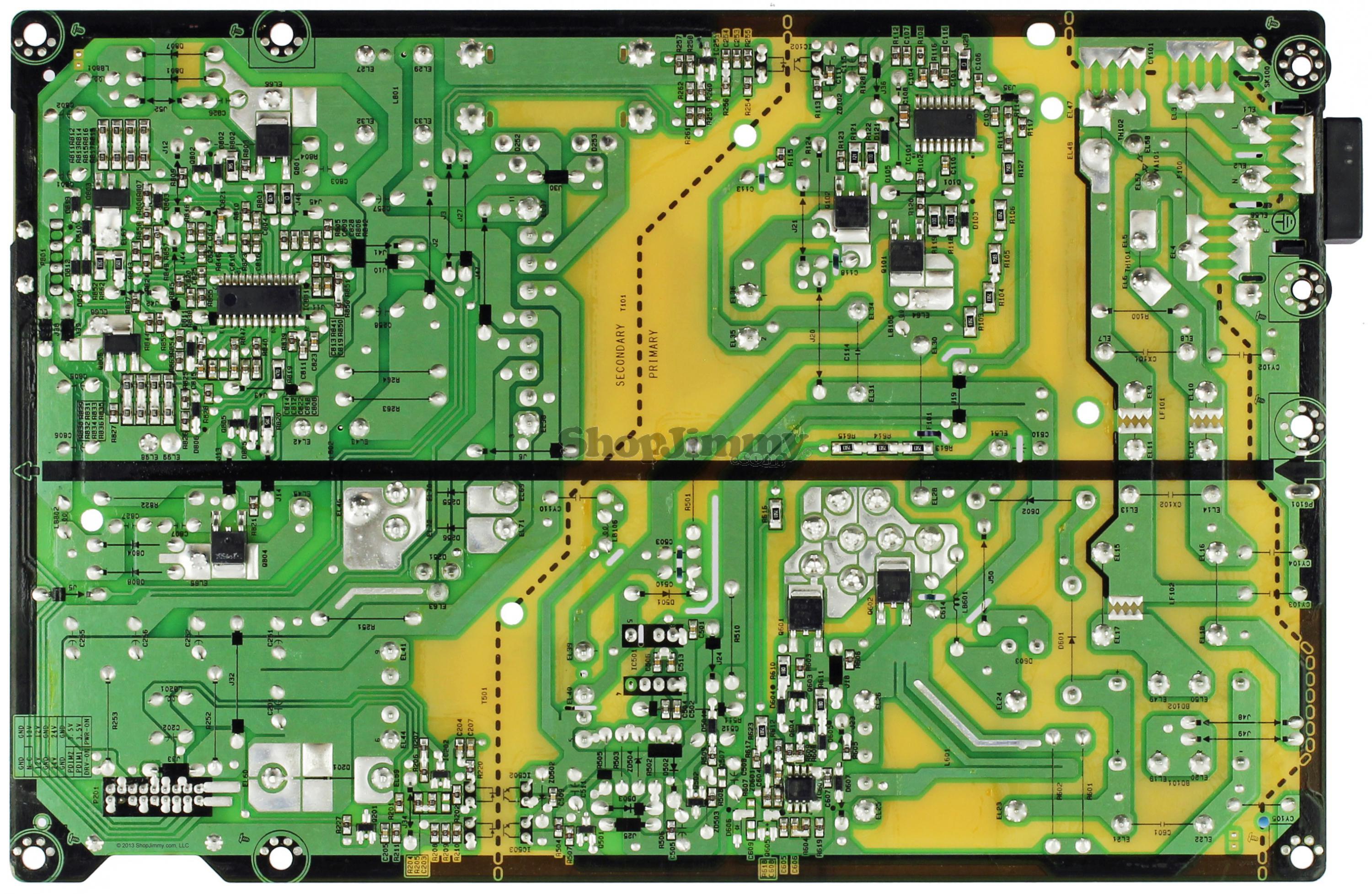

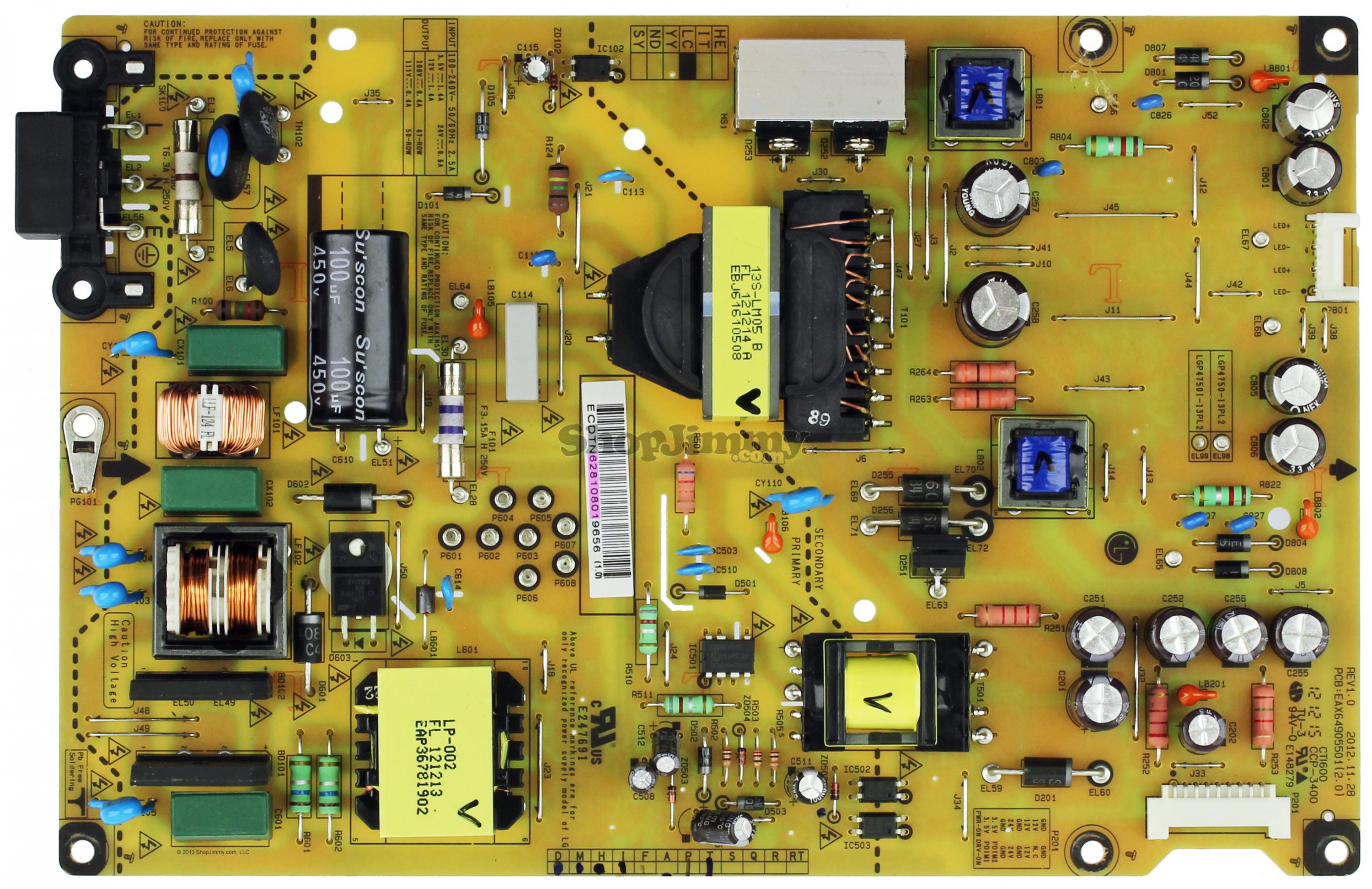

            OK, I found good clear pictures of the power supply-LED driver board LG EAY62810801.
            There are two string of LEDs, it looks to be one string for the LEFT edge of the panel and one sting for the right edge of the panel. The two strings are individually controlled as you can see there are two PWM driven POWER MOSFETs (Q803, Q805) for each string.
            So based on what I see on your youtube, it looks like the left side is not stable.
            There are 4 wires on the LED connector P801., 1 pair per each LED string, you can try swapping the pair of wire to see if the problem will follow to the right side of the screen or not.
            What do you see if you feed the TV with signal that only has white for the whole screen?
            Pictures provided by shopjimmy.
            BTW, bad LEDs can flicker bright and dim.

              Thank you. I only took a quick look and I couldn't find Q803/805 on the main p/s board. I understand you thinking and found P801 connector. There are 4 pins +/- LED so I guess the best way to swap is to unplug and then use a needle to prob and somehow swap them? Thinking here is that if the behavior follows to the right side then it could be an issue on the main ps board? If the issue remains then it could be the LED controller and/or LEDs?
              Also, that board "LG EAY62810801" is not exactly my board, mine says 2.0 on the first line and (2.2) at the end of the second line.

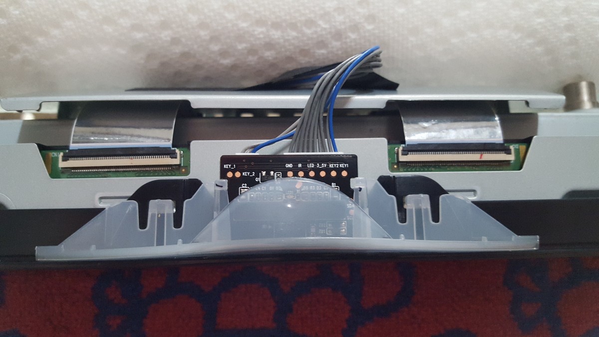

                3. Now to get to the board (whatever it's called) that the cable from P801 goes to I have to remove they entire metal cowling. Any tips for removing it? I see it's held on with very small screws and of course I will have to disconnect two ribbon cables at the bottom and a few more around the panel.
                  'Thinking here is that if the behavior follows to the right side then it could be an issue on the main ps board? If the issue remains then it could be the LED controller and/or LEDs?' That is correct. Make sure to label wire before swapping.
                  ' I couldn't find Q803/805 on the main p/s board' They are SMD and located on the bottom side of the board close to the LED connector per shopjimmy pictures.
                  'Also, that board "LG EAY62810801" is not exactly my board, mine says 2.0 on the first line and (2.2) at the end of the second line.' Then you need to provide good clear pictures like shopjimmy.
                  'Is this board the power supply-LED driver board?' Yes, it is power supply/LED driver board combo.
                  'Is it possible to see if the power supply board is not maintaining proper steady DC voltage across each set of LED +/- on P801 to isolate the ps board as a potential culprit?.' There is ONE LED controller/ Voltage Boost converter SMD IC and POWER MOSFET that produce the boosted Voltage that feeds both LED+, then the two power MOSFET for the LED- return for each string, these two MOSFETs are driven by the IC so if one of the MOSFET or the drive signal is bad then it affect only one LED string. So what you need to find out in details is to get the P/N of the IC.
