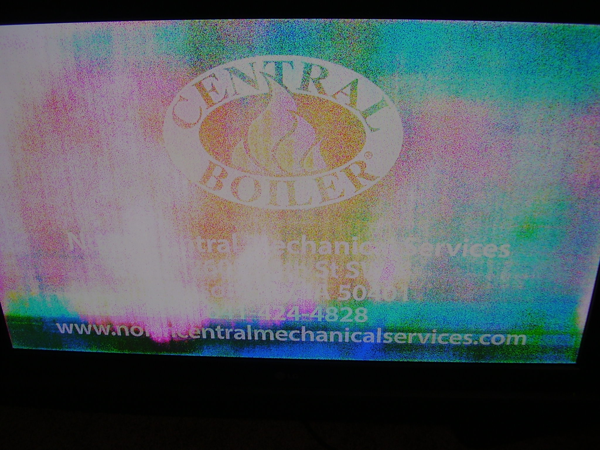

    Can you get some pictures of the image that would help alot cheers.

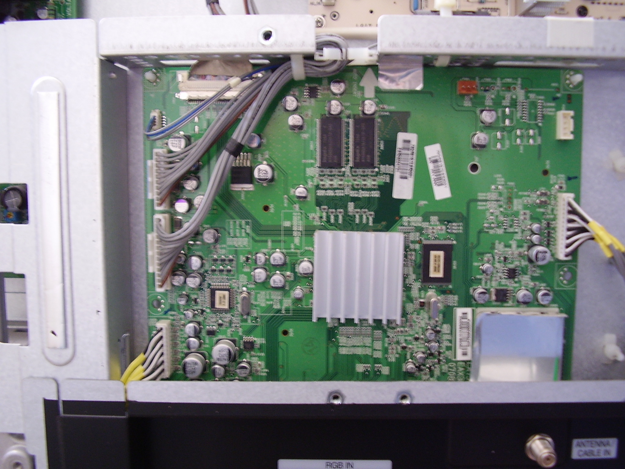

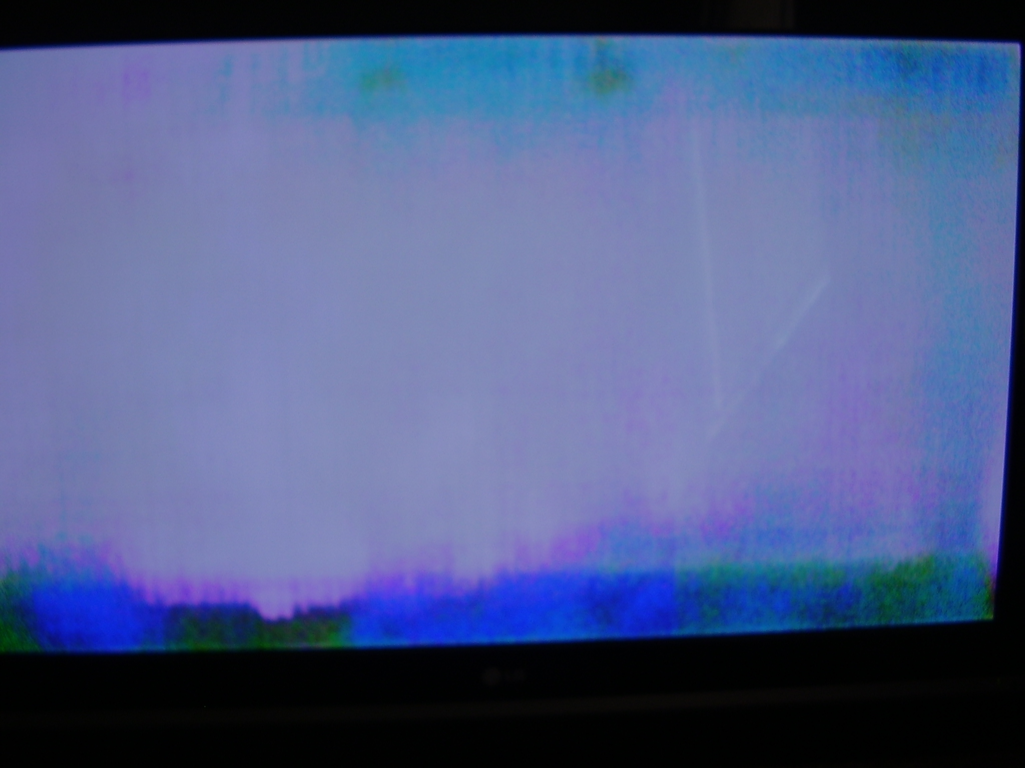

      Re: LG 42PC5D Plasma Distorted Pic
      pics
        Can u make out anything on the screen? Menu? Looks like y sustain failure
          Thanks for the response Freakaftr8. No I can not make out anything, no menu either.

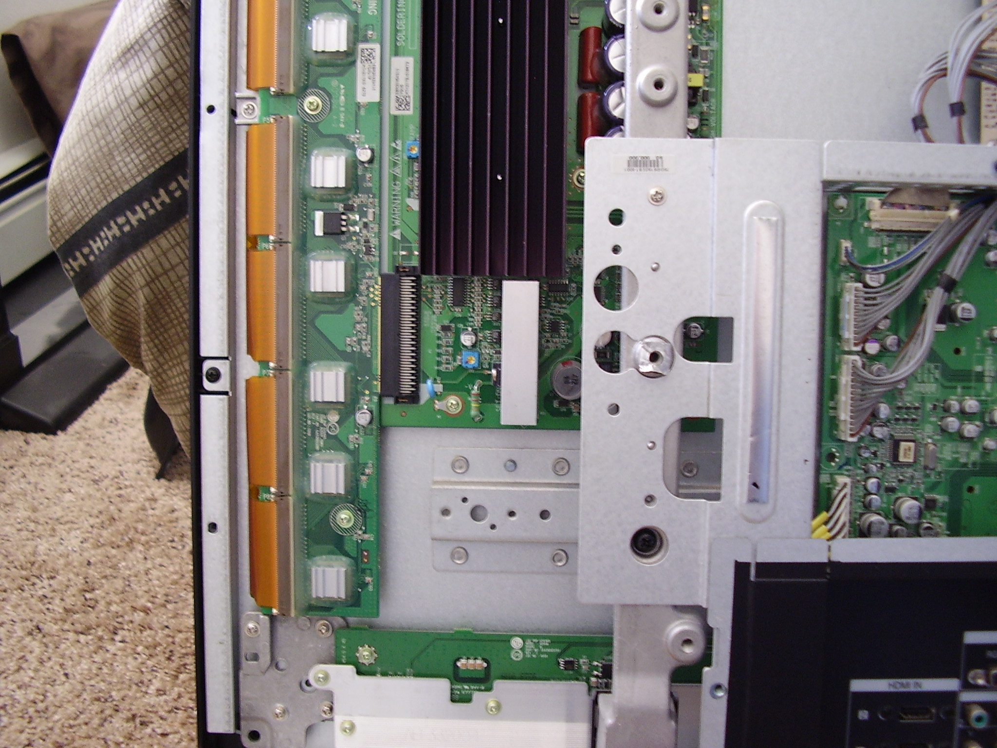

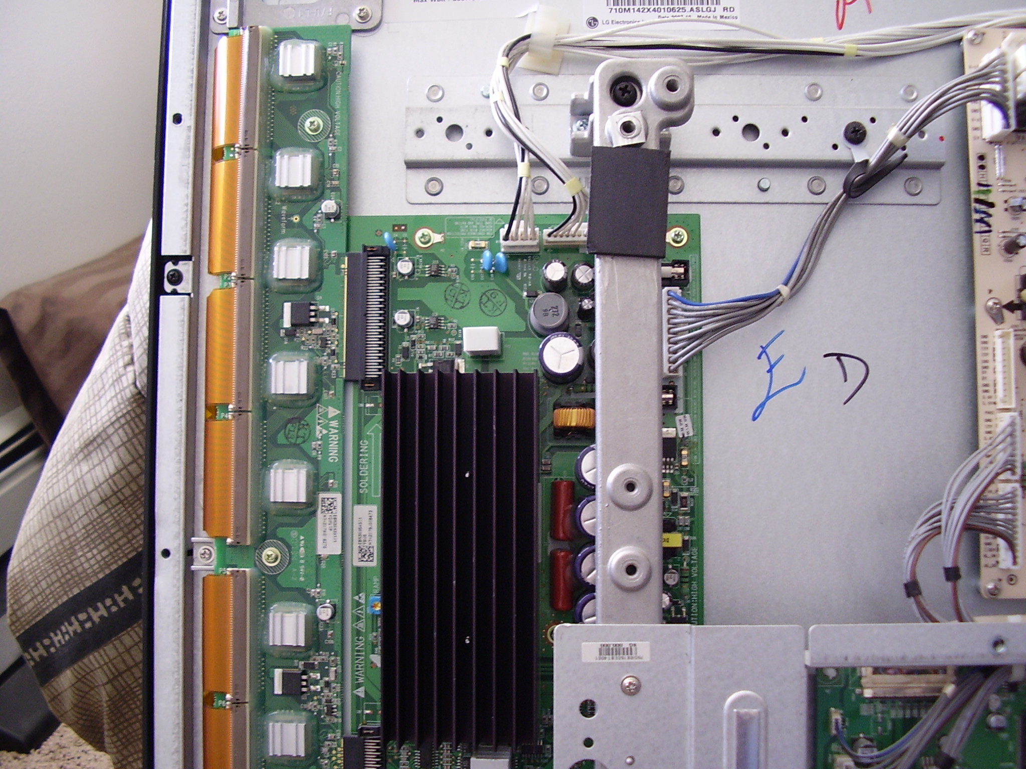

            Looks like Zsus to me, Ysus failure normally wouldn't give any image. Zsus would cause distortion. Do you have a DMM and know how to check for S/C ?

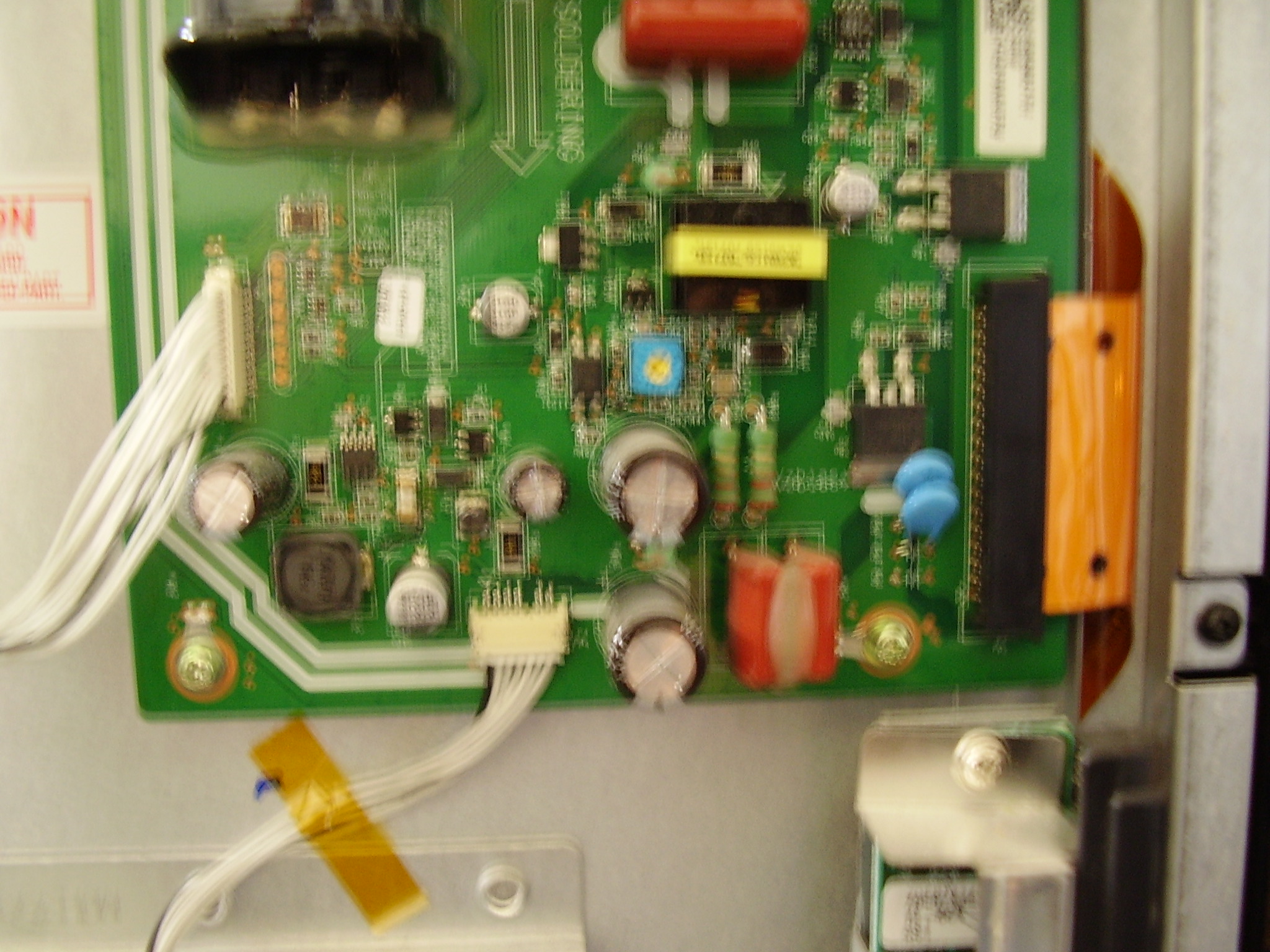

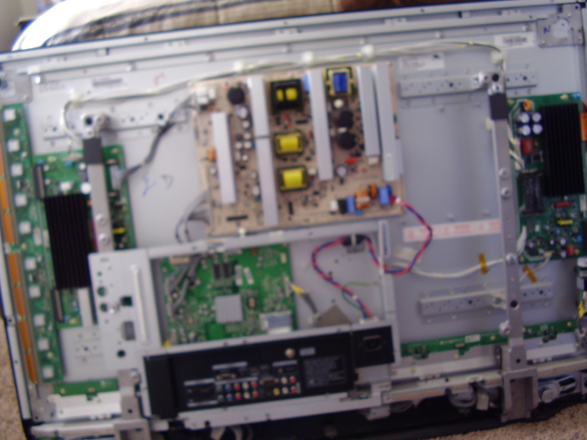

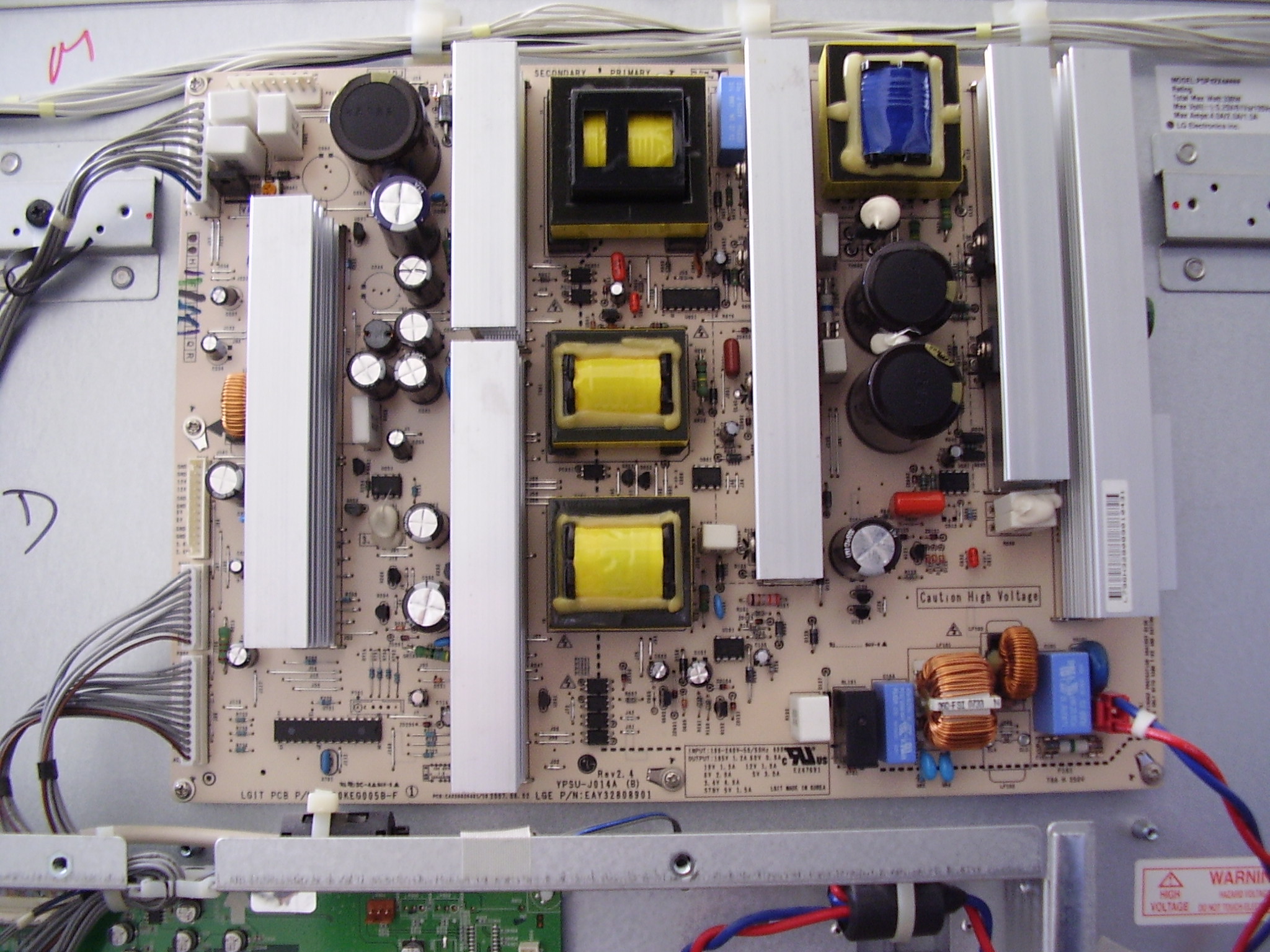

                  I tested all voltages at the connectors and all are good except on the bottom connector on the left side of the power supply, the first wire is marked 3.4v-ON and it is reading 4.7v , All others marked 3.4v are reading 3.38v. Any reason why this one would read high?
                  As far as checking for shorts I can take readings and post them or if you tell me what something should read and how to test it.

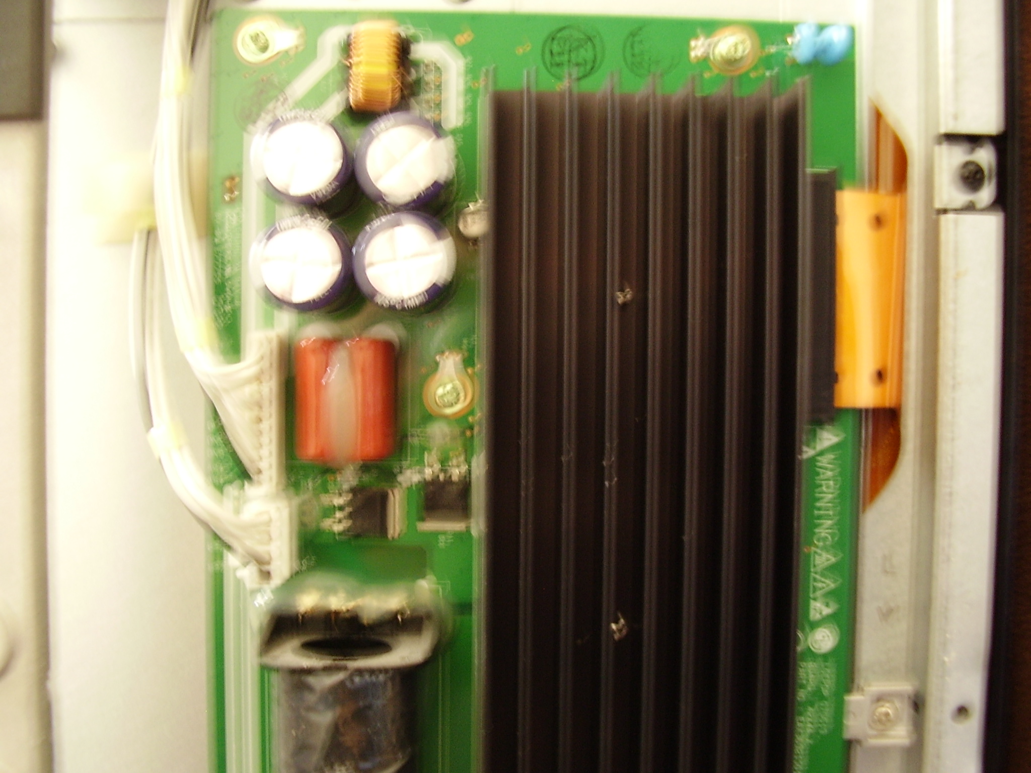

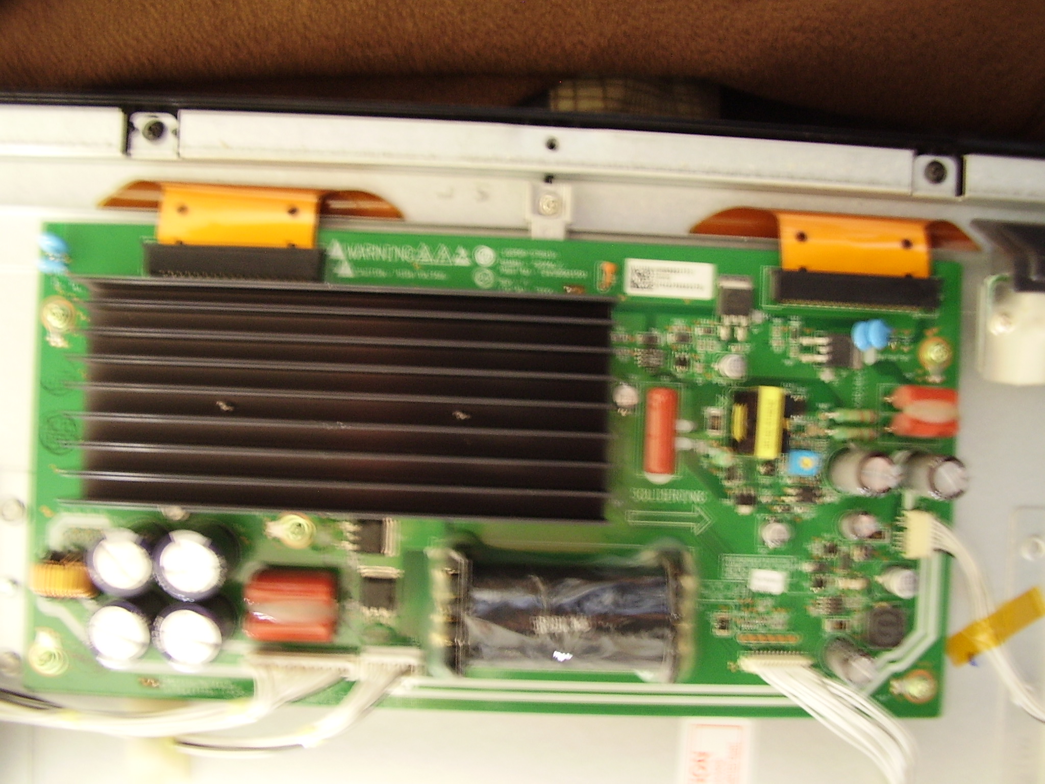

                    Finally got back to this plasma tv and replaced the zsus board and got some change but still distorted. Any idea's what I should look at next?
