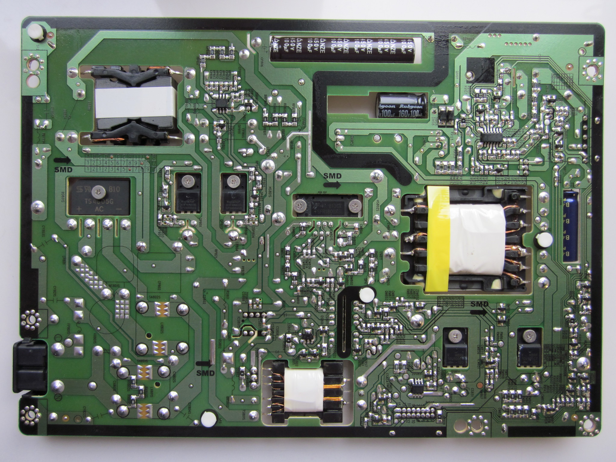

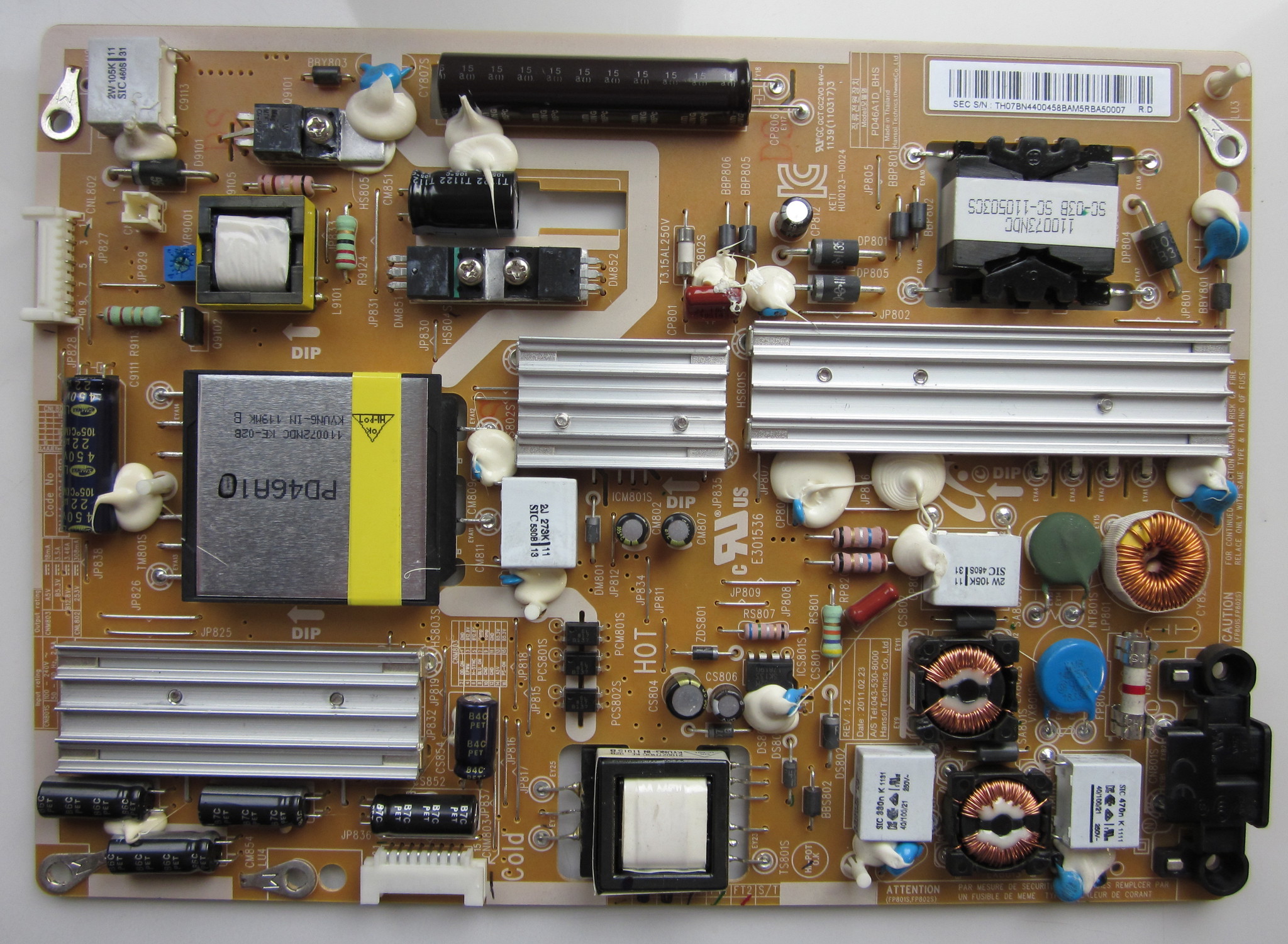

    Hi, so i have this TV which started to give buzzing noise. i`ve opened it up and located the noisy part straight away. it`s the capacitor 2W105K, SIC460S. Ordered new one, replaced and to my huge disappointment does exact same thing:/ also i`ve noticed by increasing or lowering the backlight level noise varies. Did a multimeter testing and could not find any faulty - shorted parts. Any tips where the problem lies?? Thanks in advance

                BTW, do you have good clear straight shot pictures of the bottom side of the board?
                Is it the CM802 (Cin) that is buzzing? It is connected to the output +/- of the bridge rectifier.
                I found these pix on the web for the BN44-00458B but not 100% sure it matched your board completely or not, please verify.
                Need to get the P/N of that PFC controller IC ICP201.
                Similar circuit used in the bn44-00428 except the use of the pi filter.
                I think the low noise Polypropylene should be used.

                            thanks for all your replies and suggestions lads, really appreciated! Want to confirm that the problem is solved now Thanks to the donor board i had... after checking every single part and not finding anything suspicious on an original board, i decided to swap part by part in most suspicious areas. Everything was giving same results until i came to ICP801S which is SPC7011F. After replacing this troublemaker all came back to normal. I guess in some way it was leaking, since even being faulty TV would still operate as normal, just giving this annoying buzzing noise. Once again thanks for replies guys!
