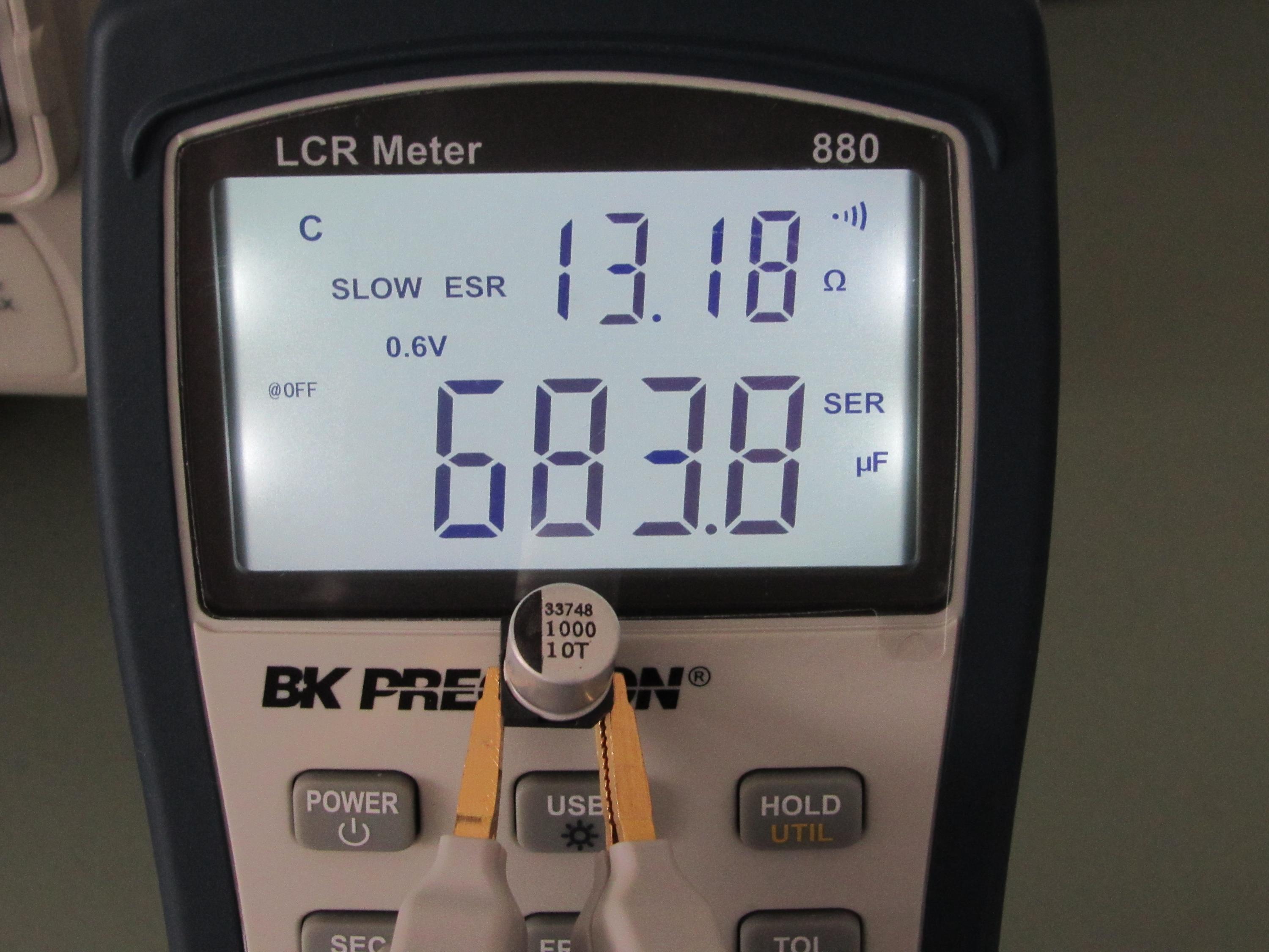

    Just to add my five peneth,The Samsung I encountered did not have any bulging caps as seen in many forums,all the caps were replaced as a mater of course, still relay clicking, I then checked the 10uf and 47uf on the power board they all showed very high ESR one was completely OC, so all caps replaced on power board, still clicking relay, I then noticed there were horizontal flashes between relay switching on and off, looking on the mother board for any clues I noticed a charing of two smd resistors R1131 R1132 68ohm, when replaced with temporary 33 ohm resistor the horizontal flashing stopped, only to be followed with a cloud of smoke from the resistor, the cause of the problem was C1102 a 1uf smd was intermittent S/C , when this was replaced everything returned to normal, good picture no relay tripping, the set was left running for about 4 hours no problem, so it was reassembled and left running, then it started tripping again every 20 seconds, I removed the can on the processor and checked all of the caps in the can, all were perfectly OK, I then started to check the ESR of the other caps on the main board and found several 100uf with no ESR at all these were replaced still the problem persisted I then checked the 4.7uf near the crystal in the middle of the panel this one had a ESR of 1.2k it was replaced and so far so good.

      I had many times C1110 and C1177 with high esr and low capacitance.

        yes, just replace them 2, thay are a bit of a prob to remove so be carefull, i have pulled the tabs before,
        i replaced with normal caps and layed them down so the shield would still fit
        Hi, old thread I know but very current for my TV fault. You say you replaced with normal caps, that is 2x 1000uf at 10v electrolytic ?
        Would 2x 1000uf 25v electrolytic be okay if so, or stick to 10v?
        Many thanks!

          Re: Still clicking after replacing eeprom Samsung LE40M87BDX
          Many thanks!
          25v volts will be fine
