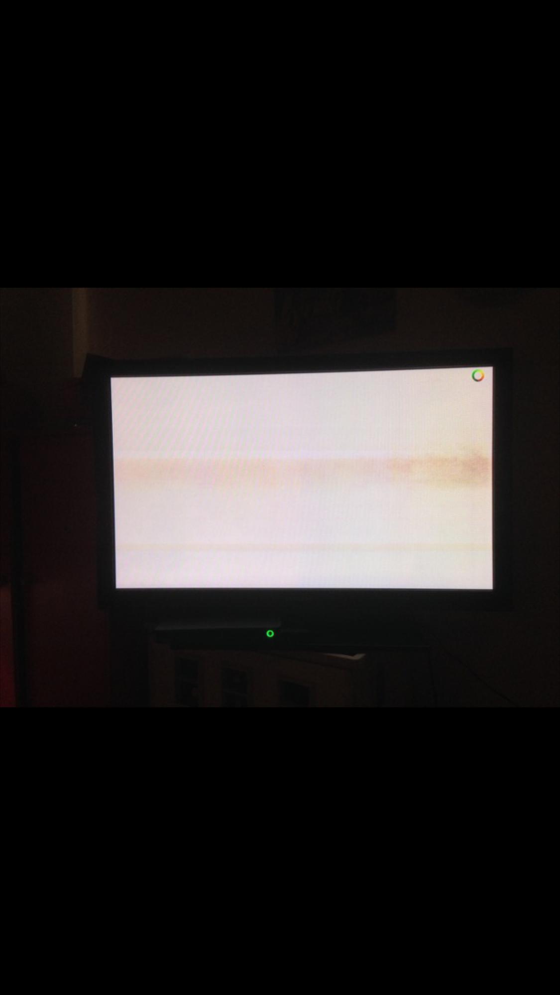

    Good evening
    recently trying to fix this model but im stuck with the following
    problem.I have a pink band going along the center of the screen
    but you can only see this on a white background,all voltages are good VS/VA/VE/VSCAN
    i cant find no shorts on the ysus and xsus but changed the xsus just in case but still the same
    Also found some brief information on google where the panel can be at fault but unsure if this is correct
    Any help appreciated

    You can try increasing VS voltage on the power supply. Watch while this screen is on. You may be able to tune that out.
    What happens if the panel ages and to compensate for that effect you increase the vs output voltage. Increase this poteometer slightly until the pink band disappears and then after that just give it ever so slight increase again to prevent it from coming back.
    I've done this on a few TVs now.
    As a reminder be super careful while you're playing around in the power supply with the TV on there is lethal voltage there. But I'm sure you already knew that lol
    For some reason some panels age like this and some dont on the C Series. The most famous for doing this is a C 8000 58 inch

        Update the control board firmware, this can be done using a normal TV firmware update over USB. Samsung has released updated firmware which *may* fix this issue.

          Already tried this tom but no different but ill try adjusting the VS
          thanks

              The tv was on 1023.1 but i have already upgraded to T-TDT5DEUC-1024.1 but didnt realise you needed to do it in hotel mode but it wont update now in hotel mode it just say no update needed etc

                I'm not sure if this pertains to your exact TV or not but the c8000 58 inch required a special firmware to have the TV put in hotel mode and do a USB update that way. The regular firmware update for the TV done by a USB stick in the main menu did not change the algorithm control on the logic board to adapt to panel age. However on this particular model the only way to get around it was a special way of putting the TV into hotel mode and do the update that way. Other than that a Samsung authorized factory remote control was required.

                      right update :
                      went in samsung service menu turned on hotel mode like freakaftr8 suggested then inserted usb and used the clone usb option in the menu
                      increased VS to 212 volts Vscan to -197 Volts Ve is reading 100 Volts and at the moment its looking good so fingers crossed

                              Good work! On mine I had to increase the VS and increase VE by two or three volts for some reason on the ysus and decrease vscan by about 10 volts to achieve perfect picture because increased vs caused a little bit of maldischarge.
                              these newer Samsung plasmas came out of the factory with just the bare minimum settings on voltages to try to keep down the power consumption to compete with the ever-growing led Industries. Of course the outcome eventually was plasmas were being phased out but in order to keep up with UL standards they had to be able to achieve a consumption per hour basis. This was only been able to be done by keeping these voltages at the bare minimum of course with panel wear you're going to see those voltages need to be increased over time to keep up with what was not a problem in the past where manufacturers game ample amount of room for panel wear with their adjustments

                                  Went ahead and pulled the back of the TV and adjusted Vs to 213. After that and recalibrating my screen settings the banding is gone.
                                  I don't understand why Samsung doesn't release the updated logic files. You'd think if they had a fix that didn't involve customers pulling a back panel and adjusting voltages, they'd want the customer using it.

                                    I think the logic files just lower the response time or something to the tune to deal with the lack of voltage. Evidently increasing voltage is the fix anyway and not mocking the issue.
