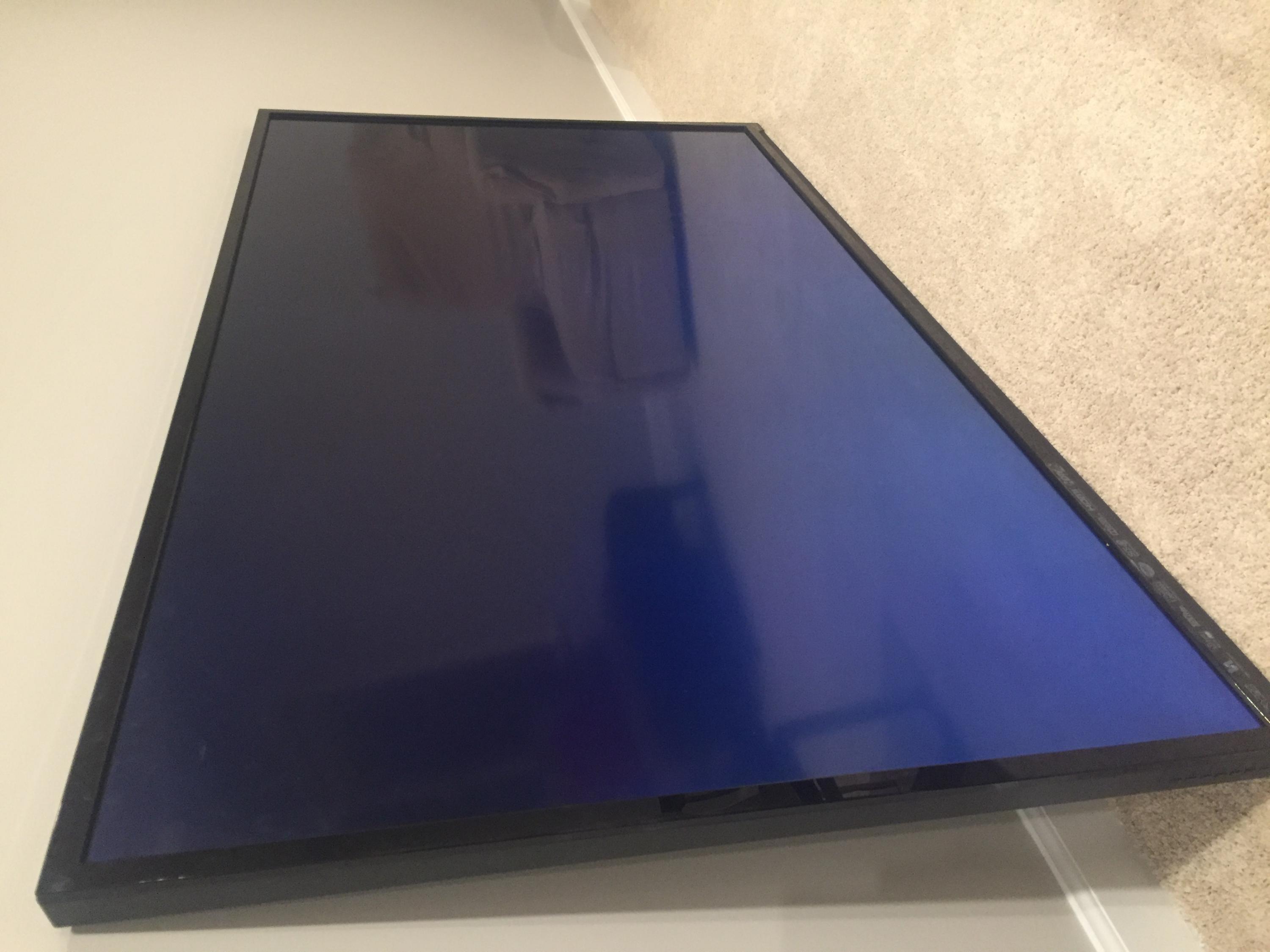

          First off, great post. Lots to read through, but very informative. Acquired a 70" vizio with no picture. Followed the posts, right side display drivers seemed to be the problem. Detached right side drivers, still no picture. I may have left the TV on for too long with the new tcon in while troubleshooting. I'm getting a short on the "bottom right" pin of the transistor. Here's the question: Replace the TCON again? or just the transistor?
          Or: Am I missing something that would warrant a retest?
          Background:
          70" vizio for free (Pic 1)
          previous owner replaced T-Con with no results.
          I powered it on when got it home, confirmed no picture (Pic 2)(left it on for more than 4 secs, was before I happened upon this site and wanted to see if I had sound)
          Disconnected right driver ribbon
          powered on
          right side was dim/distorted etc, left side seemed good.(pic 3&4)
          reconnected right side, disconnected left side
          powered on, blank (no pic)
          reconnected both, powered on, blank (dont ask why i thought i magically fixed it)
          removed right side driver tabs
          powered on, blank
          tested T-con Transistor, appears short on bottom right pin(if pin on side by itself is up)
