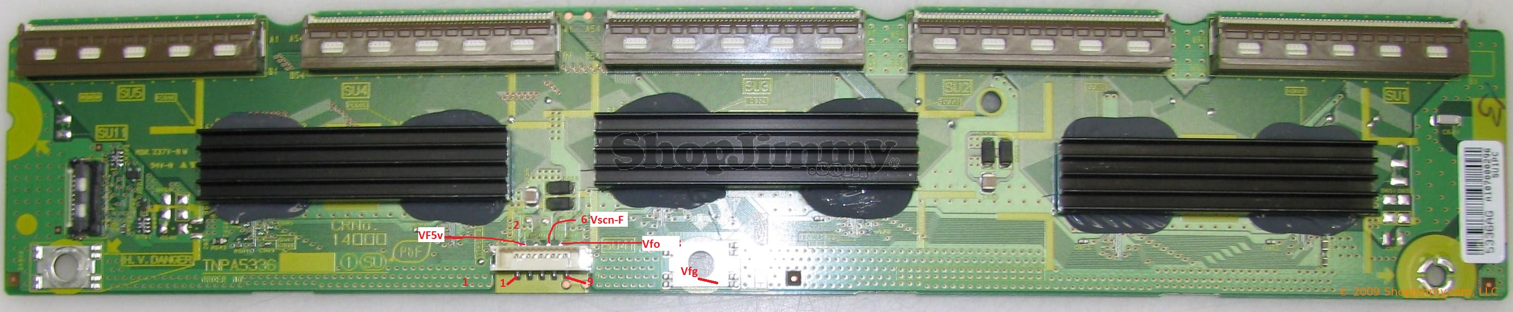

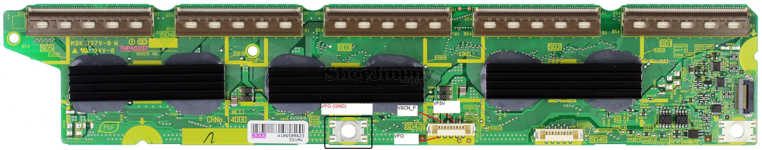

              Re: Panasonic Vierra 50ST30 SOS 7 Blinks
              there is a procedure in that guide but problem following it is it won't cover all scenarios.
              basically it says check TPSC1 - Vfg for short, if so disconnect SU, stil short, disconnect Sd, still short bad SC but if the Sc and either of those buffers are short you won't know.
              So, I will give you the pins I check at the sd/su. this is with them disconnected from the SC and Vfg is the earth pads on the buffers the bolts attach to sc.
              Here's an image I marked which I've posted previously for the points
              Whenever a buffer is shot I find Vfo is shorted but measure the resistance which will be in Megohms, measure the others as well and post results
