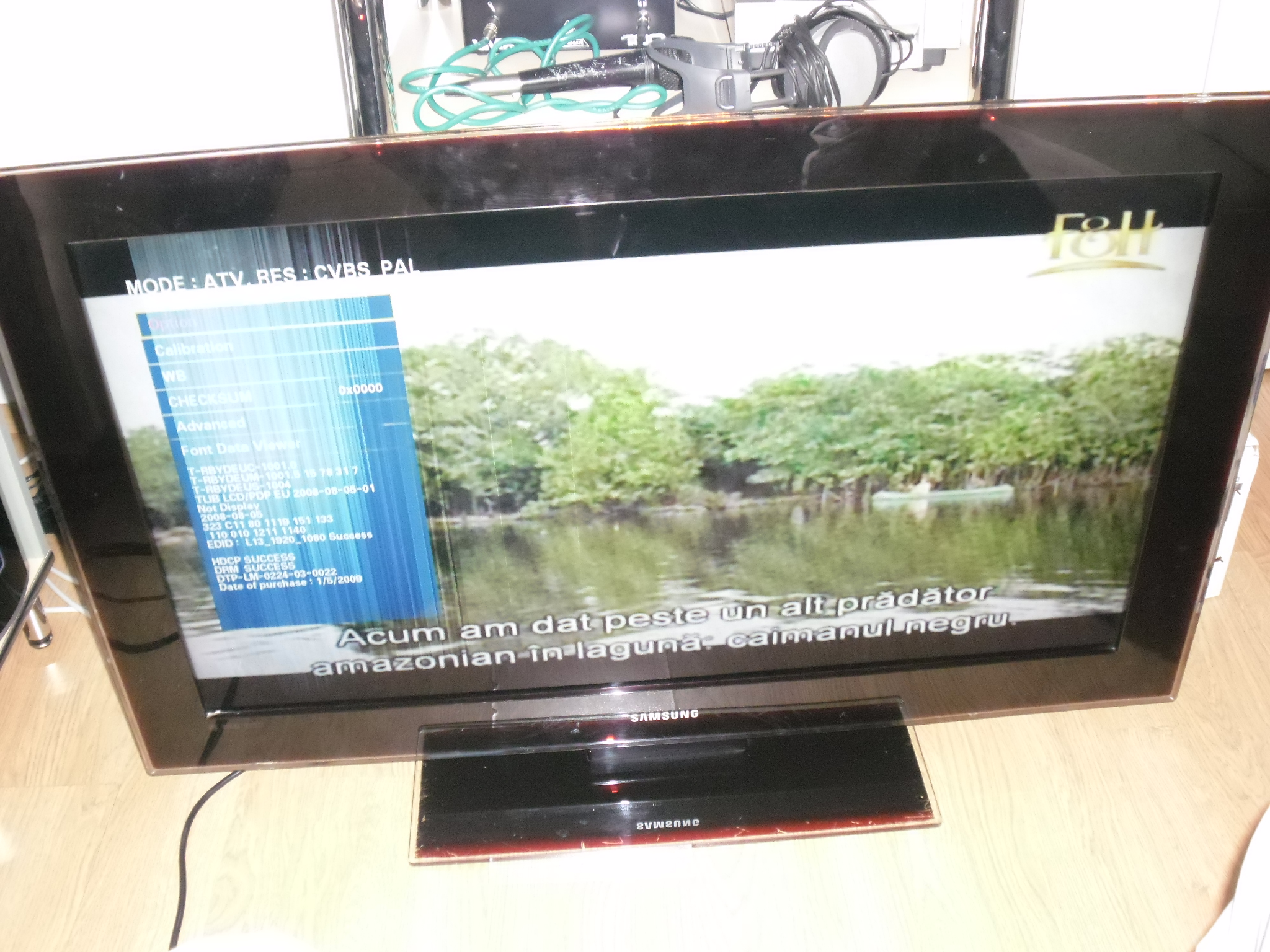

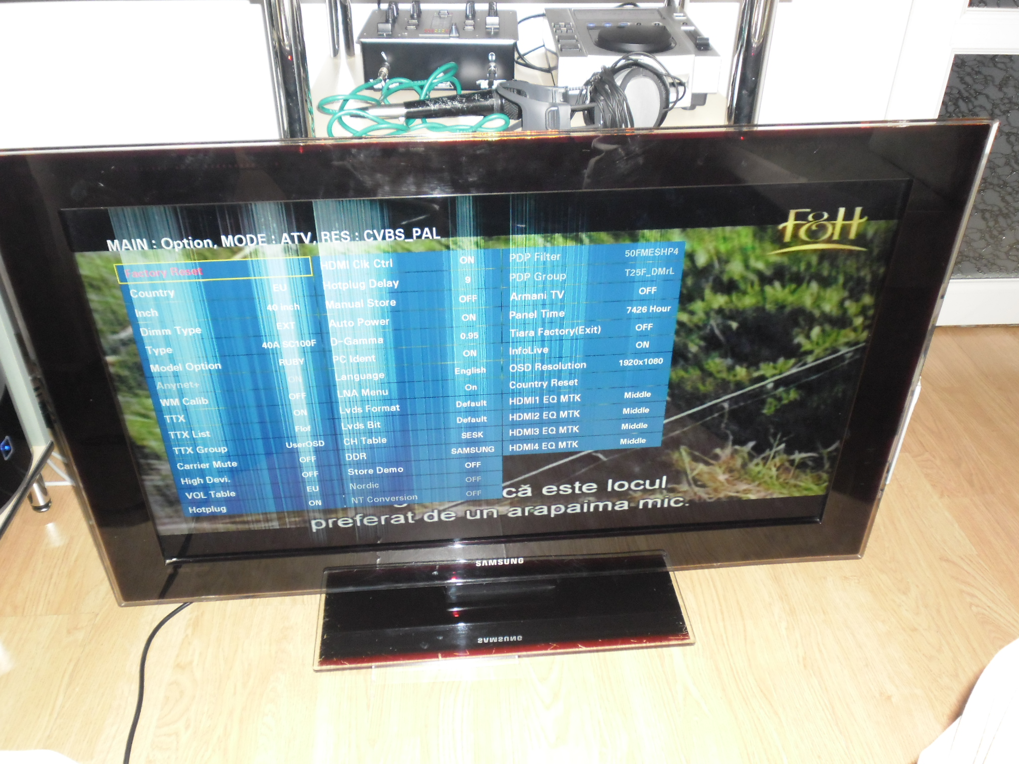

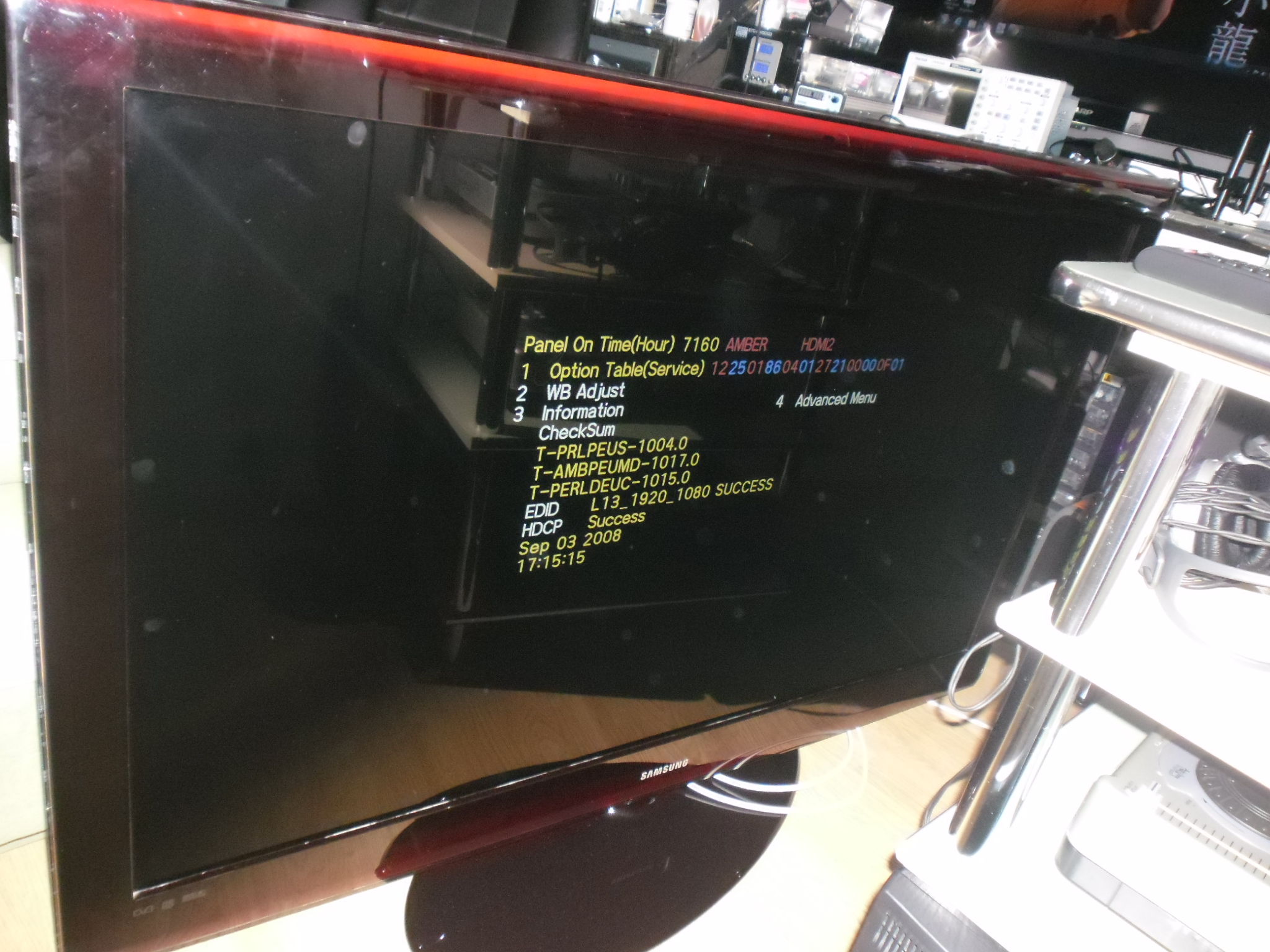

                          I found some pictures of the service menu, enter again blind and fix it.

                            Re: Samsung TV wrong settings in service menu
                            No luck so far. I cant make it to Service Menu.
