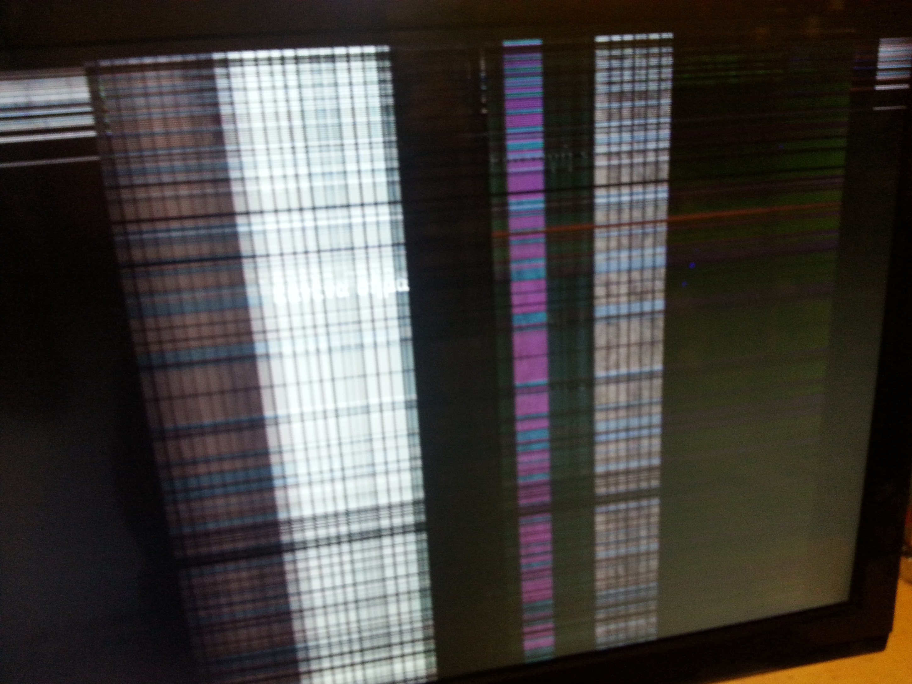

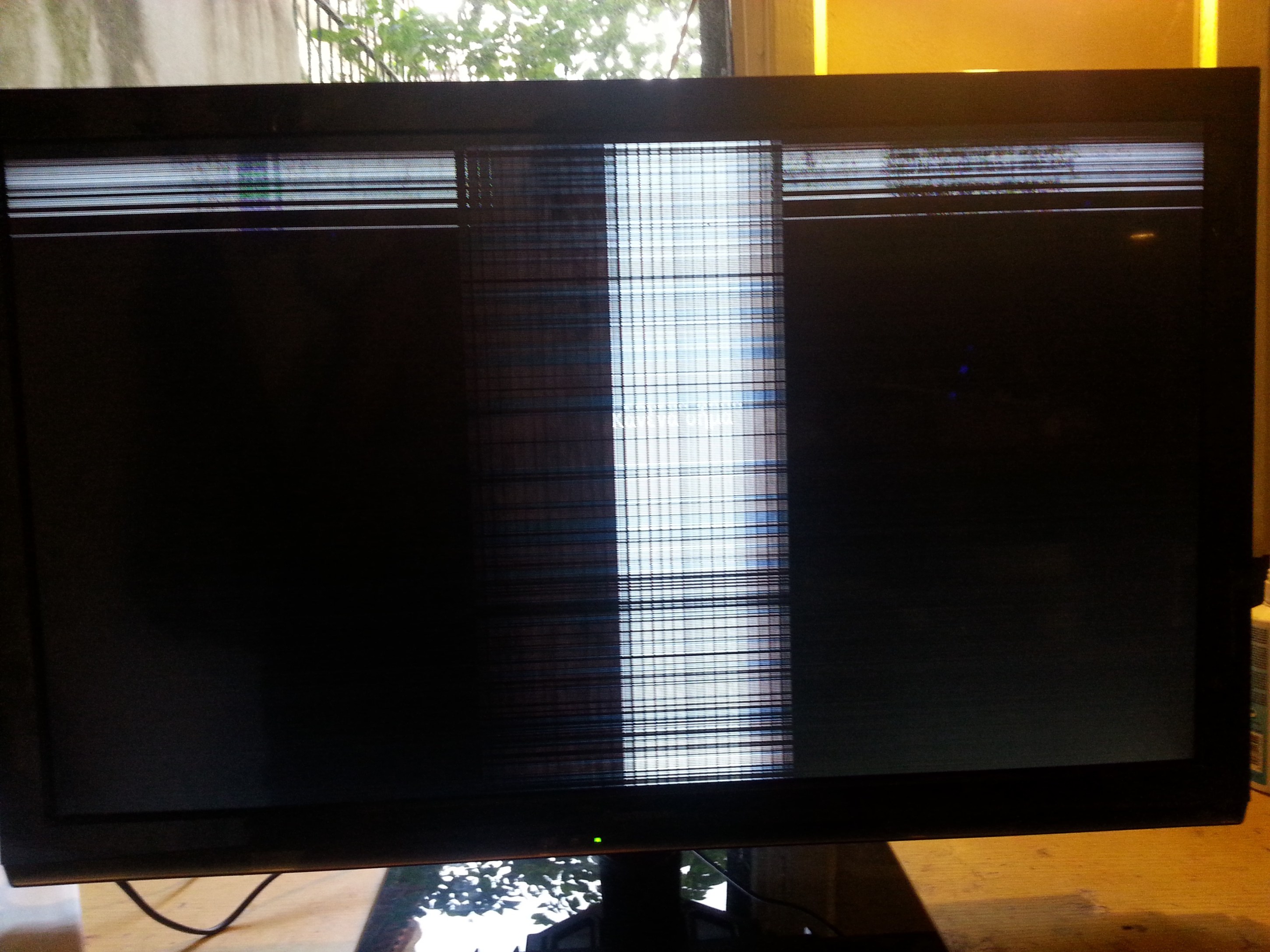

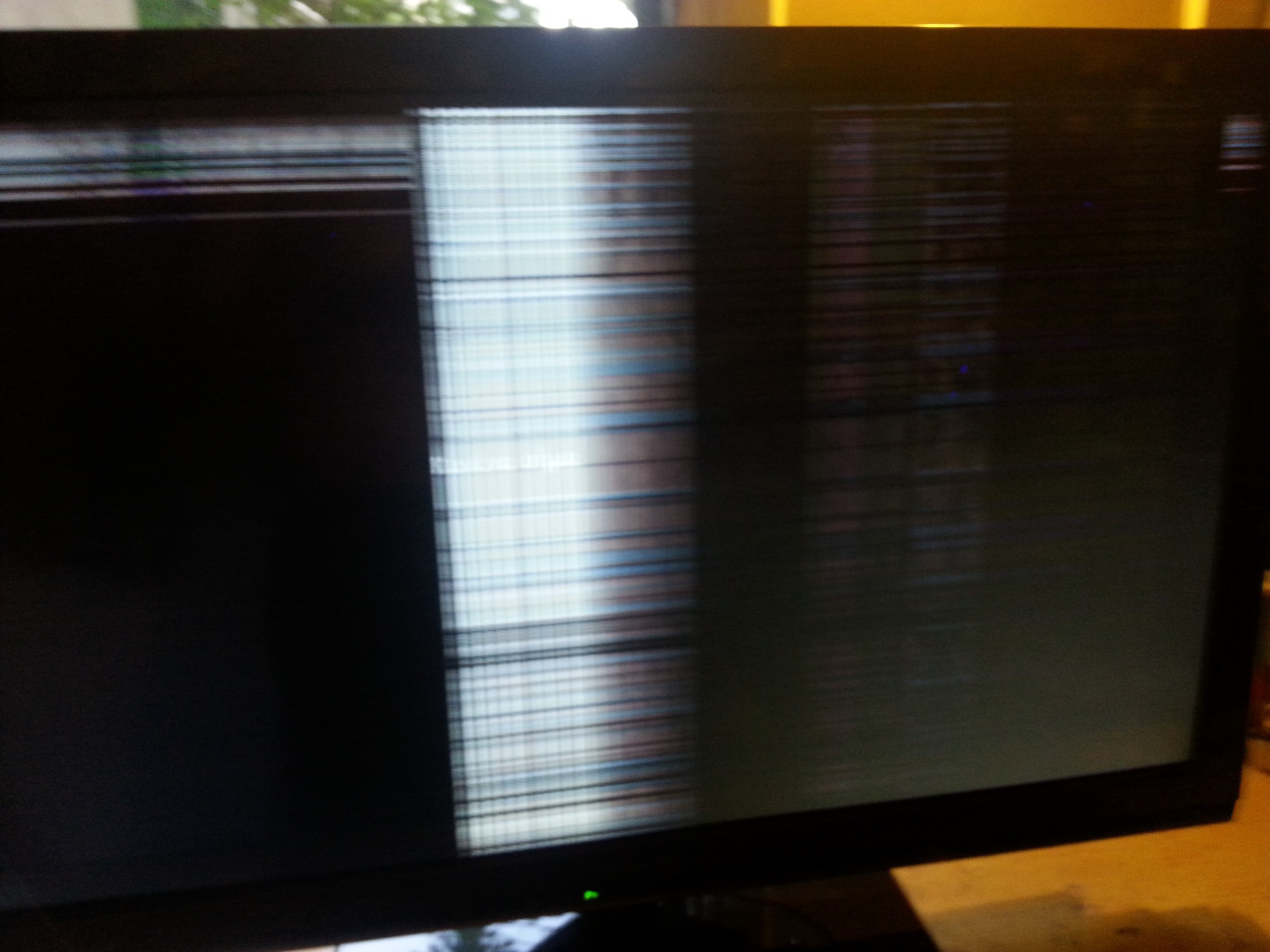

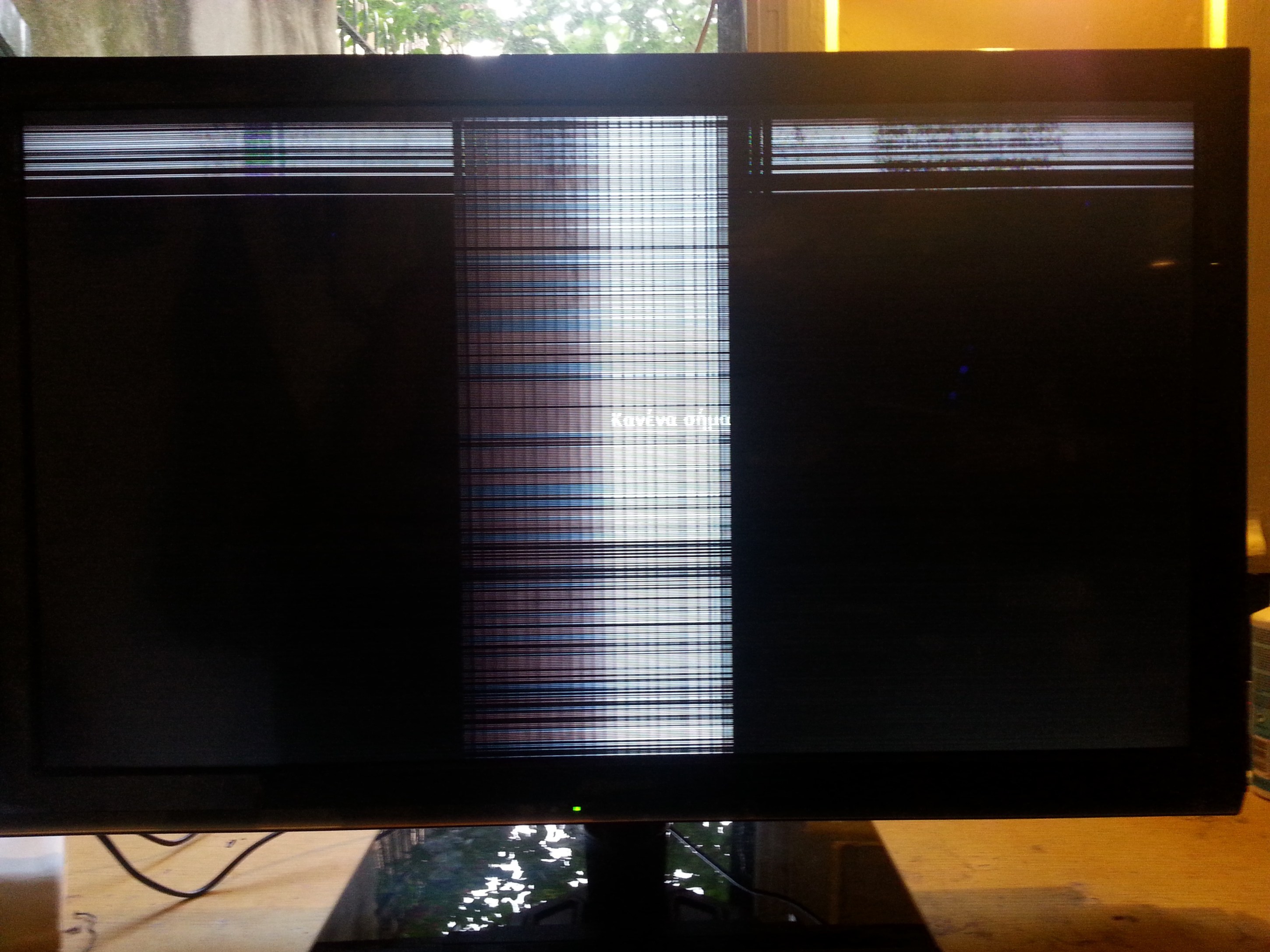

    Hello Everyone

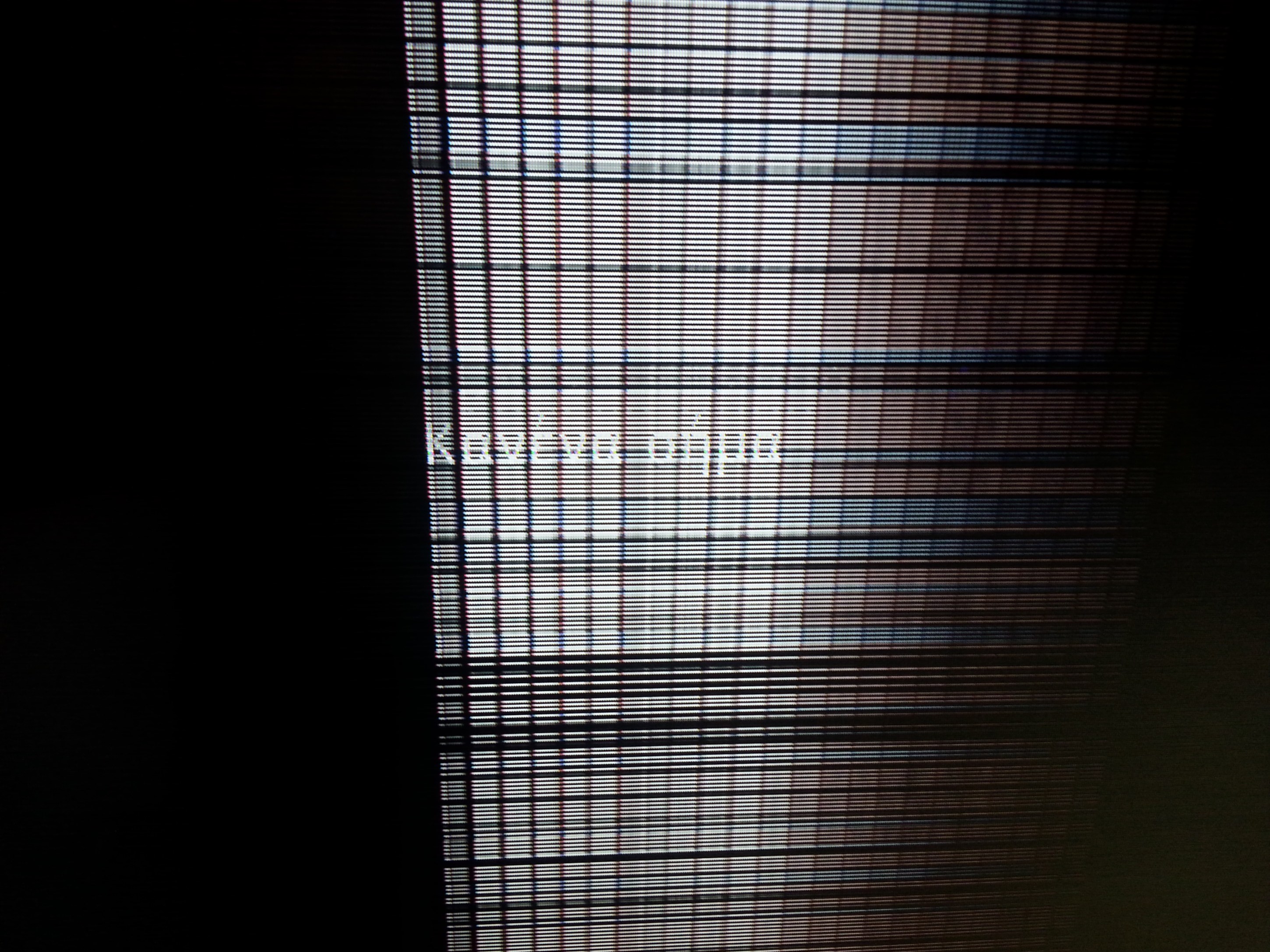

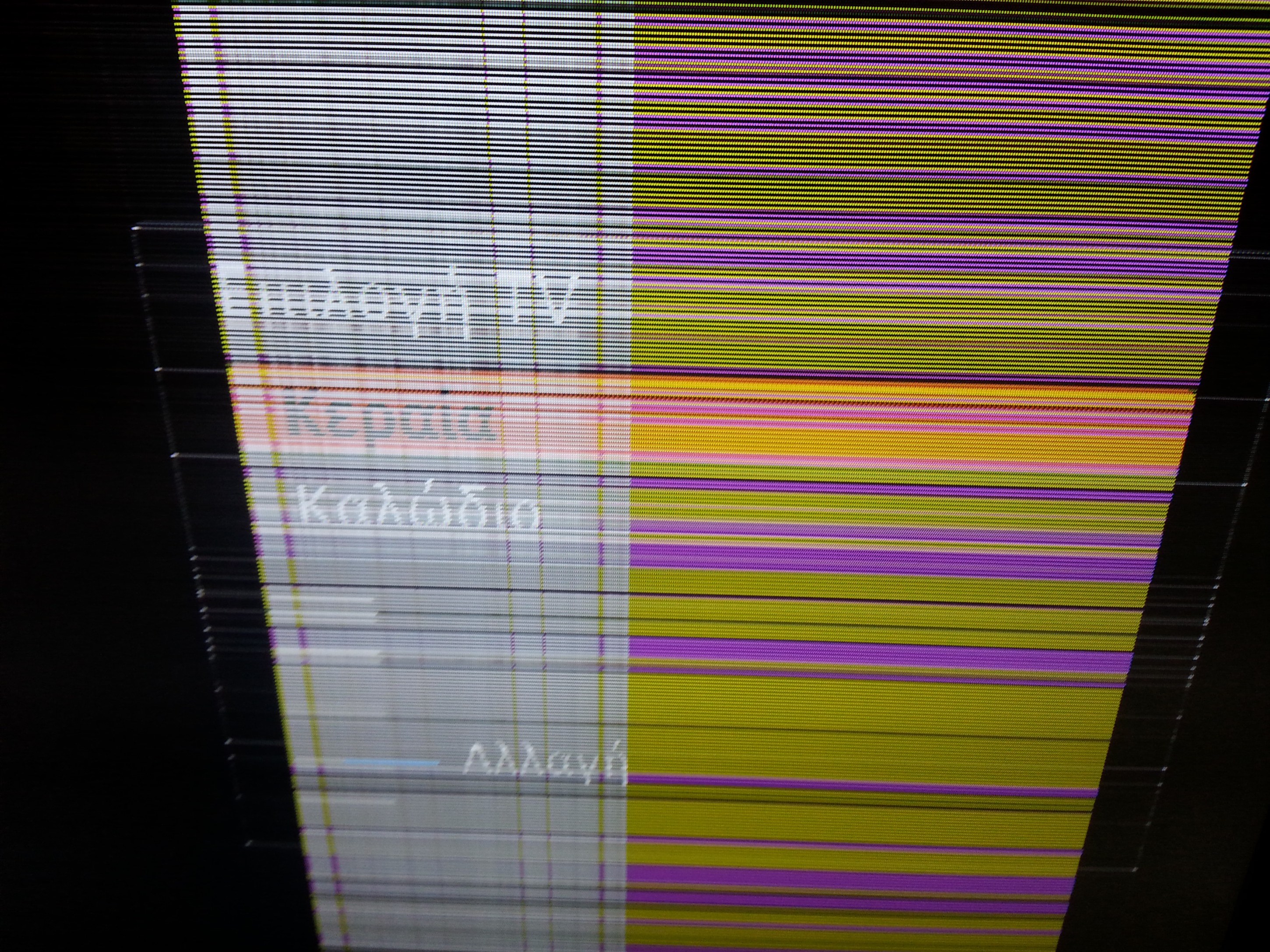

    As titled, picture stays distorted on screen, lines fill entire area when an image present and stays there for a while.
    As you can see, where "no signal" message appears picture is "ghosting"..

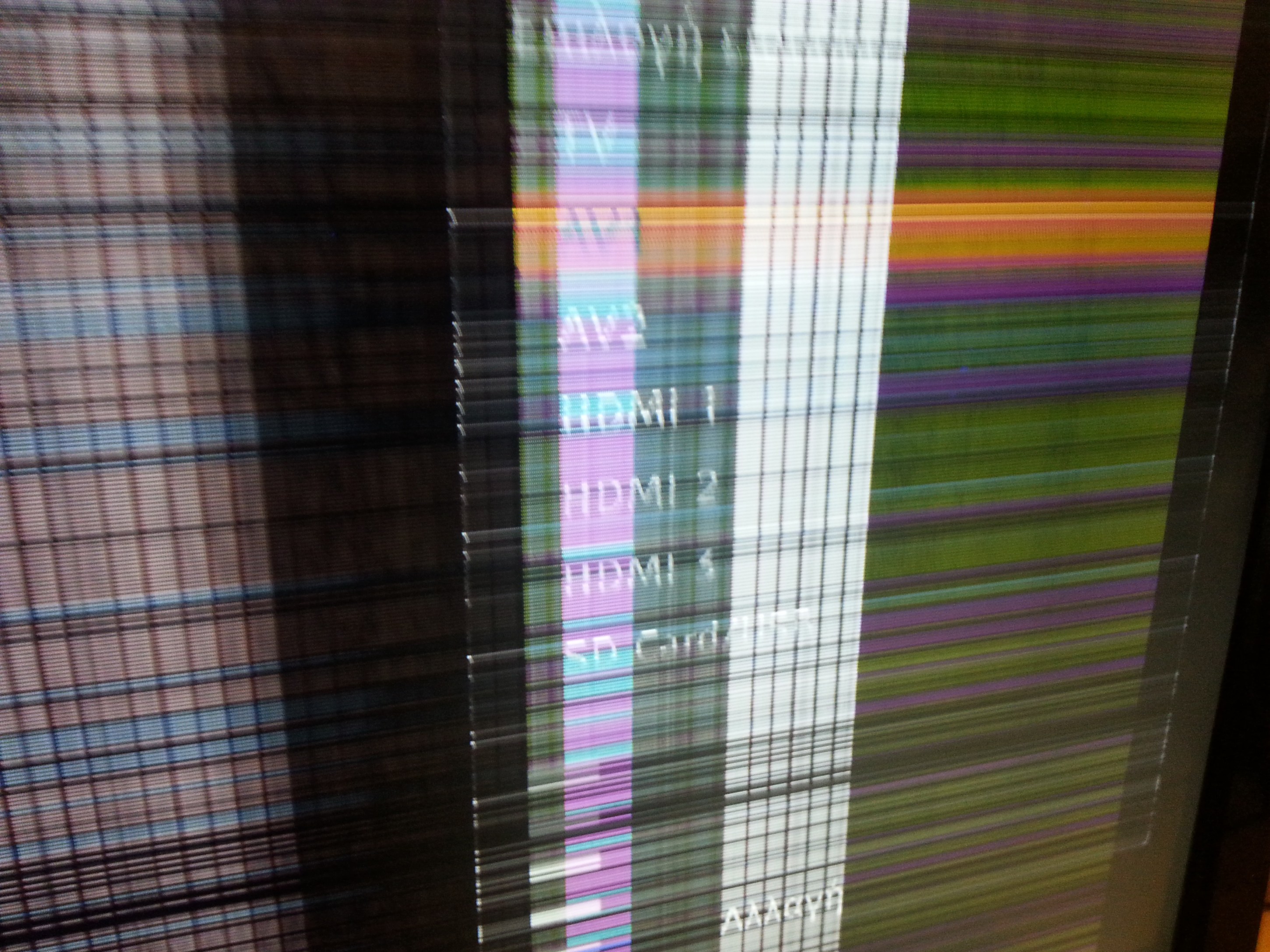

    Same when "source selection" tab is shown on screen.
    Any ideas??

    Re: Panasonic TX-L32X5E picture "ghost/distortion" problem

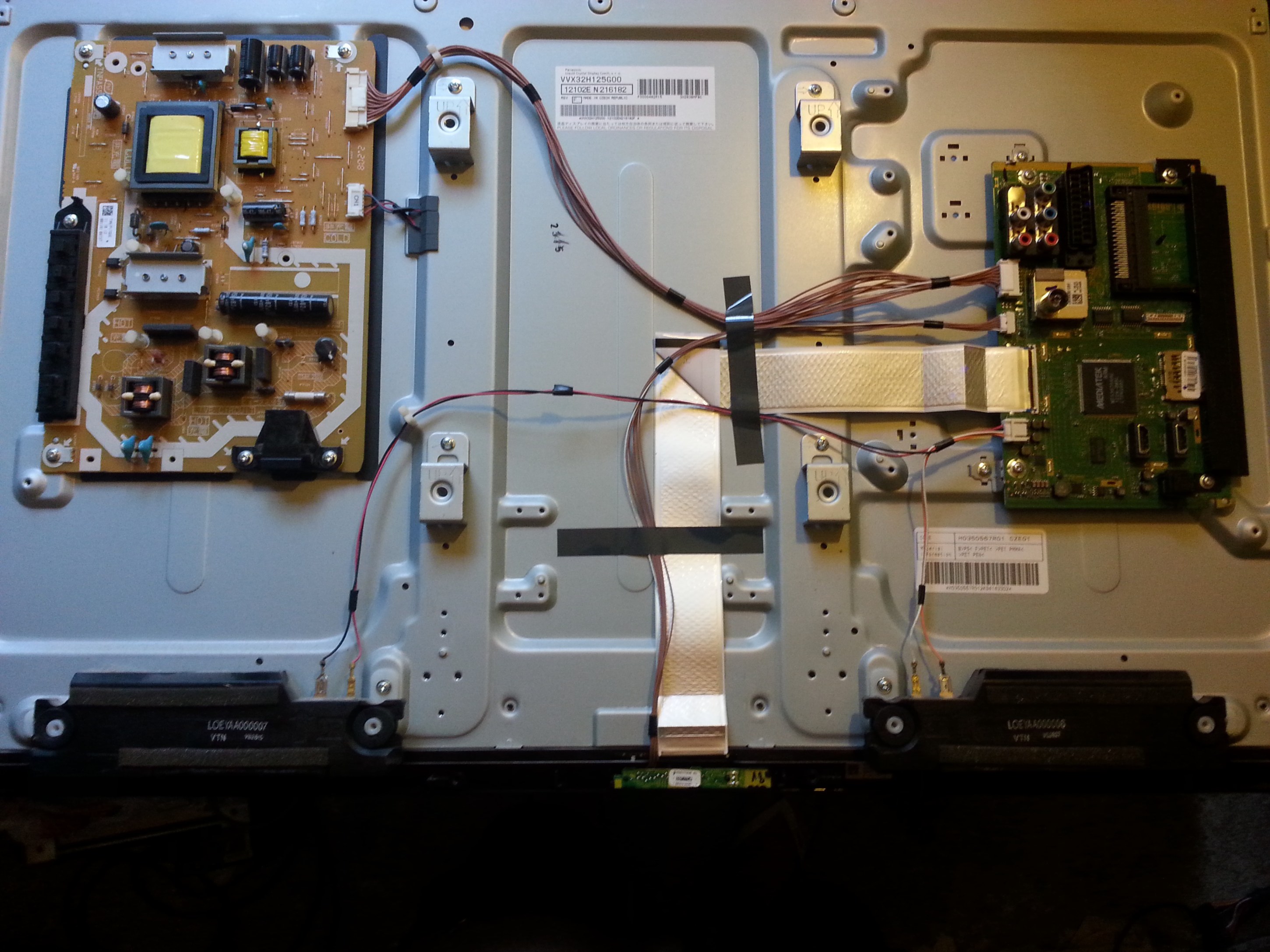

    Are you getting audio?....I would suspect the LVDS Cable needs cleaning and re-seating or the T-Con Board failure.

      Hello Andrew F. Ali

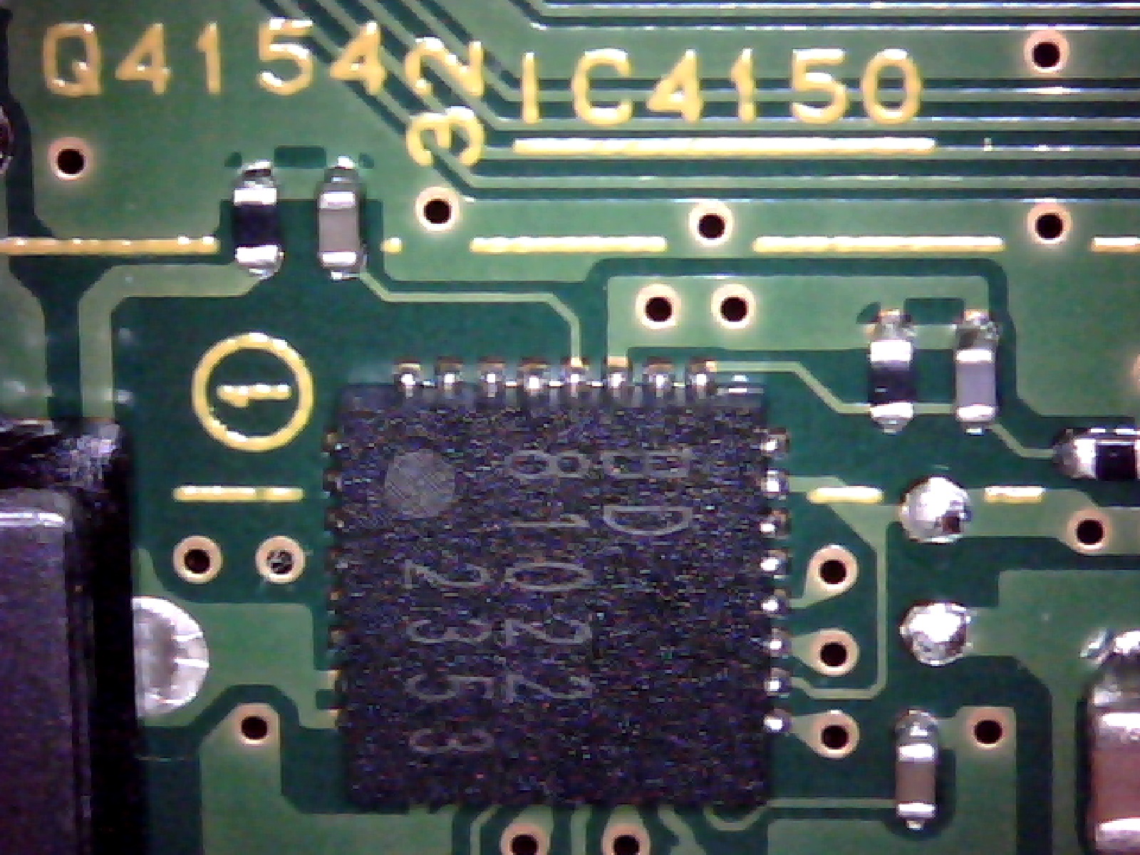

      Audio working, i have already check LVDS cable, TCON at the bottom side of metal frame after visual inspection seems ok.

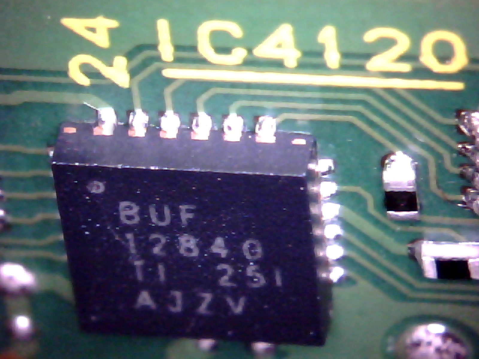

      Also i forgot to upload schematic..i suspect IC4120, page 36 at the middle.

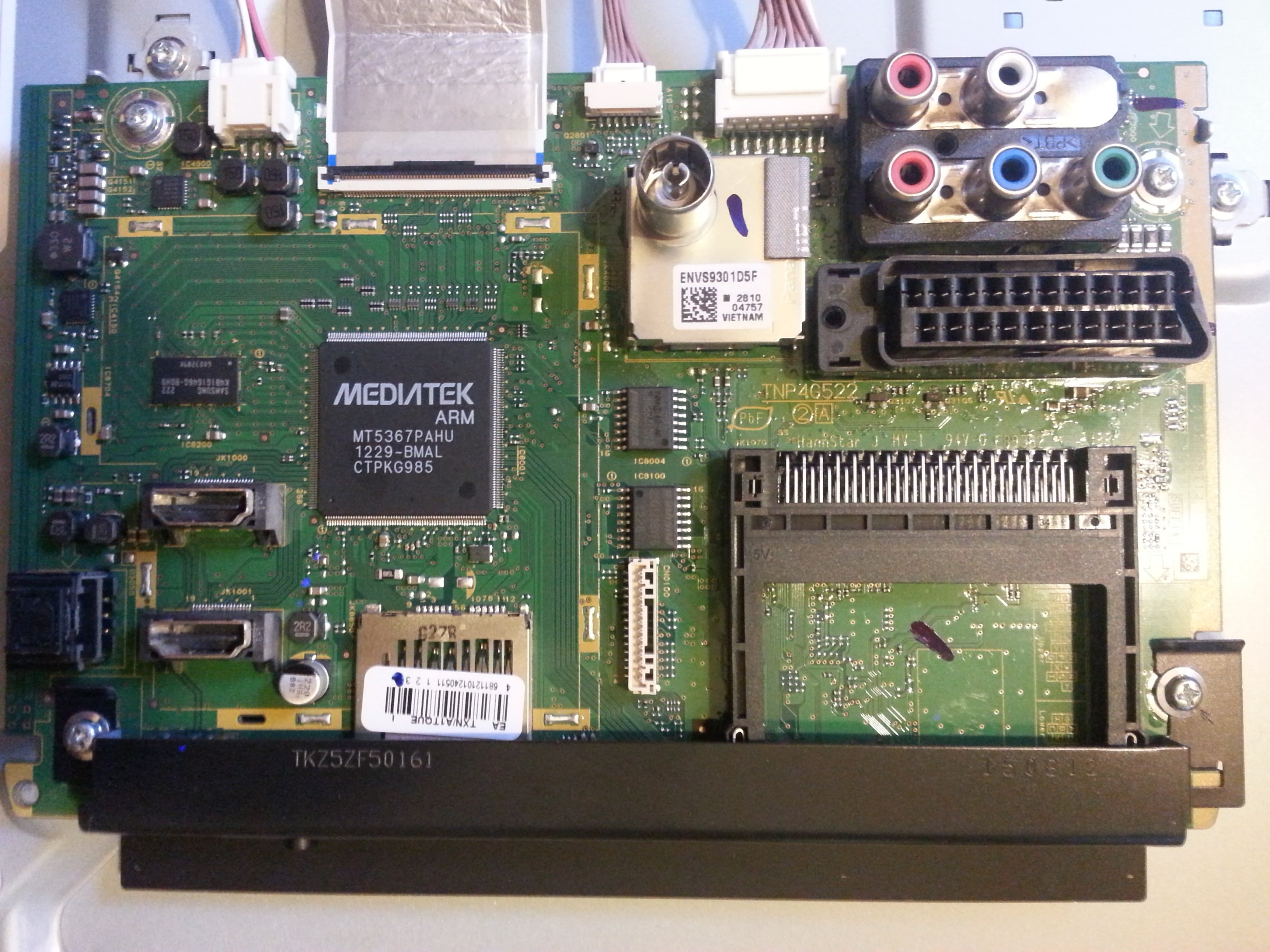

          Sorry, my mistake here for not explain it right, T-Con isn't exist as separate board...is built in on MAIN Board.
          At the bottom side of metal frame is the LVDS cable connection to the Panel..
          IC4150 and IC4120(T-Con DAC and T-Con DCDC IC's) are on the MAIN BOARD
          Also found IC4120 datasheet:
          Code:
          http://www.ti.com/lit/ds/symlink/buf12840.pdf
