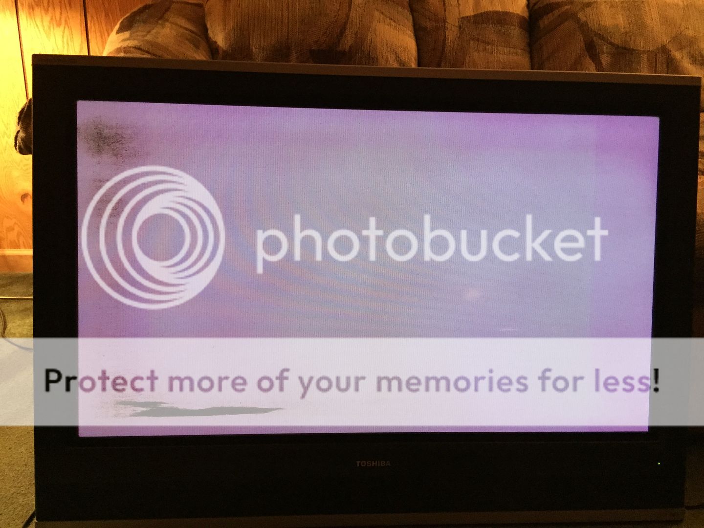

    Going in for my second TV repair attempt, found this set on the side of the road. I'll let the picture and video speak for themselves, I've done a bit of research and it seems that the y sus and z sus boards are likely the culprits.
    Haven't torn into the set but I'm assuming the IPMs are bad on one or both boards, I was just curious if anyone could tell which board was bad from the symptoms in the picture/video, and also if it could be something more serious.
    It should be noted that any patchy/black part of the screen does fill in with appropriate colors depending on what is shown. Also, the RCA inputs have picture/sound and no HDMI ports are recognized.
    http://vid1138.photobucket.com/album...ps3m4zkrlc.mp4
    As always any input/advice is greatly appreciated!

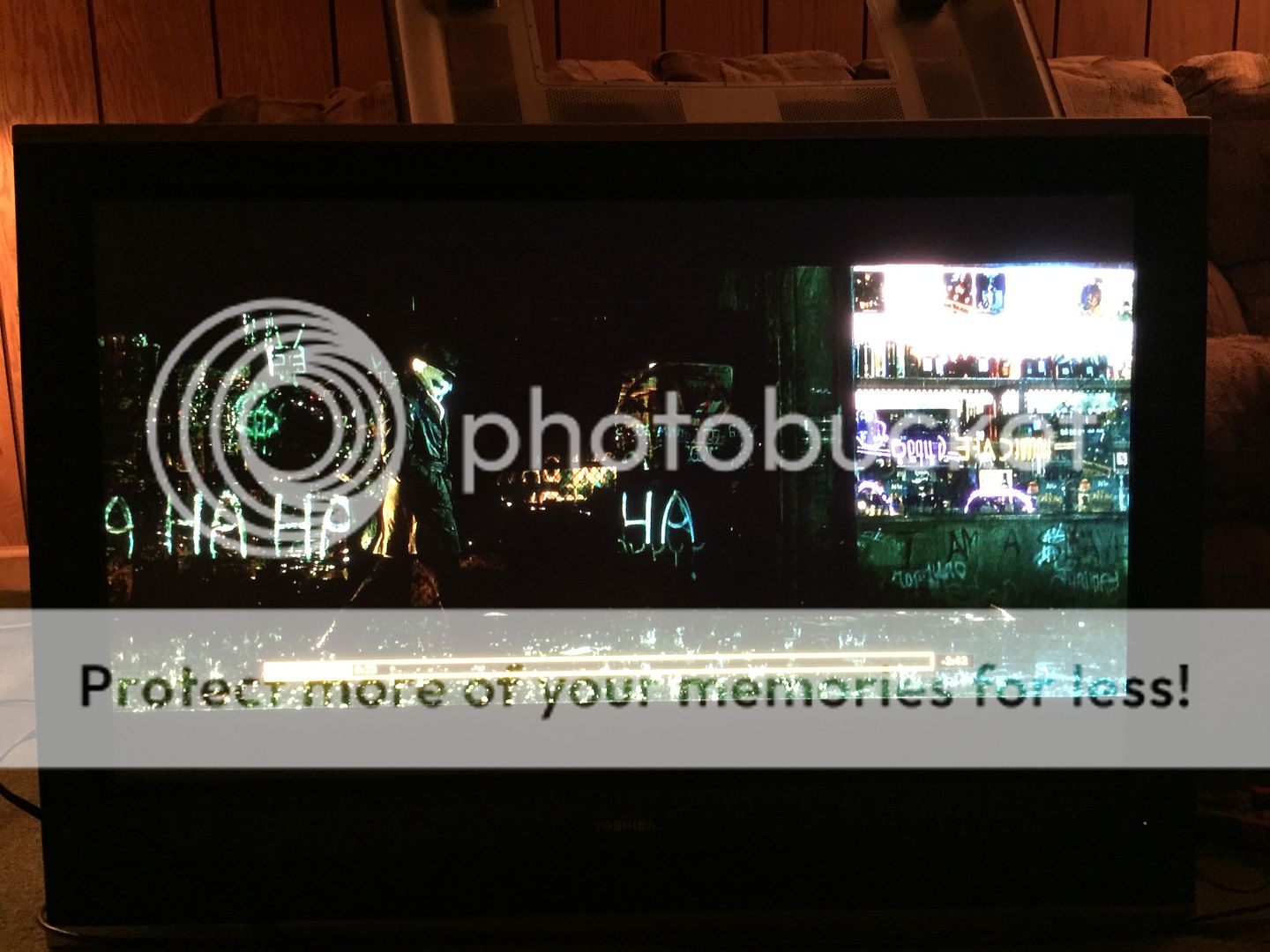

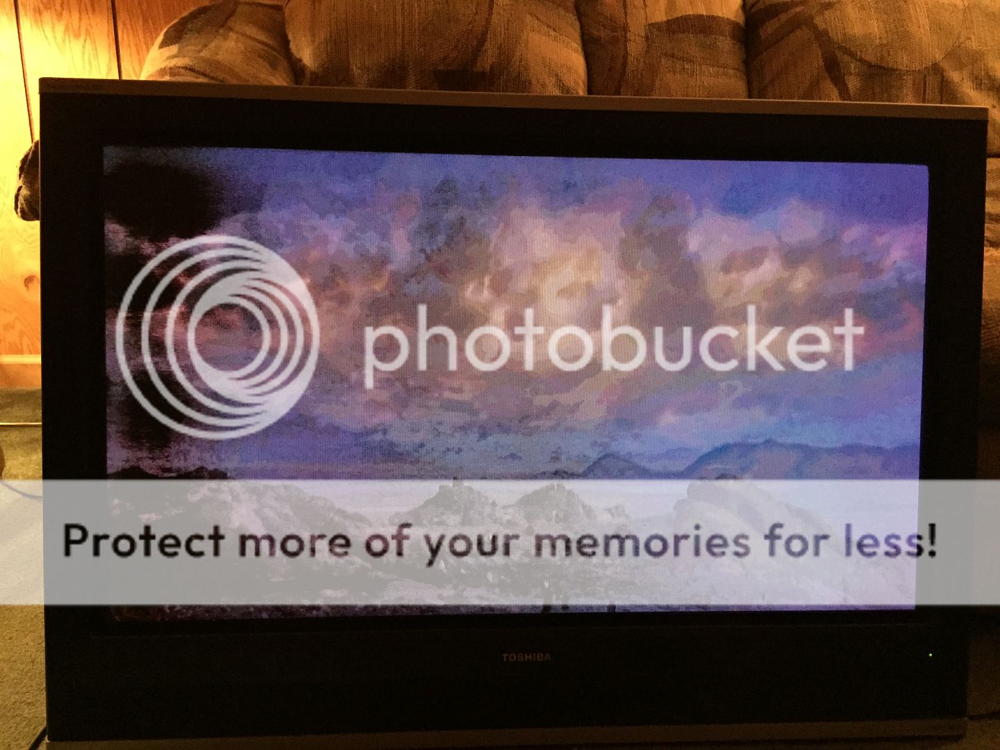

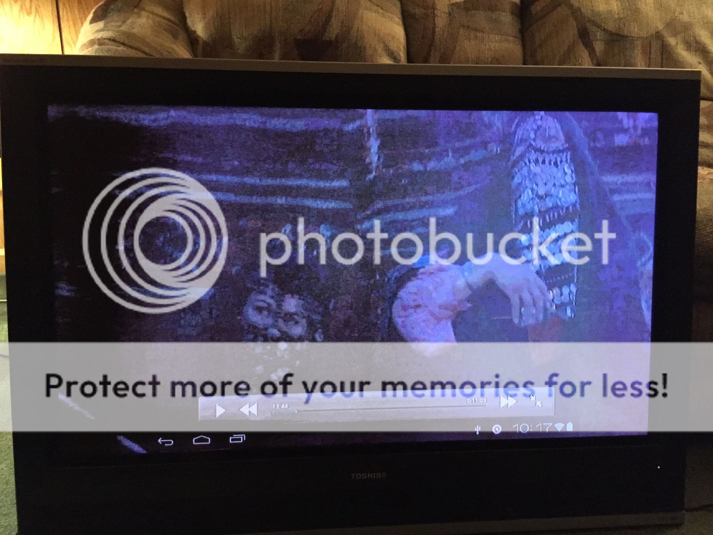

    Re: Toshiba 42HP66 dim, washed out patchy picture
    Apparently the HDMI ports do work, I guess the set didn't like windows 10 resolution settings. So all inputs and sound function correctly.
    Anyways, here's a few more pictures showing the washed out image and black patches. When there's no signal there's also lighter grey patches on the right side of the panel that aren't visible when there's something on the screen.
    The black patches seem to grow and shrink at will, and the longer I leave the set on the more the black starts creeping into the center of the screen, but as soon as a color intensive scene displays all of the patches fill in except for the ones in the first picture.
      Without checking and going by the pictures my 1st thought is the Z board.
                                        Lowered the Vs and Va along with the VSC and -VY by 1v and saw no noticeable change. Put the Vs and Va back to spec and played around with the Y board adjustments, now the picture is almost acceptable. It may seem extreme but the VSC and -VY are spec'ed to 120 & 200 and only after lowering both by ~10v was I able to remove about 90% of the mal-discharge. At ~5v lower the reds stopped firing but were replaced by splotches of blue and green.
                                        As it sits now it's watchable and if I didn't know what the issue was I probably wouldn't notice but since I do, it's extremely irritating!
                                        The HDMI input seems to hide it the best, with the RCAs being the worst. I can crank up the brightness and contrast to make it disappear completely but that just leaves me with a washed out image obviously.
                                        I guess I'll consider this set repaired, I wonder how long the y board will last being so far out of spec? I watched a 2 hr movie and it almost seemed to get better the longer the set was on, either that or I was just getting used to it. I began adjusting with the screen set to full white raster as the LG alignment handbook suggested, then got tired and got it to where it is now with a movie playing.
                                        A big thanks to everyone for their help, I'd be throwing all of these projects away if it weren't for the badcaps vets! Now I just have to find some movies that have no black in any of the scenes!
                                        These were the best pictures of the adjusted image, it seems impossible to actually capture the mal-discharge on camera, I guess that means it's not so bad!
